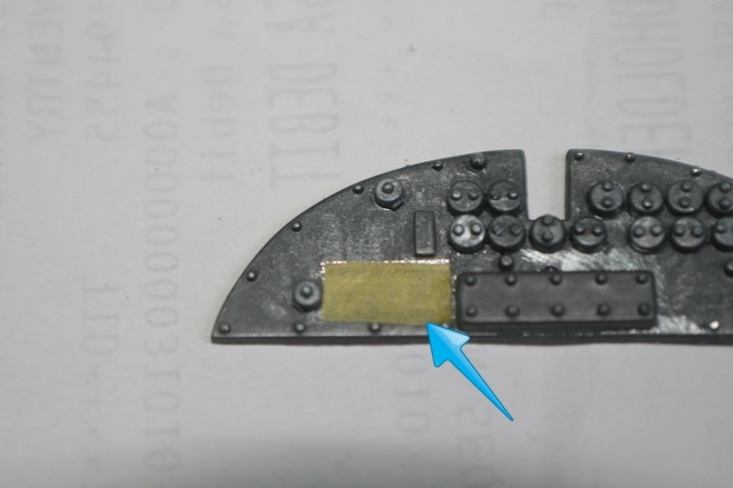

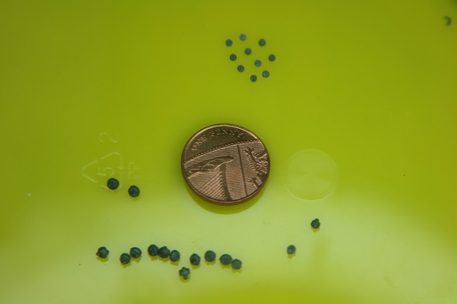

An area of approx. 8mm x 4mm that you have to fit 8 discs approx. 1.5mm diameter.(Evenly spaced)
Very rough diagram.Pic 5
Now this is where I went into "There`s got to be an easier way to do this".
The instructions say pick up each disc with tweezers, apply glue to the back and put in place.
Problem that I foresee, was that you could not manoeuvre the discs after being put in place. (Using Loctite 496 metal superglue)
So, how do you fit all eight discs at the same time and get them "close" to being evenly spaced?
Here`s my solution:
First clean up the area where the discs will be fitted.Pic 6
Next cut a piece of low tack masking tape,(I use "Frogtape")to size.Pic 7
If you then carefully remove the tape and stick the eight discs to the sticky side of the tape, you have this.Pic 8
This option gives you as much time as you need to get the discs in the best possible place. If you go for the direct glueing option you may only get six in place and have no space for parts seven and eight if you use up too much space for the first six.
So, when you have the discs in place on the tape and you`re happy to fit them, apply adhesive to the upper faces of the discs.
Carefully pick up the tape with a craft knife and turn it over into place on the cleaned area.Pic 9
Loctite 496 will still give you a short time to make the final adjustment before the position is finalised.
When happy with the final position leave the tape on and allow the glue to fully set.Pic 10
There`s no rush to remove the tape, it is very low tack. (Ideal)
Having had enough time to fully set, you can remove the tape.Pic 11

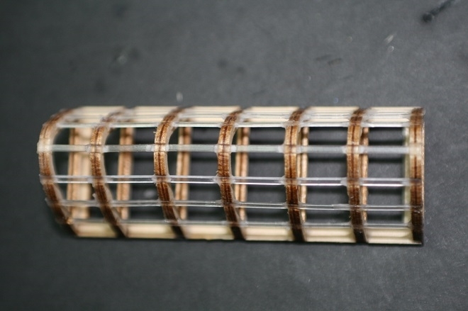

First off, the build of a pivoting leading edge for the inner wing section. This is only the basics of the construction, with the detail to follow at a later date.
The parts.Pic 1
This part of the build will only include the wooden parts, as the stringers took up all the time I had to this point of the build.
So here goes.

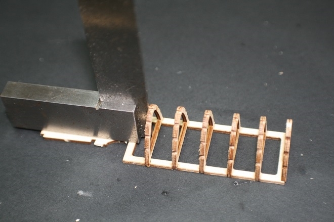

Remove the main base frame from the fret and fit the ribs at 90 degrees one at a time. NB: The ribs are not symmetrical, so make sure you keep them the same way round.
First.Pic 2
I used a piece of scrap fret to help set up a square, so as to make sure the future ribs ended up at 90 degrees.Pic 3
I followed on with the same process to this point.Pic 4
The final rib was set using the modelling table, result.Pic 5
With all the ribs in place, it`s time for more "STRINGERS" Crying seven in total.Pic 6
With the stringers in place, invert the part and carefully remove the five centre lower spars.Pic 7
This is where you are at this point.Pic 8
Final part for this section is to remove the outer spars from the base. Use either a very sharp knife or a razor saw.
When done sand all the rough edges.Pic 9
Final result.Pic 10

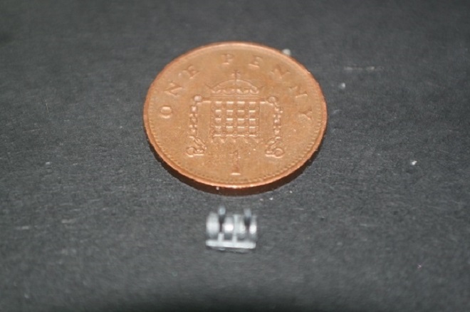

Building up the pilot`s control levers.
On a scale of 1:32 the parts used come in on, shall we say the "small side".
So, time for some more thoughts on how to put it all together.
Confused Crying Confused
More on that later.

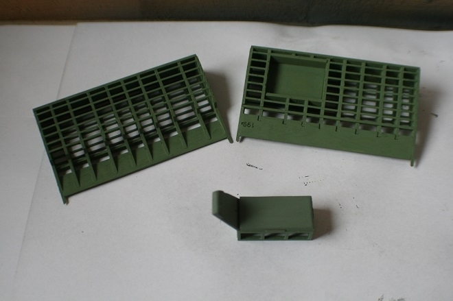

First picture shows the parts:(17 in all)Pic 1
The lever panels are made up in three sections.
The two smaller ones fit outside the larger (inner) one, just a mirror image of each other.
The smaller ones consist of the base plate and two control levers.
The larger centre one has a base plate, eight levers and two control heads.
Outer lever parts.Pic 2
Ok, construction:
The instructions say, pick up lever in pliers, apply glue and put in place.(Great way to feed the carpet gremlins).Cursing
My solution:
Bring out the "low tack" Frogtape.
Stick lever to the tape.
Put a small spot of glue in the appropriate slot, using cocktail stick.
Guide lever into the slot and allow glue to set.
Then remove tape.
Lever pressed onto tape.Pic 3
With the two levers in place you get this result.Pic 4
Construct the other outer panel in the same way.
The main centre lever section is constructed in exactly the same way, only orientation of the base plate and hence the two longer levers is important.
Here is the four lower levers in place, with the last one still setting. Hence the tape is still attached.Pic 5
Now, the upper four levers are fitted with the two shorter ones in the centre slots and the larger levers in the outer slots.
