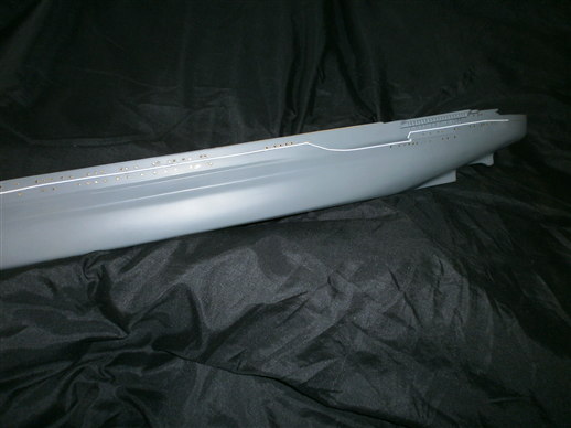

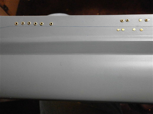

I managed to get all the front section portholes/blanks compleated with the suplied blanks [hope theres more to come so i can finish the stern areaBlink ].Next will be to add the degausing strips to the hull as ussual all coments and any questions are welcome

BigGrin Hi all
some progress on the degausing strips now 3 parts finished ,i will have to wait till i get the next issues porthole blanks to finish the stern area . As ussual all comments and questions are welcome

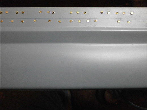

#184 Posted : 01 May 2012 23:46:43

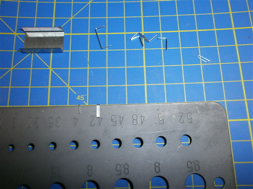

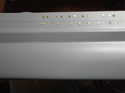

Another enhancment im adding is the fixing straps to the armoured degausing trunking, to do this i used staples cut in half then bent over a 1mm thick steel sheet to get the desired shape.To obtain the spacing im using an unused plank cut to size to drill small holes either side then the straps/staples are pushed home[probably way out of scale but its the look im after].It will take me a while to do but as my Akagi shipment went missingCrying in the post this month and iv had to reorder iv got plenty of time.All in all i think its improved the look of this area,as ussual all comments and questions are welcome
#185 Posted : 02 May 2012 09:13:32
Going the whole hog Andy...She will look great when complete Cool

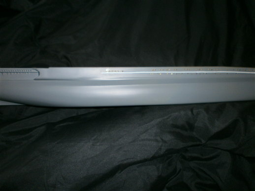

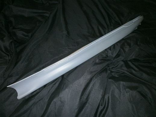

BigGrin Just a few pic,s of the bow/ midships with the brackets added,bit of filler to go on in places but overall the desired effect has been achieved i think.The stern area will be finished when i recieve the next issue, as ussual all comments and questions are welcome
