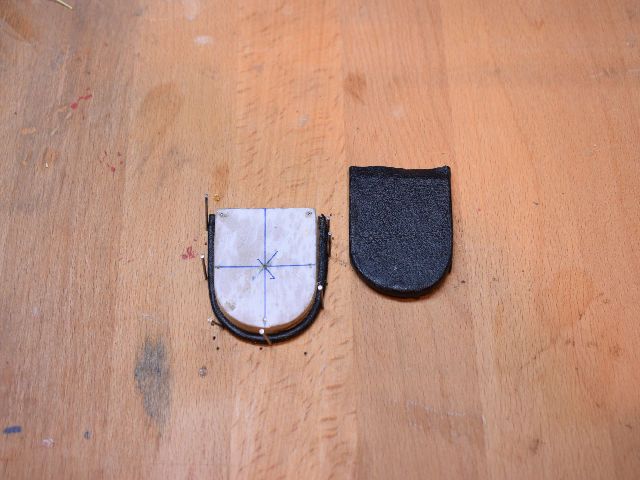

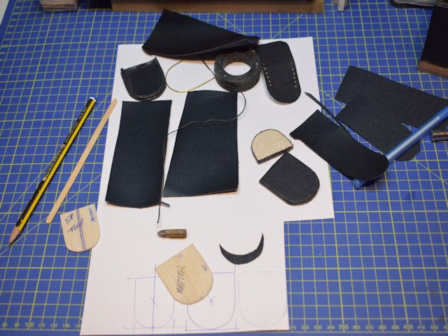

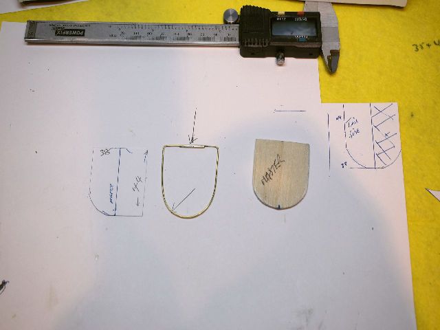

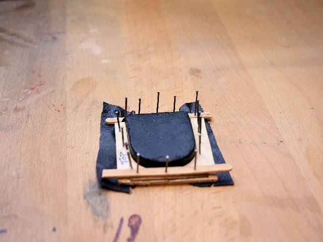

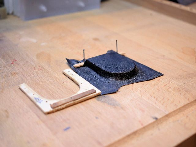

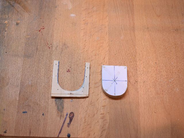

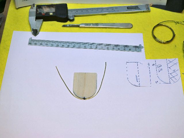

UPDATE: MAKING SADDLE BAGS FOR THE WINCH.
Soldering frame / Cutting leather to fit.
First was to make a jig exactly the shape of the saddle bag then with the 1mm brass bend it around the jig to the exact shape keeping it as close to the jig as you bend it watching out for kinks as you go.After soldering I had to reinforce the top as this was a week spot.
Next to cut the leather, this I had to glue a piece of leather to the brass frame to form a back side then stretch it over the jig to form the front shape, this I used spray starch to help keep the shape then leave it over night to dry.
Next to make the bag flap / buckles / and straps.
Trev.

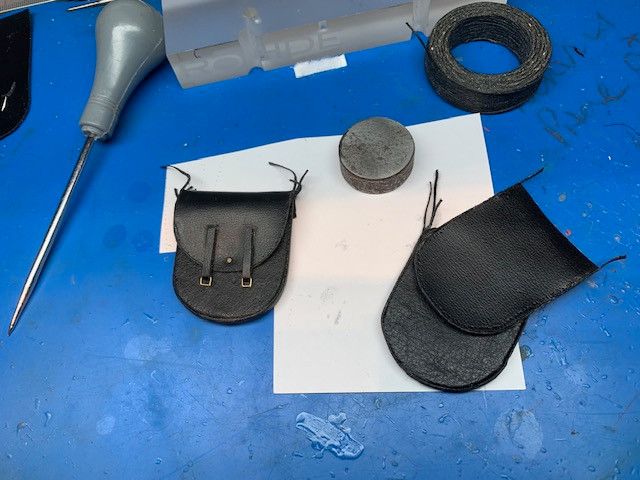

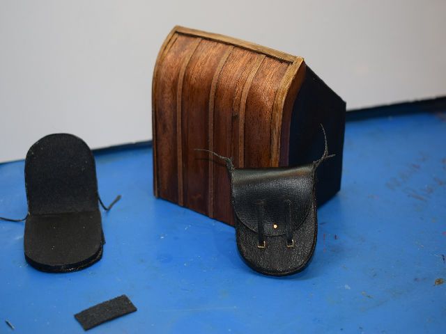

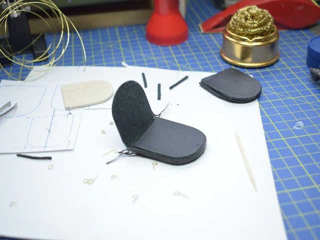

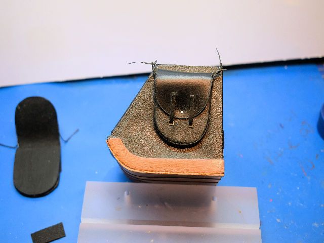

UPDATE:SADDLEBAGS.
Materials Leather,brass rod,black cord.
1 First was to bend the shape around the saddlebag jig,this will form the base shape to hold the leather.
2 This shows the front part of the saddlebag stitched to the rear frame (this is were the brass rod is,also shows brass rod buckles in the making plus bag straps.
3 This shows one completed bag with straps and buckles,and one with the flap over to be assembled.
4 Two saddlebags now completed and ready to fit to the Winch box at the rear.
5 This is were the saddlebags fit each side of the Winch box,the only part (not supplied) are two shotguns which I will scratch.
More Soon
Trev.
