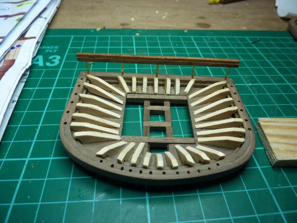

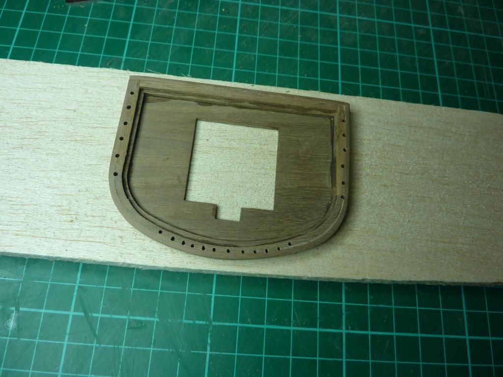

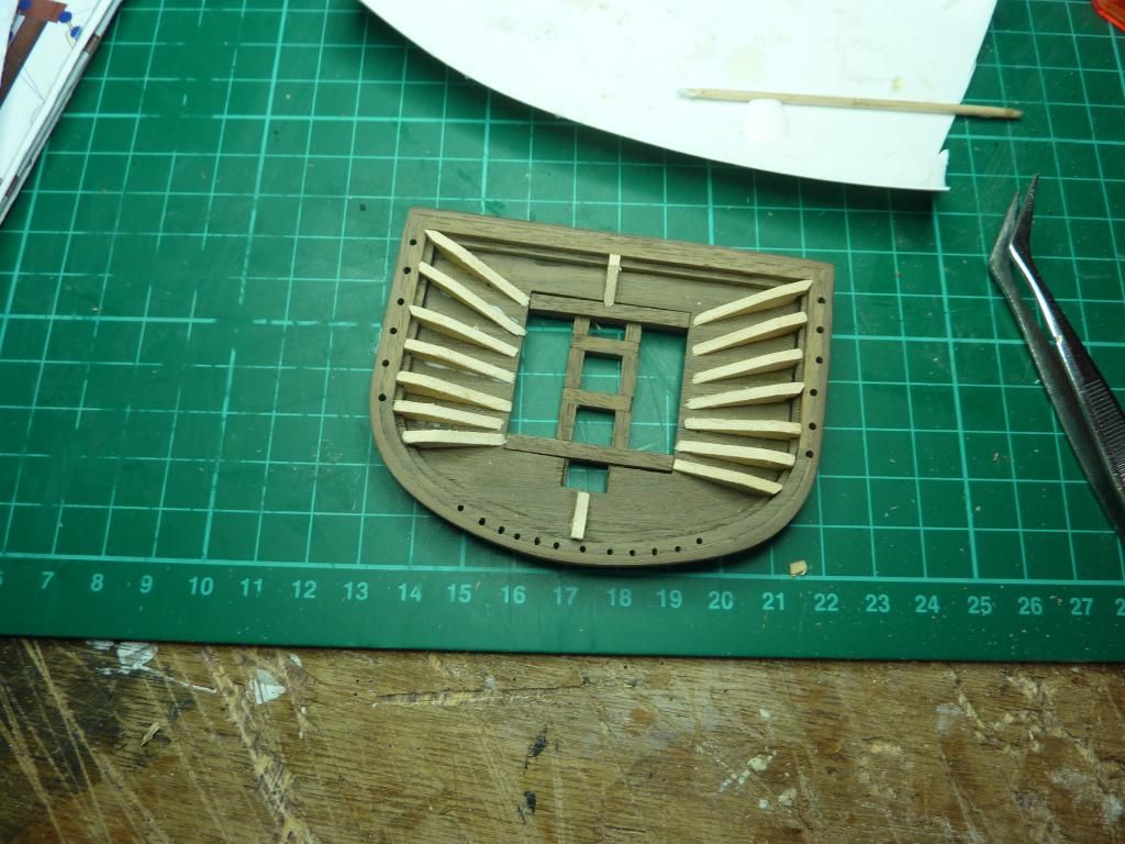

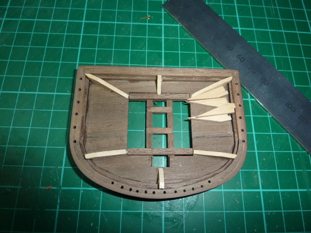

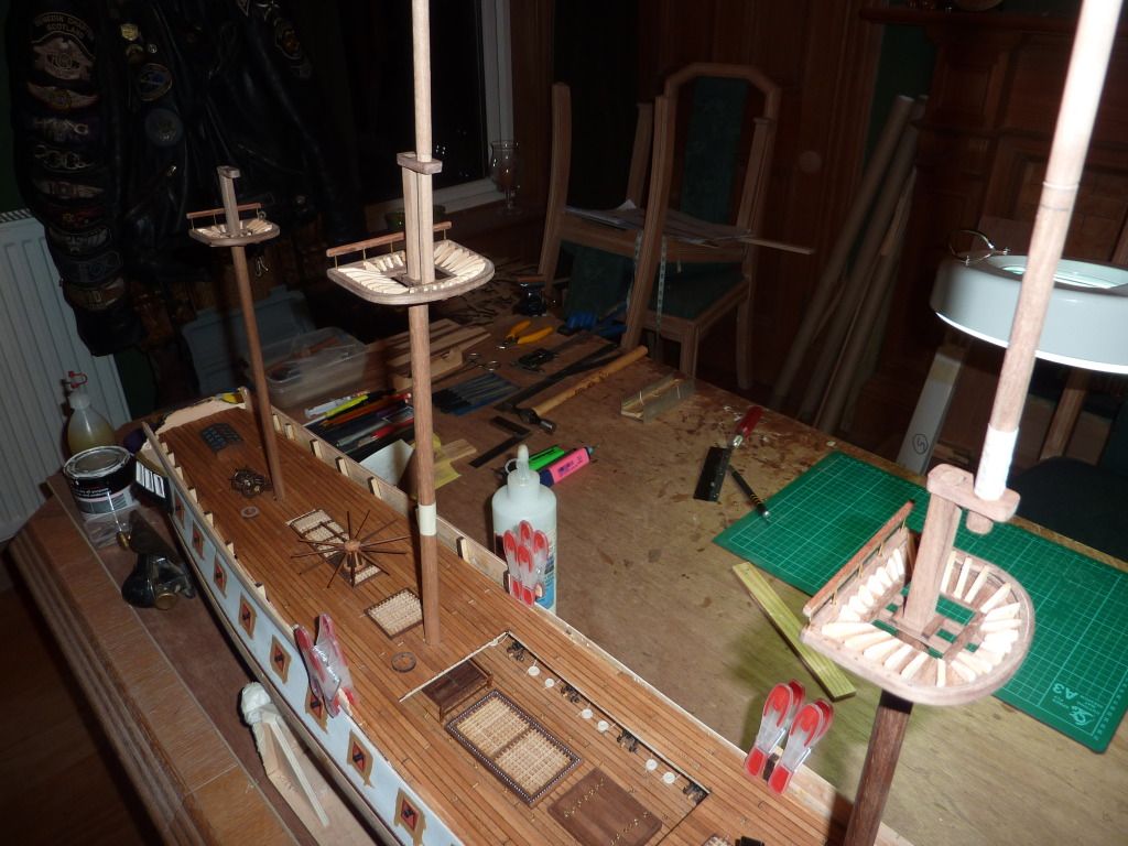

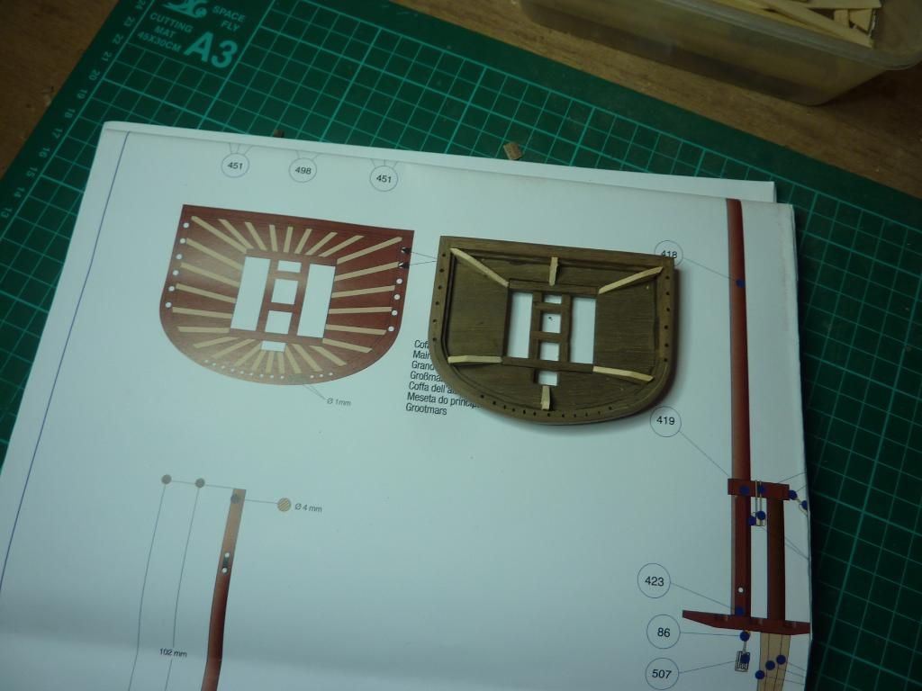

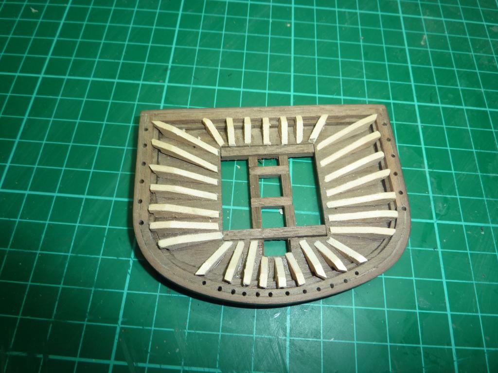

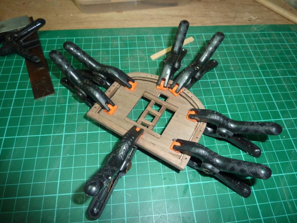

I deicided to do the work to the foretop's,
I sanded all the burn marks of the framing, trimmed to fit the base and glued in place.
Once the glue was dry, I bored the holes round the edge of the foretop.
I then marked out the positions of the bass wood battens on the floor.
There are some eyelets to hang from the underside of the platform, I have bored these and am going to fix the floor battens over these hole, so as I can fix the eyelets to them from the underside. Then you wont be able to see the holes from the top.
I then bored the holes for the handrail and fitted the brass legs and fitted the walnut and sepele handrail.
I am going to do the same to the other 2 now.
Over and out Mo

Well there has been a lot of time spent on completing the foretops or crows nest's or what ever they are called. A lot of precision cutting and fitting, Again I am more than happy with the results. All I have to do now is fit the blocks and the netting to the handrail. Will catch all that later in the build.

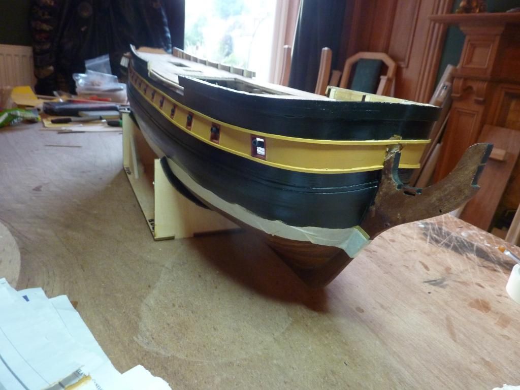

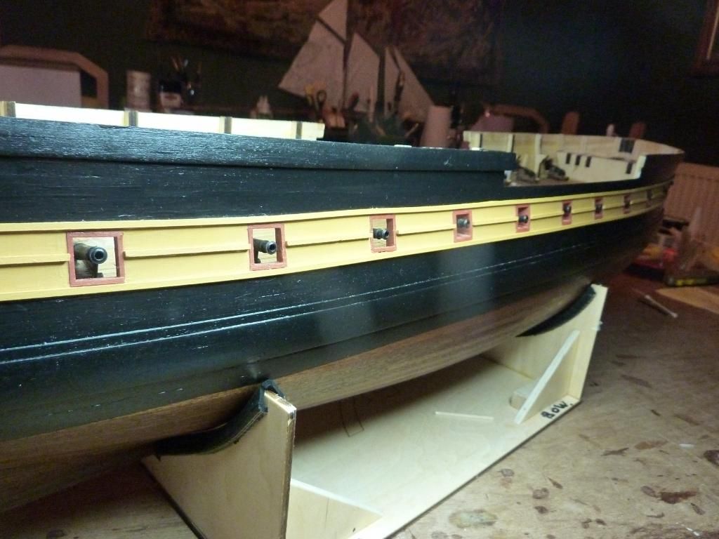

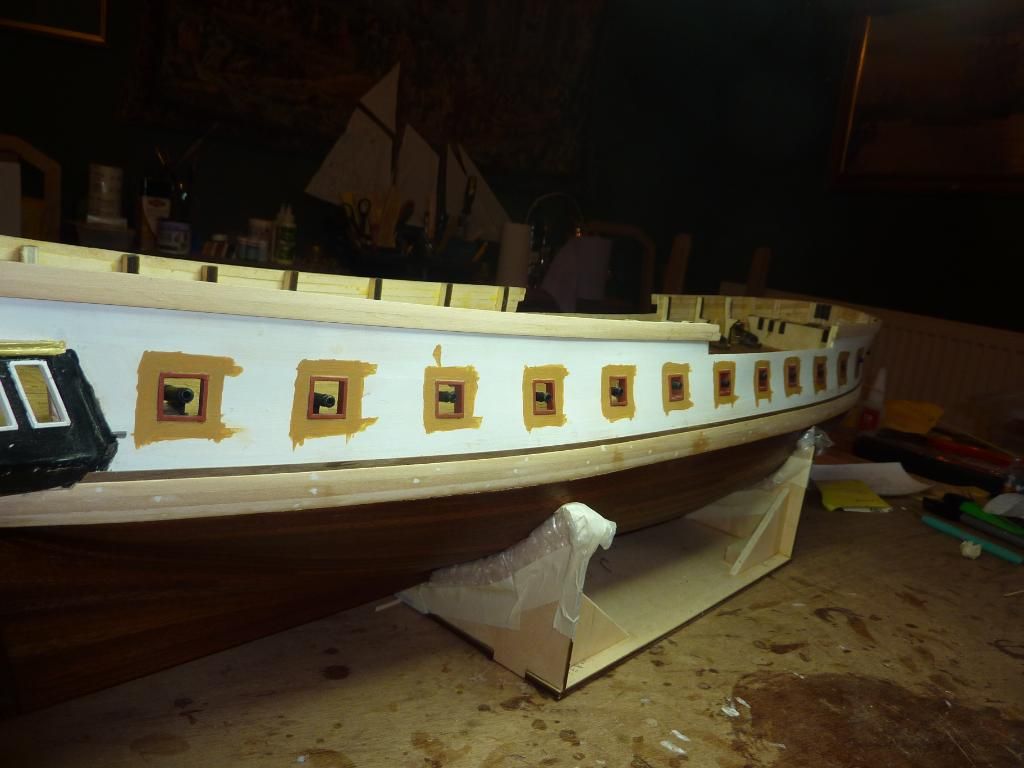

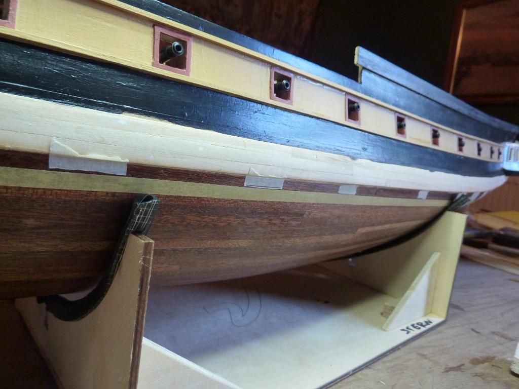

I have started to paint the hull, This will test my painting skills.
I had previously painted the gun port liners ochre red, and I had cut round them in yellow ochre,
I then roughly painted inbetween the gun ports with the yellow.
I then cut and bent the timbers for above and below the gunports to the shape of the bow, I then gave them 2 coats of yellow, waited till they were dry and super glued them to the hull,
Its then a case of painting the black to the lines of yellow, I still have to put my masking tape to the water line to take the black to that point.
I think my carpentarty skills are ok, just have to polish up on the painterwork.
Mo BigGrin

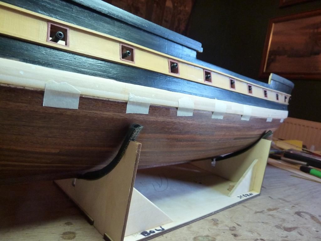

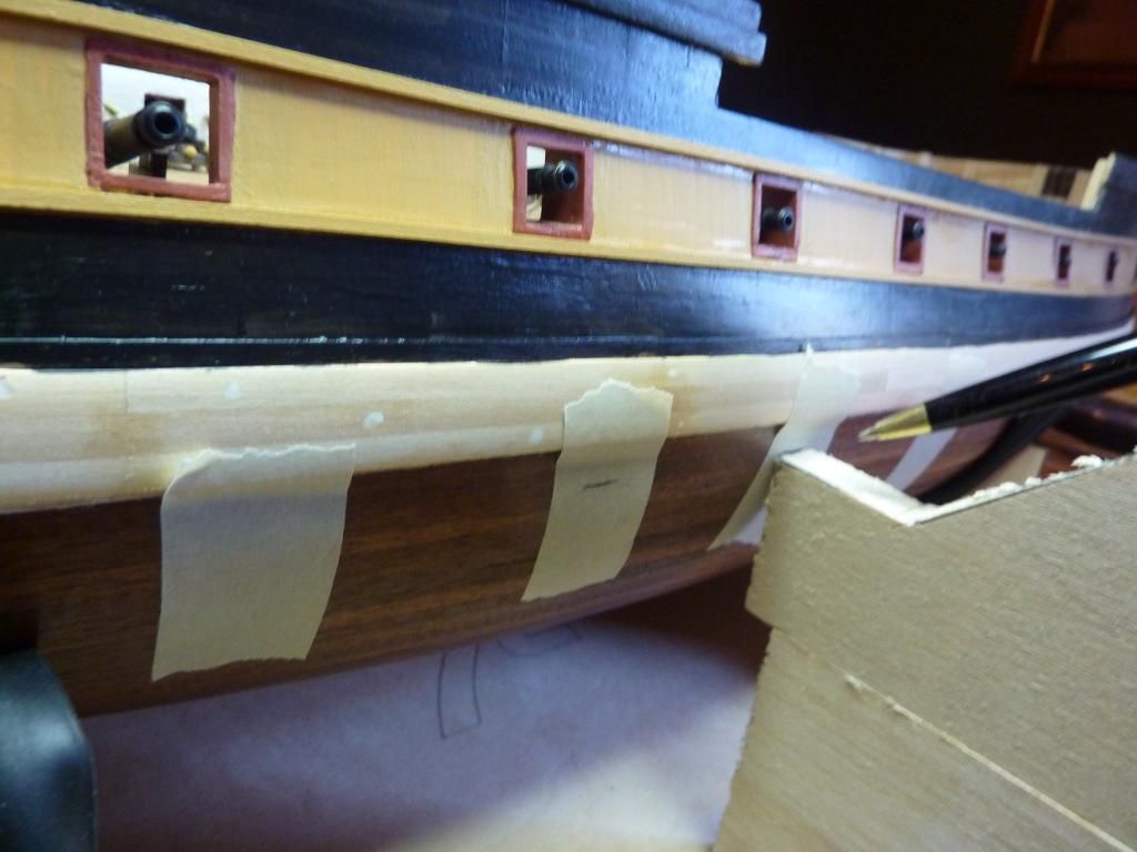

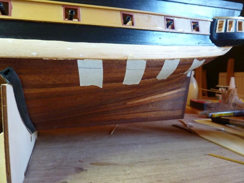

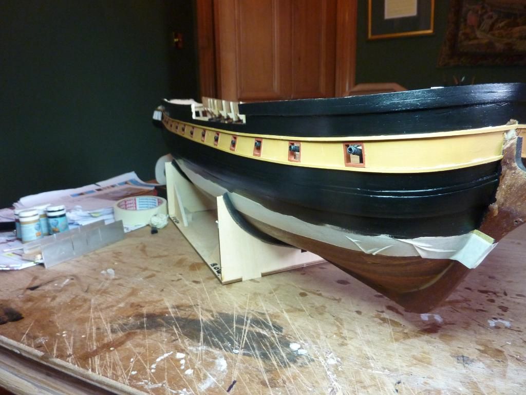

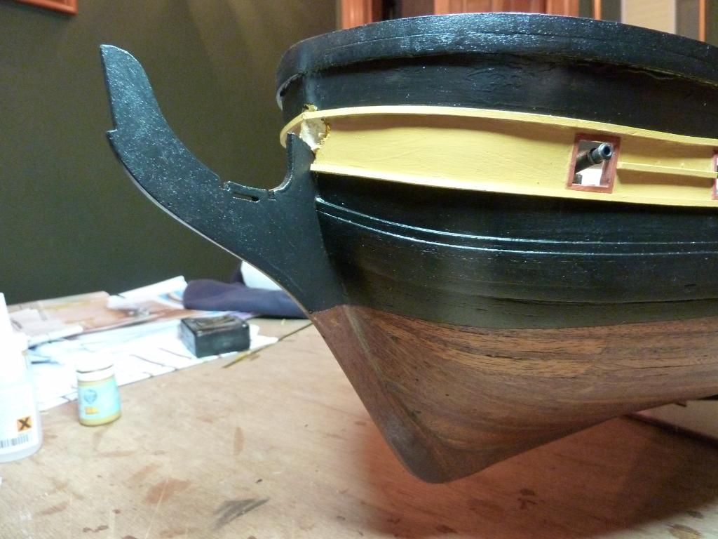

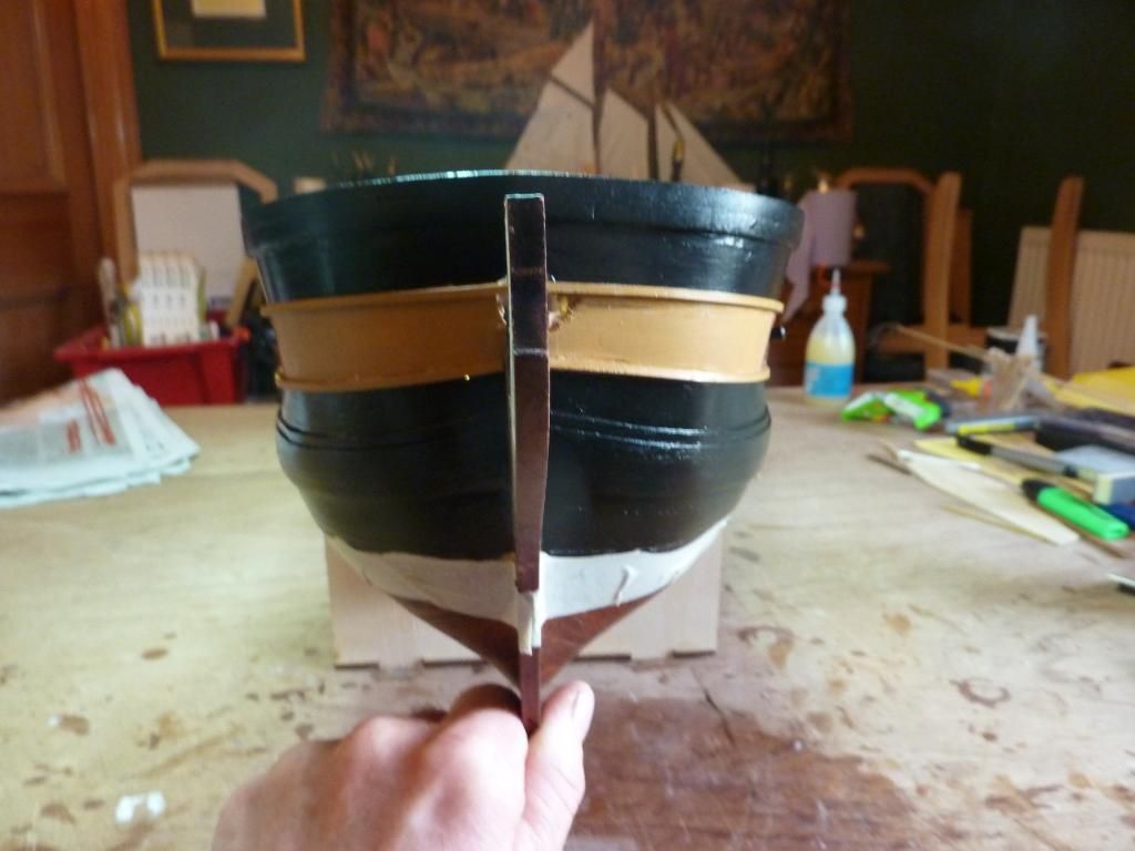

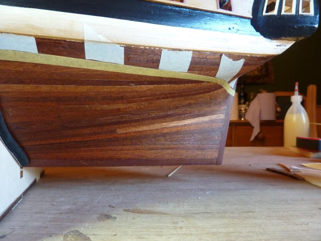

I am now establishing my water line mark, the line to where I will take the black paint down to, I first put masking tape round the hull, at variour points.
I then used a block and then marked the heights on to the masking tape, Ensuring first the ship was level length ways and width ways.
I then lightly scored the tape, at the lines I had just marked, with my craft knife, and removed the tape to the lower side.
This then gave me the position of my masking tape, which I stuck on.
I then removed the tape above the masking tape ready for painting.
I also put a extra bit of masking tape over the small piece I had stuck on.
And I painted away, 3 coats to all the black areas.
10 10 for now Mo.

I had deceided at the end of my last post that, that was it for the day, No more holding my breath to paint black into Yellow, I had done enough. I then hung up my paint brush for the day.
After which I could not hold the brush, So I took of the masking tape, and to my great delight it had worked.
Night Night now, of for some more Bud.

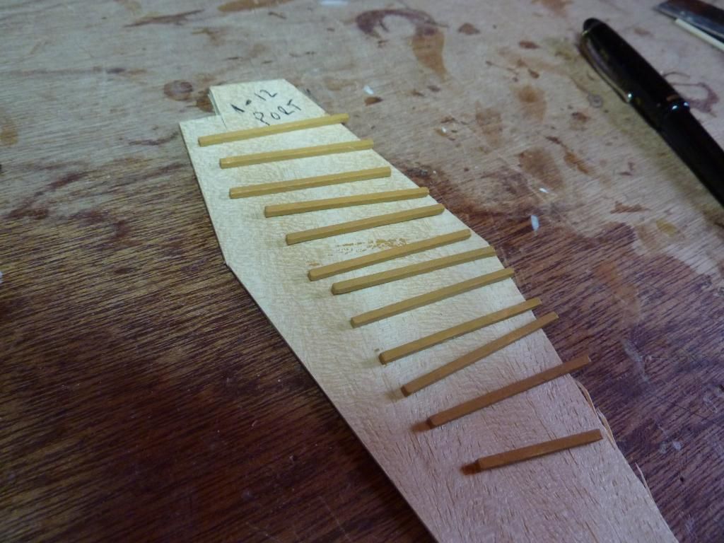

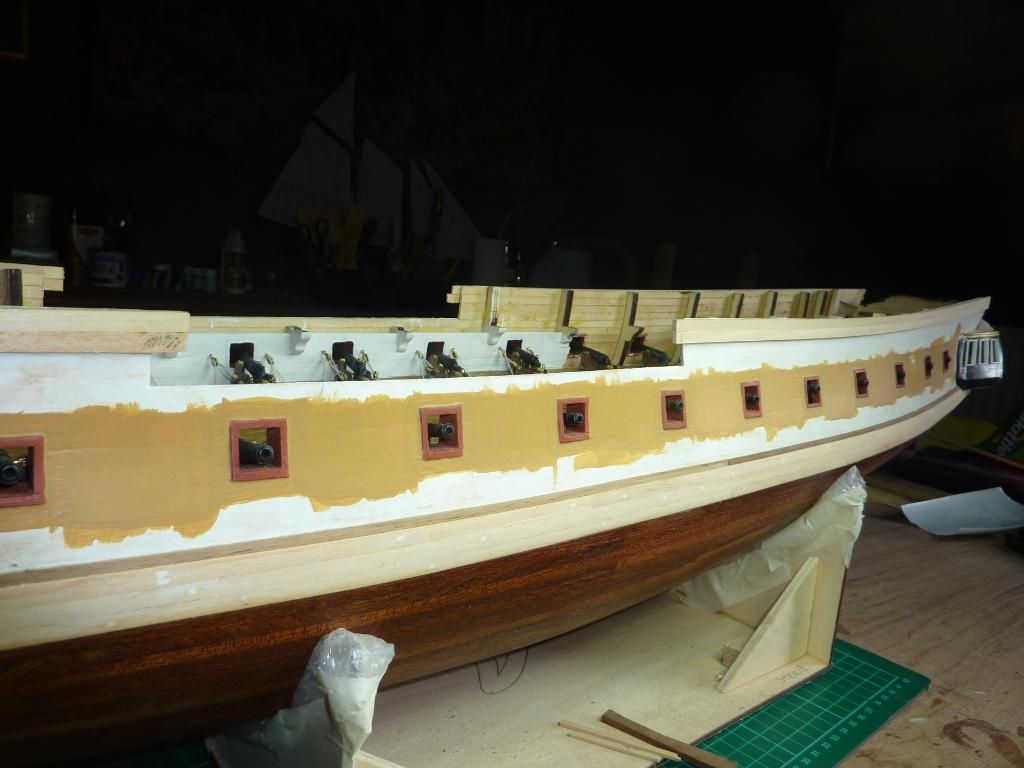

Today I have cut painted and fitted the 2mm x 2mm timber battens through the center of the gun ports.
I cut and gave two coats of yellow ochre to the timbers,
I marked the hull to there positions, But I am not going to do the first one up to the Bowsprit, untill I have fitted the bowsprit itself, I can fit it to the dowel, rather than cut away at the timber to fit the dowel.
I used a timber spacer to achieve the right position for the timbers.
I am more than happy with the line of all the battens. a good parrallel line to the bottom and top timbers.
