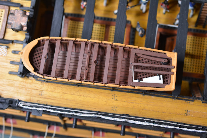

Hi all,
After regaining the use of a full compliment of digits, I set about completing the launch. The last main item to build was the rudder, but I immediately had an oops moment. Upon looking at the rudder details I noticed that the ships boats do not have a prominent stern post like the mother ship, or indeed, the donor hulls I'm using, so that had to be shaved off.
To get the rudder tight against the stern board, cut outs are formed in the top section of the rudder and on the back of the keel to fit the pintles into, unlike Victory, where all the pintles are on the rudder,and all gudgeons on the stern post.
I made the pintles and gudgeons from various pieces of small brass and copper strips.
The rudder itself was cut from styrene sheet and again, the pintles and gudgeons made from strips of brass and copper.
Finally, a length of 0.5mm brass micro tubing was drilled and glued into the top front edge to form the steering arm.
A couple of coats of paint, and the stern board repainted, to complete the working rudder.
A couple of shots of the completed launch in position on the skid beams.
Its good to be back on the build. BigGrin

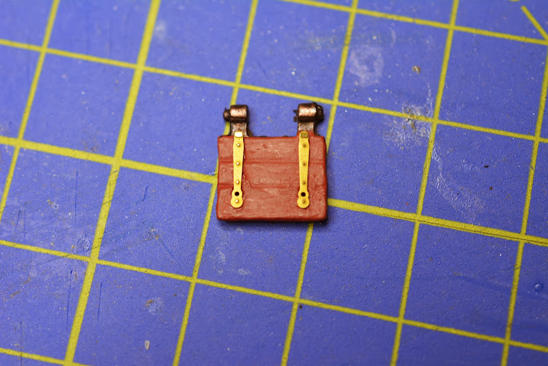

Hi all,
I'm still plodding along with the gun port refurbishment, but haven't done a great deal since Christmas as I've been busy with work and family,
it's a pain how these things get in the way of your hobbies BigGrin
Here's a few pics showing the refurb procedure.
Step one is to grind off the hinge and large raised detail around the holes on the gun port lids.
The new PE hinges are then fixed to what was the inside face of the lid.
Followed by the eyelets.
The old riggols are carefully removed and replaced with the new correct profile PE ones.
The colours on the lid are reversed, eyelets fitted to what is now the inside of the lid, new riggol painted in, gun fitted, lid fixed in place and lanyards attached.
Only quite a lot more to do BigGrin
