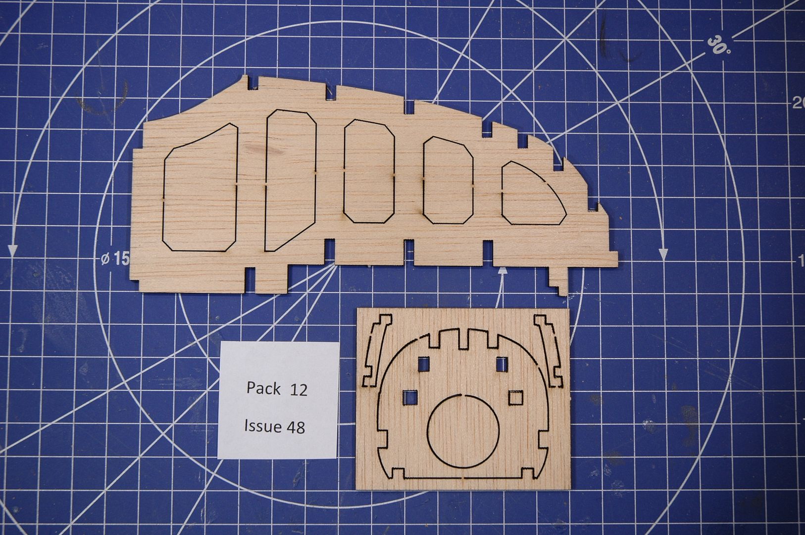

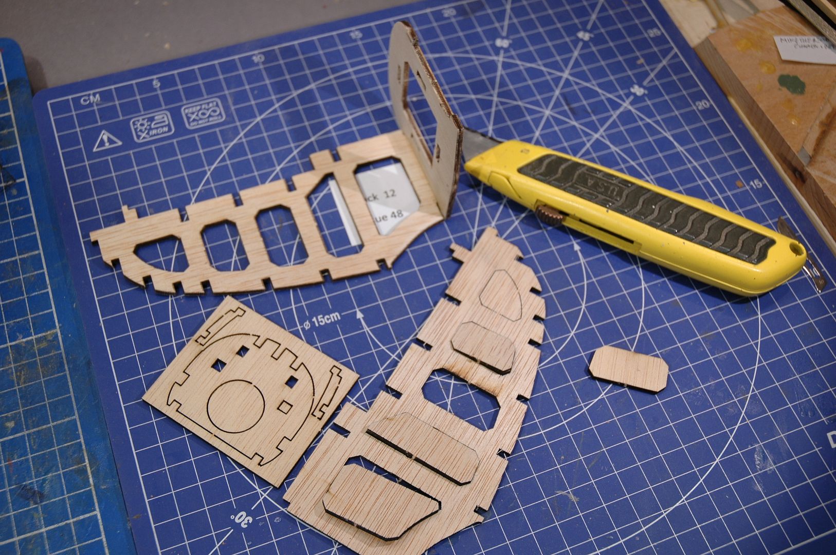

Received today Pack 13 look's like I will be very busy this month, this is what we have, for some reason in my pack I have issue 48 from pack 12 ?
Pack 12
Issue 48.
1 Engine Side
2 Engine parts fret.
Pack 13
Issue 49.
1 fuselage Reinforcement fret.

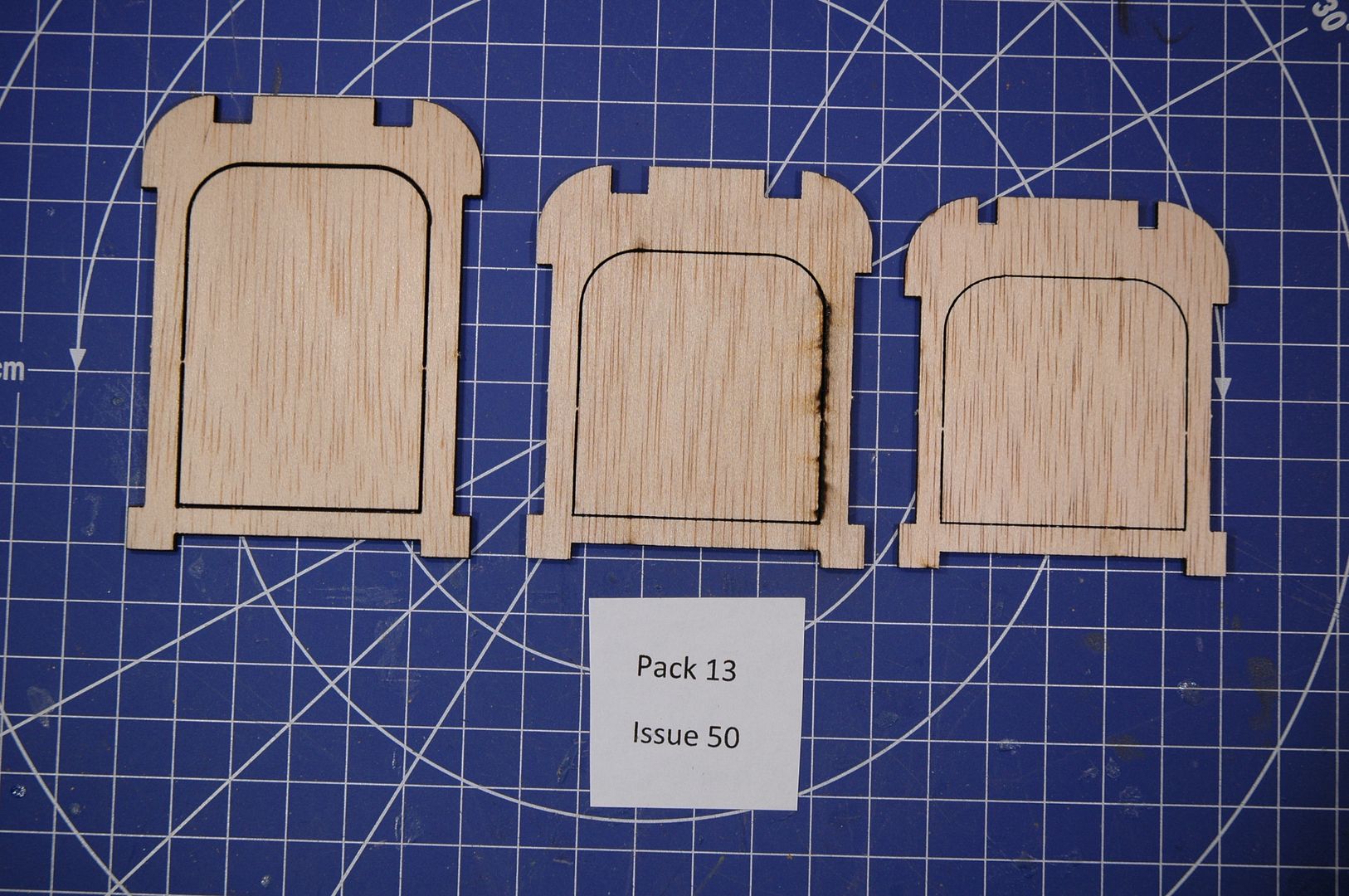

Pack 13
Issue 50.

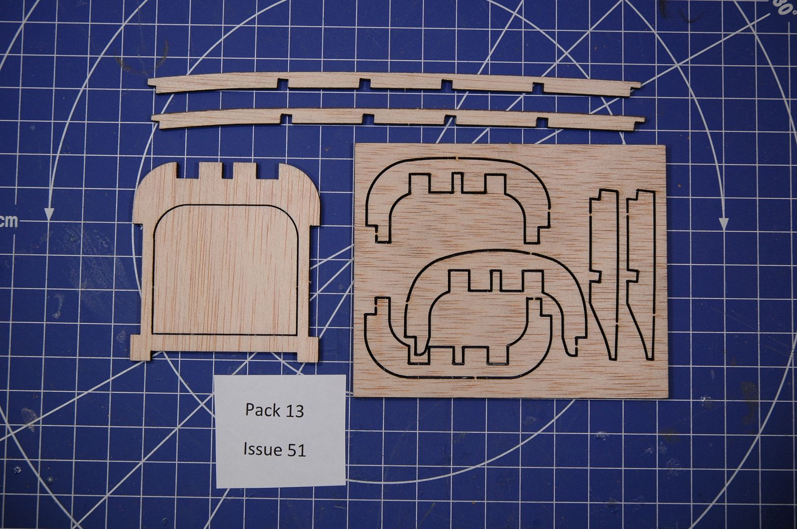

1 Frame 12
1 Frame 13
1 Frame 14
Pack 13
Issue 51.
1 Frame 15
2 Reinforcements
3 Reinforcements
That's all for pack 13 I will post as soon as I have built pack 13.

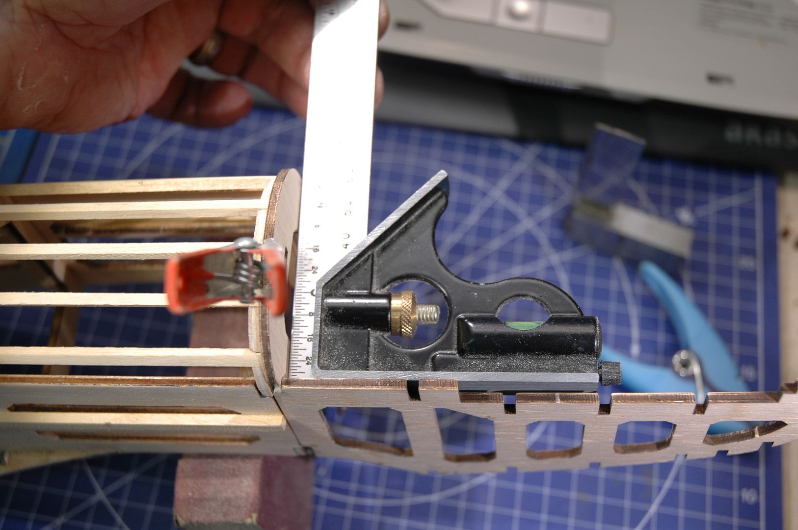

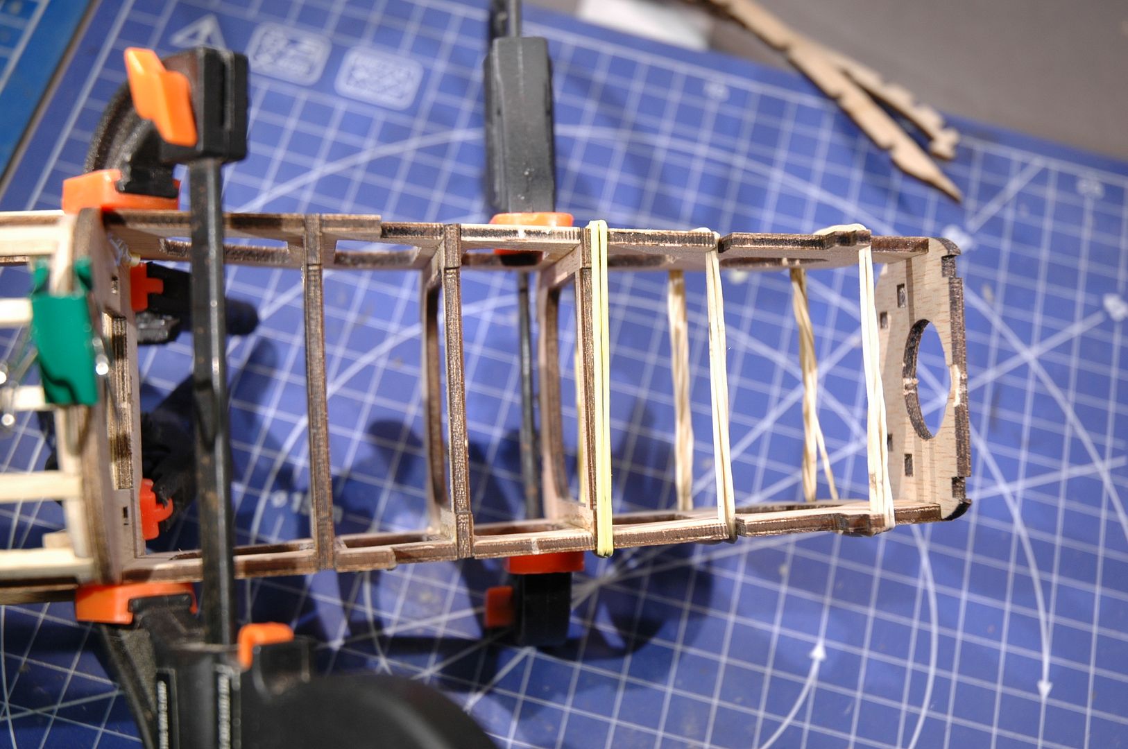

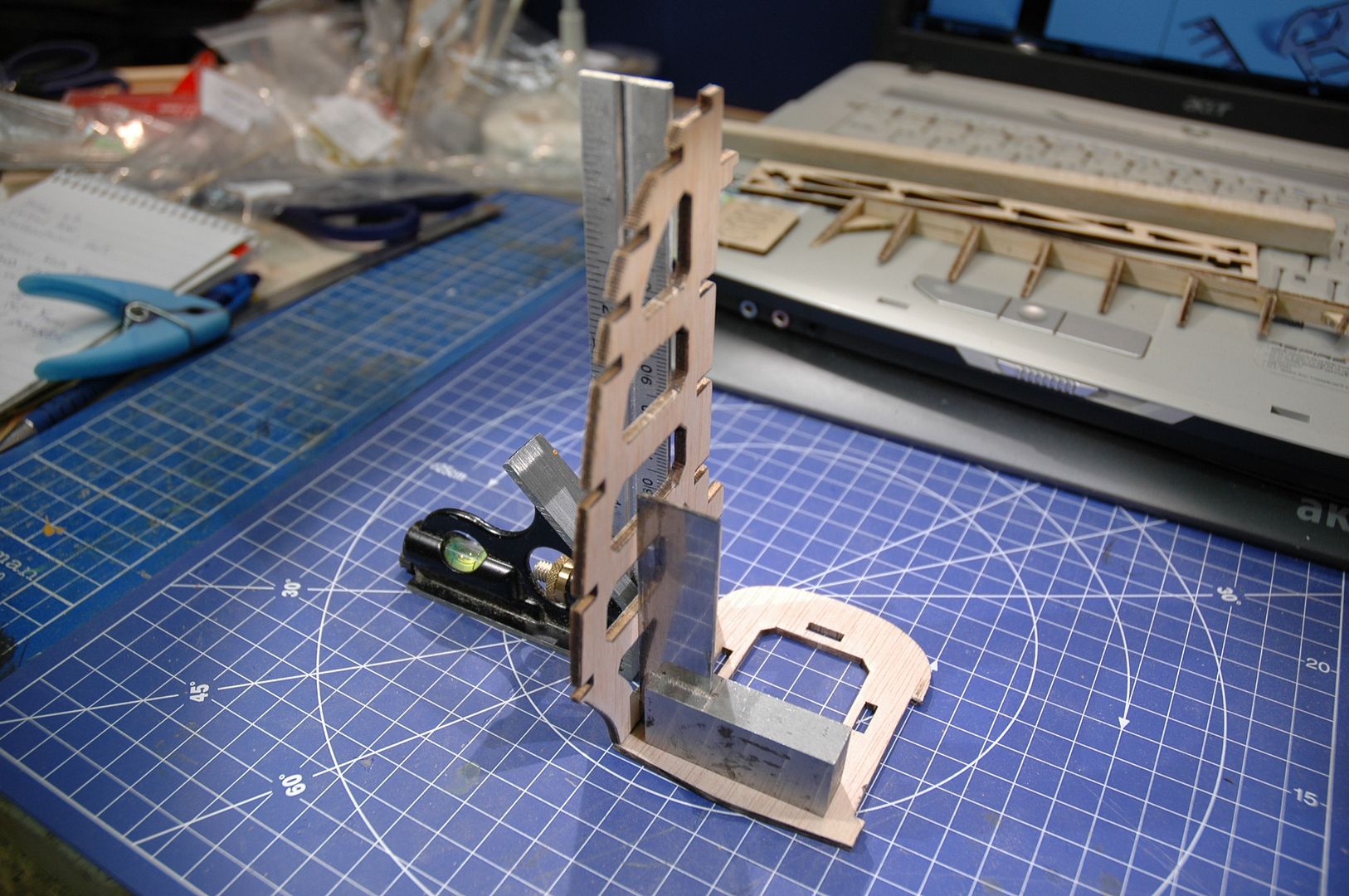

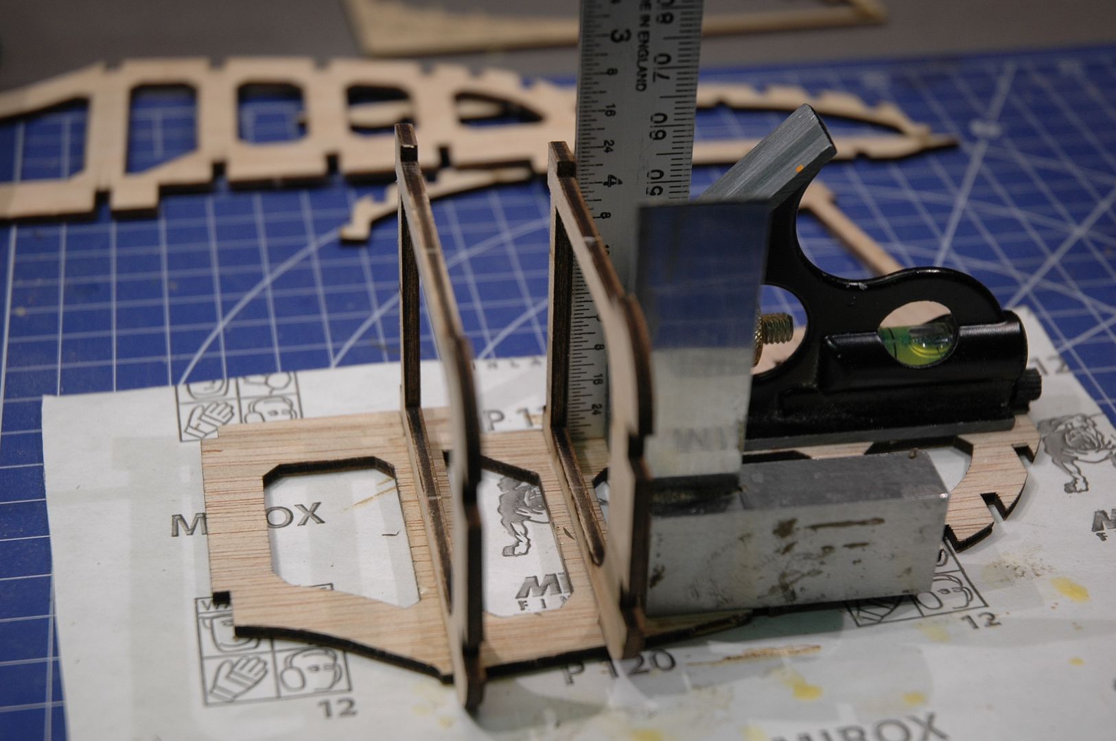

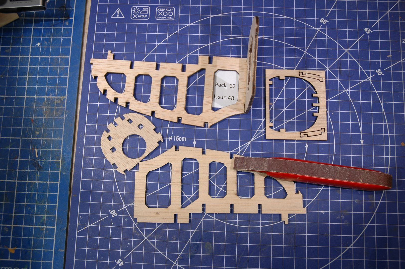

UPDATE:ENGINE SIDES.
Very ease to assemble but in my build a tricky part towards the end.
After gluing one engine side to the back plate and squaring up and test fitting to the airframe all ok and leave to set for 24hr.
Try to Airframe.
Next I removed the engine front and side from fret also the centre hole, then I smooth and sanded all fret parts, test fitted the front frame with engine sides all ok, this is the bit were you only stick one side of the engine front but check for square, I choose not stick the engine front at this stage but preferred to wait.

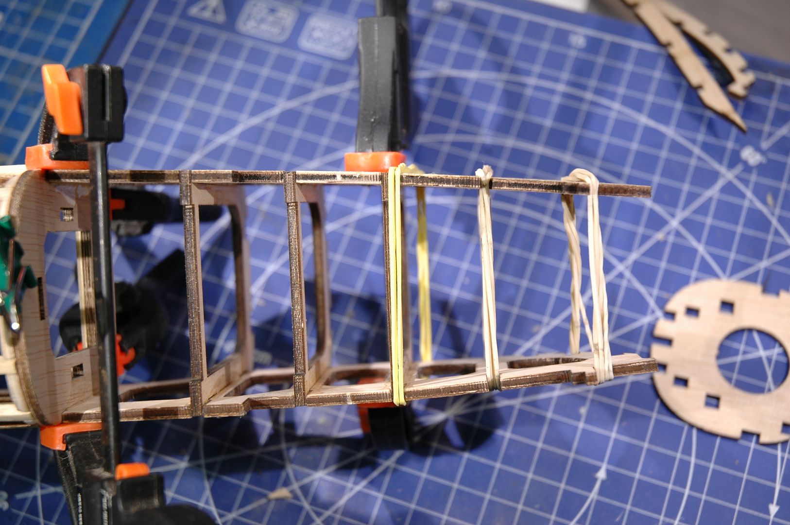

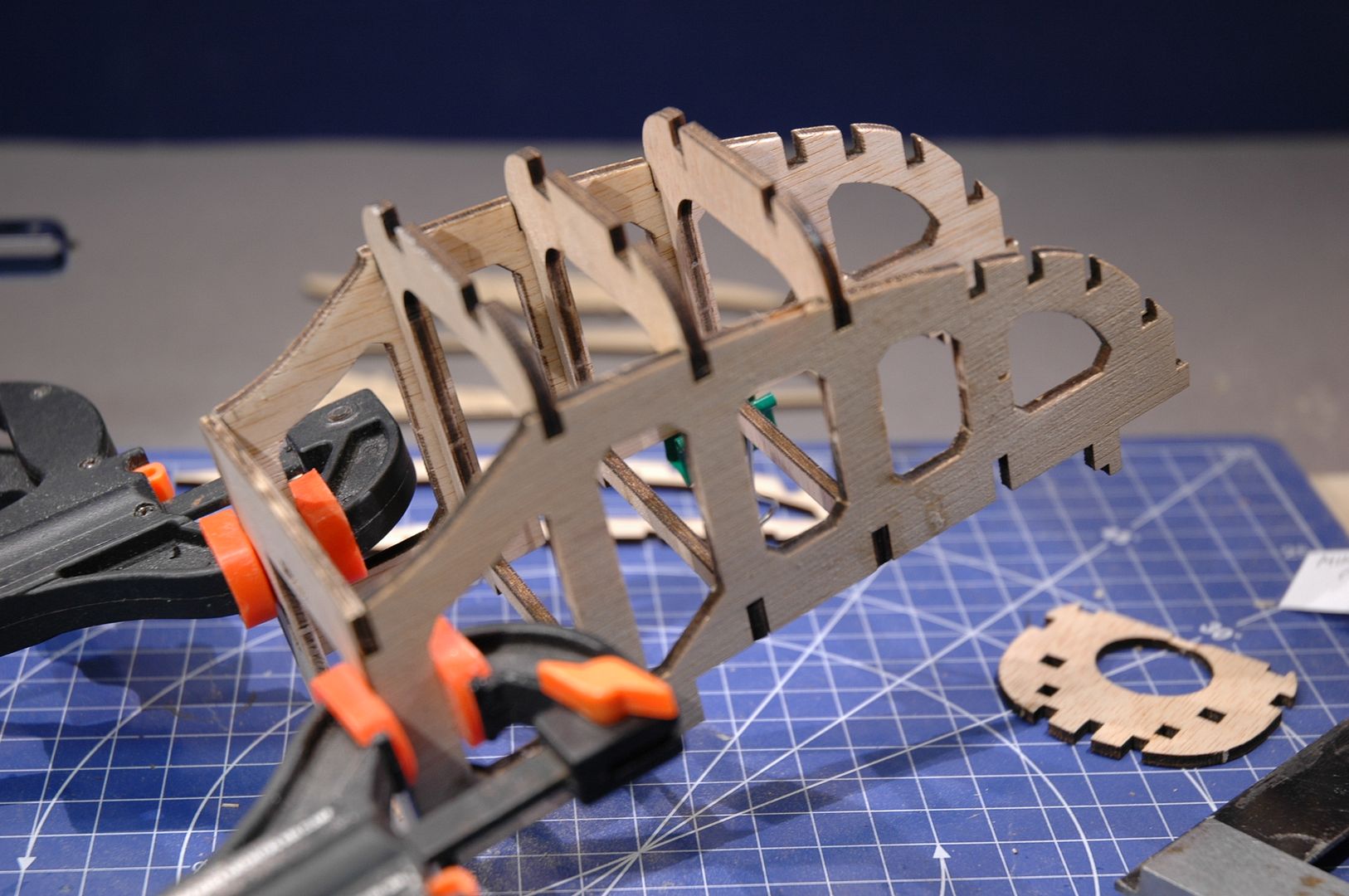

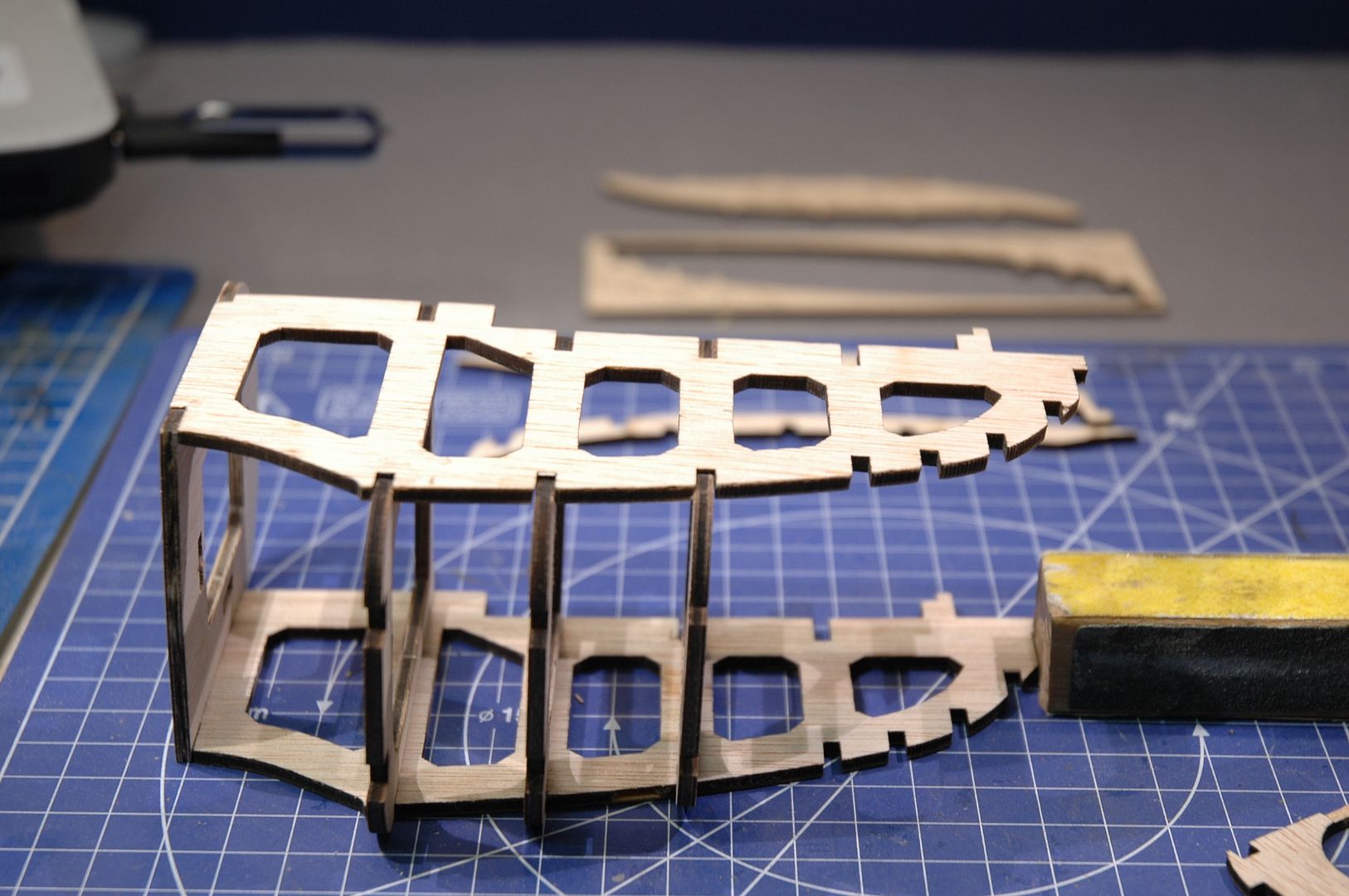

Next was to dry fit engine formers 12/13/14/ with only one engine side glued it left me free to try/ place /and /adjust the remaining this became tricky to hold together, but clearly I could see that it was not square towards the front? (it all seemed squared to me) The only way I could see was to file a bit out of the side slots which I did, ( this is why I didn't glue it) the only problem now is you need 6 pairs of hands to glue it all at once, but it worked.
Can you see in this shot how the formers lean forward these are not glued at this stage.
This shot shows how I assembled it with out the engine front to me this means I can still adjust.
This shot shows the use of elastic bands to shape in the front section.
This shot shows the engine front in place and clamped to the Airframe.
That's it for now more soon,
Trev.

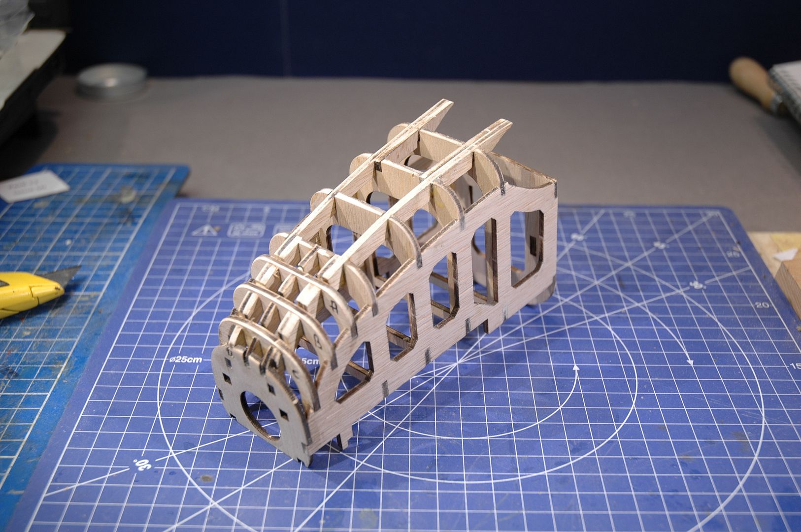

#188 Posted : 06 September 2014 19:51:20
UPDATE:ENGINE COMPARTMENT.

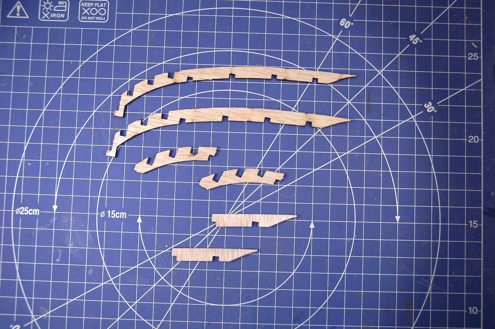

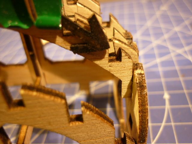

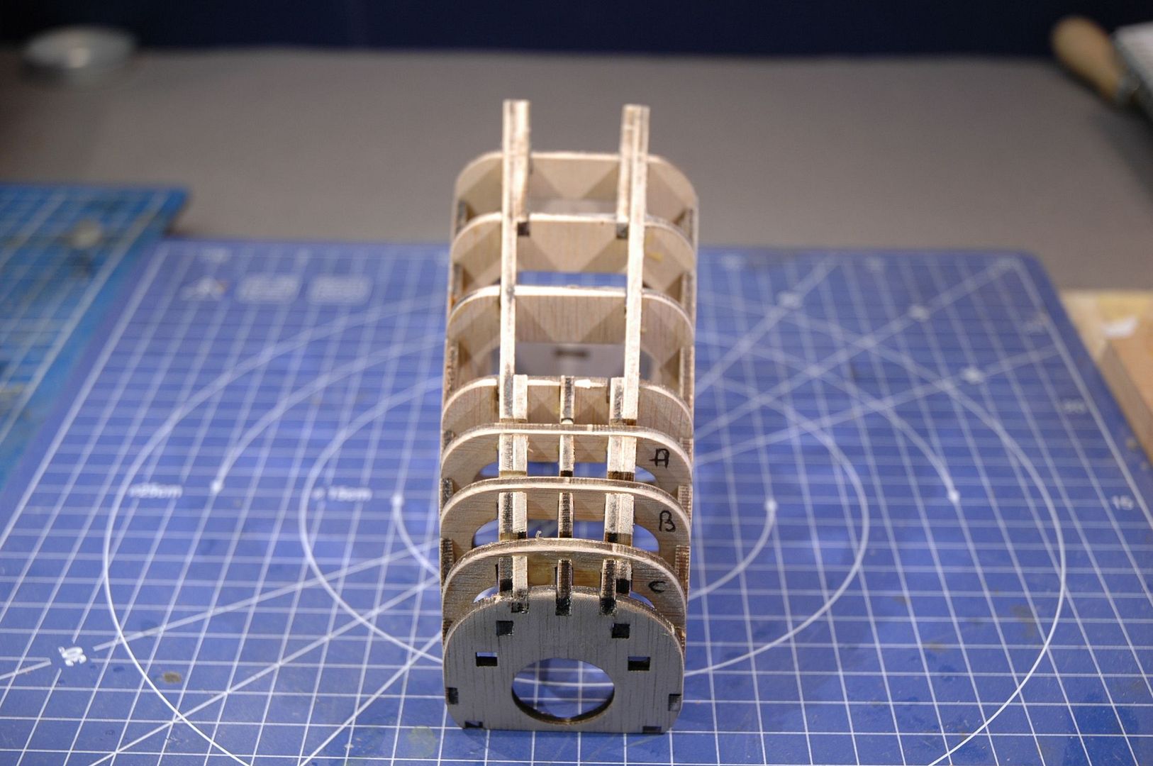

The last few pictures were the first stage assemble of the engine compartment, this stage I am assembling the upper reinforcements struts. This I found not bad to do as all the joints lined up and kept square, the only one I had to adjust was a front nose former but I am sure it was me as you will see in the pictures.
This picture show's the top struts, top struts (rear) reinforcements, and front nose reinforcements.
This picture show's the longer reinforcements/the shorter (rear) reinforcements.(this photo is a bit blurred sorry)
This picture show's the nose formers in line A/B/C just a point to look put for A former has a flat top.
The last two pictures are as far as I can go until I receive my next post.
All the pictures today are of the underside of the nose/engine compartment.
Thank you for looking.
Trev.
