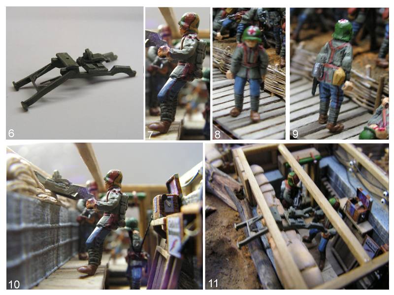

In this instalment we get to the last of the ‘fairly’ major figure conversions, namely the last of the German Medics who in this case is converted from one of the Flamethrower squad and also the other half of the MG08 machinegun team who is modelled not feeding the ammo belt this time, but trying to save the sledge mounting for the gun in the bunker.
The first diagram shows the two members of the ‘Flammenwerfer’ team as pictured on the back of the HaT WW1 German Heavy Weapons Set. Later Flamethrowers were a single man affair, but the earlier versions, as shown here were two man operated. On the left is the ‘mule’ who carries all the weight of the weapon on his back in the shape of a large pressurised cylinder containing the flammable mixture. This is fed to the other member of the team via a flexible hose to a long ‘Lance’ with an ignition device on the tip. It is this second man who actually aims and fires the thing, his team mate is simply a two legged fuel tank!
Photos 1 and 2 show the tank carrier still on the sprue, the conversion consisted of removing all signs of the flamethrower by cutting away the hose from in front and behind his right hand and then carving away the actual tank or cylinder from his back. The hose was pretty easy, the tank needed a lot more care, not so much in removing the soft polythene plastic as in not removing the human flesh being used to hold the diminuitive figure between thumb and forefinger!Blink
Photo 3 shows the figure with all the relevant bits removed, unfortunately I neglected to photograph him from behind which is where all the actual hard work took place! (We’ll come back to him later.)
The next job was to scratch build a new sledge mount for the loader to be pulling back into the bunker. The mounting supplied in the set would have been a really nice piece is it wasn’t for all the nasty flash covering it. My first attempt was to simply slice off the two front legs from the kit part which of course, is moulded in the ‘standing’ position to allow the MG to be fired from the sitting position. This didn’t go too well though and resulted in the leg breaking up completely. With only one more flashy kit piece left I decided I’d use my reference photos for the details and the kit piece for the dimensions, and build a new one. The real thing is very much like a Black and Decker Workmate in operation as I’ll explain shortly. Diagram 4 illustrates the ‘exploded’ view of the component parts (26 in all). The majority of the parts were cut out from various thicknesses of plasticard sheet. The parts that weren’t are as follows:
a was a tiny strip of lead, curved into a ‘horseshoe’ shape to form part of the elevation mounting, b and c were two different diameters of stretched sprue left over from the wicker fencing, these made up the two levers which lock or release the front legs into different positions and the shaft for the elevation handle and d was a tiny length of the 1.1mm styrene rod made by Plastruct, which I had made the wicker fence uprights from, this formed the rotating handle for the elevation gear. The finished mount can be seen in Photo 5 in front of the kit part. The new one looks massive against the kit, but they are actually the same dimensions, its just the ‘stretched out’ position of those front legs (and being in the foreground) that makes it look so much bigger!
In operation, the curved front of the two side bars of the sledge are equipped with a series of rectangular cut outs running around the curve. The two sprung levers on the legs are pulled outwards which releases two spring clip ‘knobs’ from a pair of those cut outs and that allows the legs to rotate around the bolt which connects them to the chassis. When the mounting is angled correctly to suit the terrain the levers are released and the spring clips engage in the nearest cut out locking the mounting solid – a very simple and elegant mechanism. To fire from a prepared position the legs can be swung completely forward and to move the whole gun and mount the legs are rotated all the way back until the ‘feet’ are tight up under the cut outs at the rear of the side bars, the gunner and his loader then attach their leather straps to the mount and drag it like a sledge across the ground (an extremely heavy sledge that is!)
Anyway, Photo 6 illustrates the mounting after painting it with the Vallejo Green Grey 70.886 acrylic with some light drybrushing for the highlights. The loader himself was the same home cast white metal figure as used for the gunner cradling the machinegun, the only difference being, instead of his arms being bent into position to hold the gun, they were bent up and out until they were the same width apart as the ends of the mounting as shown in Photo 7.
Now quickly back to the Medic and Photos 8 and 9 show him painted up with his Red Crosses on the helmet and the typical German ‘braces’ painted across his back where the flamethrower tank used to be. I thought afterwards I could have given him a First Aid bag to be held in his now empty right hand!, oh well, can’t think of everything!Flapper
The final two Photos, 10 and 11, show the completed Loader and the new mounting, trying desperately to pull it back into the bunker. What it doesn’t show is the wooden ammo box and belt and the ammo belt laying across the sandbags which I forgot to add before taking the photos! (Again!)Blushing

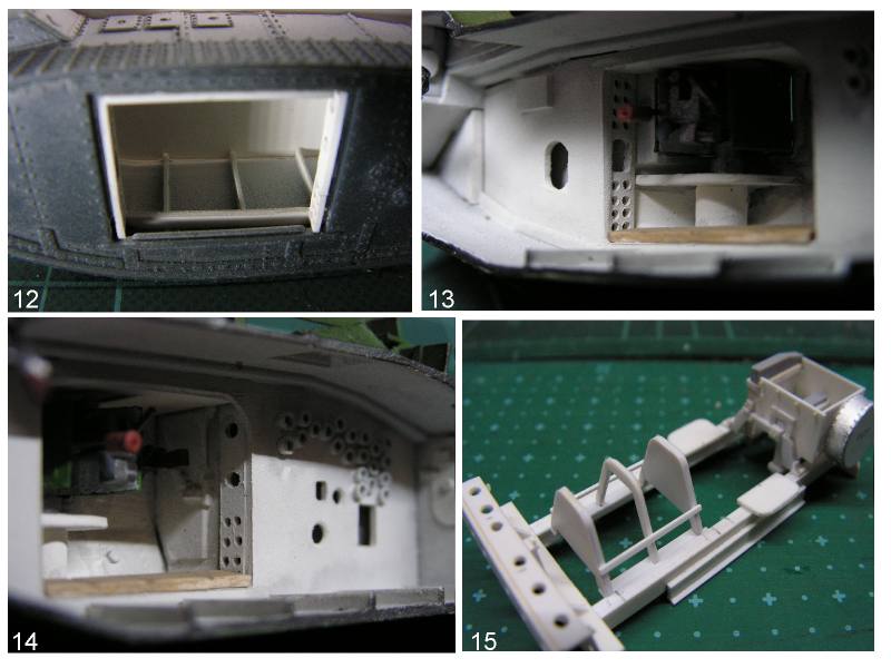

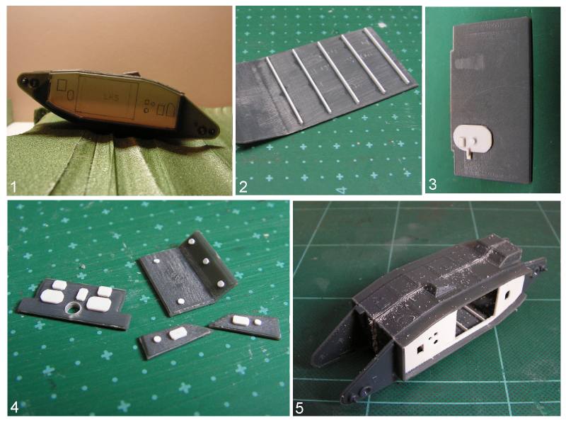

Part Fifty: Lining out the Inner Hulls.
Photo 1 illustrates the basic inner hull wall and this picture was taken way back as you can tell by the completely bare ground work! This is actually the full hull model “Rumblebelly” fitted with the cardboard stencil which would later be used to cut out the plasticard bulkhead. Before “Iron Rations” could get to that stage however, a lot of added details would have to be put in first. Photo 2 shows the first of those details, a series of angle iron re-enforcing beams which form part of the actual framework of the MkIV. These beams provide the bolting points for the floor armour plate and were made here from the 0.5 x 1.5mm styrene strip by Plastruct (#90723). In actual fact you might notice the not too deliberate mistake in this photo. I glued those strips down as a perfect fit to meet the kit hull sides – forgetting that the kit hull sides are the exterior walls! As you will see in Photo 5, the interior walls are about 5mm further in! Fortunately the odd 5mm at each end trimmed off quite easily using the safety razor blade. Also visible in this shot is the sanded floor section itself, the result of sanding off the raised moulded lettering which quite a few of the interior faces had on them.
Photo 3 shows the rear hull panel with the added rear hatch, complete with its associated vision slots and locking catch. The slight marking in the rear panel at the top is the back of the moulded air extractor louvres on the outside of the tank, this was very useful as it provided the perfect positioning for the big circular fan housing which was built up onto the inner chassis as seen in Photo 15 below. In Photo 4, you can see the four sections of the driver’s cabin, again fitted out with the various vision slits and hatches together with more revolver ports. (There was hardly any part of this tank where you couldn’t get shot at by the crew!) The front panel has the two large rectangular panels which are the insides of the opening armoured ‘windows’, the smaller rectangles are the polished metal periscopes and the circular slivers mark the gun ports. The cabin was then glued together and fitted to the top of the hull and the rest of the hull parts and the inner horns were added as per the first tank. Once dry, the two plasticard inner hull walls were then carefully slid into position. Being quite a tight fit (a little sanding was required here and there), they stayed in position on their own and I could simply paint the liquid poly around the outer edges to weld them permanently in place as seen in Photo 5. As you can also see, this is when the ‘heart in the mouth’ razor sawing also began! For the most part, this wasn’t as bad a task as I’d anticipated. Apart from the driver’s cabin and the sloped front of the tank, the rest of the vehicle has a moulded panel line right down the middle where the armour plating sheets came together. I was then able to pencil in the front and cabin lines and very carefully, using the Exacto Razor Saw with the extra deep blade (3cm) I gently sawed along the lines cutting through the floor bars at the same time. I have to admit that I was pleased with how it went, if you look back to Photo 4, you can see there is a revolver port right in the middle of the rear of the cabin wall, when the two halves finally came apart as in Photo 6, there was exactly half a port still glued on each side!BigGrin After cleaning up the edges of the plastic hulls I could then begin on the extra bits on the inside of the hull bulkheads. As you can see in Photo 7, this involved a lot more drilling out of holes! Being a male MkIV, a lot of the inside bulkhead space is taken up with 6pdr ammunition stowage – the damned things are everywhere! Careful examination of the reference books was required here as the two halves of the tank walls are not symmetrical. The shell lockers were formed by first marking out in pencil dots where each one was located and then drilling it out with the pin vice before cutting a tiny length of aluminium tube with my micro tube cutter and then gently push fitting that into the hole, getting it to lie at the correct depth and finally securing with a drop of super glue cocktail-sticked in from behind. I should be grateful though, by 1918 that pedestal under the 6pdr was encased with even more shell lockers!Crying
Now to the sponson Lewis guns mentioned last instalment. Many (many) years ago one of my early kits (so early in fact it was mostly made up unpainted!Blink ) was the Airfix 1/72 British MTB and during one of my hunting expeditions to the old garage workroom looking for spare parts I found a sprue with loads of MTB parts on it. Since there were torpedo launchers on this sprue and my old model has all four launchers on it, there must have been a second kit from somewhere though I can’t remember ever having had two of them! Anyhow, as you can see in Photo 8, I had a twin Lewis gun mounting still attached to that sprue, painted in 30+ yr old Humbrol matt black by the look of it! For Airfix these are quite basic looking components (though useable, and this meant the even older collection of Airfix biplanes which I had gathered together from their dusty attic shelf didn’t get cannibalised after all!)BigGrin Photo 9 illustrates the stages of converting these old guns into something a little more accurate for the MkIV’s. At the top is a single Lewis, separated from its twin with the connecting bar cut away and filed down. Next the barrel was cut off from just in front of the ammo drum, (Lewis guns used in situations where there was a source of fast flowing cooling air, ie aircraft and fast MTBs did not use the tubular outer jacket but had an exposed inner barrel, hence the search for WW1/2 biplanes!) The end of the barrel stump was drilled out to accept a length of brass rod which then passed through one of the glass beads as used in the full hull version and an identical length of copper tube, chamfered down to produce the outer barrel jacket. The only thing I didn’t think to add at the time was the canvas bag attached to the side, which caught the expended brass cartridges so they didn’t end up jamming some mechanism in the belly of the tank, and also must have reduced the cordite fumes a little too. I might have a go at tweezering a bag in place later. The first test fit of the finished Lewis into the sponson ball mount can be seen in Photo 10.
Obviously, with an inner and outer hull wall, there is a gap or space between them. At the front of this space are the big return sprockets for the tracks together with a drinking water tank and the Commander’s locker, (the MkI also had its petrol tanks in there too!)Crying In the rear space is the final drive chain, gears and sprockets which actually drove the tracks around. Where the spaces met the sponsons there was – yet more ammunition stowage! These however didn’t have projecting tubes but were sunk flush with the wall panels (thank you Designers!!) In Photo 11 you can see these panels set into the hull spacing. The placement and shapes of these holes sometimes varied between male and female tanks and different manufacturers but essentially in Photo 11, the left hand section points to the rear with ammo stowage at the bottom, secondary gear position in the lower, bigger hole, and an oil tank lubricating those gears at the top. The forward panel on the right has 6pdr ammo stowage and Lewis Gun Ammo drum stowage in the big square hole in the centre. There is also a flat panel overhead, which is shown in Photo 12, also shown is the gap at the bottom between the two hull walls. This was covered in with removable wooden flooring panels, which allowed the sponsons to be unbolted and run inwards, reducing the width of the vehicle to fit through railway tunnels. Photos 13 and 14 illustrates all these bits coming together after a good spray with white car primer. Its starting to look nice and cramped in there now!

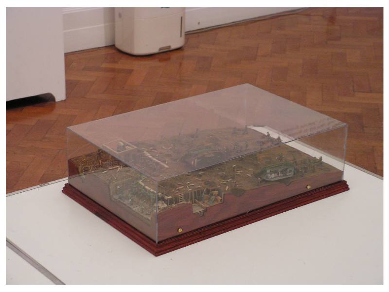

The finished diorama went down very well with the public, I must admit. Shortly after the actual Centenary, Plymouth City Museum held a couple of very successful 'Bring and Tell' days held in the Great War Exhibition Hall in which people could bring their family heirloom items in and have them identified and tell their background stories. Having met the organiser beforehand I was invited to bring the model and my own 1914 SMLE rifle in to demonstrate. The two photos below were taken during the setting up. Both items went down very well with the visiting school parties (especially the rifle once the bayonet was attached for some reason!BigGrin ) There were some really interesting stories from the public too. One of the families were the grandchildren of one of the very few survivors of HMS Hampshire? (the ship that went down with Lord Kitchener on her way to Russia), a very graphic description of the sinking it was too!
Many thanks to you all again and I'll keep trying to get this blasted thing working properly (damn your eyes Microsoft!!)Crying

Sounds like you had a great time Robin and the dio looks fab in its case... Very well done...

Looks fantastic in the case, superb work!!Love Drool BigGrin

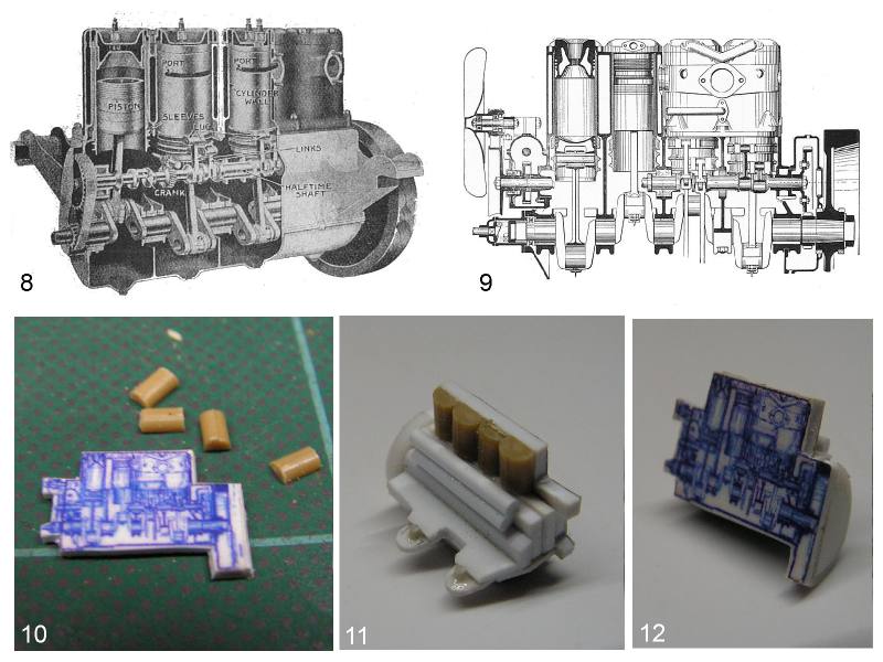

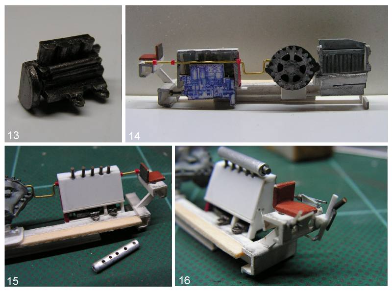

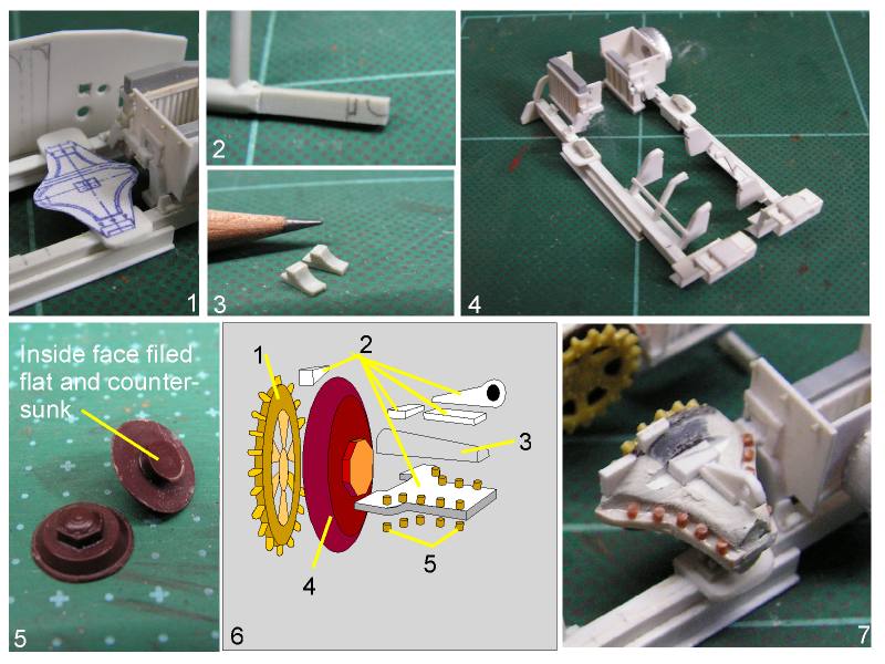

Part Fifty One: The Differential and Daimler Engine.
The first photograph Photo 1: shows the paper template cut out for the huge Differential Gearbox thingy which takes up nearly a quarter of the rear section of the MkIV. This thing takes the main drive shaft via the first gear box (coming later) and somehow transmits the power to the drive sprockets inside the rear walls of the hull through two axles, which pass through the inner hull walls. The template was taken from a scan of the Bovington MkIV plans, which I kept reducing on screen and printing off until they were just right. The lines which pass across the body of the Differential, mark the coolant pipe which passes back to the radiators. As you can see in the photo, the ends of the Differential are resting on a couple of plasticard platforms. The Differential itself needed to be raised above the level of the chassis on two curved supports which sit on top of these platforms.
Photos 2 and 3 show these supports under construction. Spare kit sprue was used to form them, in Photo 2 the round sprue has been filed down into a rectangular profile and the shape of the supports drawn on in pencil. The following Photo 3 shows the supports after they were carved and filed to shape. The sloped curves were done first whilst they were still joined to the sprue and then the step was filed down after cutting the body of the support off. They were then glued to the platforms and four tiny bolts from stretched sprue added front and back.
The next stage was the most frightening! All the work which had gone into making the chassis up to this point was now to be put at risk trying to slice the whole thing down the middle! I had intended trying to achieve this with the deep Exacto razor saw, but a few exploratory strokes of the saw soon proved that the structure was far too delicate to take the stresses involved. A trial with the rotary fine toothed saw blade also gave too much vibration so the final attempt involved using the same rotary with a very thin carbide-slitting disk. As you can see in Photo 4, it was successful, but was still nerve wracking during the process!Blink In fact, I didn’t like the cut on one end of the engine bay covers, it hadn’t gone at a dead right angle so in the end I re-made the curved bulkheads at the front and also took the opportunity to re-do the covers in plasticard sheet as the thin aluminium I’d already put on also didn’t cut neatly either!
With the chassis finally separated down the middle, it was time to make up the two halves of the Differential itself. Of all the internal parts of the MKIV, apart from the engine that is, this was probably the most difficult bit to scratch build. Everything I’d made up before was basically ‘boxey’ in nature, from the chassis struts and girders to the rectangular radiators, this thing however was composed of more compound curves and unknown angles than the rest of the tank combined! After trying a few trials with shaping plasticard and even wood, I decided (or was forced, to be truthful) to try and make the thing up out of a variety of odds and ends with a liberal coating of Milliput thrown in for good measure. Photo 6 shows the basic design but first to Photo 5 for the ‘core’ onto which everything else was fixed! The two core sections were going to come from an old ‘Sky Crane’ helicopter made many decades ago (and sci-fi’d up a bit!), they were the engine air intakes I think but they were a little oversized unfortunately. I then found something else, which needed more work but at least had the correct diameter which you can see in Photo 5. These two objects are actually the wheel nuts from an old Lindberg unfinished kit of a naval cannon (like those on Victory in fact). It was probably about 1/12th scale. I have another of their kits, un-started and still in its box out in the old workroom, this one of a Civil War era Gatling Gun. I’ve had a project planned for that one lasting many (many) years, of using the kit parts to fashion the carriage in real wood and the gun itself in soldered brass – maybe one day!
Anyhow, the wheel nuts shown here first had their protruding locating pins on the rear filed away and then the flat face thereby created, was carefully drilled with a large drill bit to produce a counter sunk ‘depression’. Into this sunken dish would later go a drive sprocket wheel from a 1/72 Airfix German tank (1)(another never made kit, I assume its German due to the Afrika Korps sand yellow plastic, plus it looks more German than Allied!) Back to Photo 6 and here you can see the complex make up of the Differential. Into the centre of the altered wheel nut was fixed a shaped plasticard ‘platform’, (2) the real gizmo was cast in two halves and bolted together through the edge flange, this platform will eventually be that flange. On to the platform was glued two tapered sections of kit sprue cut in half lengthways to form the shaft of the machine (3). Once all was set hard, Silver Grey Milliput was mixed up to model the overall shape of the Differential body, encompassing the sprue and flaring out to meet the wheel nut disk. Once satisfied with the basic shape of the body, the Milliput was left to begin to harden off and once it was stiff enough, the edges of the putty were sliced back, removing a thin strip which forms the flange mentioned earlier. This was finished off with twenty tiny little bolts cut from a length of stretched sprue and super glued into place (5). Finally, the rectangular bits and pieces were cut from plasticard off-cuts and glued in position after gently filing a flat face into the Milliput where they had to fit (2). The Differential half shown here is the left hand side, the right hand one which is shown in the following photos, was not so detailed fortunately, it doesn’t have that curved bit with the hole in on the top! Apparently it’s a linkage to one of the levers up the front which locks the Differential for forward travel. Those links only feature in the left hand side – Yippee!
In Photo 7 you can see the left hand side before its final sanding and painting with the other side showing off that Tank Drive Sprocket.
Now came the damned engine!
I had gathered various pictures of the Daimler Knight 105hp engine but even with all of them to ponder, the overall shape of the thing was still uncertain in areas, especially the lower parts! Fortunately, in the case of cutting the thing in half as in this model, once the engine was in the casing you could hardly see any of the inside face of it anyway. It was just my passion for cramming in as much detail as possible which made this part seem so difficult. What I did find on Wiki however, which proved really useful were these two ‘free to use’ photos. Photo 8 was a semi cut a way view, which would have been perfect except that it wasn’t ‘side on’. But Photo 9 was an engineering drawing of the ‘guts’ of the motor, which gave me an idea of how to make the thing in miniature!
The first job was to save the photo of the section drawing as a jpeg and then, using the old faithful Corel Printhouse program, reduce the photo down, printing off plain paper copies until the size was just right to fit the engine bay at the forward end of the chassis. Once correct, the photo was duplicated and reversed to provide a left and right version and then the two photos were printed onto Inkjet Clear Decal sheet. The right hand side is shown in Photo 10, this was after giving it a couple of coats of matt acrylic varnish before cutting it out and applying it to a sheet of thick plasticard. Once fixed and dry, the plasticard was then cut and trimmed back to the decal leaving a flat face with the internal details of the engine. Also seen in this photo are four pieces of kit sprue which have been filed down into half rounds (before cutting into individual lengths), these will form the back edges of the four cylinders on the reverse side of the engine. This can be seen clearly in Photo 11 where the basic shape of the engine body has been built up with simple ‘slabs’ of plasticard glued at right angles to the back of the decaled face. The half circular part at the top left in this picture took a little working out until I arrived at a simple solution – one of those free ball point pens that come with charity letters was just the right size so I simply sawed off a short length of the barrel and then cut it in half. After gluing in place, the hollow interior was filled with a double thickness of plasticard cut to fit. The final engine body can be seen in Photo 13, painted first with Citadel Bolt Gun Metal and then dirtied up with a Citadel Skaven Brown Ink wash. It looks quite believable in this photo, it’s a real shame you can’t see any of it once it’s on the chassis!Blink
In Photo 14 – it’s on the chassis! As you can see in this and the final two photos, the engine bay cover has been replaced, the old aluminium foil original having been changed for a stronger plasticard version. You can also see the ‘business’ end of the Differential, also given the Bolt Gun Metal and Ink wash treatment plus some subtle drybrushed silver highlights. Also visible is the brass rod starting crank which passes from beside the driver’s chair, back through the engine bay over the top of the Daimler and back to the front of the Differential where it is bent into the shape of the starting handle. The little red bits, which form the various pulleys and universal joints, are tiny slices of electrical wire insulation, threaded on from the front end and pushed back down the rod into position. More on the starting crank system in the next instalment!
Photo 15, from the other side, shows that plasticard engine cover again, this time with five stretched sprue pipes going down through the pre-drilled holes along the join of the two plastic sheets, which form the engine cover. These vertical pipes sit on top of the horizontal pipe work seen in Photo 11 (well most of them do!) These are the take offs for the cooling system which runs back through an overhead pipe to the rear radiators and the large connector pipe can be seen laying on the floor in the foreground. This was a length of aluminium tube with matching holes drilled through to take the sprues. In the final picture, Photo 16, the coolant connector is in place on top of the engine with an end cap from another bit of sprue glued in the front, the pipe back to the radiators will soon be seen out the back. Also visible at the front of the chassis are some of the driver’s controls, the main gear selector, the throttle, the ‘Advance and Retard’ and the starter motor selector. I’ll go into their construction in the next instalment.
