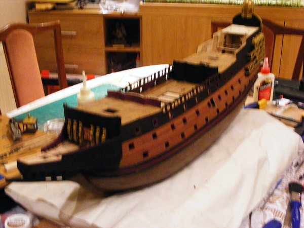

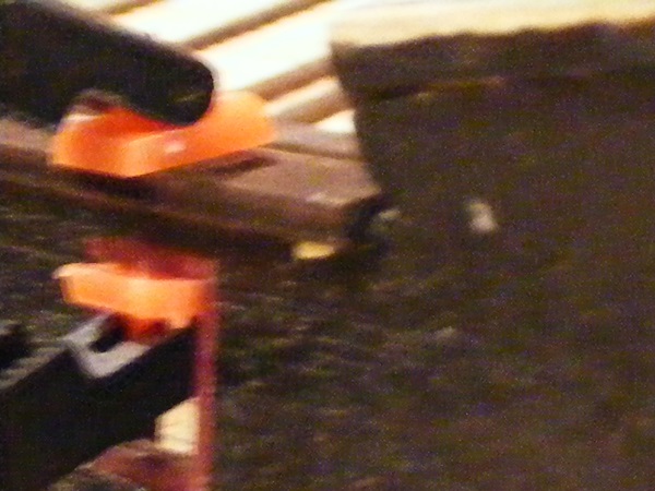

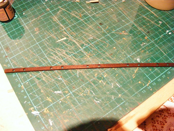

Made a start on issue 64 and the first thing to do was to finally adjust the height of the bullworks on the main deck.... After cleaning up the base strip of the railings I then gave them 2 coats of walnut stain. When dry glued and clamped into position ensuring they post holes lined up with the port spars. Also ensured the base strips protruded the hull by 1mm..Cool Cool Moved onto staining the uprights... instructions say to stain sapele but I wasn't too keen on this so decided to give them 2 coats of medium oak instead and am happier with how it looked...
#2124 Posted : 23 November 2013 23:07:26

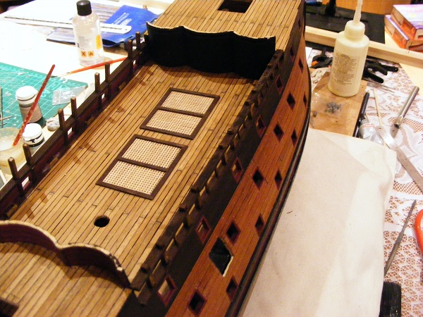

Took the two oak stained 3 x 3mm strips and cut 20 pieces each of 20mm in length. Glued these into the locating holes in the railing base.... found this to be a very neat fit indeed and caution needs to be taken not to use too much force in inserting these posts.....Blink Blink Blink .. While drying I cut out and stained with walnut the upper railing strip after cleaning off the ash... did a dry fit and a big word of caution here, the strips are very fragile around the locating holes so do not force the uprights into the locating holes or disaster will occur.... I was a little too heavy handed and snapped it in two Cursing Cursing .. a little final repair work will be needed but nothing serious... Decided to take a 2mm fine square file and very gently cleaned the inside of the locating holes, this made the fit much easier and neater.... Cool Cool .. Will continue with the railing tomorrow..... Cool Cool

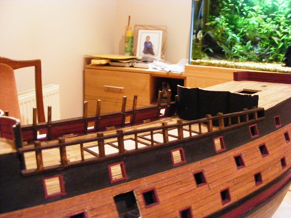

Today finished the starboard side railings on the main deck, fairly delicate work but am pleased with the outcome.... Next up is to finish off the portside.... Cool Cool ..
