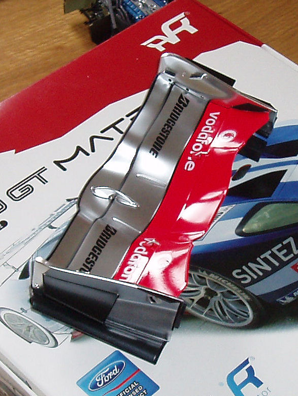

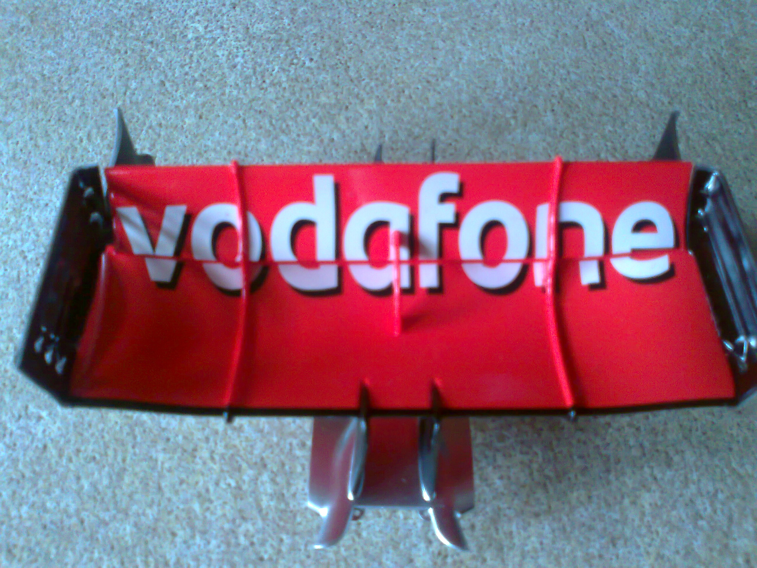

Iv sprayed the front and rear wing left i while to dry and YES they look red but not quite the same as the side cowls but better than orange as they where Confused not sure what do you all think guys
They look good, although the image is a little blurry to see the full effect and how shiney they are!

only1ianuk wrote:
A Question though, how do you get the real good shine like car laquer?
If you look at my images one of the as got a tin of spray thats all i used just did a few thin coats about 4 if i remember but let each coat dry before the next took my time and a steady hand
#207 Posted : 24 April 2012 15:59:17
Posts: 5,829
Points: 17,639
This is my 'experimental' front wing.
2 coats of Halfords clear lacquer - 15 mins between coats.
I'm happy with the finish. Forgive the naff picture - cheapo camera.
The wing is now very smooth and glossy although the pic doesn't show it well.
I want red side pods!!!!!!

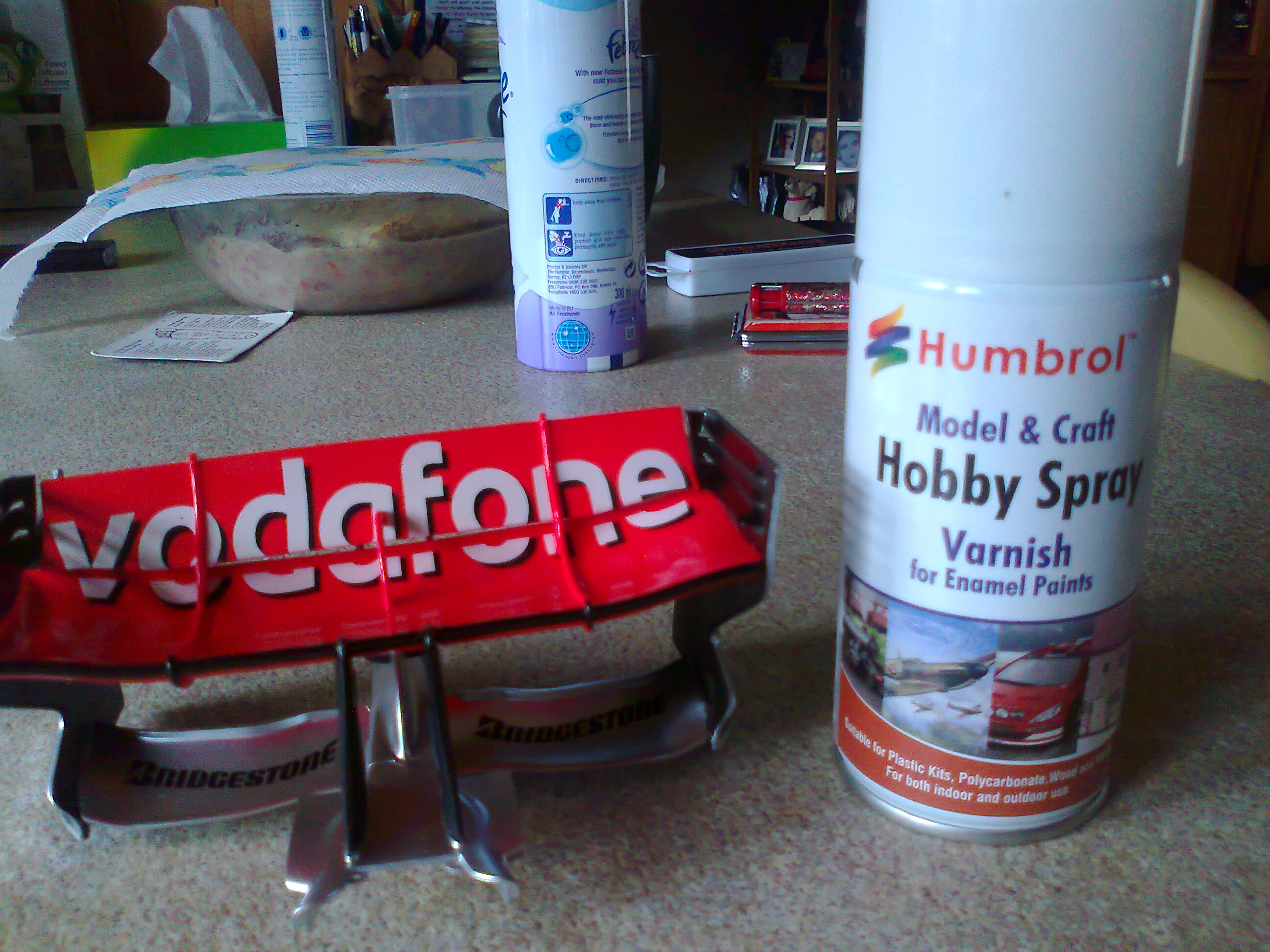

only1ianuk wrote:
Hi Roy,
I'm a real novice at spray paint but did you use anything else to get the shine or litterly just spray?
Thanks
Ian
It's just spray straight from the can.
2 light coats at around 18" distance.
The spray wasn't heavy enough to look 'smooth' on the panel - if it is, you've put too much on.
It should look very slightly 'dimpled' - as if you haven't sprayed quite enough.
Don't worry - it will 'flatten' after a few minutes, and then dry out.
Remember, if your lacquer still isn't quite smooth enough, you can always give it another coat 15-20 mins later.
If you aim for a glassy finish straight from the can, IT WILL RUN!
Several light coats will give a great gloss.
Let it dry for a few days then polish it with Micromesh.
That's what I will do as my wing ISN'T glossy enough yet!
Roy.
