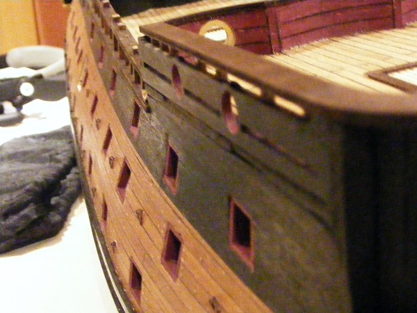

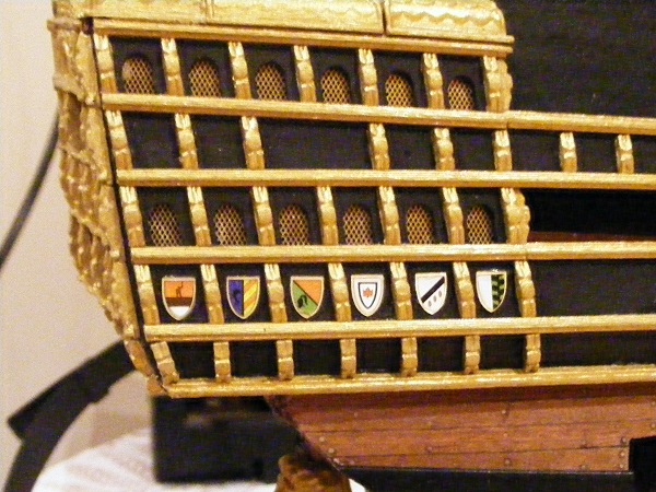

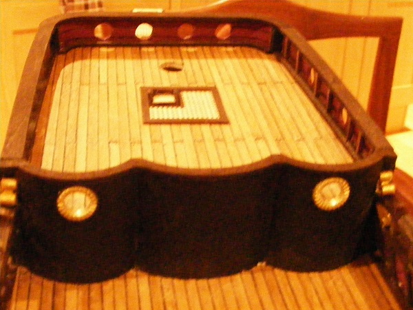

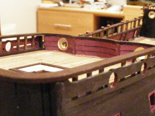

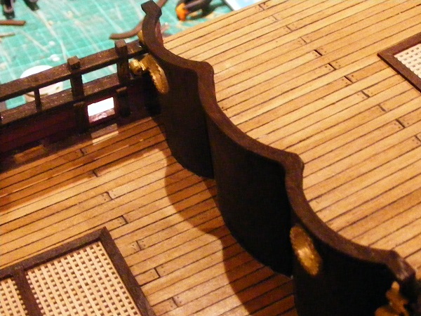

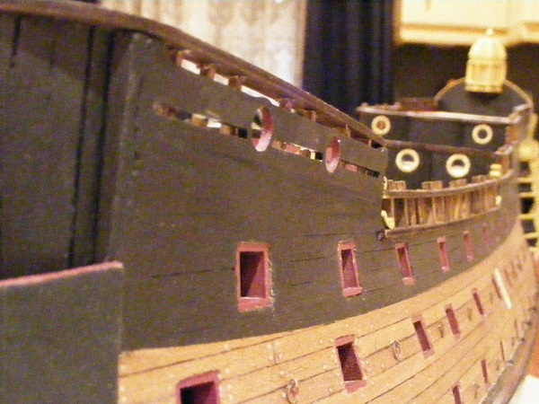

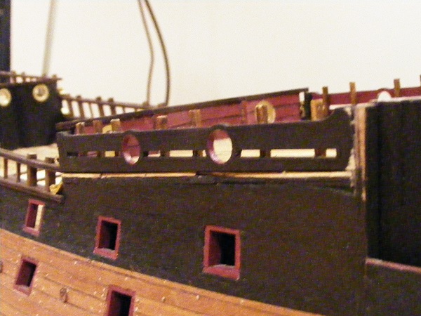

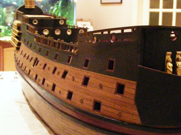

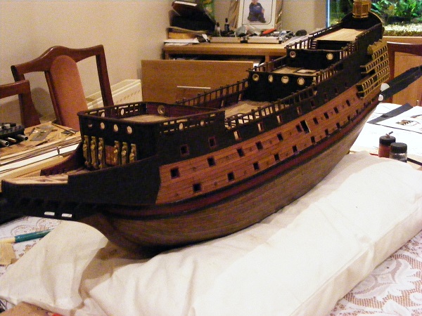

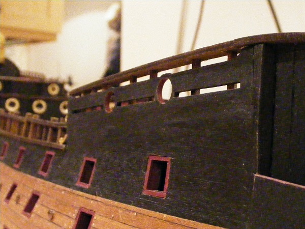

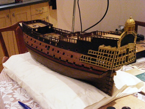

Hi all, issue 75 complete now.. Started by fitting the decals onto the brass etch shields, these were attached using Micro Set and superglued to the stern gallery. Coat of clearcote added for protection..Cool Cool
Cut all the pieces for the forecastle gunwales from the fret and cleaned all the edges carefully using a fine file.... Stained using 3 coats of walnut stain, and painted some parts using the same black and burgundy used on the hull... Cool Cool .. Uprights were cut slightly longer as I wanted to ensure a smooth line all the way round the forecastle.. these were sanded down gently to get the correct heights. Uprights were stained using medium oak...Cool Cool . Once attached, used some wood filler to smooth out the deck line that could be seen on the outer hull and sanded smooth... Moved onto drilling and cutting the 4 gun ports on the bow bulkhead, this was done starting with a 1mm drill, a round reamer and a piece of dowel with a fine grade sandpaper attached. Finally applying a matt varnish and touching up where needed.... Am very pleased with the way it all turned out....
