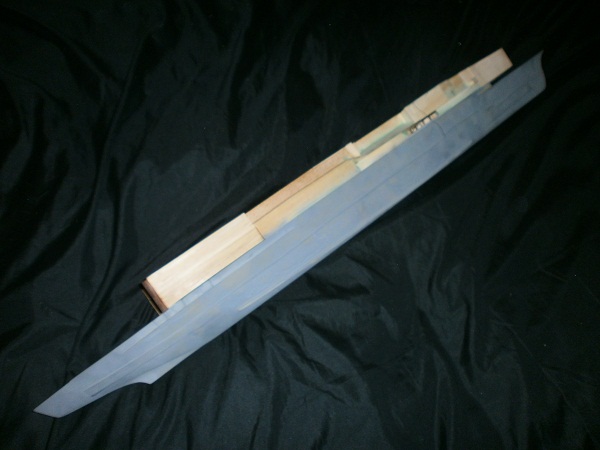

#223 Posted : 02 September 2012 20:31:12
Not much happening as im waiting for this months lift parts before i can resume the build on the hangars,but i added the bilge keels for something to do the screws and rudders will be added at the end of the build. As usssual all questions/comments are welcome

#224 Posted : 02 September 2012 23:29:16
Joined: 06/08/2011
Posts: 480
Points: 1,421
Location: Galway
Hi Andy,
looking good as always
#225 Posted : 02 September 2012 23:34:53
BigGrin Thanks Ger CCool
Yutaro HONMA
#226 Posted : 04 September 2012 02:55:29
Joined: 21/04/2012
Posts: 747
Points: 2,233
Location: Tokyo, Japan
Hi Andy
The hull and bilge keels look beautiful. I guess the painting process is closing to your Akagi. I'm waiting for next photos.
Best Regards,
Yutaro

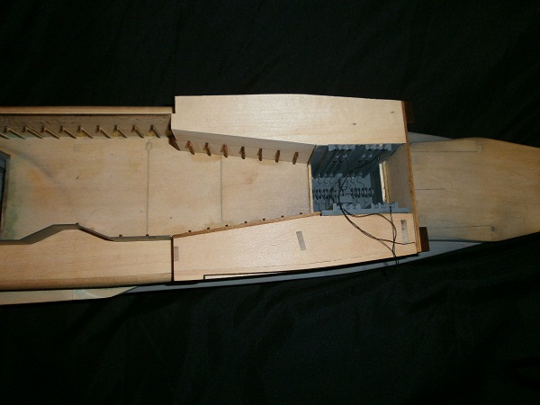

#230 Posted : 16 September 2012 10:37:28

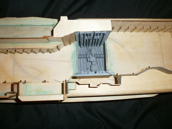

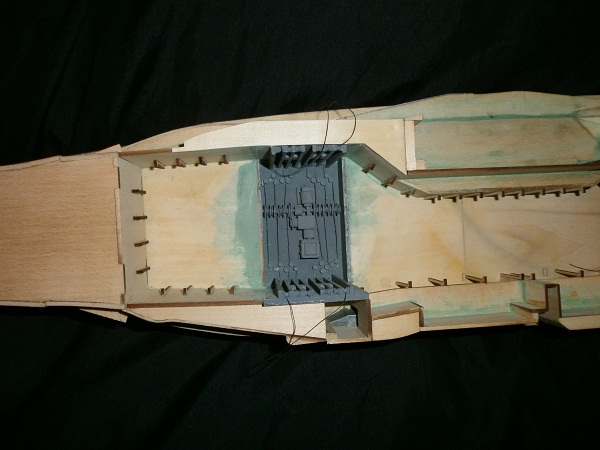

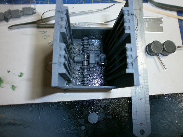

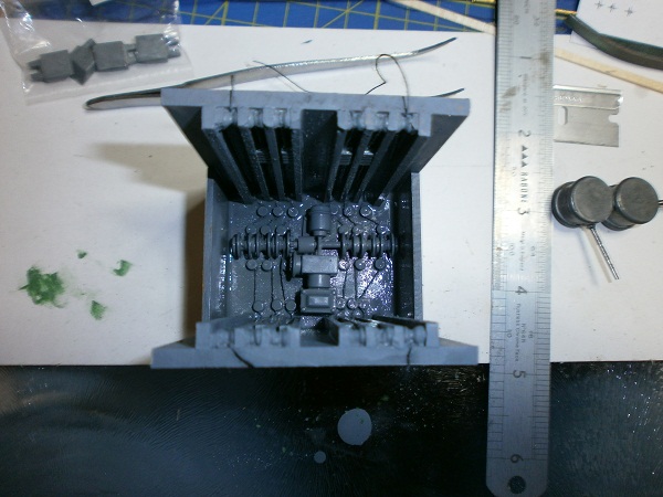

heres a couple of pics of the last stern lift]excuse the wet paint]Blink .This is the smallest and most chalenging lift to fit everything into,as space is at a premium.I had to do a fair amount of fettling on the motor components bases to get everything to fit,but as you can see it is possible to get it in with a little bit of thought.
If like me you decide to use Amati's portholes to enhance your build the 1.5 porthole count is 66 and the 2mm is 496, so you will need 1 pack of 1.5 mm[aprox 100 per pack for 1.5 and 2.0 mm]and 5 packs of the 2mm portholes,i obtained mine from CMB but this will not be cheap option as you wont see much change out of £46.00 with post and packing.
I can now continue with the fitting of the stern hangars and then some serious painting of the internal walls/floor.After that theres the portholes to add and the deguasing cable,i will be using plastic strip for this again as in my Yamato build and then more painting of the external hull.As always all questions/comments are welcome

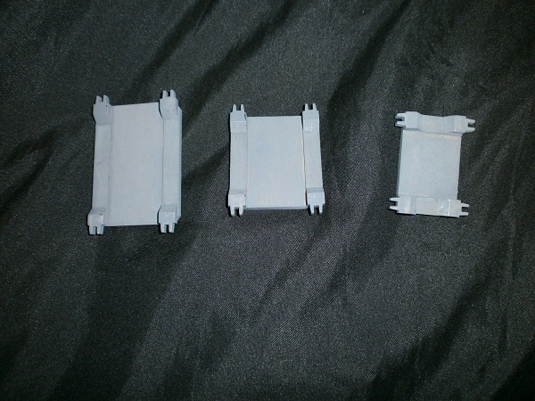

#235 Posted : 16 September 2012 21:39:55

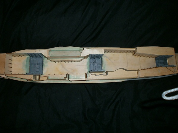

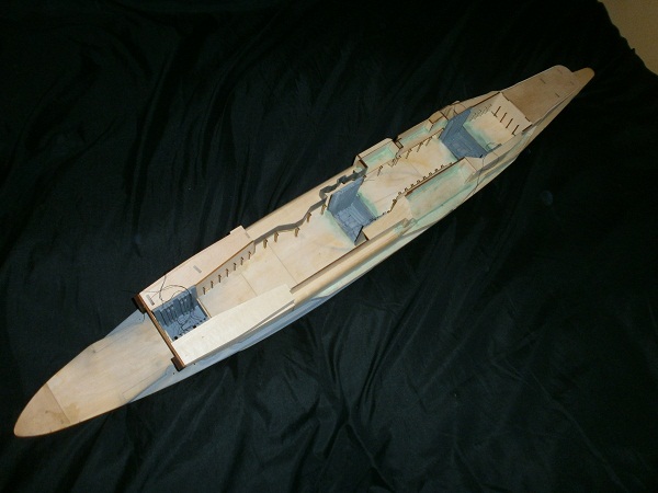

More progress to post ,i have now finished the 3 lift platforms just a bit more paint to add here.The hangars are all now in place and some of the cappings have been added some filler will be needed in places to tidy things up,next i will be busy painting up the hanger internal walls/decks then its the portholes to add.As ussual all comments and questions are welcome

Yutaro HONMA
#240 Posted : 17 September 2012 12:19:01
Joined: 21/04/2012
Posts: 747
Points: 2,233
Hi Andy!
Your work of lifts were very fine. Motors, gears and wires seems realistic!Love
By the way, as I wrote in another topic, DeAGOSTINI Japan closed this part work without showing us how to fix the floors of the lifts. I recommend you to make some kinds of stoppers for the floors.Cool
Best Regards,
Yutaro
