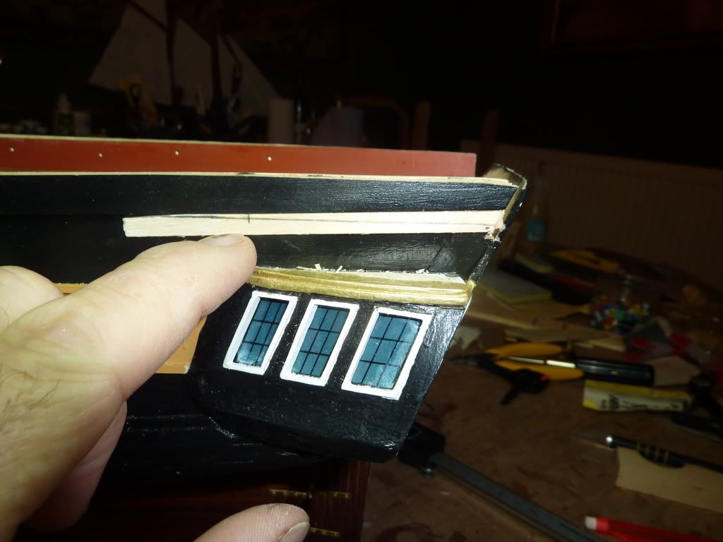

Been having a bit of trouble with my new p.c. Hopefully I will get the hang of it, I think the picture posted above was a bit of a fluke.
Anyway, after fitting the bulwarks to the inside of the top deck, I found I had to dress the height of the bulwarks down a bit, to achieve the same height from deck to the top. In doing so I ended up taking a bit of the outer upper planking, and because I had already fitted my Rubbing steaks at the top of the planking, they were tapering a bit, so the picture above shows the bit I have had to add on to keep the upper rubbing steaks parallel.

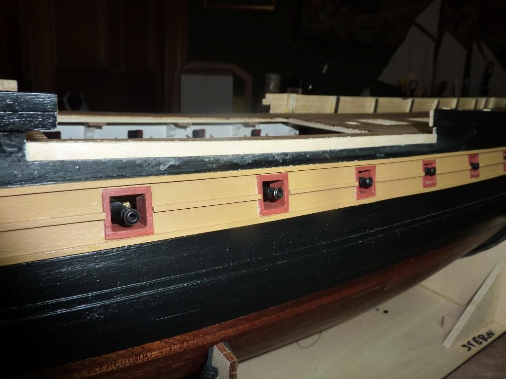

After I fitted the upper deck, I found the planking to the cut away area was not high enough, so I had to fit another plank on to gain the height required. I will sand or file to the correct height and paint.

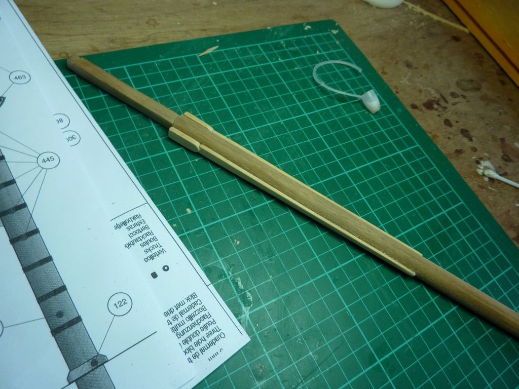

I seem to being random bits of luck with loading my pic's from the mac, But lets try again.

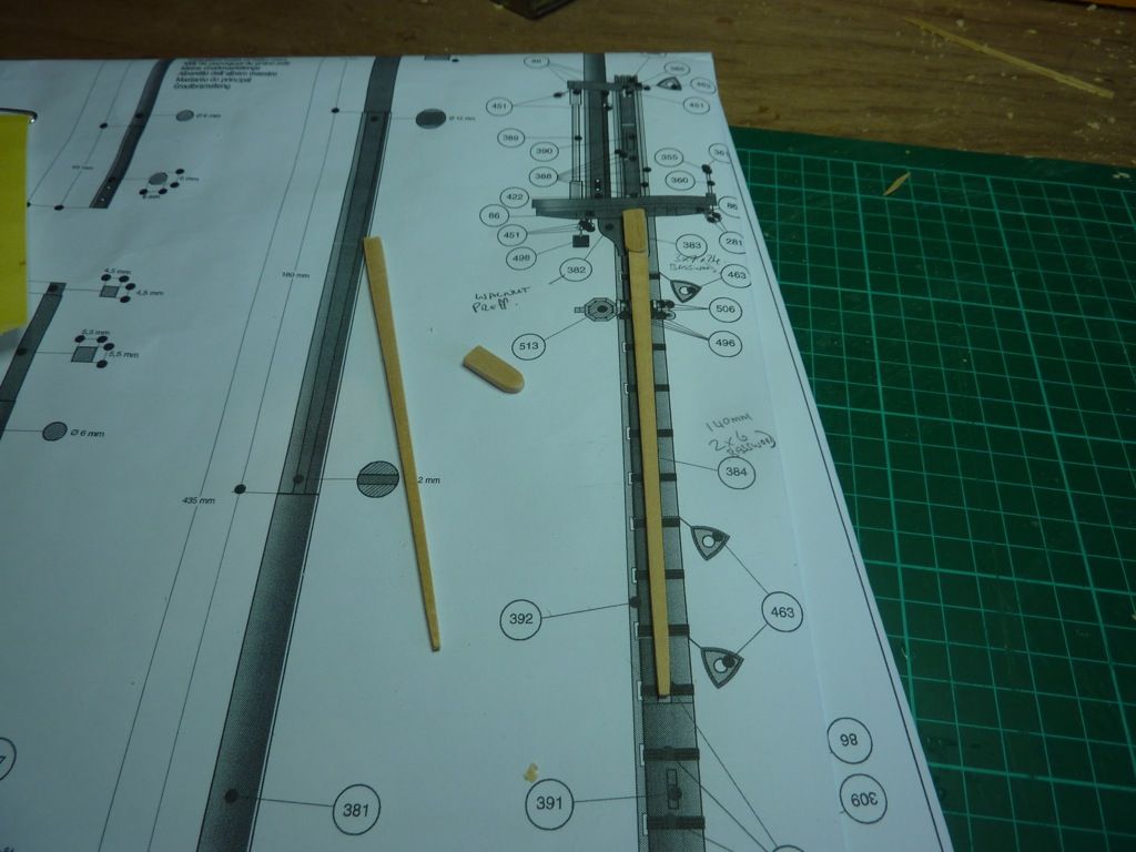

I took a break from the ship, and put some time into the masts. This was my point of getting a full size 1 : 1 Drawing I started of by fileing the masts to receive the strengtheners.
Mo

#230 Posted : 07 November 2012 17:49:46
Joined: 09/02/2012
Posts: 569
Points: 1,675
I then cut my pieces of timber checking the sizes from the plan and dry fitting.
I glued the bits on and waited for the glue to dry, I am using P V A glue for these bits.
Once dry remove the clamps, and check against the drawings.

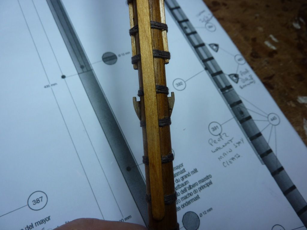

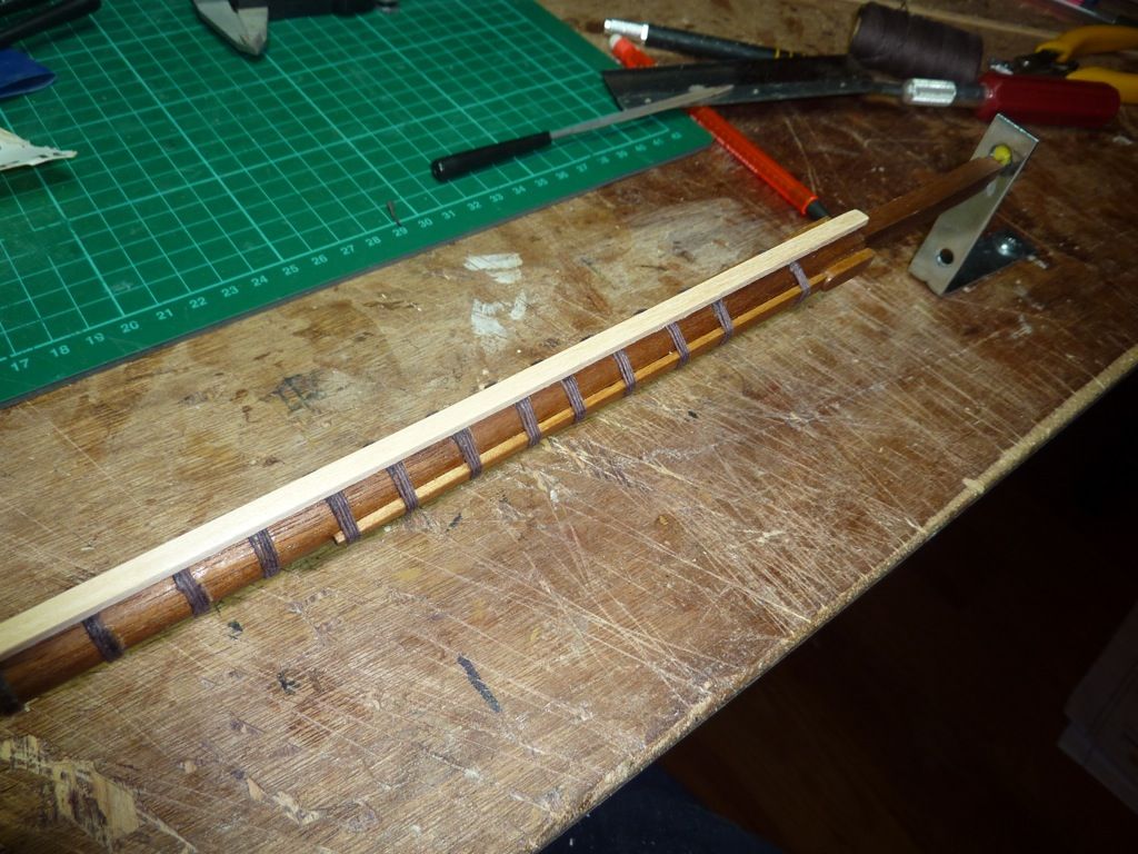

I have stained the walnut masts and the boxwood strengtheners with a coat of dark oak, I am happy with the look I am getting, It is now time to tie the thread around the masts.
I will report back soon with the rest, if I can get all this technology to work,
Mo
Mo
Mo
#232 Posted : 07 November 2012 18:23:55
Joined: 09/02/2012
Posts: 569
Points: 1,675

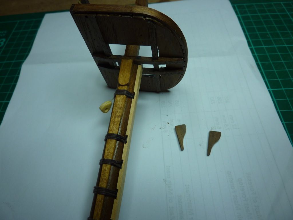

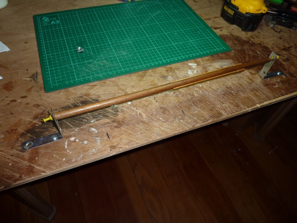

I have a bit of catching up to do to get my log up to date, Seems I have a hang of the picture's now.I made a rough contraption of a jig to hold the mast's while I was putting the thread on them.
I got a piece of planking and used it as a rod, to tell me where the thread was to go, Would not have been able to do this without a full size drawing.
I am making the join's in the thread to the front of the mast's as most of this will be hidden by the boxwood strengthener. I am glueing this all in place with super glue.
Only thing to watch out for is that in certain locations you have to incorporate in some blocks, these can be tied in as you thread the mast's
The next bit was a very tricky bit, I had to put a strengthener over the threads on the front of the masts, I had to mark the positions and cut and file out enough to accomadate the threads.
Will report back in a bit about the rest

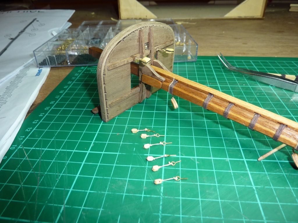

I am checking the drawings all the time, as there are other bits and bobs to go on the masts, like cleats, and there is a half round rest for the backward pointing sail, Sorry for not having the right terminology.
The next picture shows the cleets, very hard to work out which way they go on, Very short of detail on the drawings.
A couple of shots of the masts in place
Then it was the supports for the fore top.
Will post a bit more later, trying to get up to date, to a point where I am now.

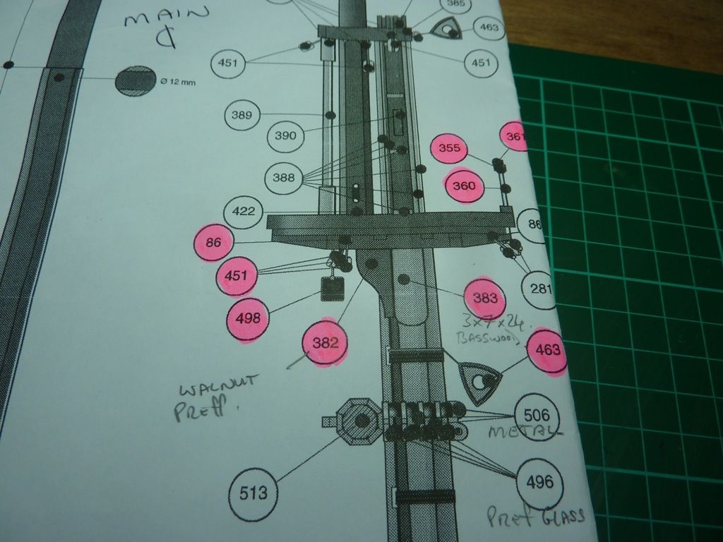

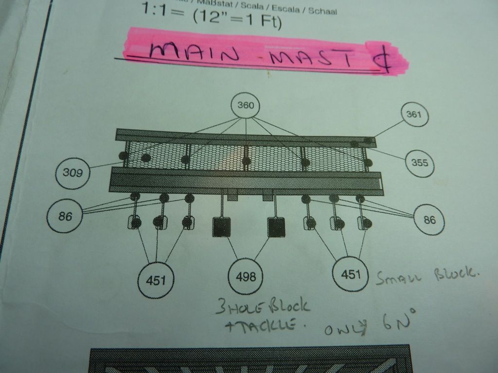

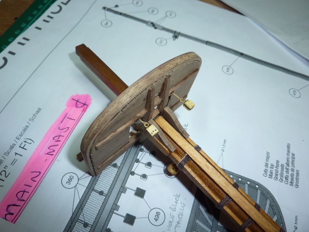

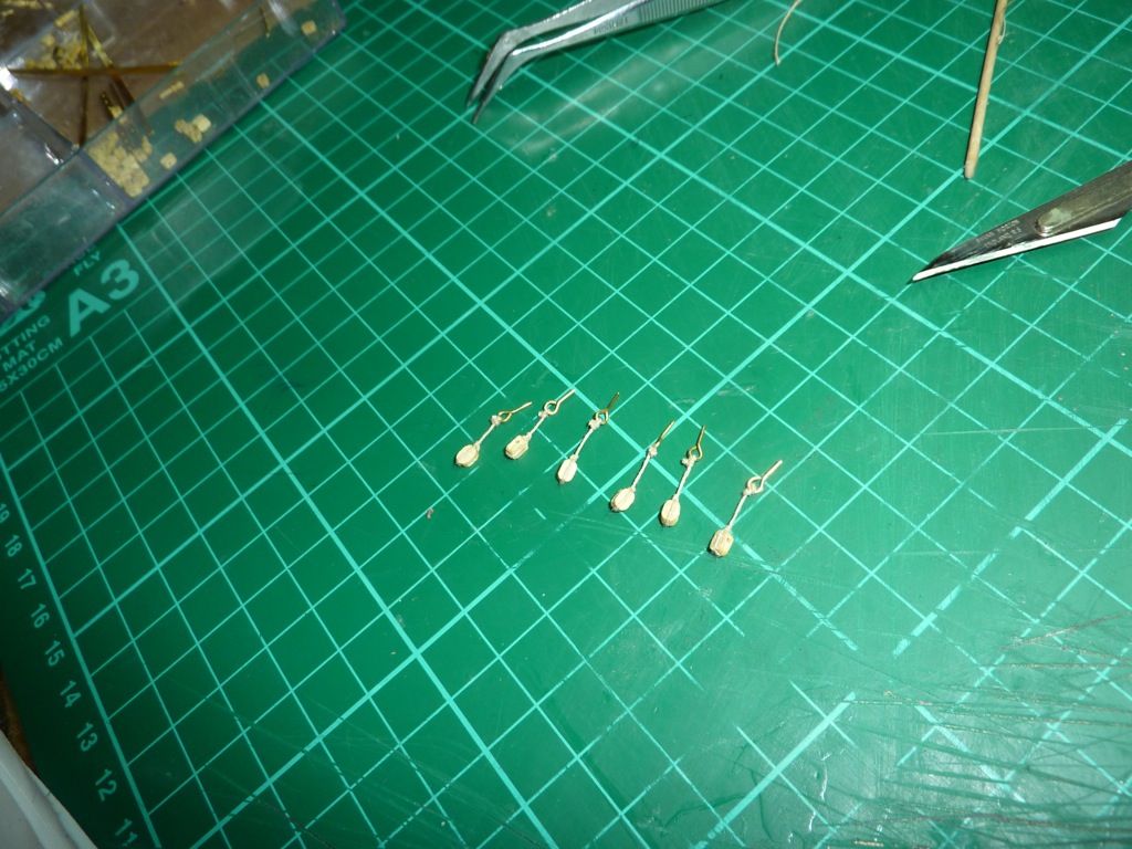

My next task was to do the blocks, this is where the real problems began, I found a real lack of information regarding these items. And any help would be greatly recieved. This first picture I am going to call the foretop front elevation.
And this second picture I am going to call the mainmast side elevation.
On the first drawing from left to right it shows, I have to fit 3 No 451 ( small blocks ) Then 2 No 498 Three hole block and tackles. and then a further 3 No 451 ( small blocks ) and to me it looks like they are all in a straight line, So that is what I have done.
But when you look at the second picture, the side elevation of the mast, at the same point, you can see item 451 with 3 lines pointing to its location, and item 498 with one line indicating its position, Therefore its fair to say that what is on the side elevation drawing, is specific to whats on each side. It make sense to me.
But I am struggling with the blocks marked 281 to the rear of the foretop. it shows 2 lines indicating to me there are 2 blocks on each side, and a 281 block is a 5 mm block and tackle, is a 281 block and tackle the same as a 451 small block. and if there are two blocks on the rear at each side are they together or separate. Sorry to be asking such intricate questions, but I just want to make the best that I can, but to do that I require the information.
Mo Confused

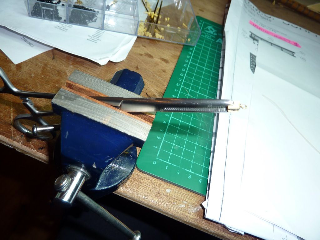

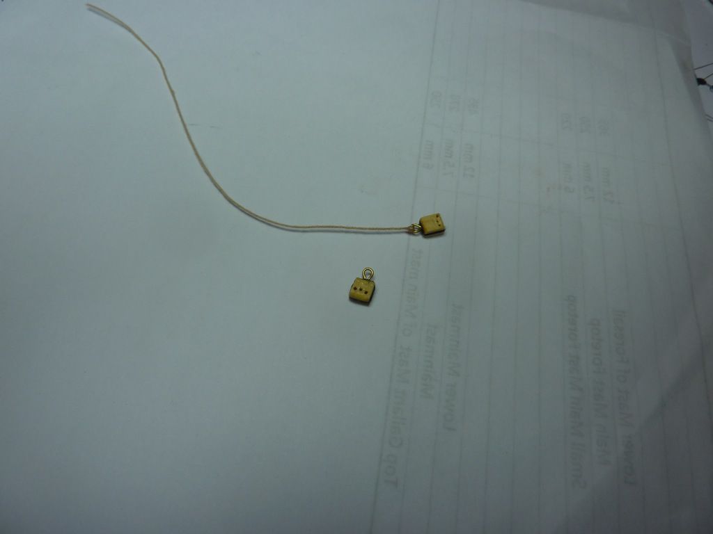

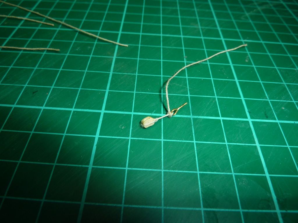

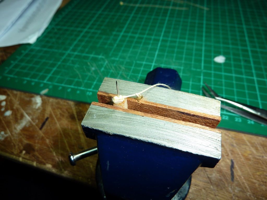

I am now tying the blocks, I found a very helpful post, under son of bulwark's victory build, he shows you how to hold the block, clamp the thread, tie the knot, etc, I have used it and it works great for me, I really did not know how I was going to do this job.
I have glued wooden pieces on to the face of the jaws on my vice, I them held the block on the pin mounted on a piece of scrap wood, I bored a hole in the wood on the jaws of the vice and that held the brass eye. This ensured that all the rope was of equal length, give or take.
That is me up to date with the log, The last few post have been quite rushed, But I am really happy how it is all coming together. I must at some point soon return to the ship and get on with the upper deck gun cut outs etc, etc.
Mo
Mo
Mo

I ment to say in my post, that when I am tying the rope to the blocks, I am doing a half hitch, putting pva glue on the hitch before doing the second half of the hitch, Thus giveing the knot a good bit of stick.
