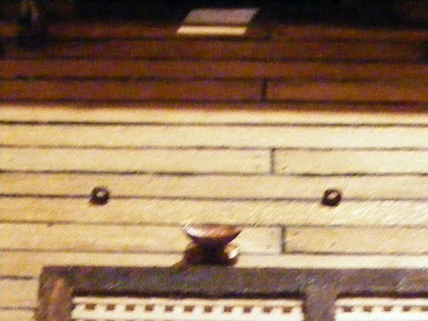

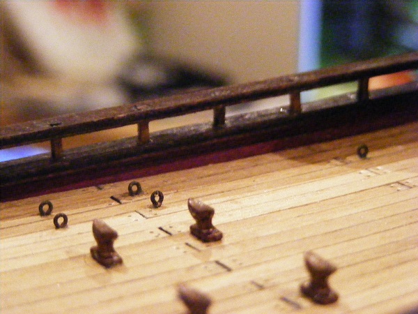

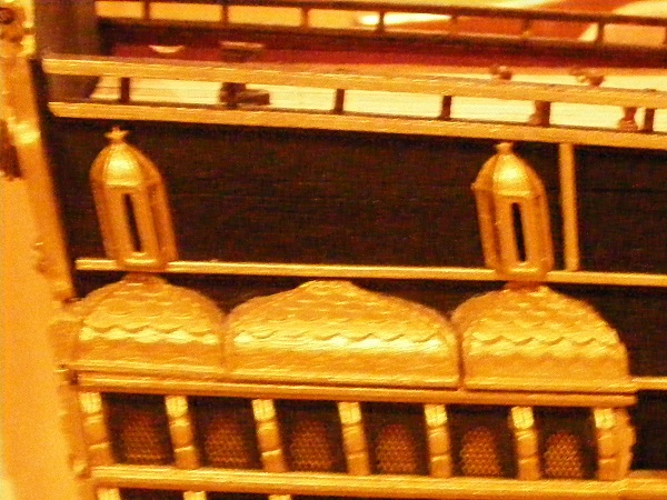

Week 90 now complete... week 89 was simply the supply of 2 cannon kits, cannons I intend to make up later in 2 batches, those for the main deck and then those for the other decks... Cool Cool .. Issue 90 was the fitting of 2 lanterns on each side of the side galleries. 9 Cleats were also fitted but here I found what I believe to be a measurement error.. Instructions say to fit a cleat either side of the quarterdeck parapets 4mm from the front rail... Looking at the mag photos, this shows the cleats in behind the first upright post on the parapet and well away from the front edge of the front rail which is 4mm wide, this just does not work. Positioning of the cleat works out to be 12mm from the front rail and not 4m.. or at least this is where I have placed them Cool Cool .. Finally in this issue, fitted 20 eyebolts in total on the decks, these were first blackened and set in place with superglue gel....Cool Cool .. Looks like issue 91 will just be the fitting of more bling... Happy building all..

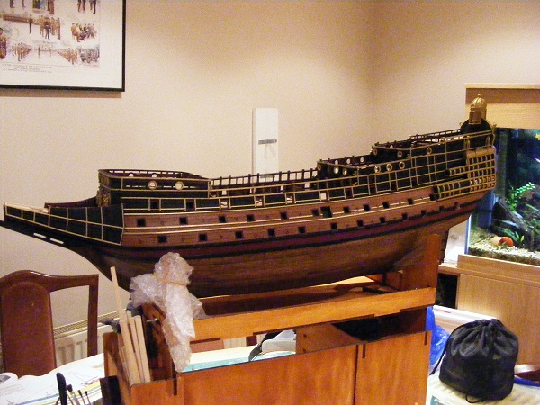

Beautiful Alan! The more bling she gets, the more majestic she looks!Cool
It always pays to double check between the written instructions and the build photos, typing errors are far easier to make than getting the photo wrong in the magazine! Even the DelPrado instructions are a little 'out' now and again!BigGrin If in doubt, go with the photo!

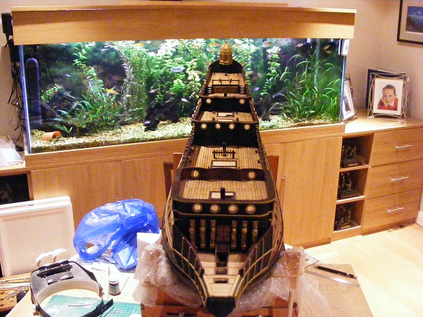

She looks more stunning every time I see her Cool Cool
Think I have spotted a great display opportunity for you. looks like she will fit in the fish tank, would be good to see her afloat don't you think BigGrin BigGrin BigGrin Blink

Thanks for your kind comments Robin, always appreciated.... They do say a picture paints a thousand words and in this case it's very true....Cool Cool .. Went by the pics on the mag so will soon see if it is the right decision.... Cool Cool .. Thanks again....
Thanks for looking in and the positive comments Jase, appreciated... Don't think the pics do the build true justice, she looks even better in the flesh.... Cool Cool .. Somehow I don't think this one will ever see water but as for your comment, the fish tank being 6ft would take the Titanic very well, that may be a better option.... BigGrin BigGrin .. Thanks again...
