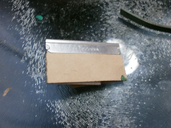

heres how i marked out the upper black paint section on the funnel,i didnt use paper as recomended but the thin card you get that wraps individual safety blades i use[i find card is a little stiffer than paper so it wont deform as u scribe the funnel].After cutting to the correct width i used masking tape to affix and ran a brand new blade around the edge'you can just see the marks in the pics

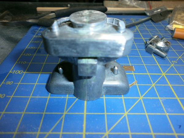

As im a little stuck with the build on the screw area i decided to do another enhancment i had planed from my reserch into the Yamato.The aircraft deck area was of a cast concreat construction but the two side areas to port and starboard over the boat hanger,where the etch grills are placed were made of a checker plate steel construction like the bow and stern with a small lip surounding the outer edges and also a central panel over the etch that is ommited from the build . I had great difficulty trying to source etch checker plate to the same scale as provided for the Yamato build but finaly found some plastic card checker plate that was as close as i could find.So the following pics show the results of a bit of scratch building of which im relativly happy with the outcome,not painted as yet but il post pic's after iv sprayed it up.As ussual all comments questions are welcome

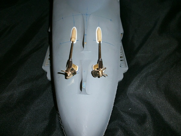

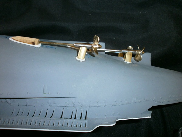

replacment pack 14 arived today posted on monday and my deepest gratitude to whoever sorted it.The templates for the screws area are photo copys on paper so the 1st job was to mount them on card with spray mount and cut out.
After doing all the measurements to the hull i proceaded with the inner set but have deviated from the instructions by adding the rivet flanges to the propelor shaft casing and shaft suports,also i have used the brass streamline tube instead of the wood provided for the shaft supports.
This involved a bit of scratch building for the suports and a lot of file n fit but in quite happy with the results so far,tomerow il hopefully fit the outer screws and then its the rudders to fit.As ussual all comments and questions are welcome

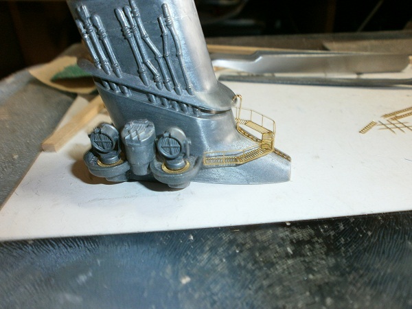

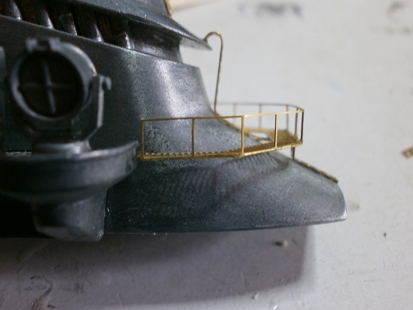

I recieved the funnel crown this month so i decided to start fitting some of the etch i have,as ussual there was a fair amount of burr to remove from the searchlights and range finders and some reshaping to the funnel crown was needed.Firstly i made up the searchlight gangway by ataching the rails then fitting it to the searchlight deck,this left the gangway hanging in thin air at the front so to speak so i used the lower ladder as a suport at the front[ i may add some side suports to this gangway later but i dont want it to look too busy there].I then added the second ladder by bending to shape and using a 2mm drill bit to obtain the top curve,finaly the upper ladder was added and the range finders and searchlights.
I then added the baffles and funnel grills to the crown shaping the grills using the rolling marble method and attached the crown to the body.The final few pics show the assembled funnel and with the 1st light undercoat.As ussual all comments and questions are welcome

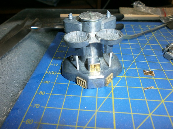

made up the stern range finder tower the usual deburring and filler was used,i also filed off the cast marks on the rangefinder top as these were not present on the Yamato.Then i made up the etch grills suplied and fitted them,i also replaced the brass wire suplied for the gunnery deck with plastic rod.Again i didnt use the wooden gangways suplied here but replaced them with the etch i have,there is also more railings/ladders to be added but they will be fitted just before the final fitting of the tower to the deck.As ussual all comments and questions are welcome.
