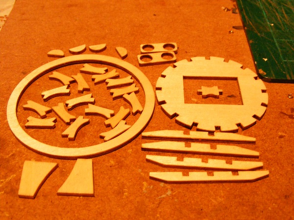

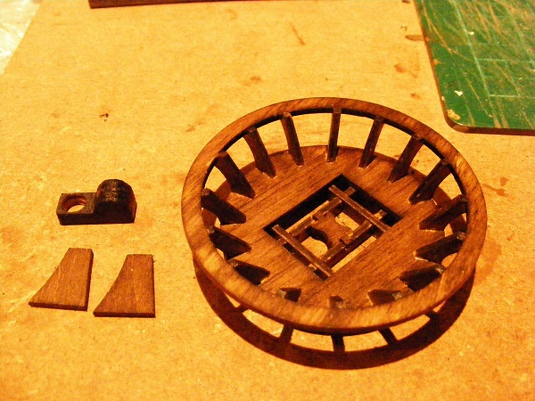

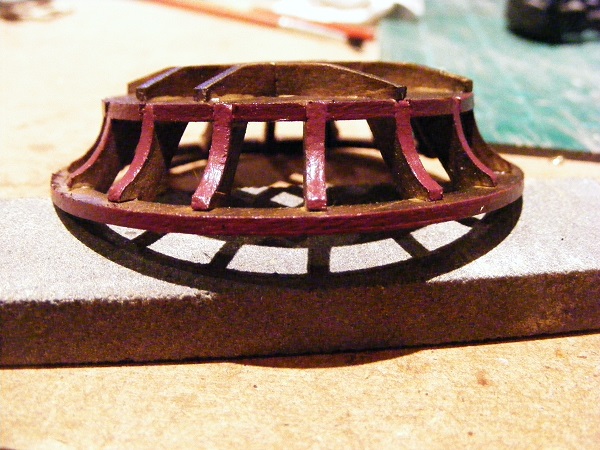

Issue 97 now well underway to being complete, this started with the construction of the foremast lower fighting top... Started by cutting all the pieces free from the fret and cleaning all the edges clear of all black ash... Glued the pieces of the fighting top together as laid out in the mag instructions, this was pretty straight forward... After applying the top ring everything was weighted down to ensure it all glued together squarely... When dry, gave the fighting top including the crosstrees and the cheeks 2 coats of Medium Oak stain.. Painted the outer edges the same maroon colour as used on the hull strip finishing off with 2 coats of satin clear varnish... Cool Cool .. All these pieces will now be placed in a marked for later use..
Next task was clean out all the holes on the 55 deadeyes and to stain them with walnut stain, it's here I may have a slight problem. Am hoping there are a couple of deadeyes spare with the issues as two I received were split in half, if not then I can always raid some of my other kits as a stop gap... Moved on to painting the mast cap 2 coats of matt black, cleaned off the supplied buckets of any casting residue, gave them a coat of metal primer followed by a coat of walnut brown paint... buckets hopefully will be completed tomorrow.... Cool Cool .. Happy building all..
