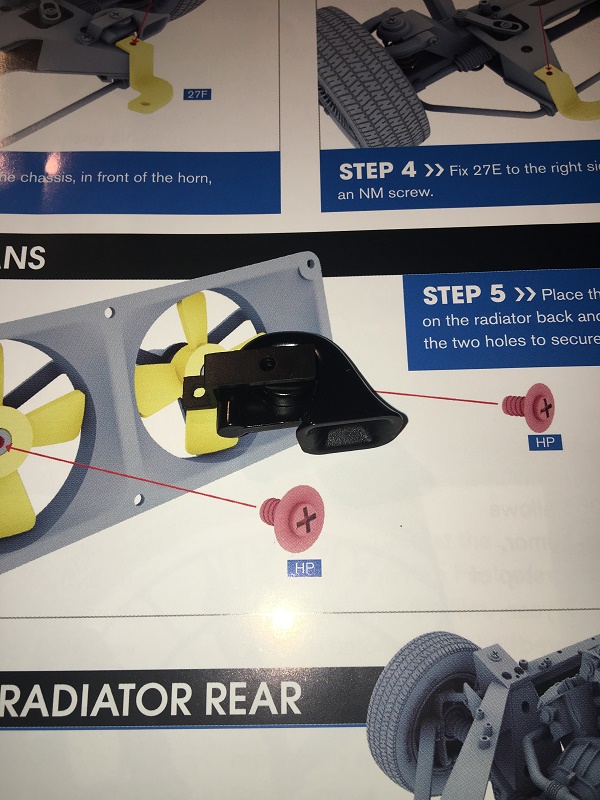

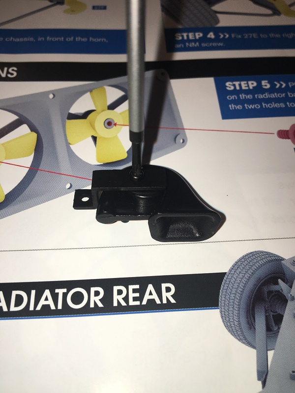

Place the horn bracket on top of the horn and secure with an GP screw. Place the assembly on to the front left of the chassis and add an NM screw.

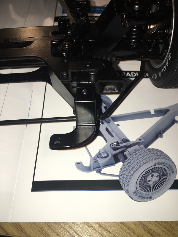

Points: 897

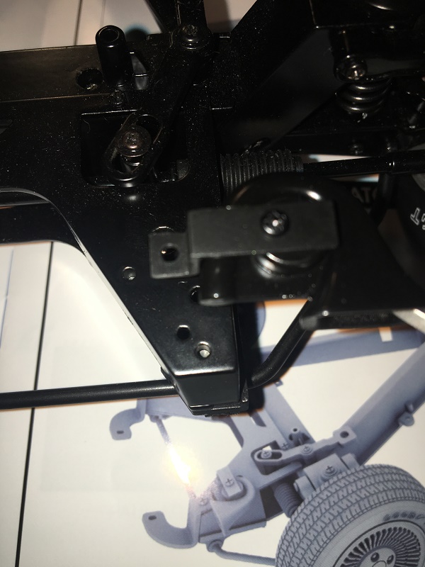

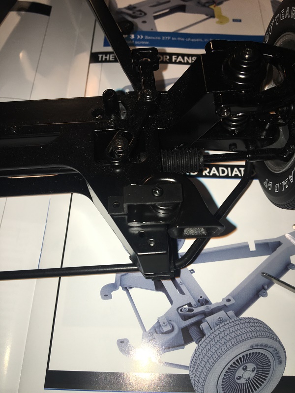

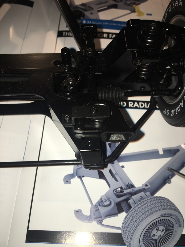

Secure the radiator mounting bracket (left) to the front left of the chassis in front of the horn with an NM screw. Do the same with the right radiator mounting bracket on the front right of the chassis.

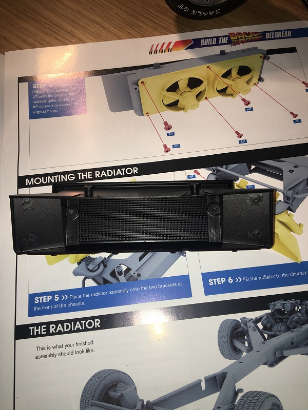

Place the 2 radiator fans onto the posts on the radiator back and secure with 2 HP screws.

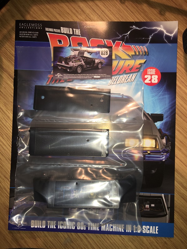

Issue 28
Parts -
Radiator Grille Back
Radiator Grille
Radiator Mount
6x AP Screws
4x FP Screws

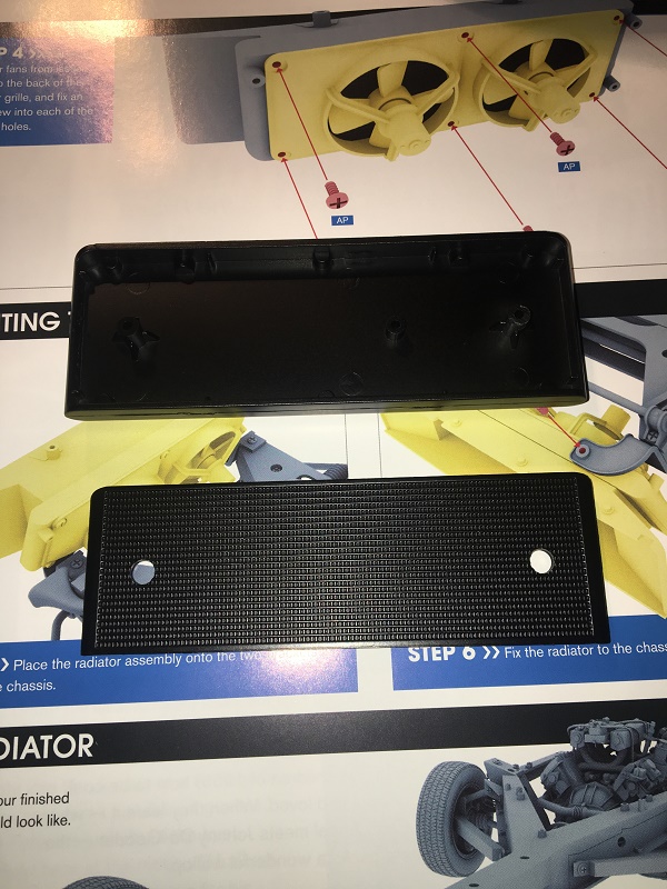

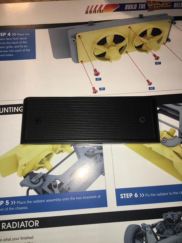

Place the radiator grille into the recess in the radiator grille back. The place the radiator mount onto of the radiator grille and secure with 2 FP screws.

Place the radiator fans from the last issue (27) onto the back of the radiator grille and fix in place with 6 AP screws.

Points: 897

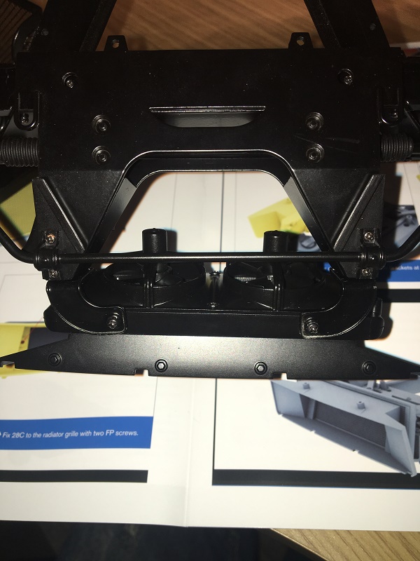

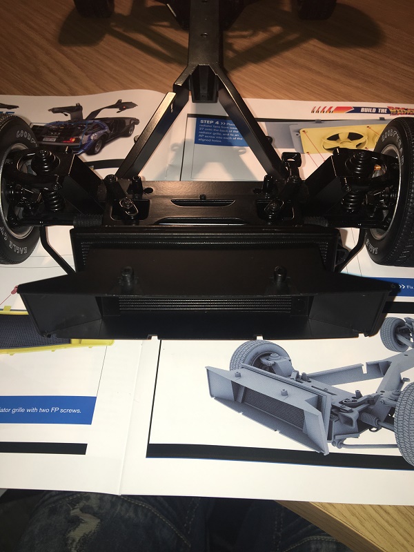

Place the radiator assembly onto the brackets at the front of the chassis. Then fix in place with 2 FP screws.

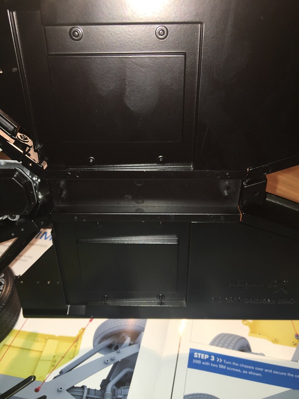

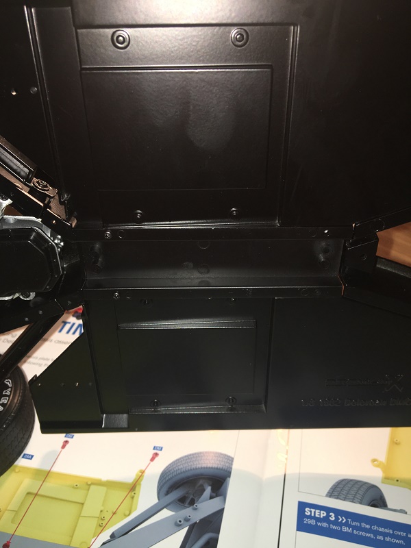

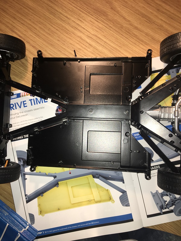

Fit the chassis plate against the underneath of the chassis and secure with 2 DM screws. Then add 4 more DM screws into the holes on the chassis plate.

Turn the chassis over and secure the centre plate with 2 BM screws (top side closest to the engine).

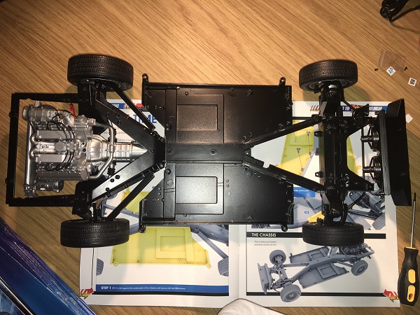

Points: 897
Some pictures of how the car looks so far and next to the Ford Mustang.

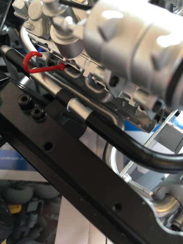

Insert the front left water pipe into the hole in the back of the radiator, then fix into the chassis with a JM screw.

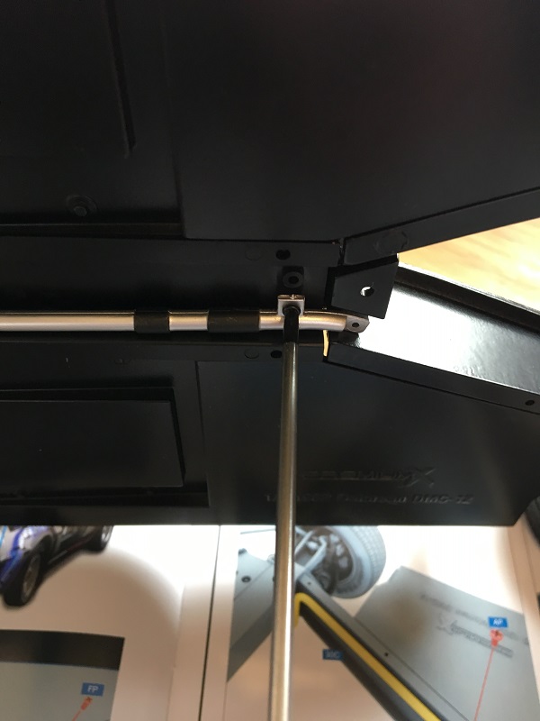

spike
#277 Posted : 25 September 2017 22:23:03
Joined: 04/07/2016
Posts: 297
Points: 897
Secure the left water rail to the underside of the chassis with 2 FP screws. Then fix the rear end of the water rail to the inside of the chassis with a AM screw.

Connect the left engine water pipe to the end of the left water rail and the water pump.

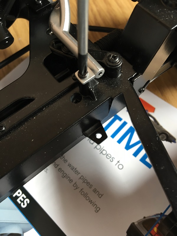

spike
#279 Posted : 25 September 2017 22:30:18
Joined: 04/07/2016
Posts: 297
Points: 897
Fit the left S pipe to the left water rail with an AP screw. Insert the end of the S pipe into the end of the front water pipe.
spike attached the following image(s):

#280 Posted : 25 September 2017 22:35:11
Joined: 04/07/2016
Posts: 297
Points: 897
Insert the split end of the front right water pipe into the holes in the back of the radiator and secure to the chassis with a JM screw.
