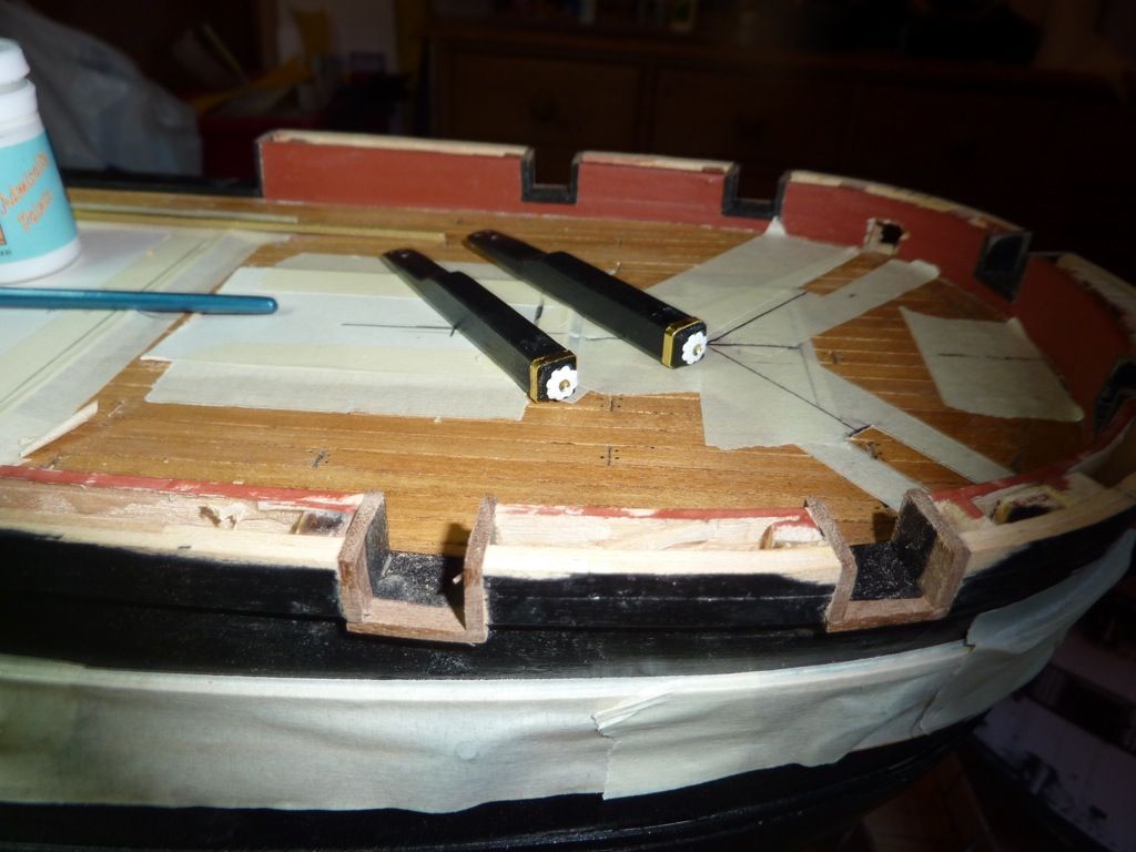

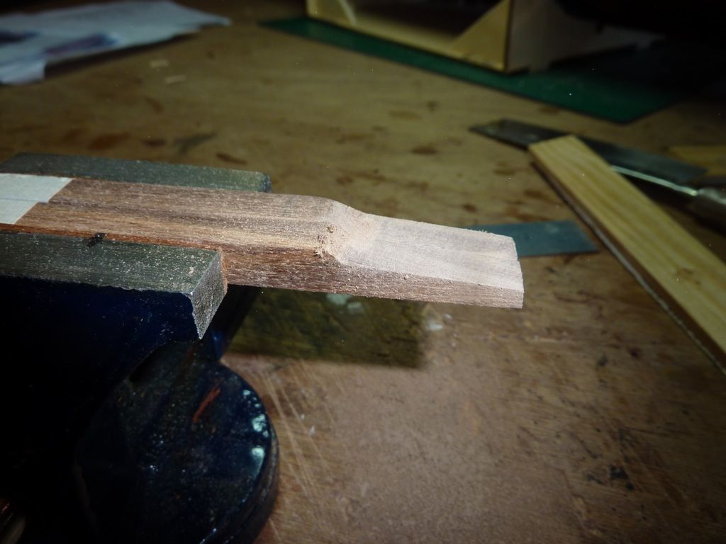

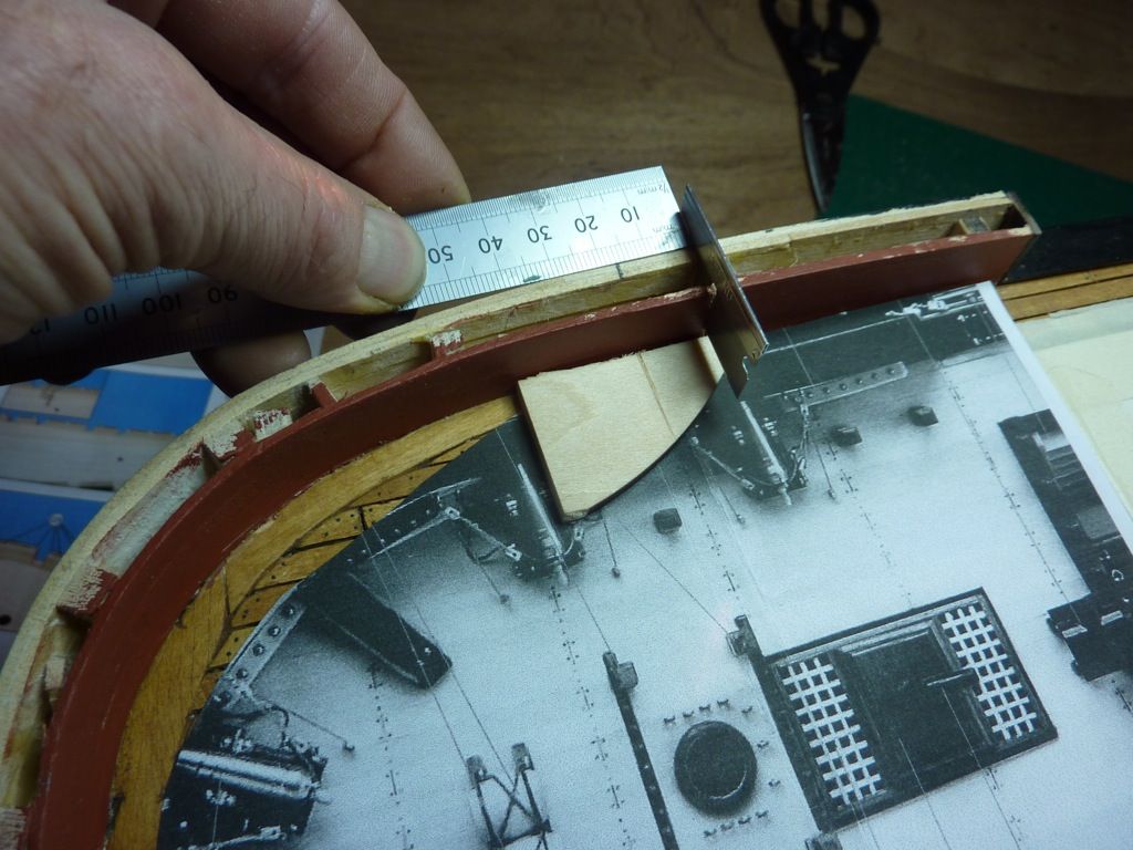

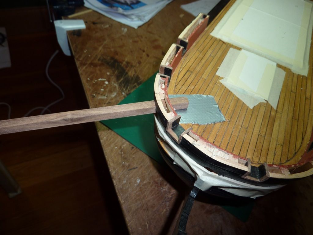

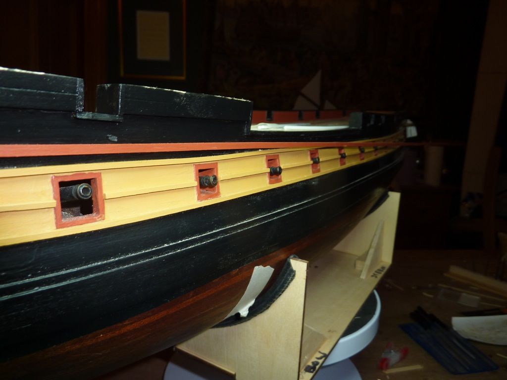

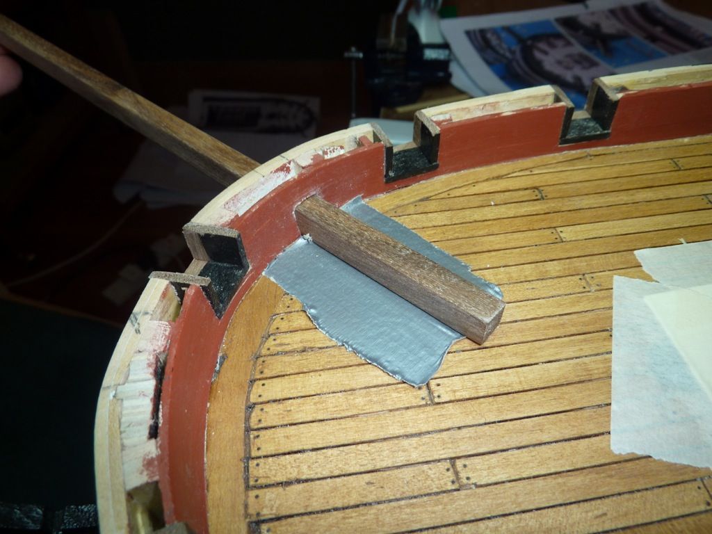

I have been doing the gun ports to the bow of the ship,

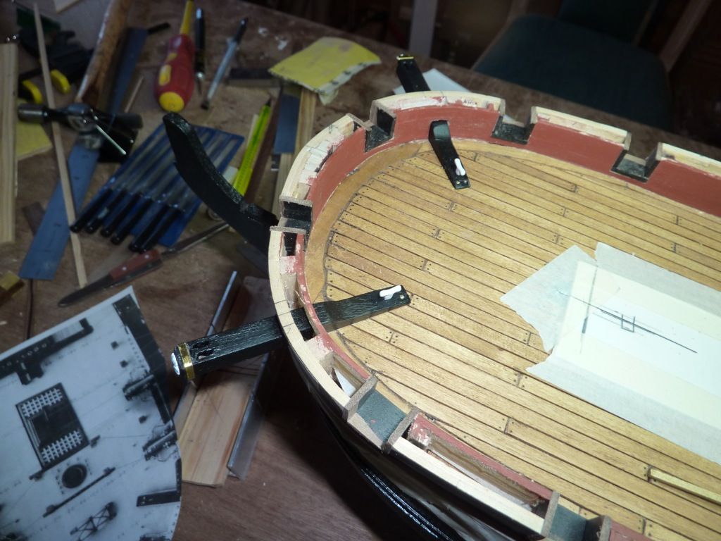

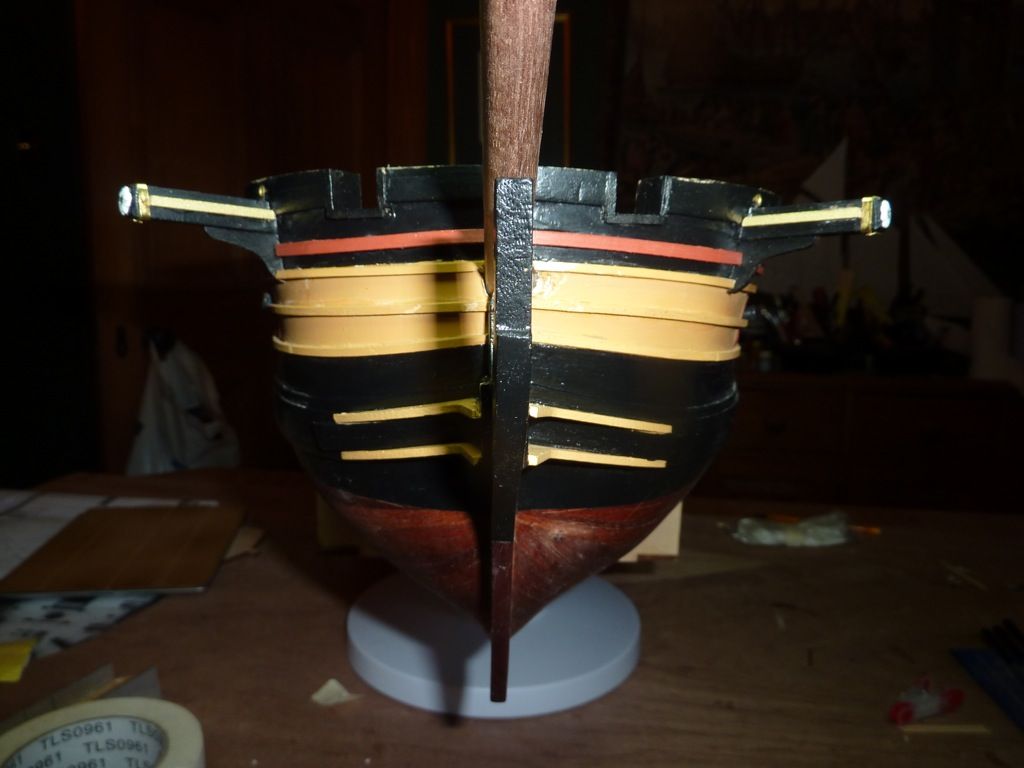

I then decided to go and give the anchor davit's a go. Quite a bit of geometry here, as you can see.
Quite a bit of work in this item, I still have to put the rosette on the end, and put the brass collar at the front and drill 3 elongated holes in the front for the pulleys, I am awaiting delivery of a vertical drill stand to do that. Anyhow plenty to do in the meantime.

Beautiful work on the catheads Mo. This is going to be a cracker.

Looks like she will be a model to be proud ofDrool

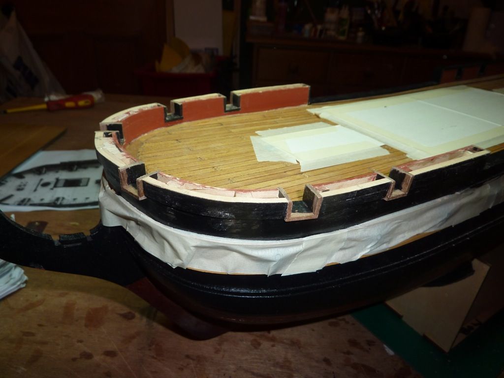

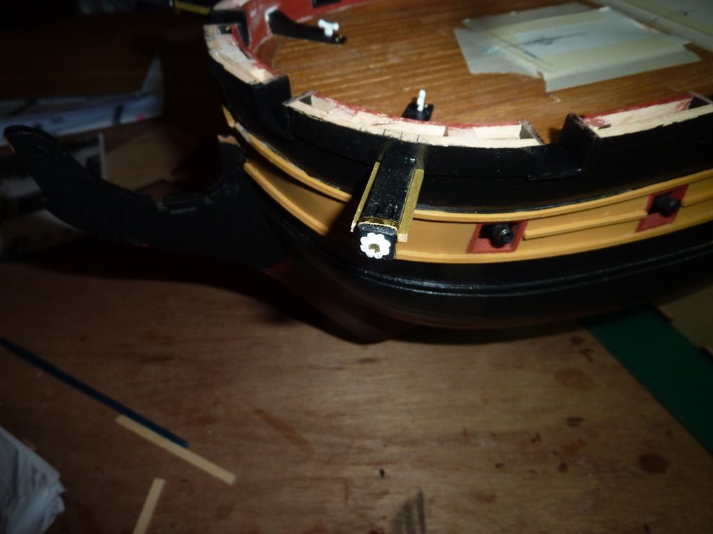

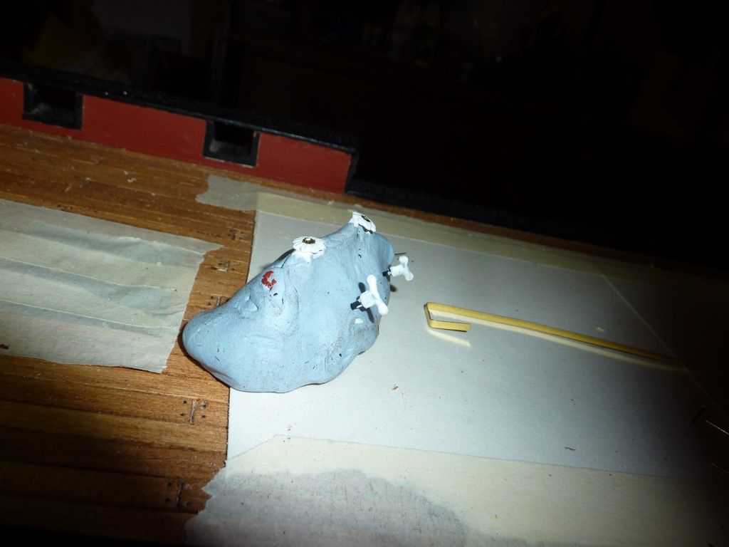

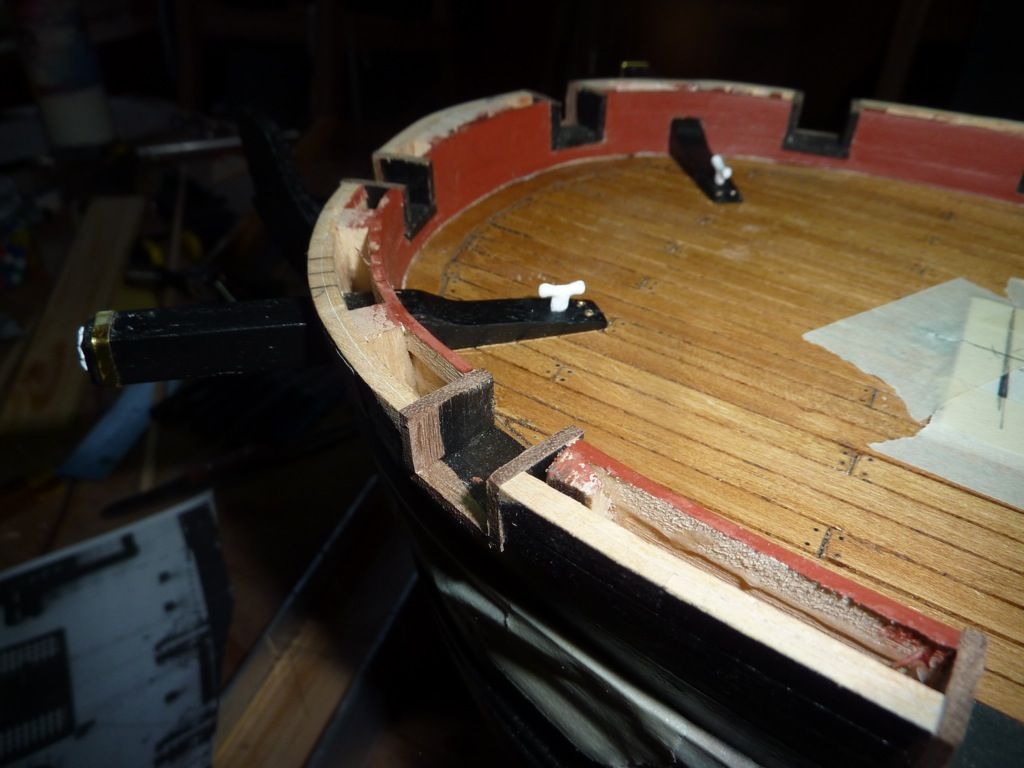

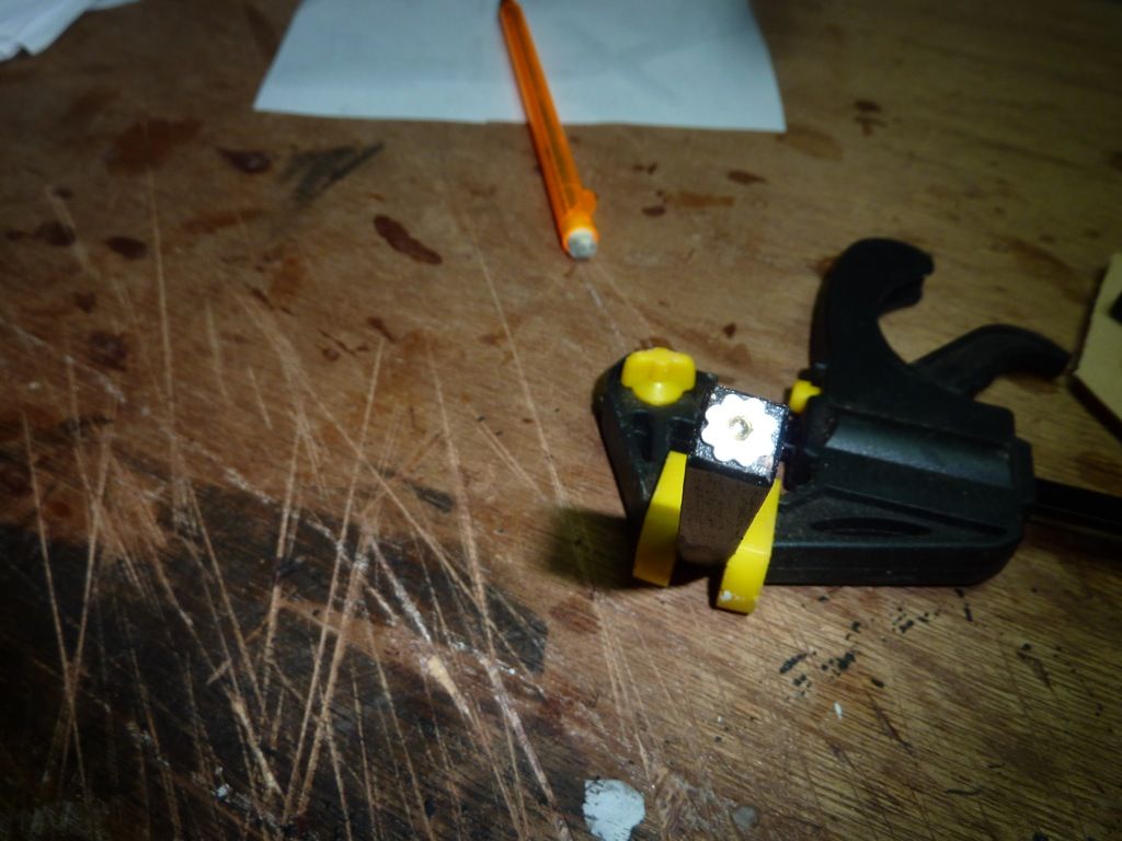

Still on the anchor davits, I have painted the rosettes, 3 coats, and painted the cleat things.

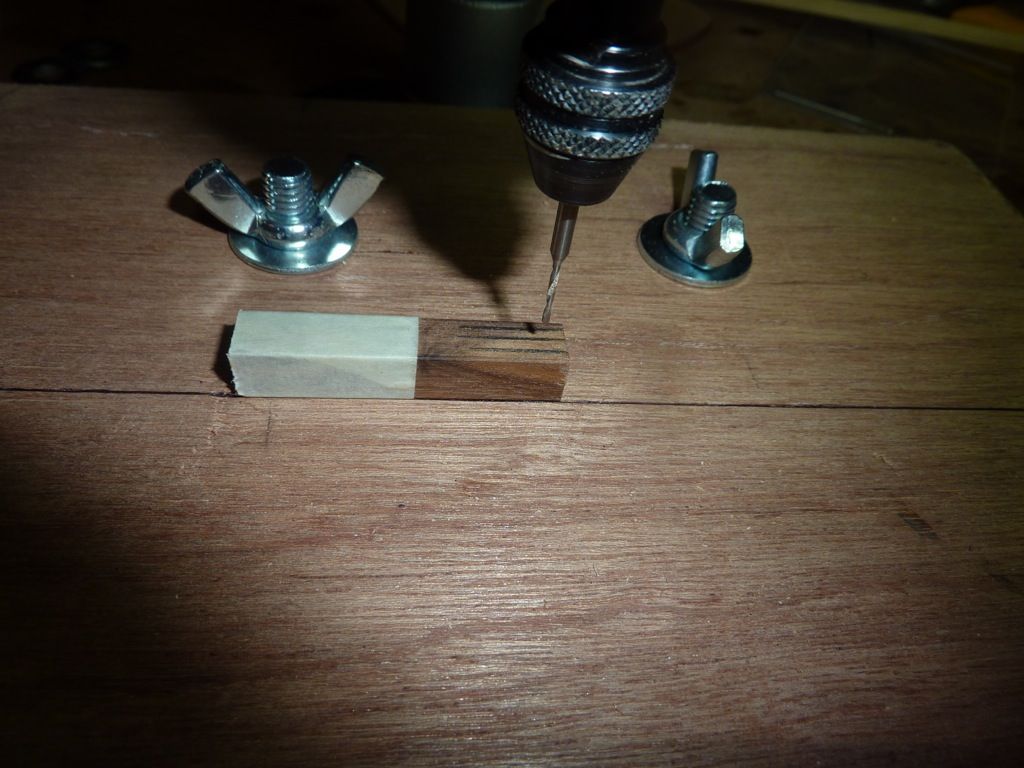

I have also bought a dremel drill jig, I needed this to bore the elongated holes in the timbers, I read a couple of bad reports about the jig, but all in all its fit for purpose, I would say.
The timbers are all painted and fitted now, I have also filled the holes around the cut outs to tidy them up and will paint, I am going to stick to the front of the ship now for a while, try to do the funny shaped bits.

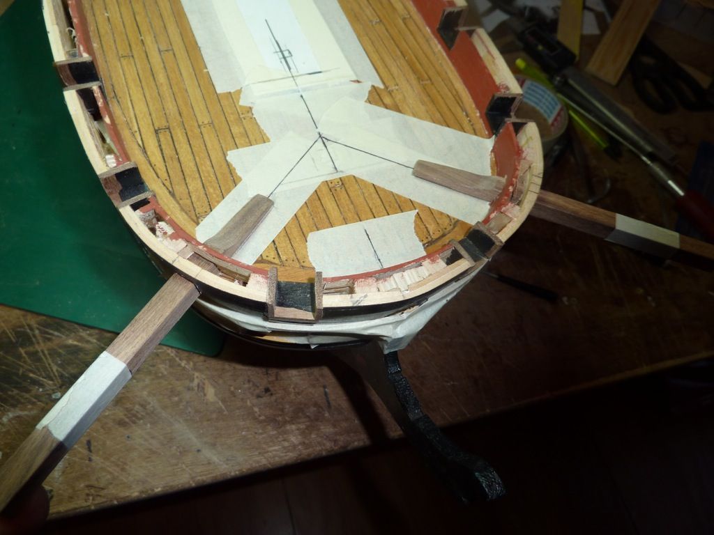

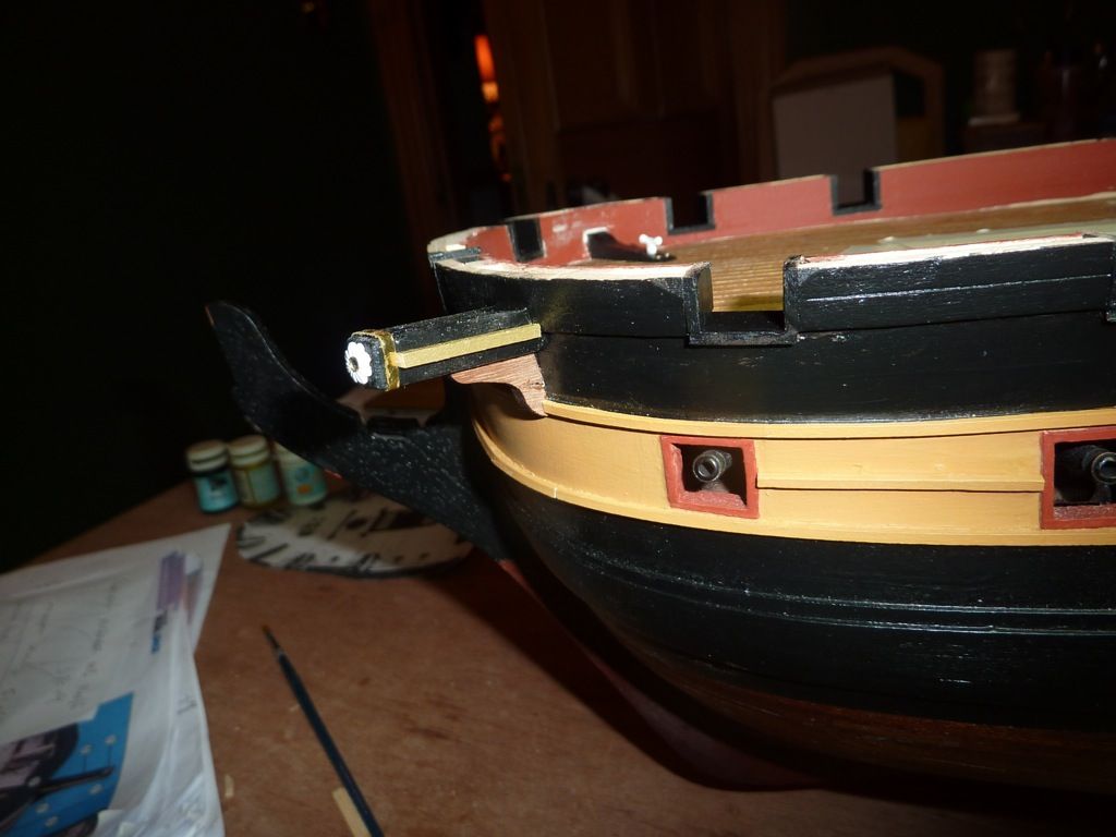

The Anchor davits are looking of now, filled and sanded and painted.
Mo
Mo
#276 Posted : 13 December 2012 22:29:01
Joined: 09/02/2012
Posts: 569
Points: 1,675
The Anchor davits are all looking ok now, filled, sanded and painted.

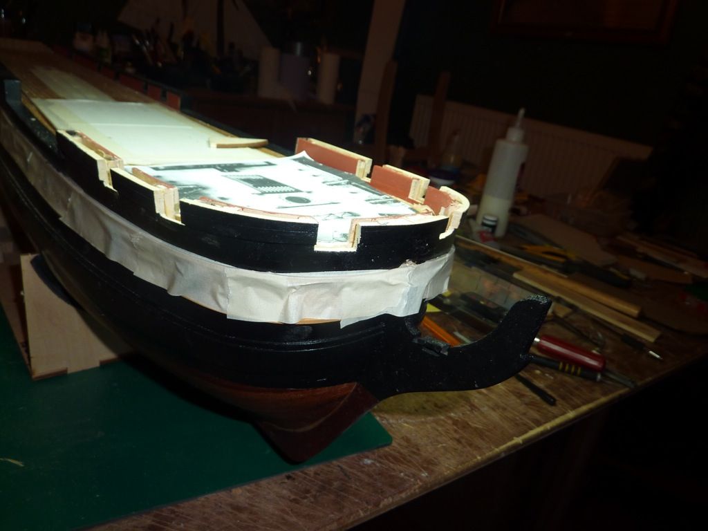

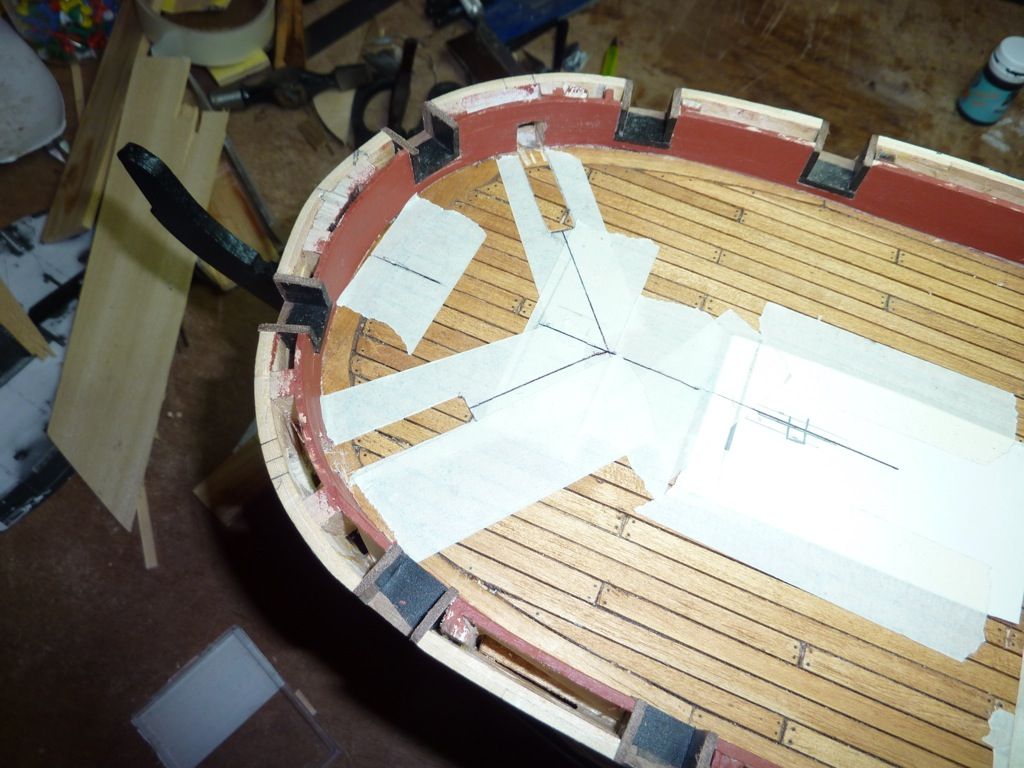

I am sticking to the front of the boat for the next while, I am going to try and copy James Choi's build, the fancy detail around the bowsprit, His work is outstanding.
I have looked out all the pieces for this area, Studied the drawings and instructions, lol.
I am dry fitting first, just to make sure things look ok, and I will be painting before glueing in place.
This area around the bow is tricky, a lot of different colours of paint meeting here,Not going to drink to much this weekend, will need a steady hand for this task.

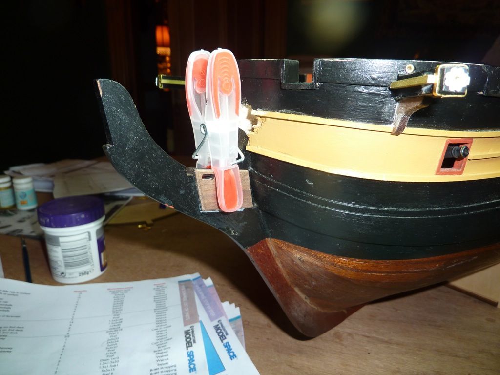

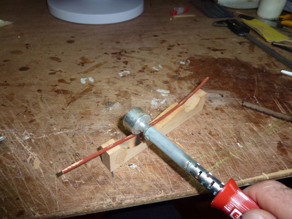

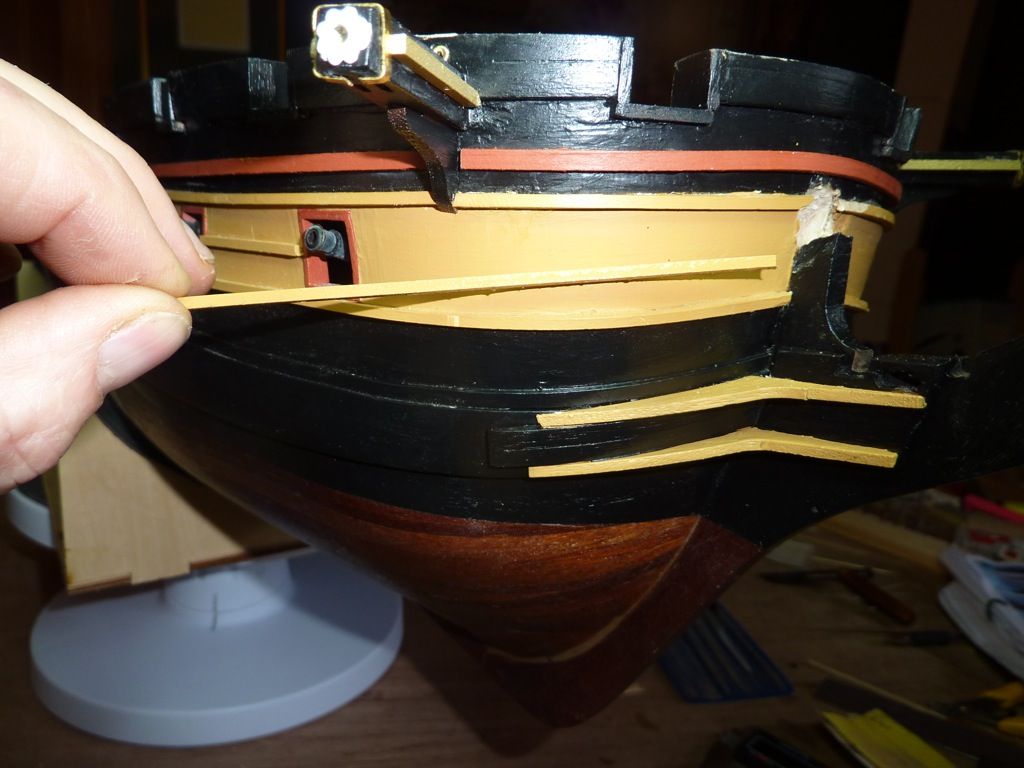

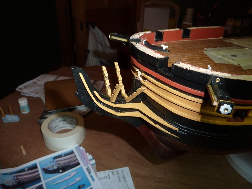

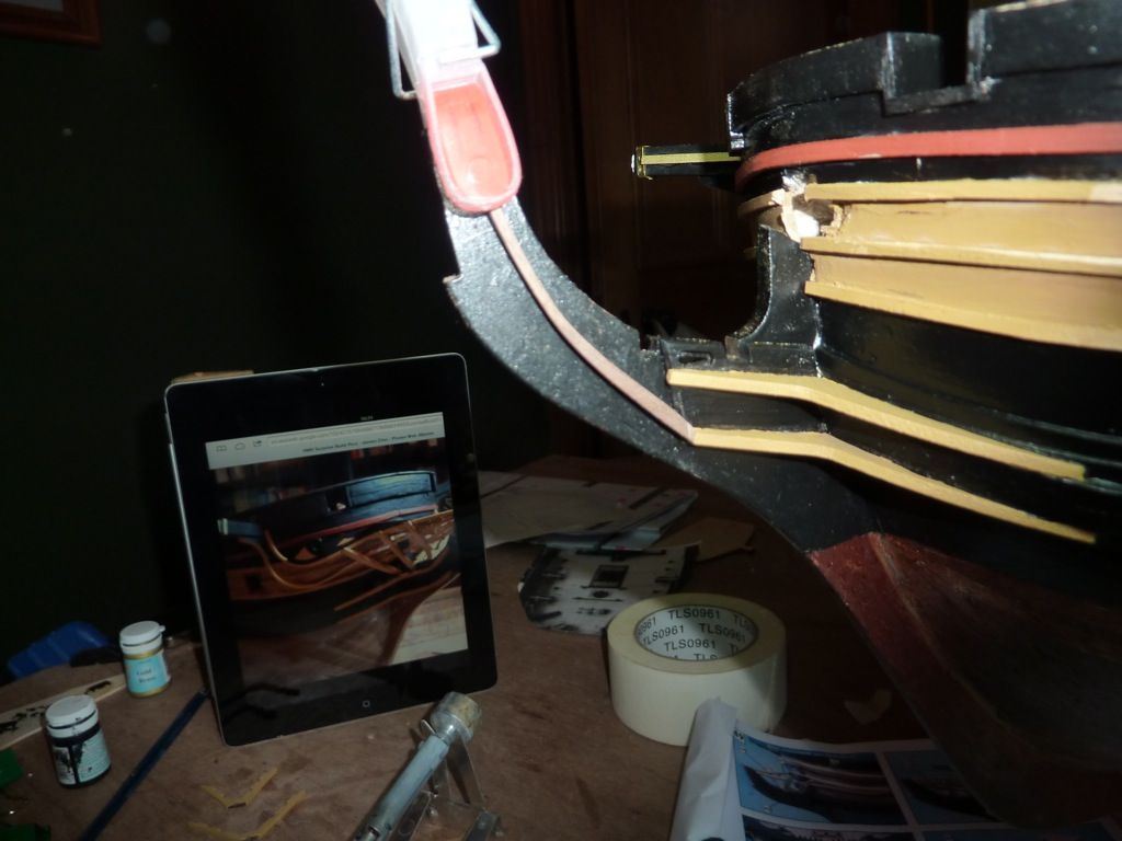

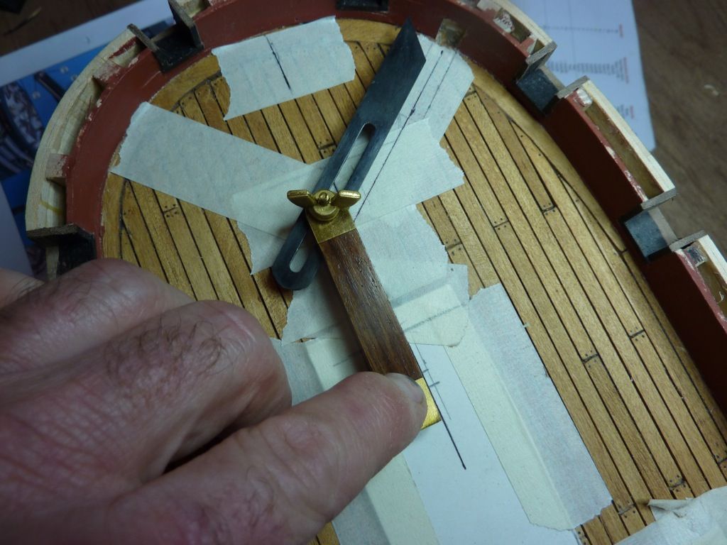

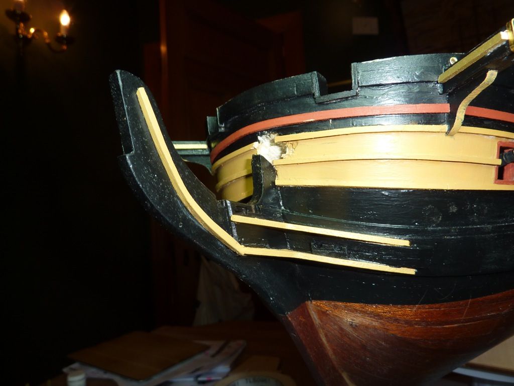

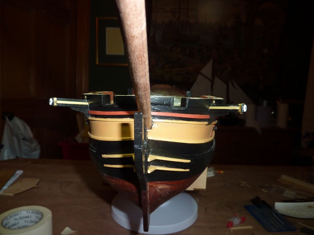

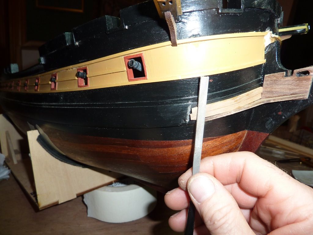

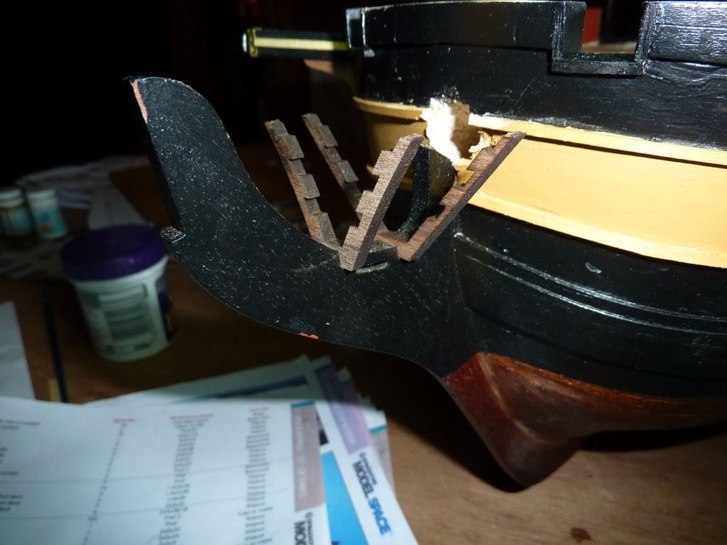

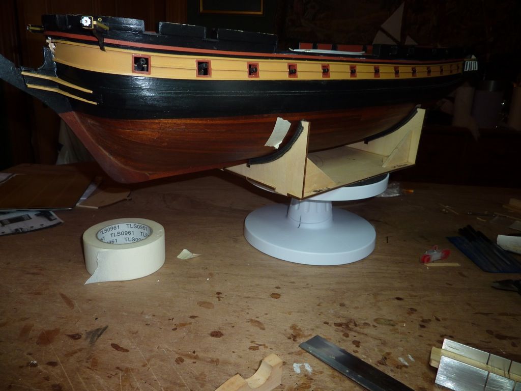

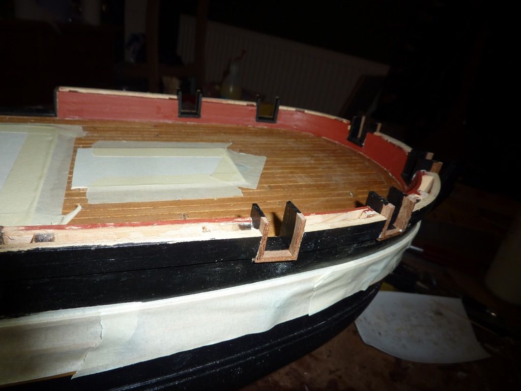

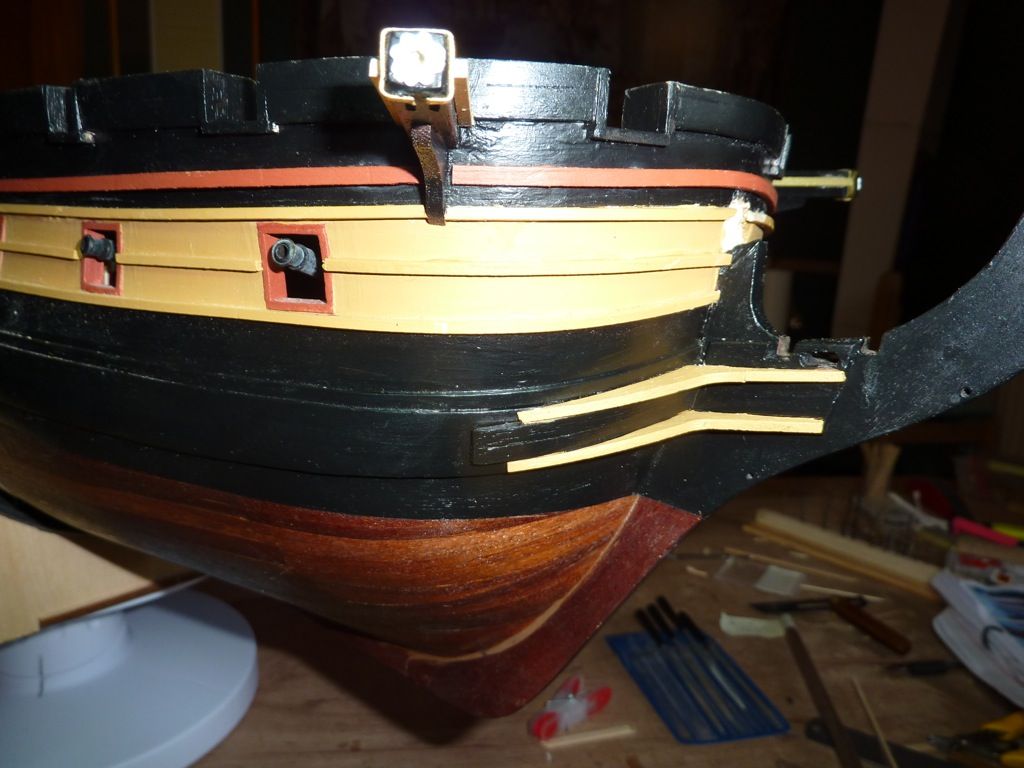

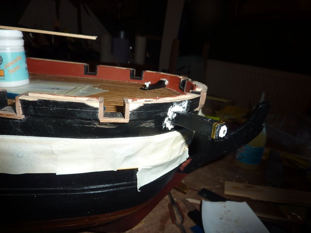

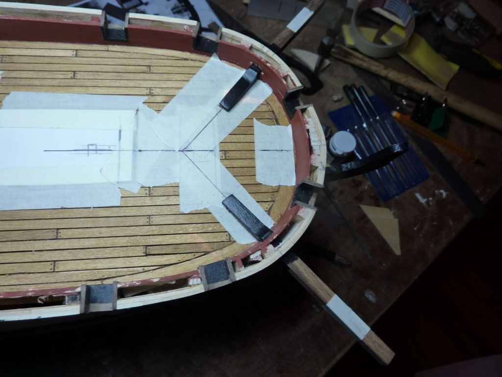

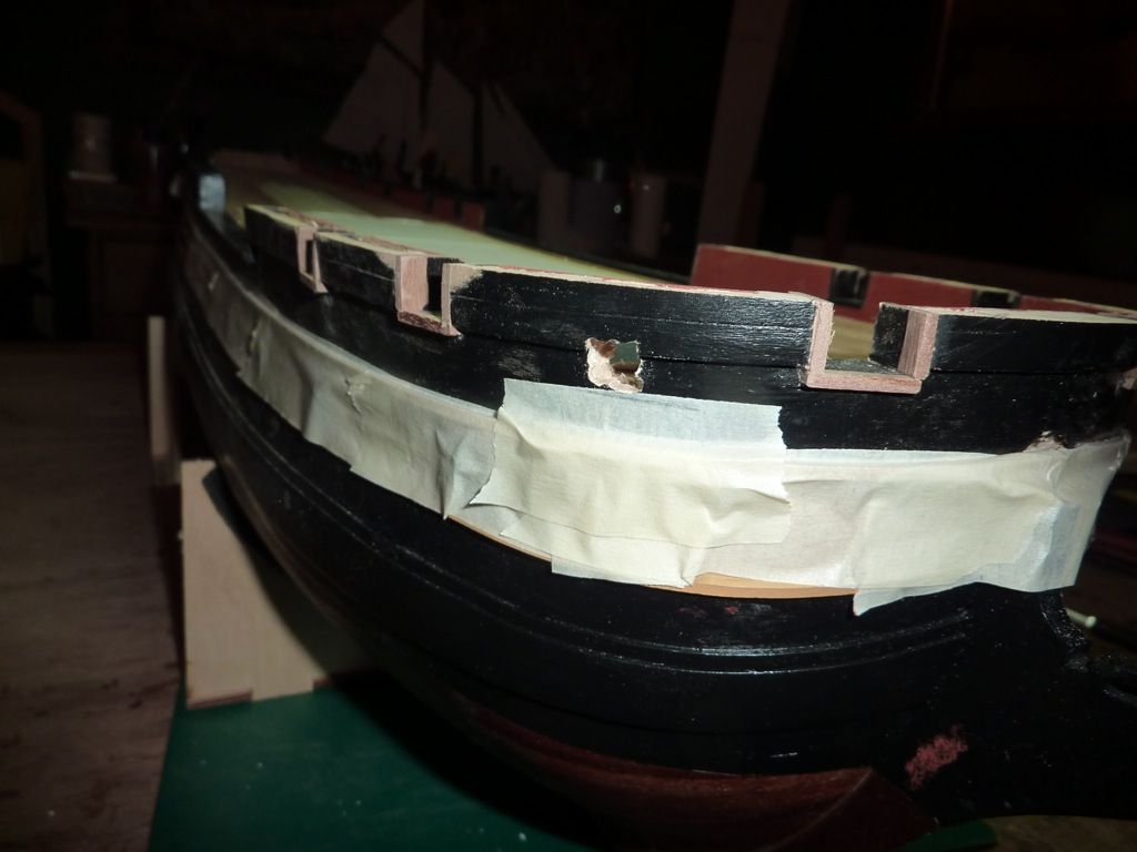

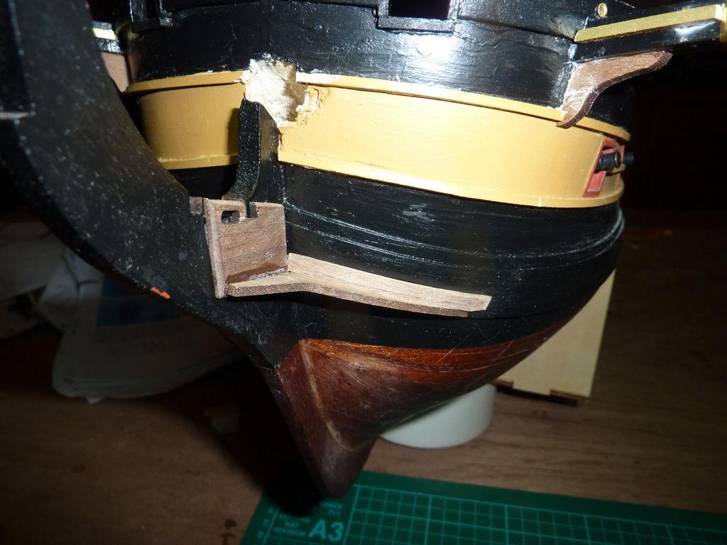

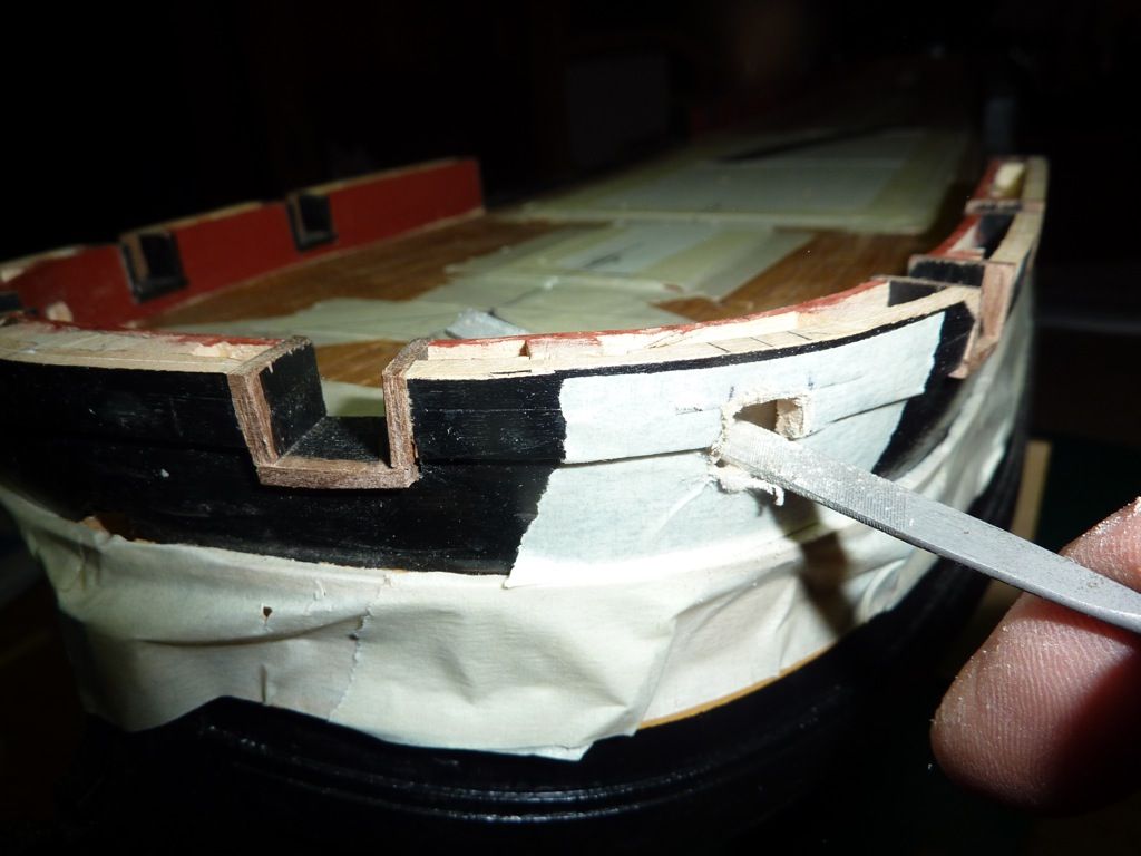

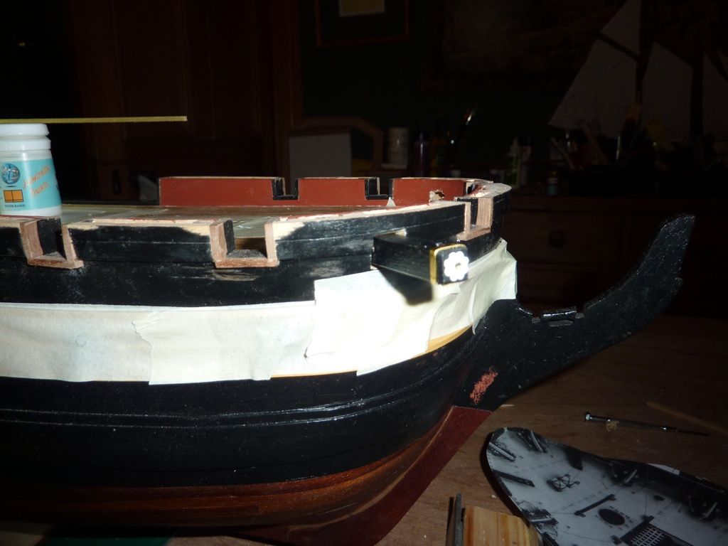

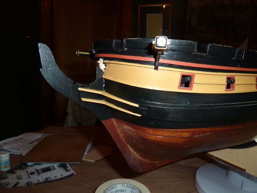

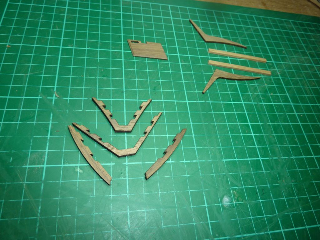

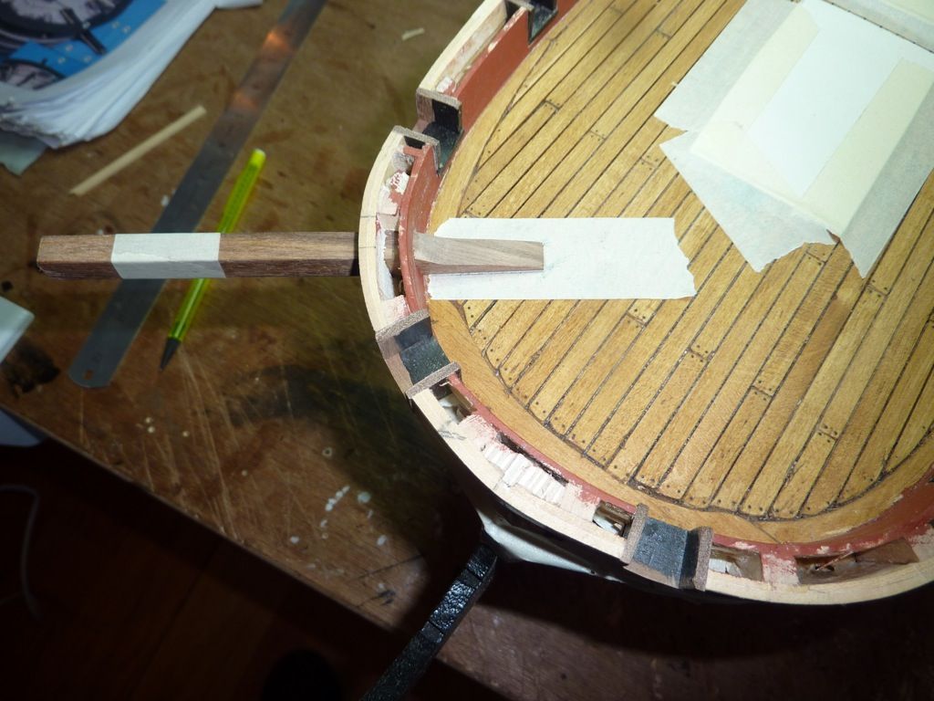

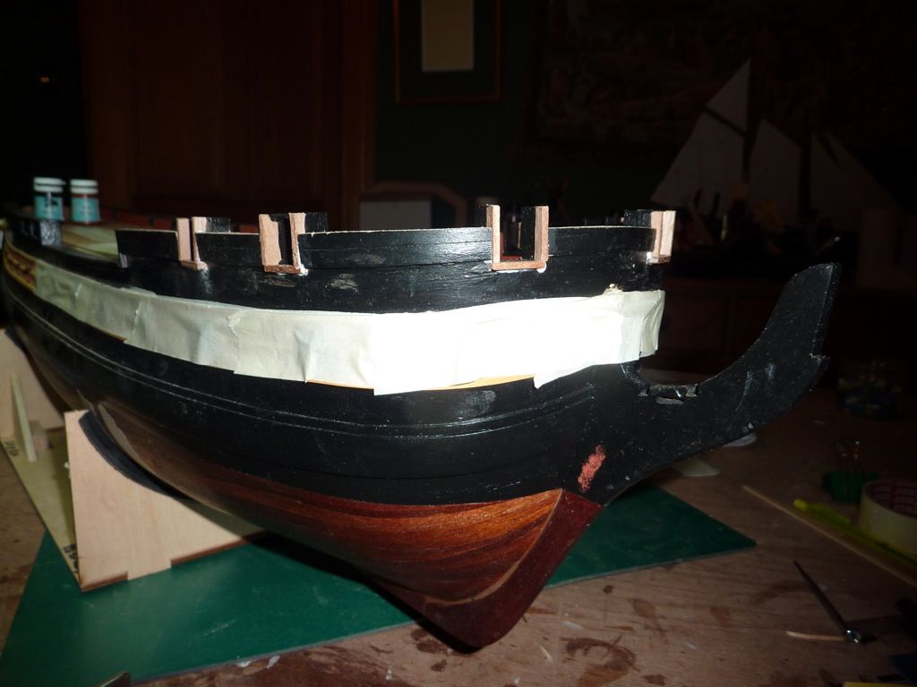

Things seem to be taking an age just now, Can't see myself getting much done, anyway, I have had some remedial's to do, to the timber adjacent to the hole I bored for the bowsprit, As I was boring the hole some splinters came of and I have to cut out the broken bit and replace with a new bit. I have also fitted the timber painted red, to a position of about 5mm above the timber to the top side of the gun ports,

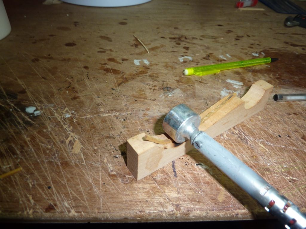

Thank goodness for the electric plank bender.
I have also bought a revolving cake stand, this is enabling me to turn the model around, just by spinning the cake stand. ( yet another great idea I found on this forum, )
I have also been completing the timbers to the centre line of the gunports, I had not done the front ones, as the bowsprit was not bored at the time of fitting.
There was also little pieces of timber to be fitted to the front, turning upwards, This again was very fiddly, and were had made and shaped to suit, I again have choosen to paint them Yellow Ochre.

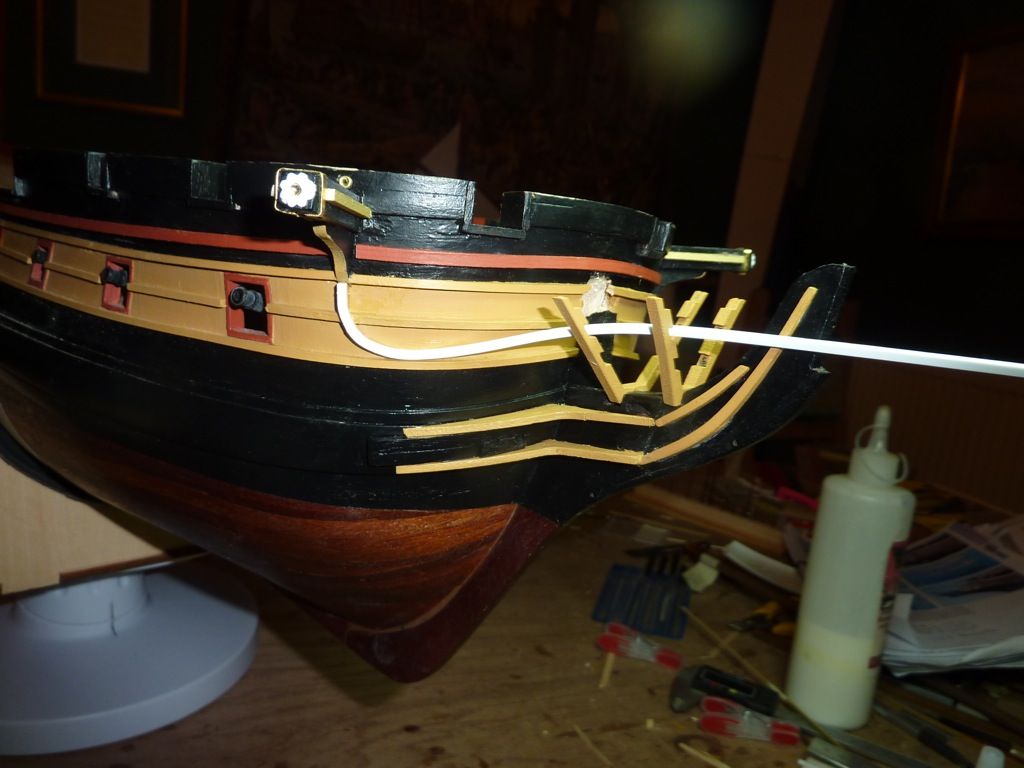

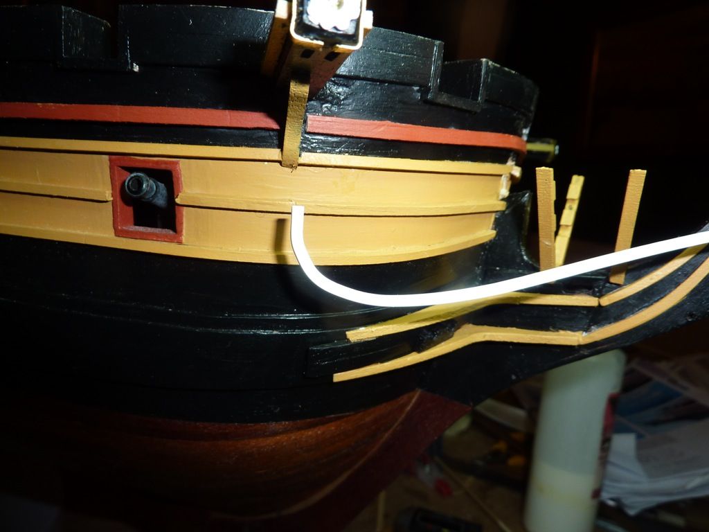

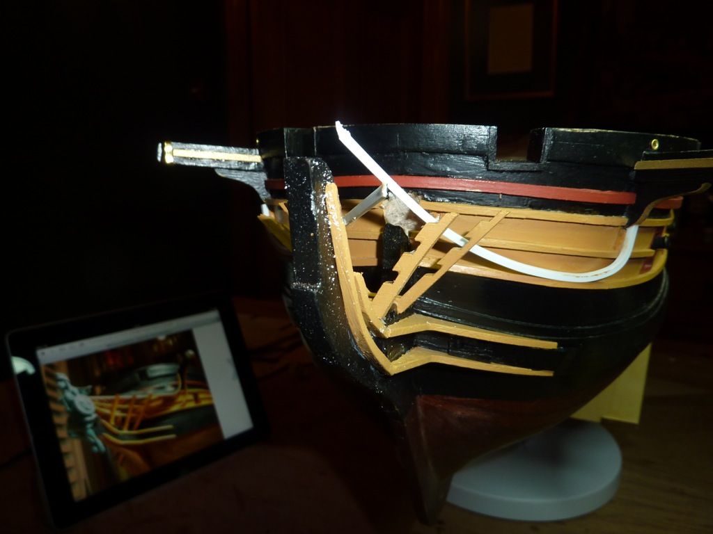

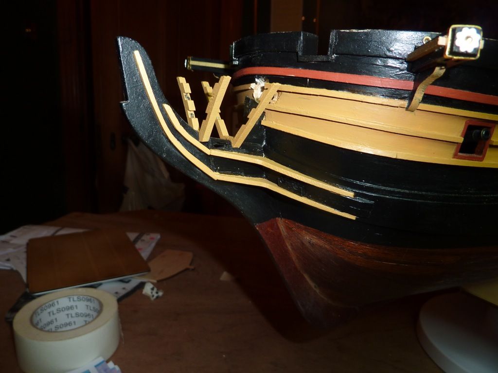

Now comes the really really fiddly bit, These curved timbers to the bow, I am taking Moriaity's advice here and I am going to use Plastic, I have picked up some 2mm x 2mm pieces of plastic, So here goes.
The plastic is bending very well, and the superglue is sticking well also, Will report back later with more developments.
Mo 📐 ⚓

looking good mo, i've seen the plastic used before, and it can really look good.
the one thing that i have noticed with this kit is the different woods. i wish the victory had come with walnut, sapele and other woods. it does not make much difference if you paint your models, but as i have said before my paint skills are terrible, so i like plain wood. i am not sure if the actual a/l victory kit comes with the various woods or not, but i certainly wish the partwork had been like the surprise.
keep up the good work, sometimes each area does seem like a kit in itself, but you are certainly doing a good job.
