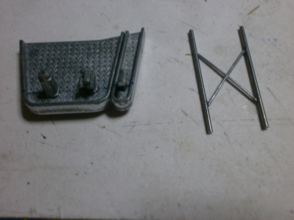

i removed the plastic strip from my hull and used the moulded strip provided [this would work great on the Yamato build too,better by far than the wire provided for this],i deviated a little here from the build instructions instead of cutting all the peices out i used the round nose plyers provided in the free tools kit to bend the strips to shape.This helps keep the joints to a minimum also i have stil to add the mid stern area strips as this area as pointed out by Yaturo is not right[the strips go above the guns in this area not under as shown on the plans],i think il need to mould some extra strips here as i think i will be short when it comes to compleating this area.
I added the etch to the bow hanger base and the shaped and added the two cast walkways,im still deciding about these as there way off scale [they would be at least a foot thick at full size]il probably just scratch build these items.
I then shaped the two rear etch hangar parts and put them to one side,mine needed a fair bit of work as they are two pieces of etch stuck together and not aligned very well,some work with the file cured this.
Finaly i added the bow etch plate,no real problems were encountered here just had to straigten one rear corner bent by an overenthusiastic postman forcing it through my letterbox.Also the final three hangar covers were added,as always all comments/questions are welcome

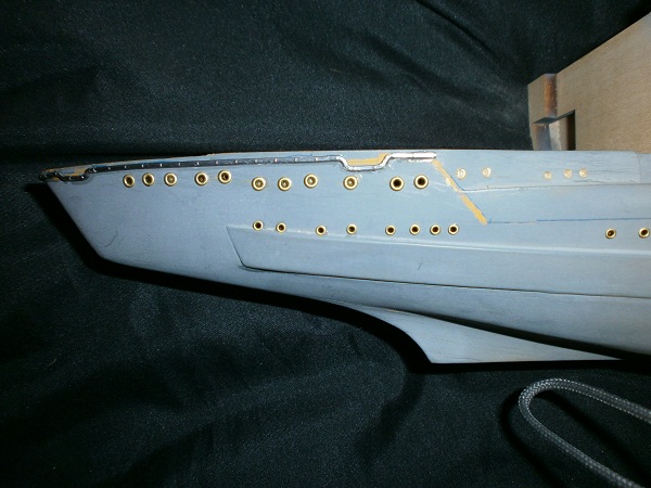

#289 Posted : 21 October 2012 12:57:59

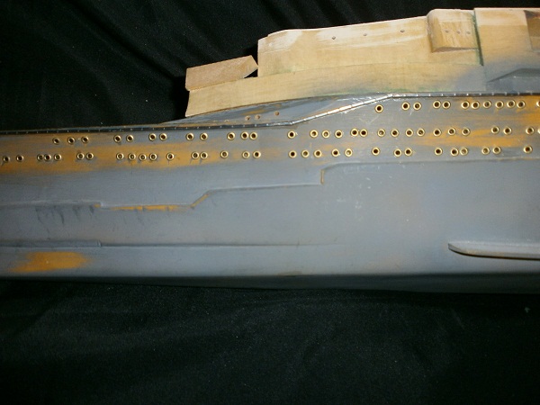

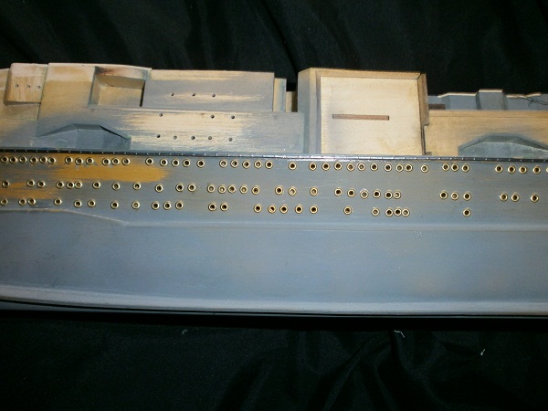

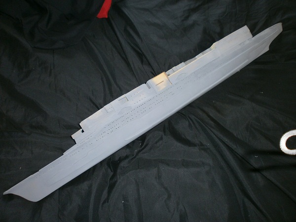

just acouple of pics of the hull with a coat of grey to cover the portholes
mark 2
Hi Andy.
Wow she is really starting to come together now Drool Love .
Well done on doing a fantastic build.
Best regards.
#291 Posted : 21 October 2012 13:36:09
BigGrin Thanks Mark for looking in and your kind wordsCool
Ger C

much better now the portholes are painted andyBigGrin looking good
Come on you Jimmies
#295 Posted : 21 October 2012 19:17:58
BigGrin I totaly agree there saintsmanCool

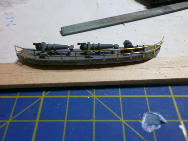

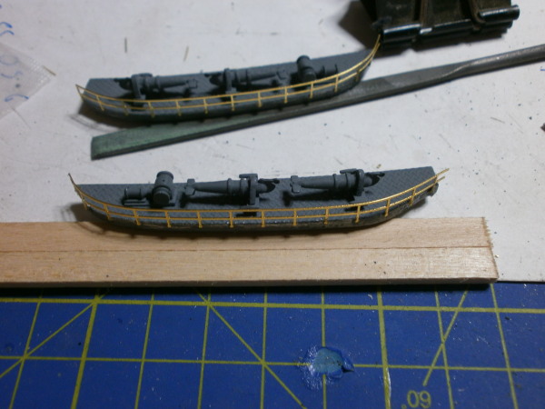

some more pics on progress,im still painting up the stern etch deck after fitting to size might be just my build but there was quite a bit taken off the sides here to get it to fit. Part of this months items was to put railings around the bow hanger platforms but I haven't fitted these as yet as the Fujimi Akagi shows that the upper platform runs all the way round the outside of the hangar back to the mid section decks, im not realy that happy with the castings anyway [too big if they were scaled up to real size they would be 1ft thickLOL ]so it looks like I will be scratch building this itemBlink . There were some items to make up aswell but there not going to be used for a while so il be making and fitting when the time comes, as for the rest of this month its adding pieces, making up stations and the usual metal bashingDrool. I am also casting the anchor chain winches in plastic I think Yaturo scratch built his but I thought I would try the casting method. As always all comment/questions are welcome
#300 Posted : 26 December 2012 22:25:30
Hi Andy, have to say I love your work on this build... reading your diary has highlighted a tricky build.... very well done m8.... look forward to seeing more....BigGrin BigGrin
