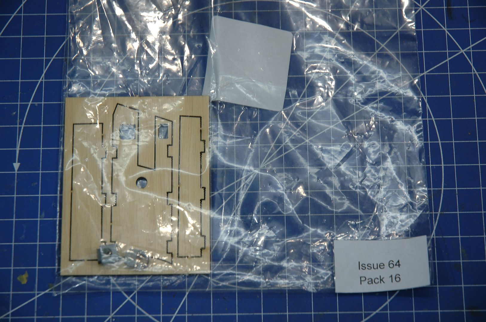

PACK 17
ISSUE 64
Landing Gear Housing.
Housing Plate.
Gear pivot axis 1.
Gear Pivot axis 2.

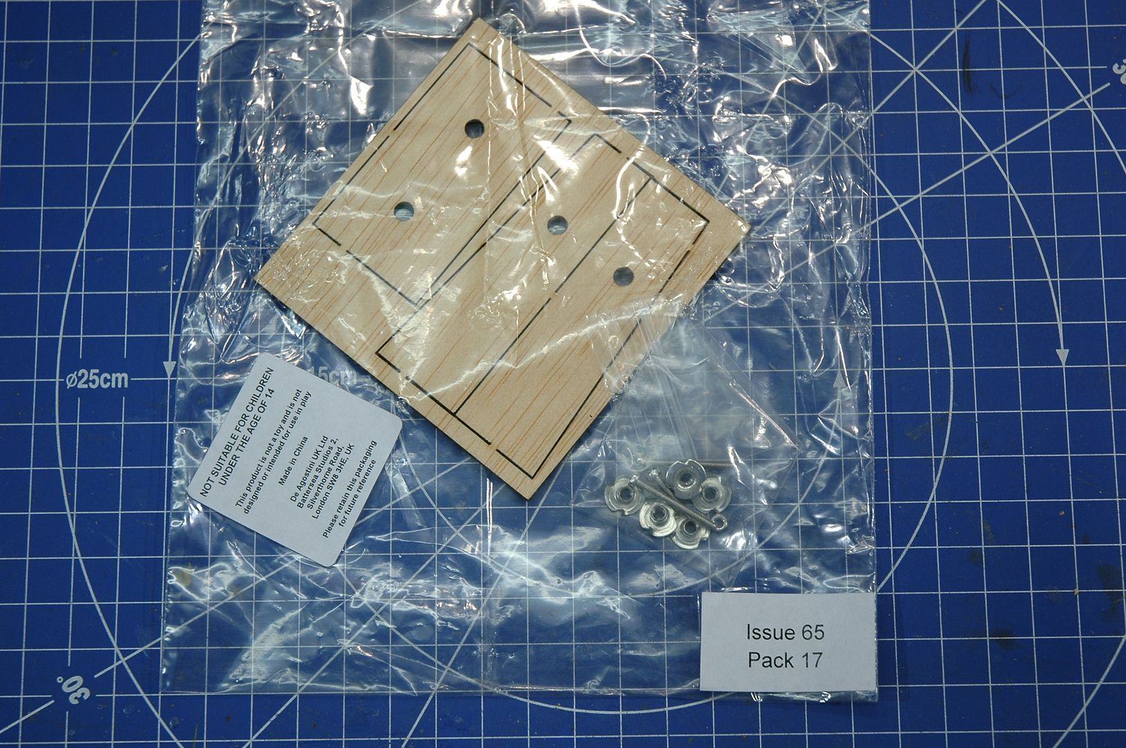

PACK 17
ISSUE 65
Parts Fret
Captive Nuts
2x20mm Screws
2x12mm Screws

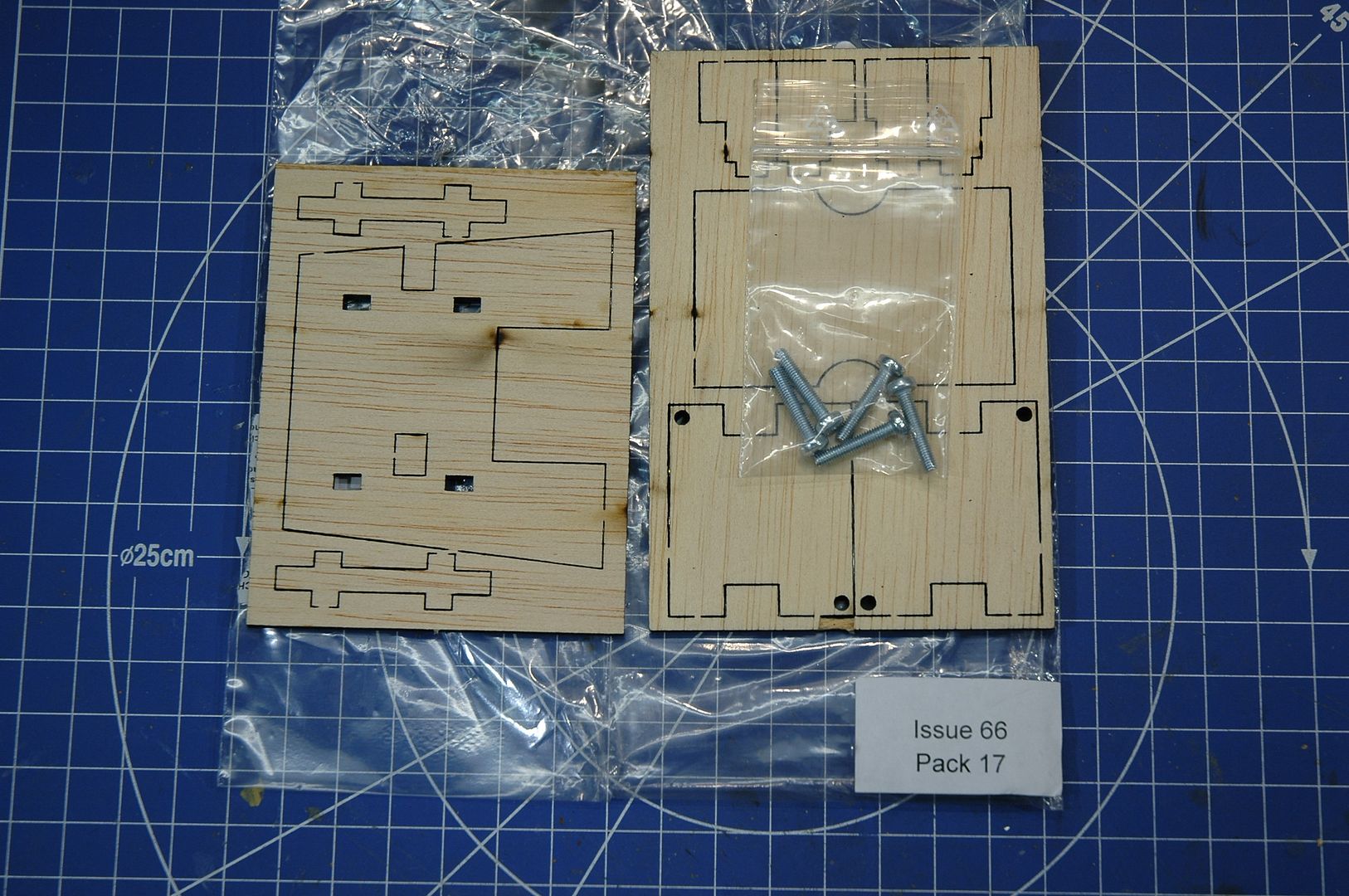

PACK 17
ISSUE 66
Parts Fret
Parts Fret
3x16mm Screws
PACK 17
ISSUE 67
Parts Fret
6.5 mm Screws
Metal Rod

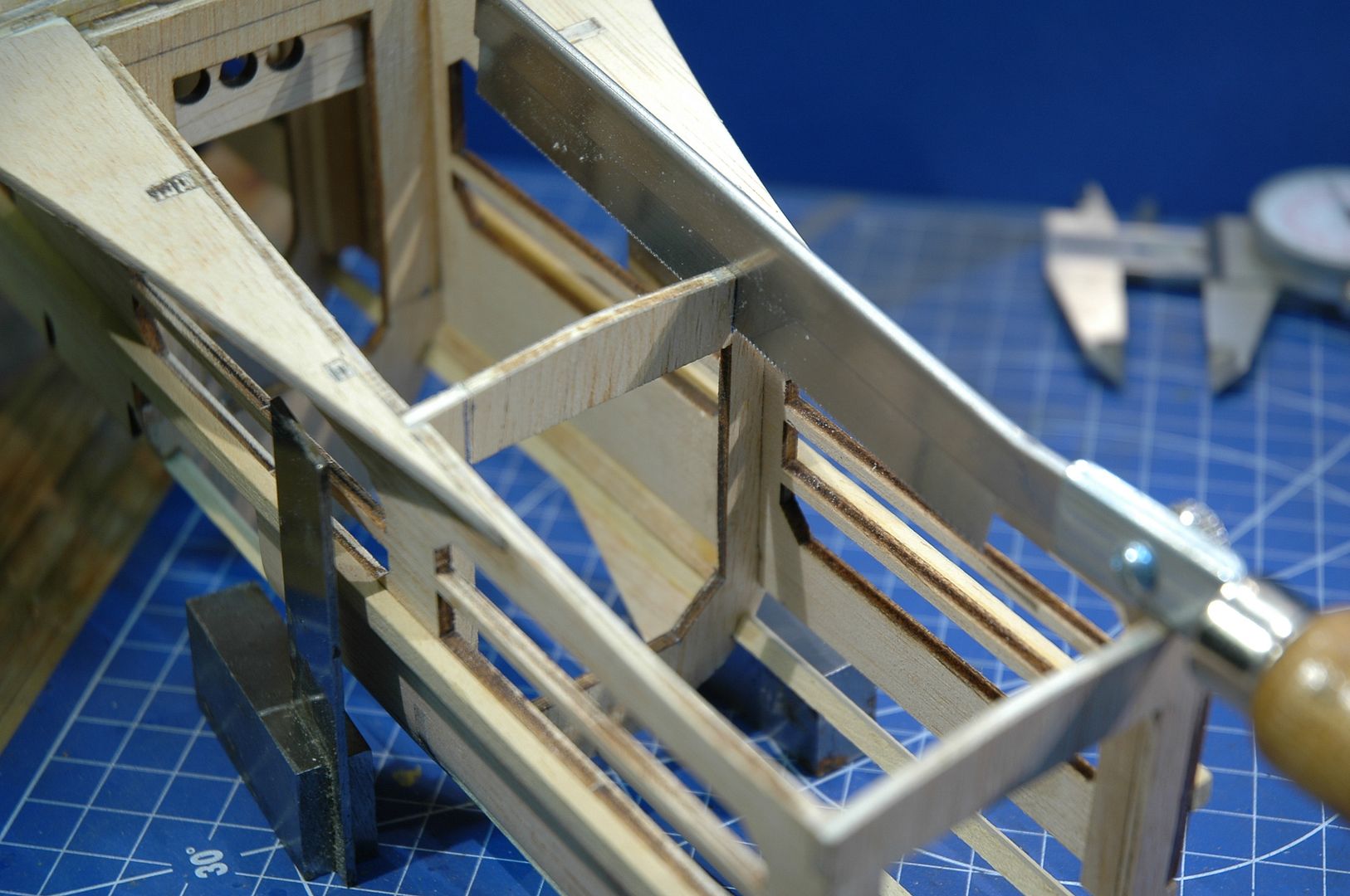

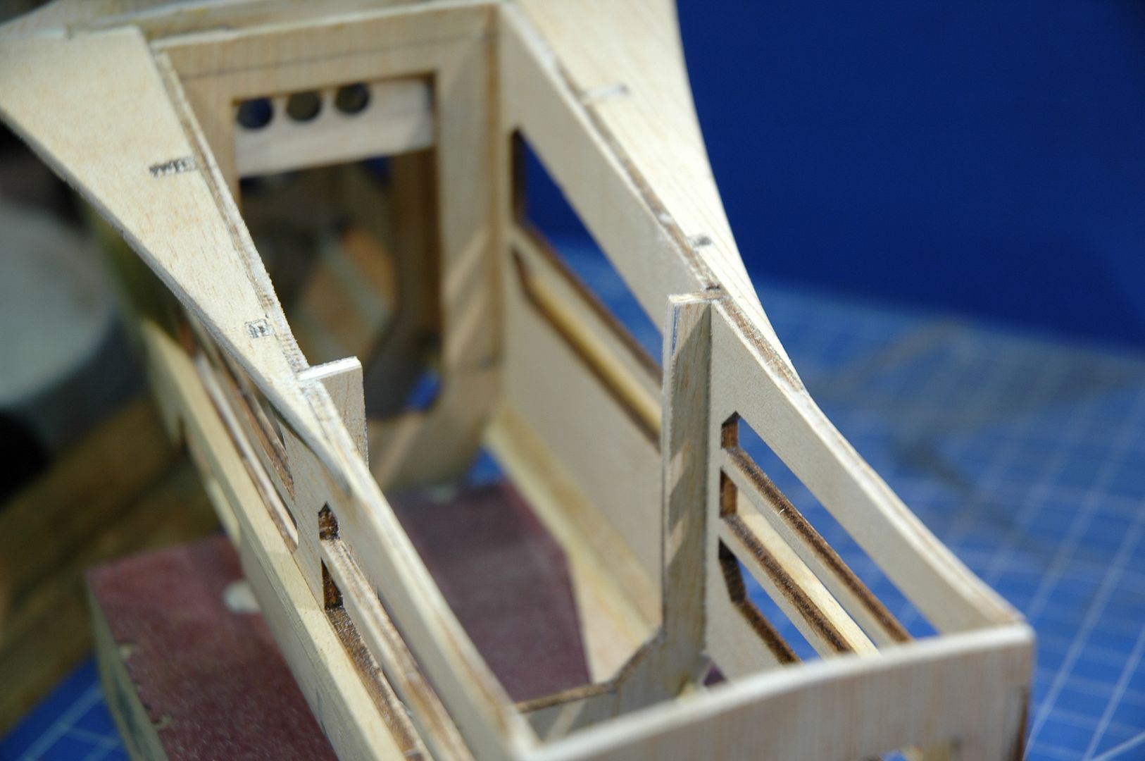

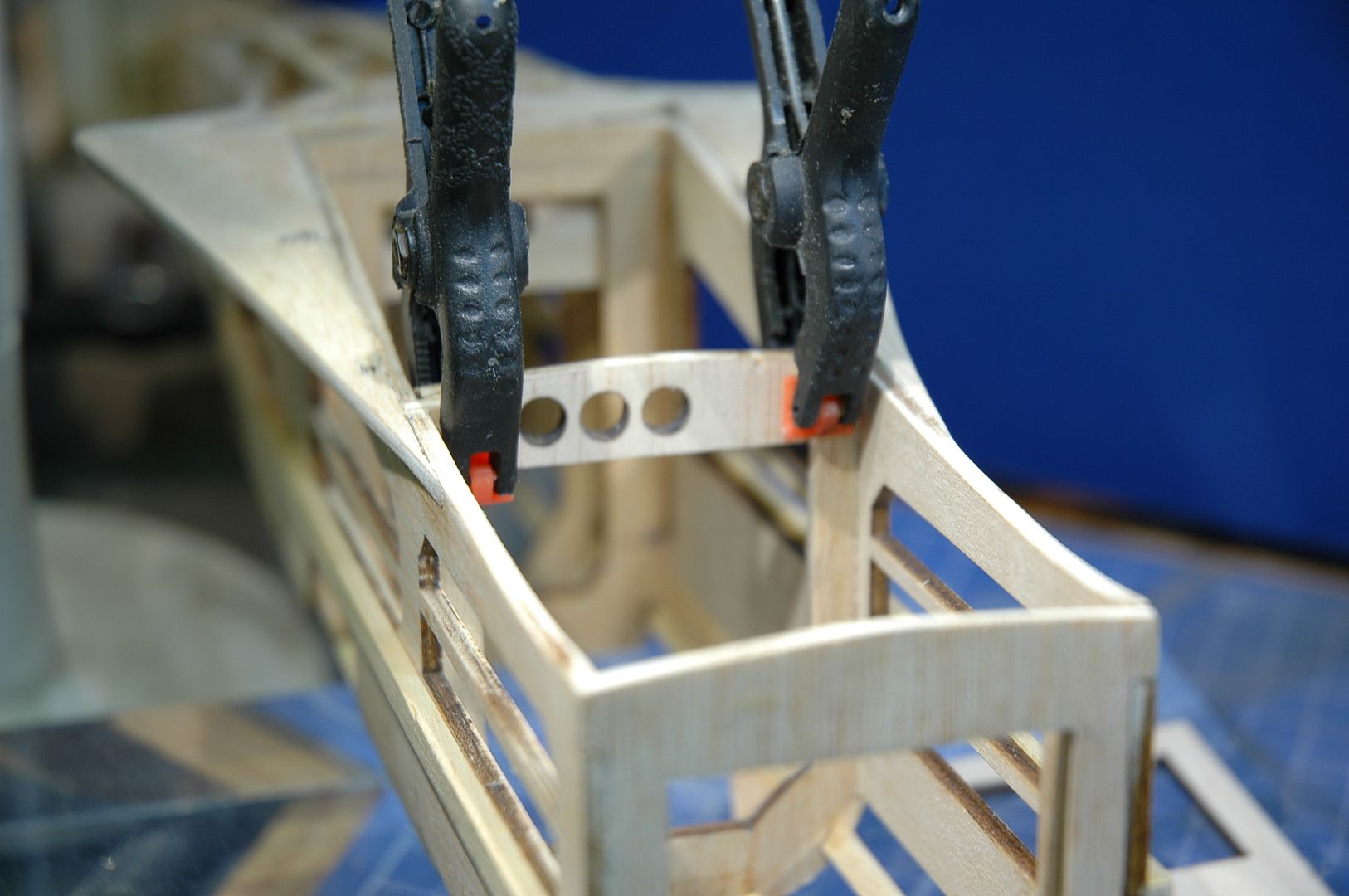

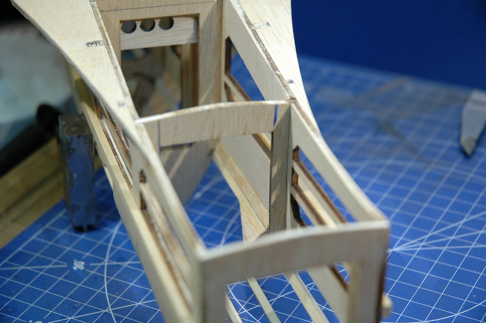

To day I have removed a centre section from the underside of the fuselage and replaced it with a small part with three holes, this has to line up with another piece to the rear of it, no problems but you have to try to support a best as you can while you are sawing.
First job was to turn the fuselage upside down to locate the position of the central section to be removed,this picture shows the two lines where to cut.
This is were you need to support while sawing.
With the wood section removed sand down to a smooth edge, again hold tight to avoid damage.

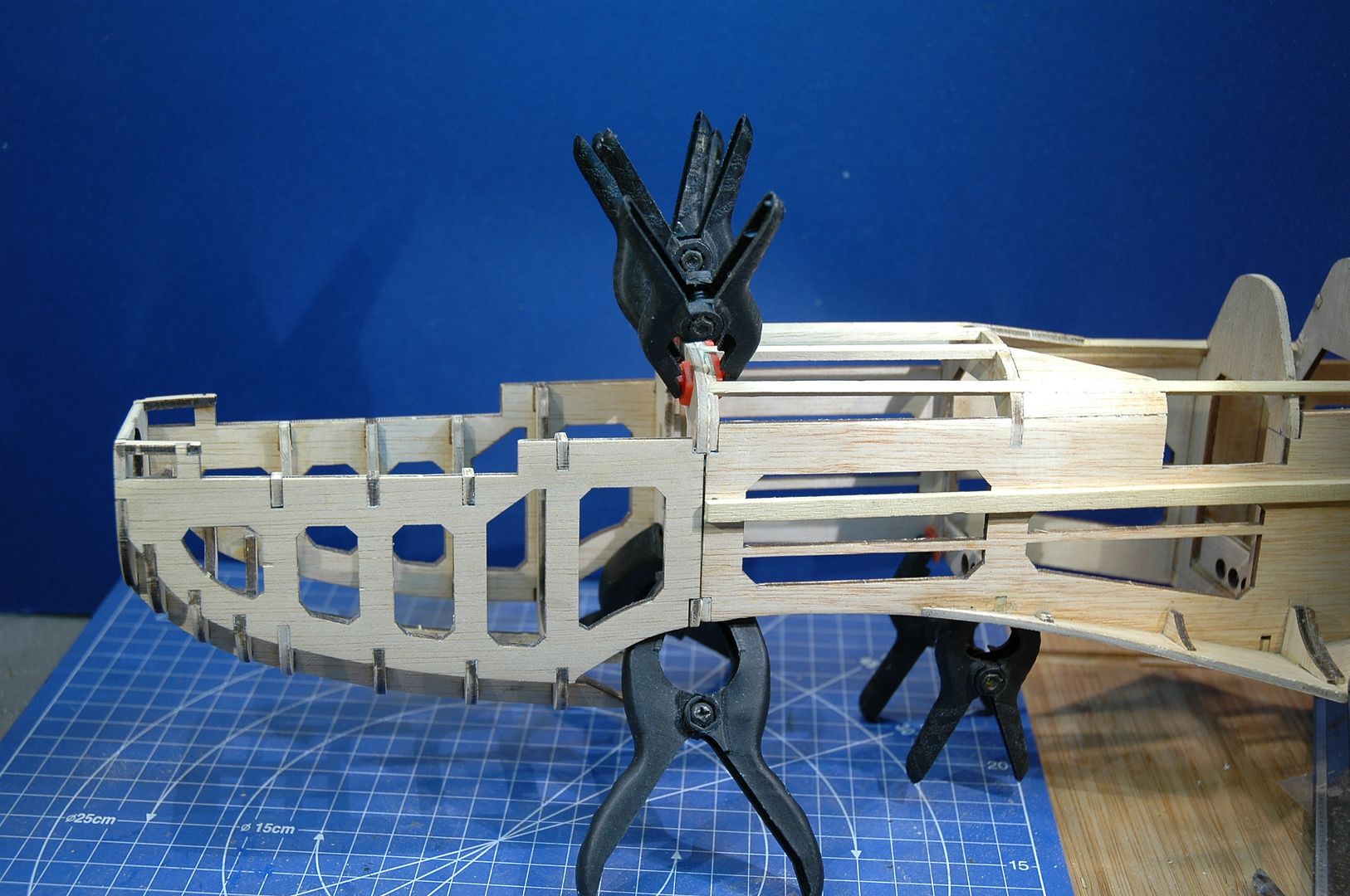

Next job was to remove all of the fret received for this stage, smooth down all edges and test fit the small piece with three holes behind the frame. You may find that you have to make small adjustments for a good fit, I then glued in to place making sure that the top edge fit's flush with the bottom edge of the fuselage.
Last picture in this section shows the engine compartment glued to the fuselage it should all line up ok and no need for adjustment clamp together and leave to set.

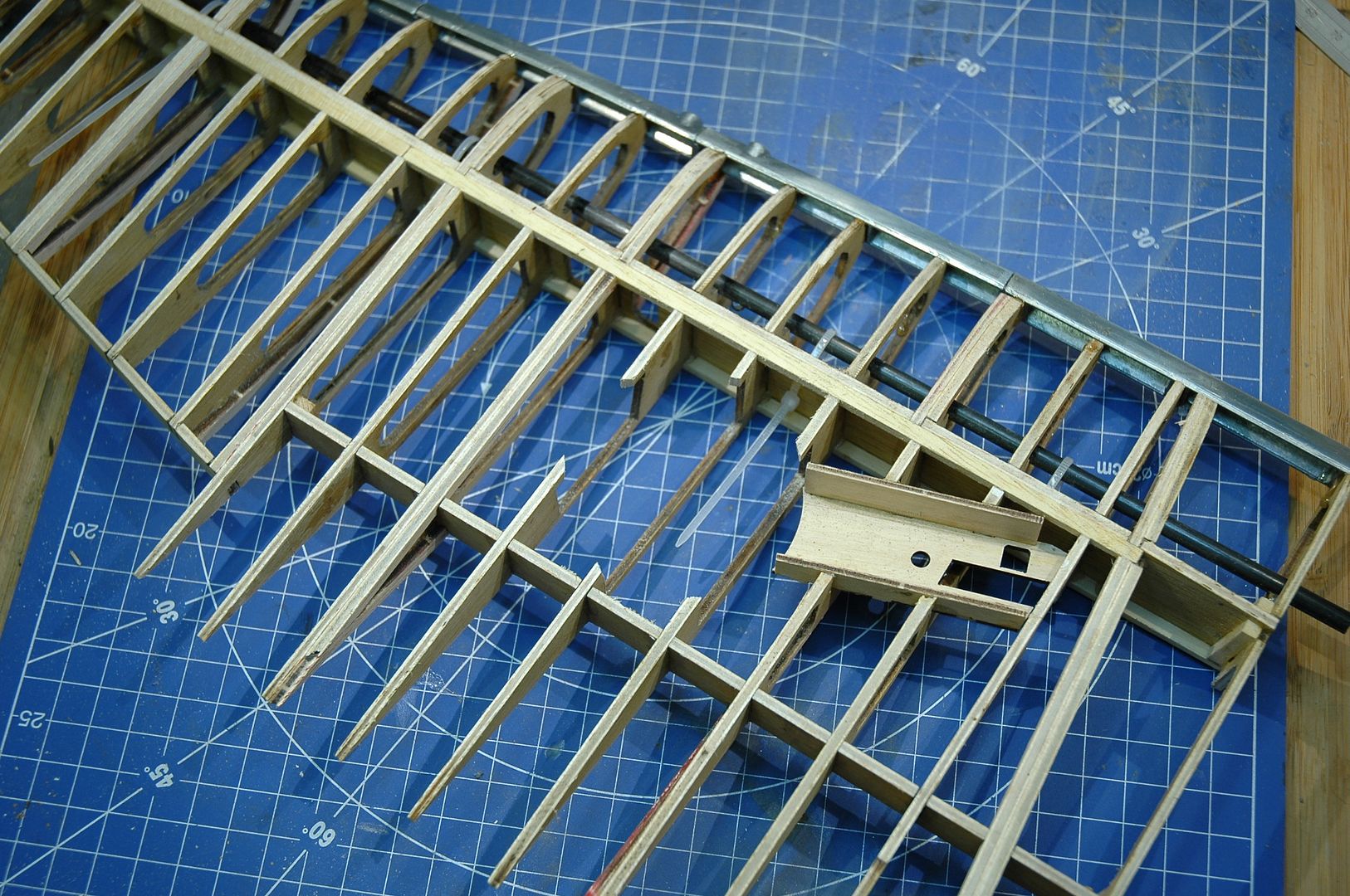

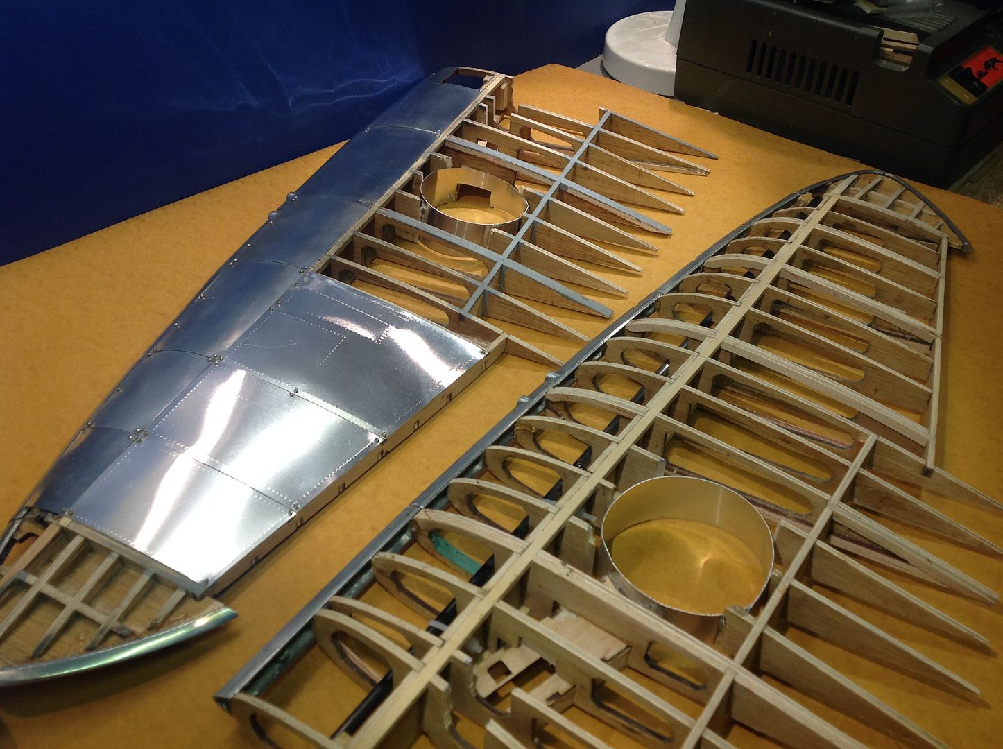

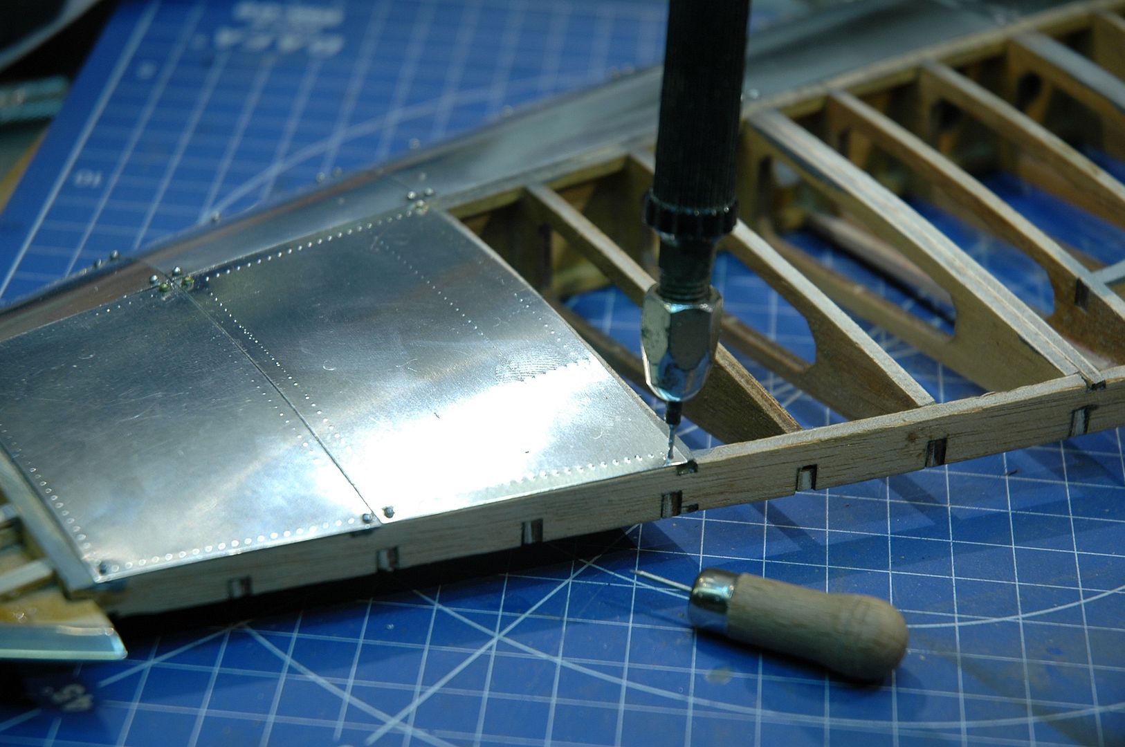

After fitting the Port/Starboard Wing landing gear housing the next step was to fit the wheel housing, but before that plate 10 had to be fitted to the wing.
the next step was to fit plate 10 next to plate 12 making sure that it fits tight with the surrounding plates make sure all the ribs are clean from glue from plates near by, then drill and pin holes were indicated.
This shows were I have cleaned away glue.
Now to fit the wheel housing, for this you will need a Saw-file-knife-glue, first I turned the wing upside down, then locate the two ribs to be removed I found that it was best to cut at a bit of an angle so long as it looks round. Then I turned the wing over and cut out the tops as near as to the same shape,
Trev
