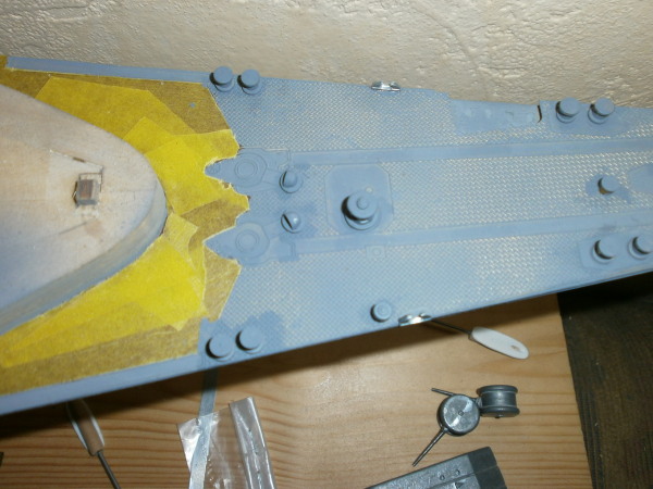

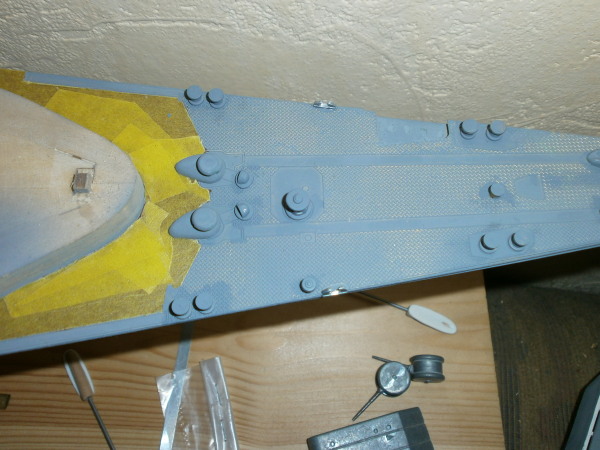

After Yaturo had posted about his enhancments of the Akagi page3 post 42, I too had in mind a way of replicating the machinery [ the anchor winches] for this area as I too didn't think that the etch outline would do. My way was to make a master mould part [pic 1] and cast a mould round it [pic 2] then use the casting kit to replicate 2 parts [pic 3], pics 3 and 4 show the deck without and with these parts.
I haven't glueed them down as yet and yes the hangar will cover this area but the winches would be able to be seen here. As always all comments /questions are welcome

Your enhancement looks great! Although these parts are hard to be found, but we can see them. I think that they should not be simplified.
