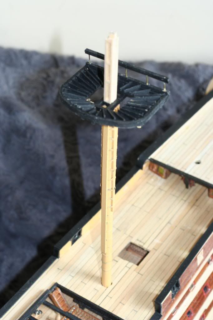

A small warning here,I was just painting the fighting top,getting on really well,put the fighting top down to dry,and getting on with something else went back an hour later,to put on another coat of black paint,when I picked it up,the fillets all came away,the reason,I'd used aliphatic glue on them,and the thinned down acrylic paint being water based had disolved the glue,again I should have read the instructions properly,should have used superglue.

Karl, the top of the mast battens are placed all around the square section above the mast top and not just the forward and aft face; see the completed mast photo on page 13 of 62 Wink
#312 Posted : 15 July 2011 13:15:17
thank you o holy one,noticed it on mag, but thought the rest done in issue 63.

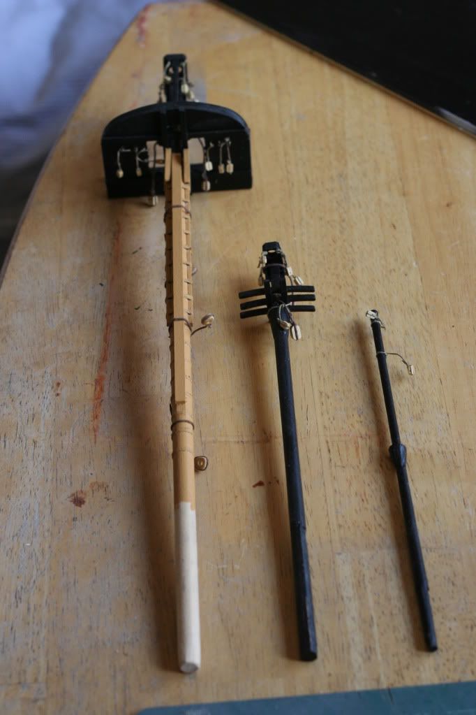

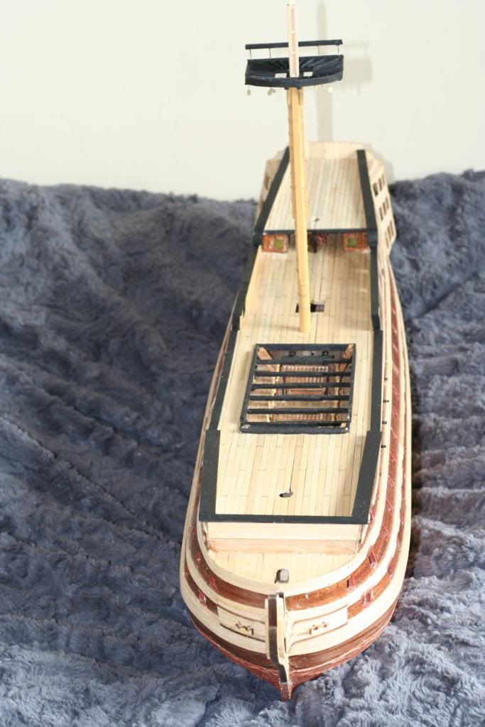

main mast almost complete,tidy up of the rest,then put away.
#314 Posted : 15 August 2011 13:25:05
Looking great KarlCool

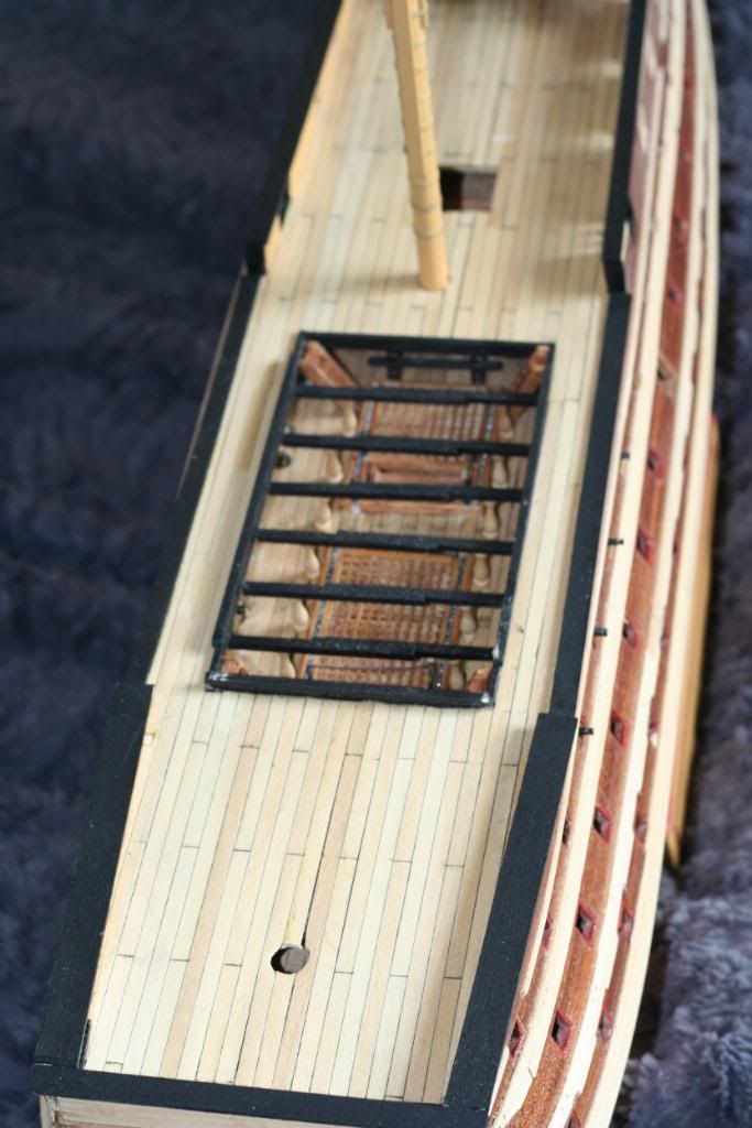

#315 Posted : 13 October 2011 17:09:34

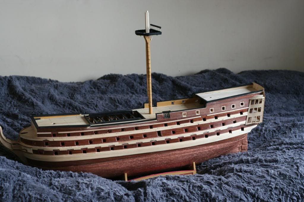

that's most up to date for now.

#317 Posted : 13 October 2011 18:51:15
Very nice indeed KarlCool BigGrin
#318 Posted : 13 October 2011 18:56:50
Looking good Karl, with the masts and yards together you get an idea of the work gone in!
#319 Posted : 13 October 2011 21:52:12
there sure is a lot of work and thanks for the comments guys.
#320 Posted : 13 October 2011 22:10:49
Looking real cool Cool
