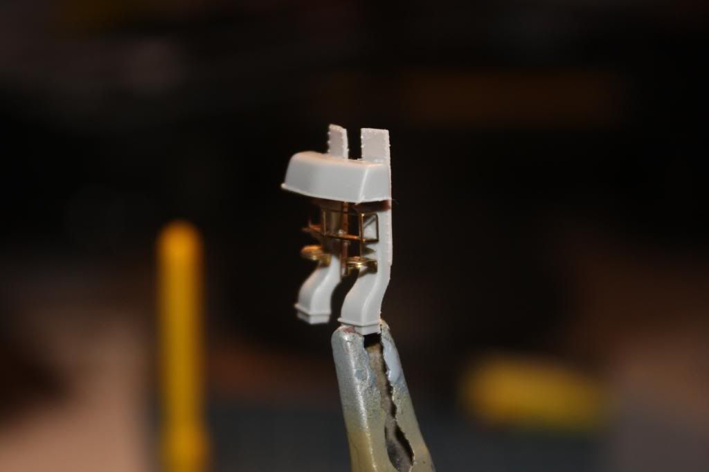

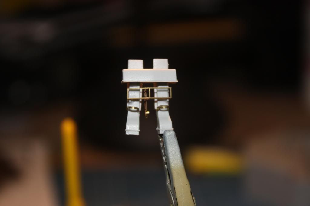

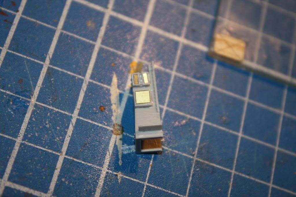

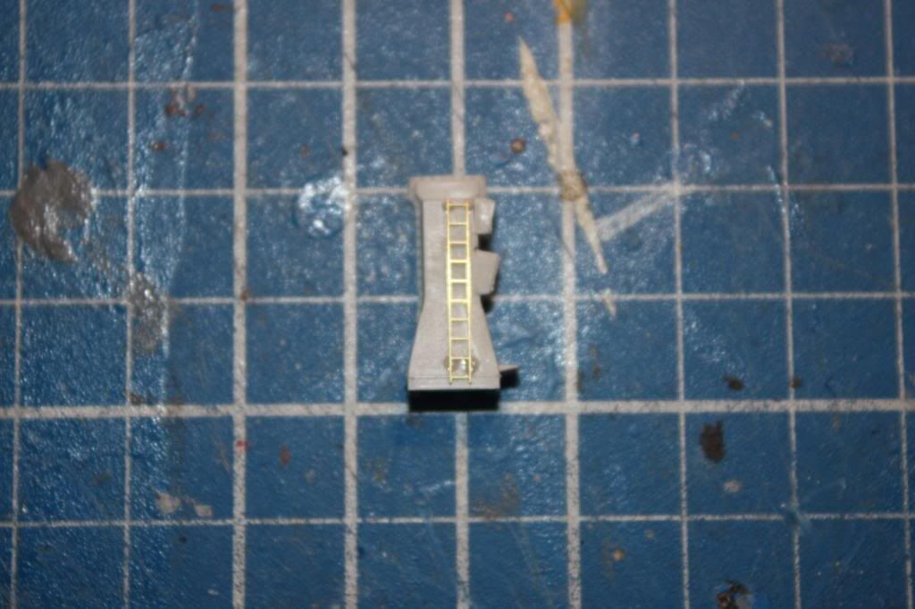

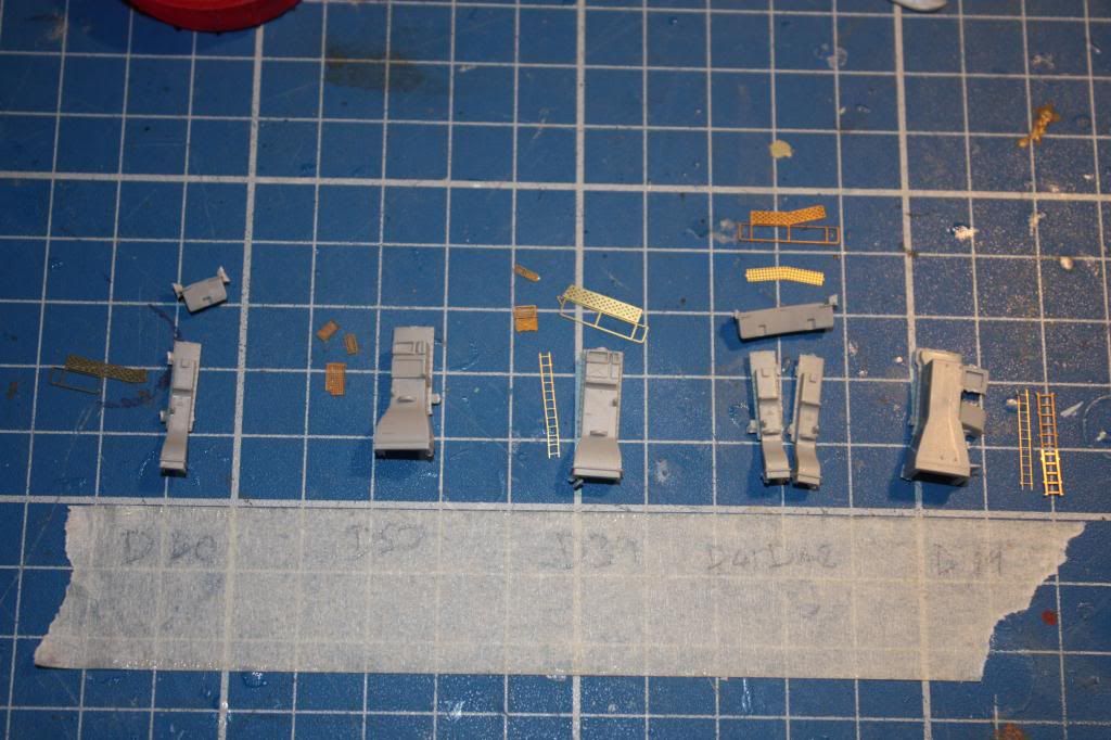

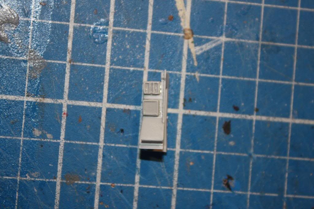

Main gun deck vents
Total build time 185 hours
Started working on the deck vents that surround the main gun mount of Bruno. Trumpeter have done an excellent job of these vents. both MK1 and Eduard offer additional etch to that supplied in the kit. The Eduard set provides replacement walkways and ladders and replace some of the moulded parts with detailed etch. unfortunately their handrails are all wrong and very delicate to fold into shape. The MK1 handrails are better but still not correct. So I have used the MK1 walkways and the Eduard parts that replace the moulded plastic. On part D19 I used the Eduard ladder but removed the tabs for mounting it. the vent already has these and unlike the Eduard etch they are in the correct position. Both MK1 and Eduard supply replacement grills for some of the vents. Eduard's sit inside the moulding where as MK1 sits on top. in the case of part D19 I used the Eduard grating because the MK1 instruction omit part numbers so was not sure which ones to use.
