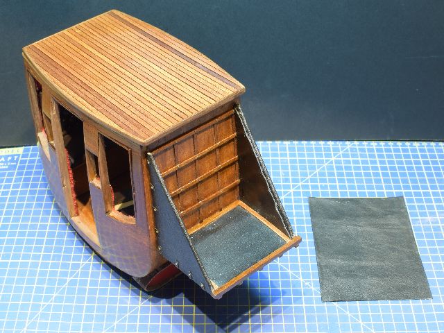

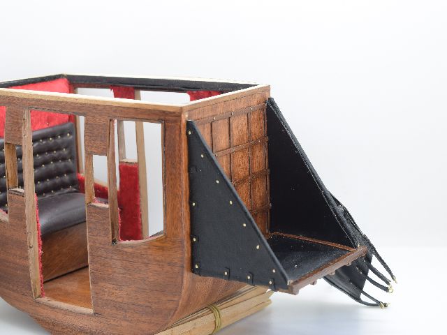

Hi
Just a quick update with both sides of the rear rack finished, now is the time to make and fit the rear back cover which has to be cut from a leather sheet supplied in the kit, first thing is to measure your own work and adjust to that ( reason no to builds are the same) then cut 4 straps to fit around the outside edge of the cover, I super glued mine on being careful not to spill it will stain.
This picture shows both sides fitted to form the rear rack sides, Rear back cover on the right.
Next to make and fit will be the back cover, this will have leather straps around with buckles, the buckles have to be made by hand I used 1mm brass and when inserting the leather straps through the buckles be sure to cut them a bit smaller than the buckles, when inserted fold-over halfway and glue, when dry glue and pin to the corresponding places on the sides and back of the luggage rack.
Back cover fitted with straps and buckles.
Trev
ps: next will be the roof rails.

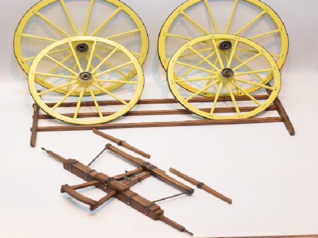

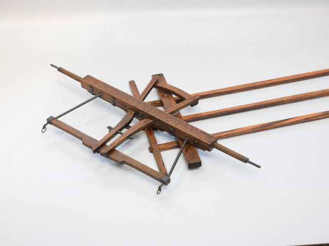

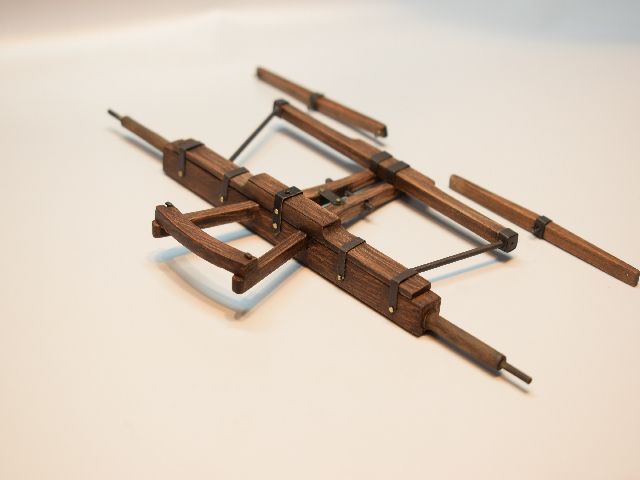

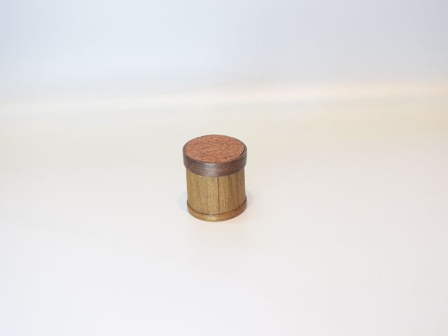

#336 Posted : 27 September 2020 18:00:39

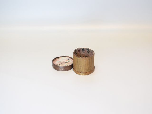

Update: Hatbox,Streering bars, and pivot point assembly.
First picture shows the hat box this I cut two 30mm circles from a piece of 2mm sheet of balsa,I then cut 18 pieces of 20 mm 5x1.5 to make the walls,when dry sanded down and stained American Walnut.
Steering assembly with carriage.
The carriage build was very strate forward 3 bars and two ends I have to add more at a later date such as brake lever and clefts, suspension brackets.etc.
Sterring took me longer than I would have thought,plenty to think about and make,and keep it all straight, also make and fit the pivot.
More soon
Trev.
#337 Posted : 27 September 2020 18:24:27
Hi Trev, BigGrin
Good to see you back posting on this excellent build.Cool Cool Cool

#339 Posted : 27 September 2020 21:48:04
Trev
Nice to see your latest build update.
The hat box looks like you have lined it with a patterned paper - it looks very good.
Tony
#340 Posted : 27 September 2020 22:12:28
Tony,
Thank you for looking, yes you are quite right I have lined with hat paper from the mid-1800s, found the pattern on the internet although in the kit you should cover with leather I tend to be a bit different and do my own thing.The next part will be a luggage box and ammunition box.
