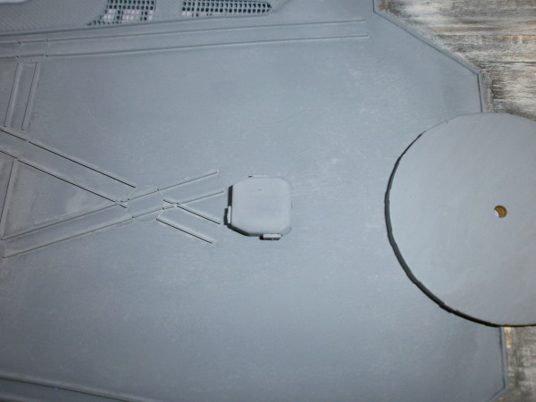

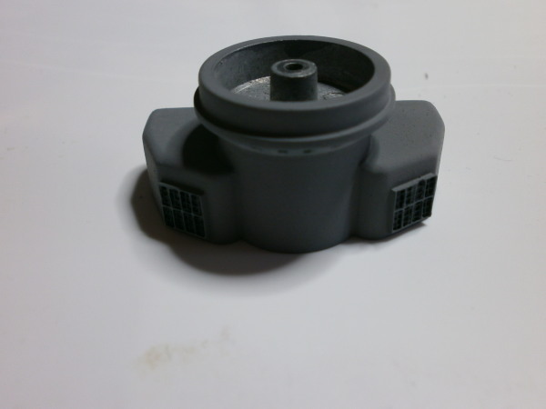

just about finished this months parts now, all three main gun battery's are done apart from the adding of the machine guns. The lower anti aircraft guns have been attached along with the 6 machine gun housings, i also added the lower gun stops, railings to the bridge structure and added the flag rigging using the black fishing line I showed previously.
The forward and rear 15 inch gun bases have been attached to the hull, just be carefull when constructing the forward 15 inch gun base as the round part to the front has an angled base to follow the deck contours so carefull alignment is a must as the download dousnt really say anything about this, what I did is to keep turn the piece in its housing when its in the correct position there is no gap between the two parts. As usual all comments/questions are welcome
