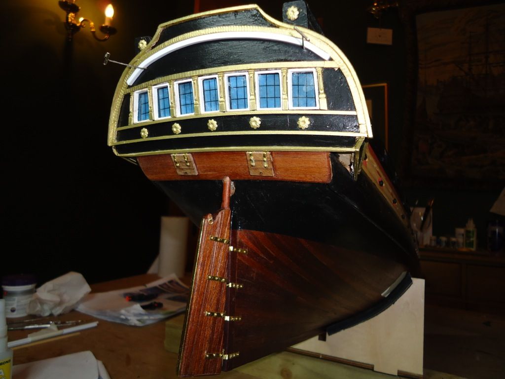

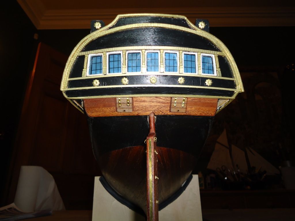

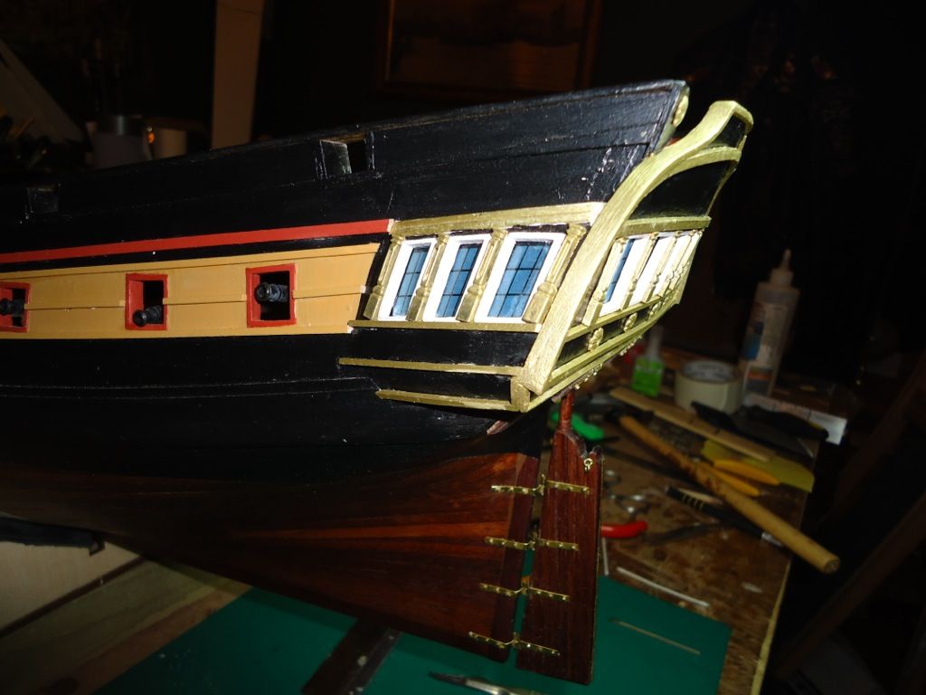

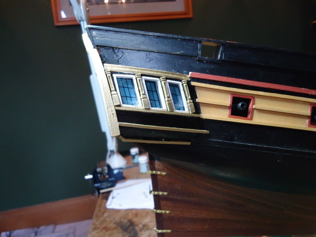

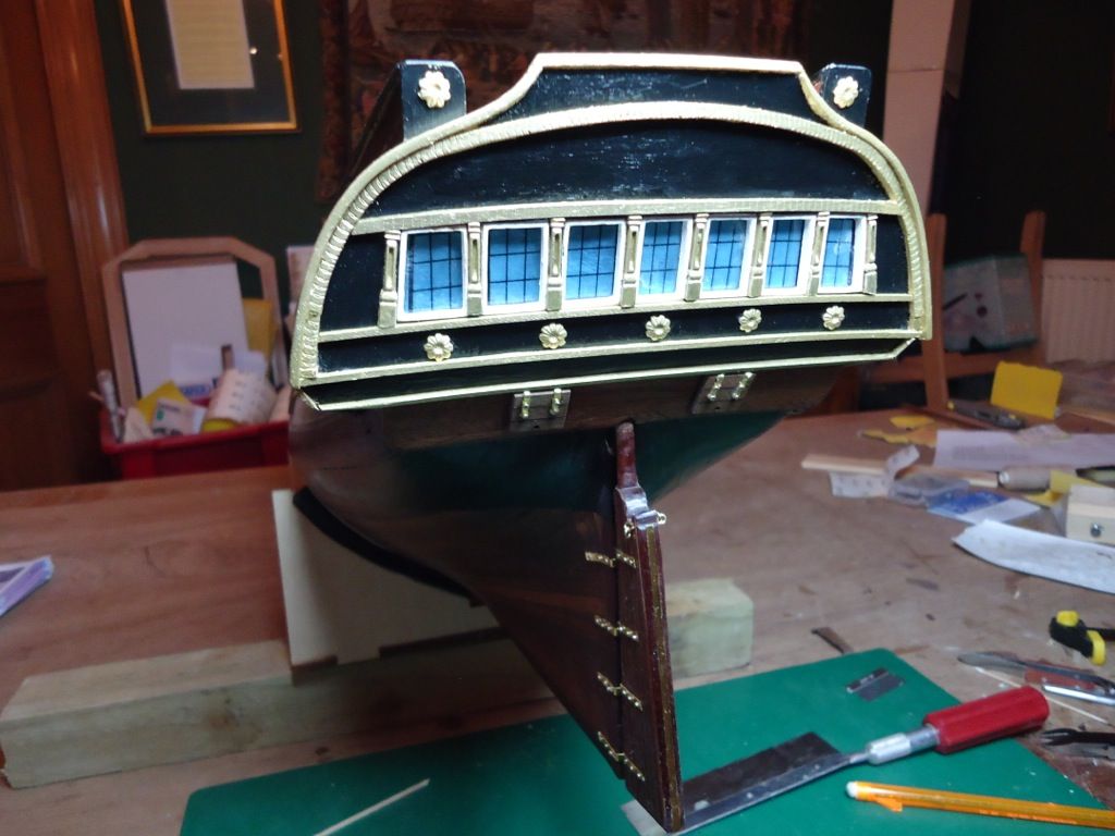

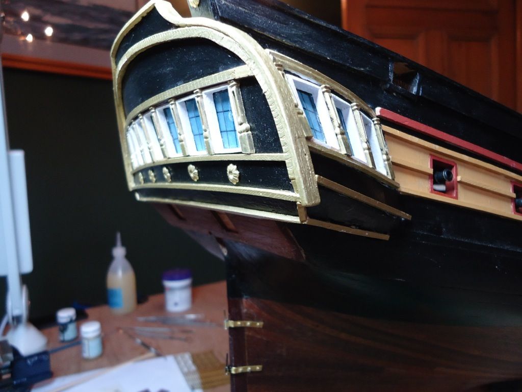

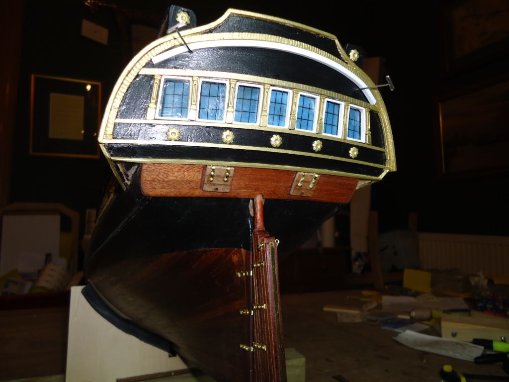

Thats the rear end all done now apart from the name, Leaving that till later, Needs to be sooooo precise, I also have to do the chains to the rudder, and give the gunport doors a coat of Danish oil. Really happy with the look.
I have painted the rosettes and the timbers gold, so I have painted the letters for the name.
I have done the side windows as well now, and added some gold embellishments, to the wood work.
Moving on to something else now, not sure what, deck furniture or the likes.
Mo

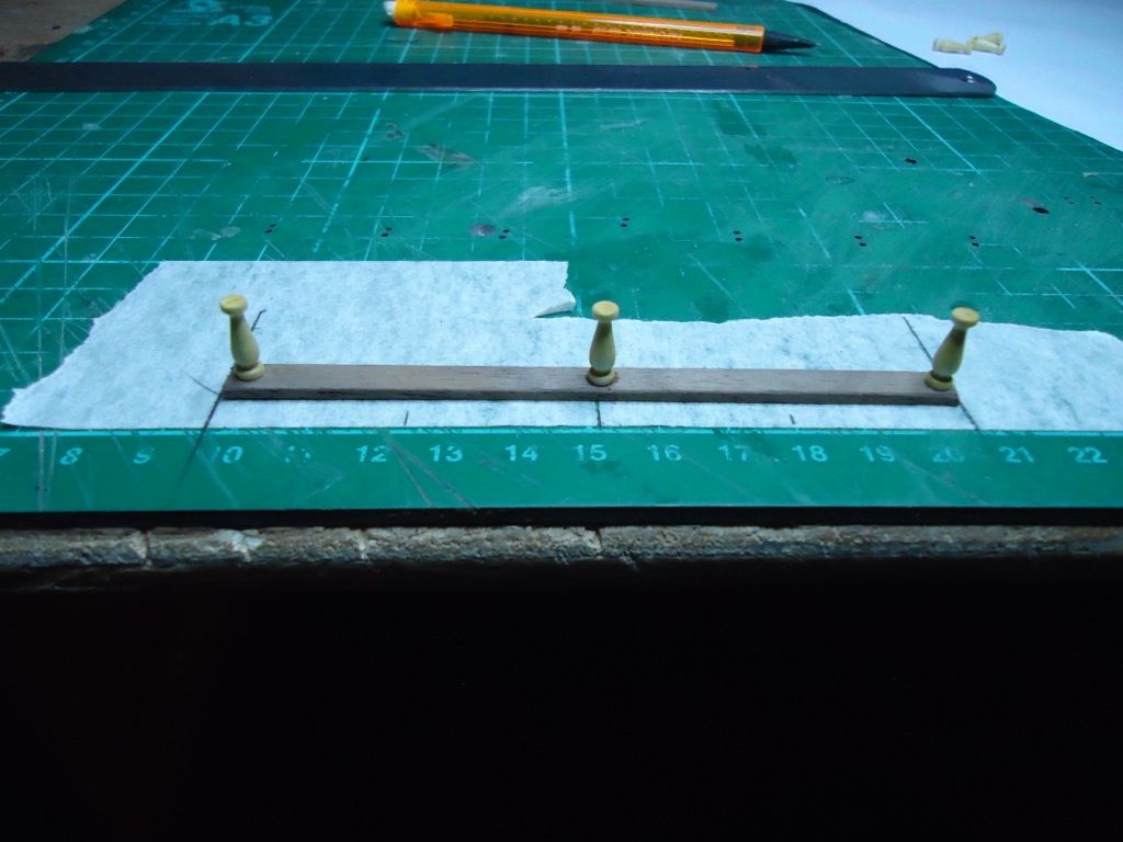

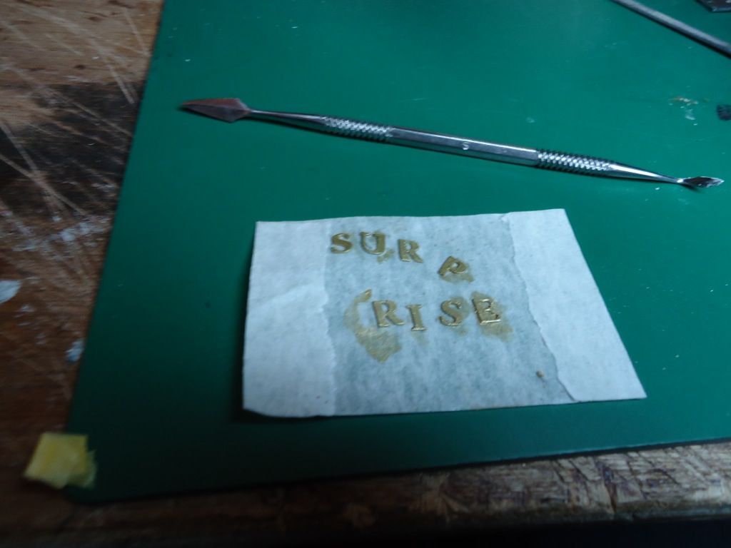

As for the lettering, I think I will stick them on to a bit of tape, face side to the sticky bit, get the spacing s right, then glue the letters, then stick the tape on to the wood, once the glue dry,s I can remove the tape, sounds ok, but will it work, not going to do that for a while yet,
Mo

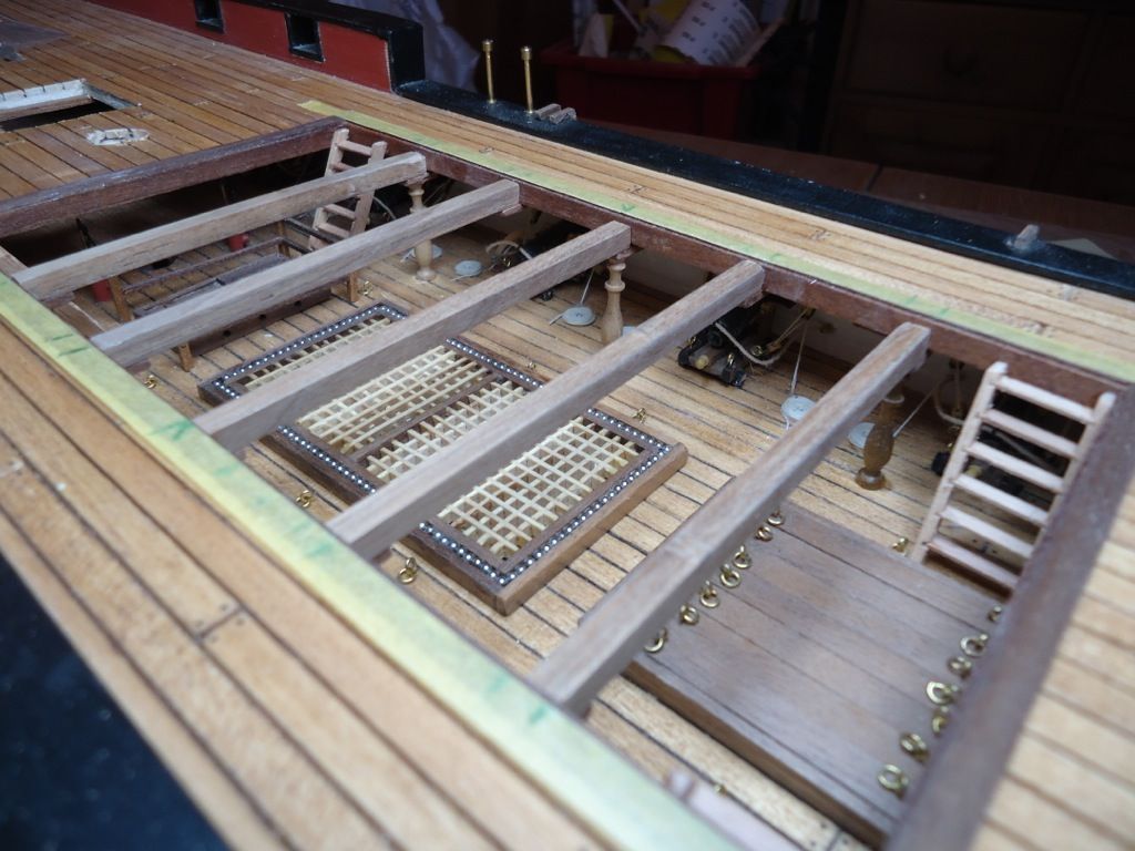

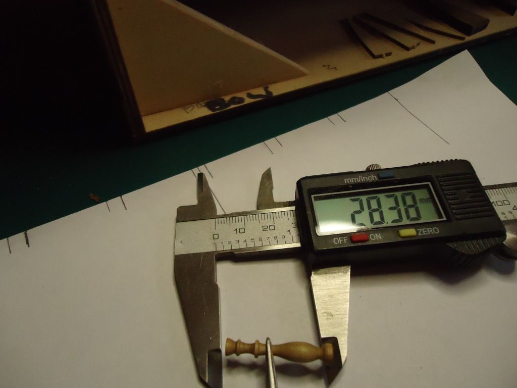

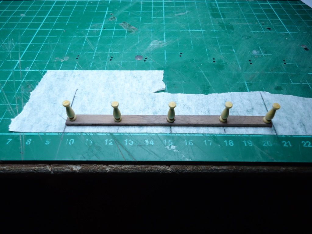

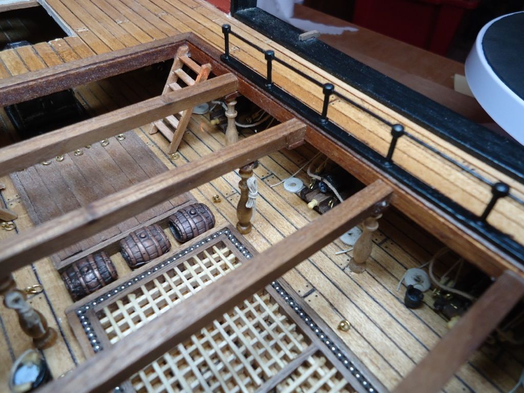

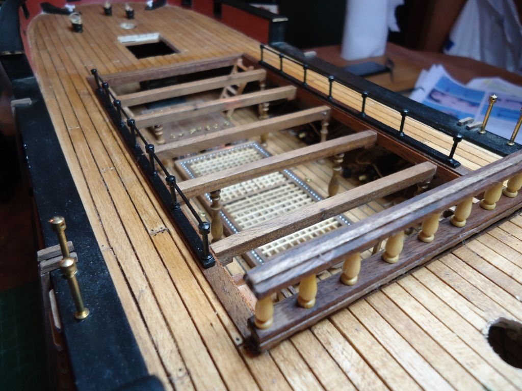

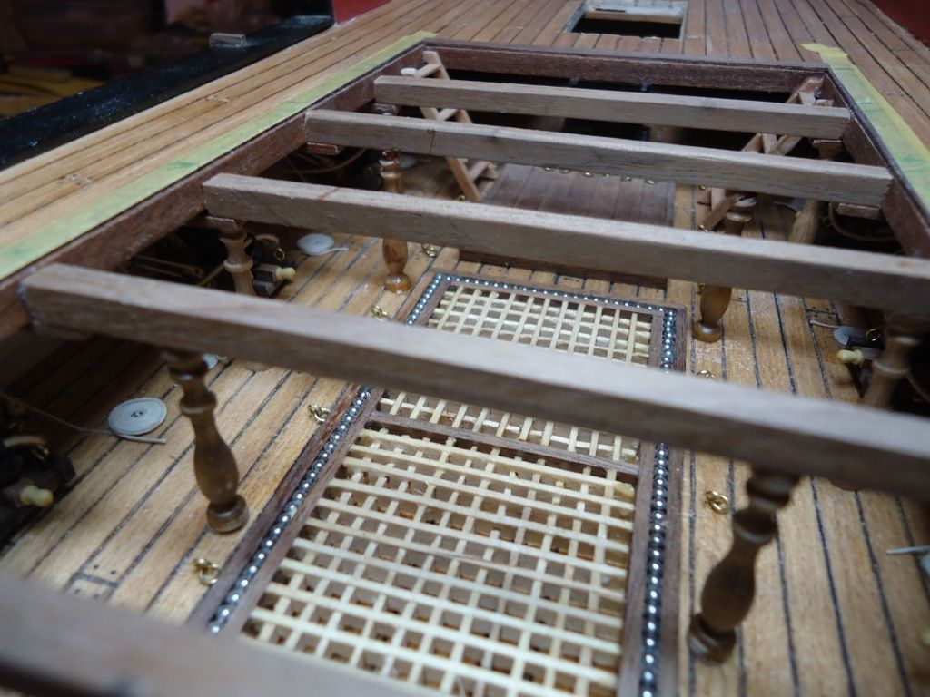

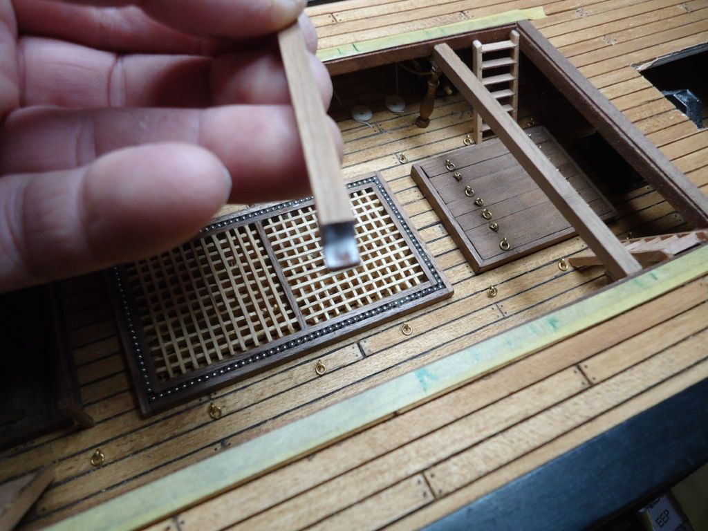

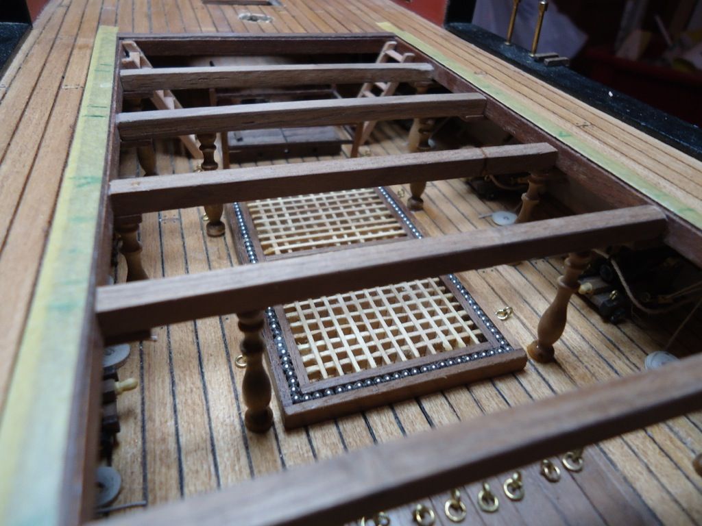

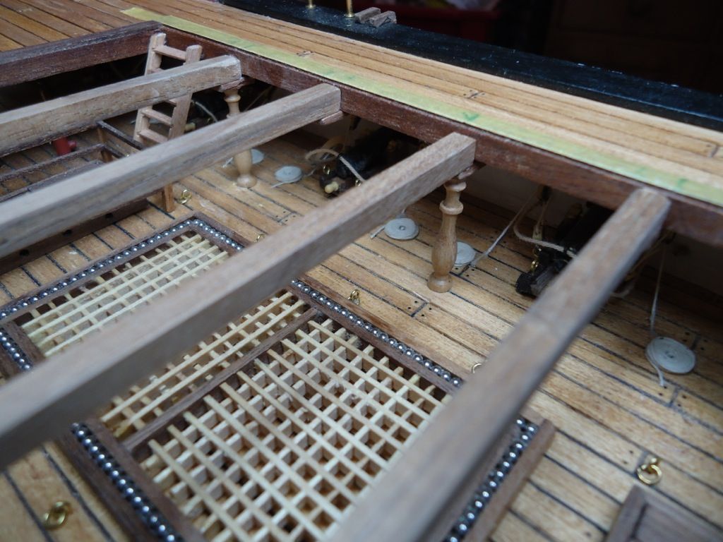

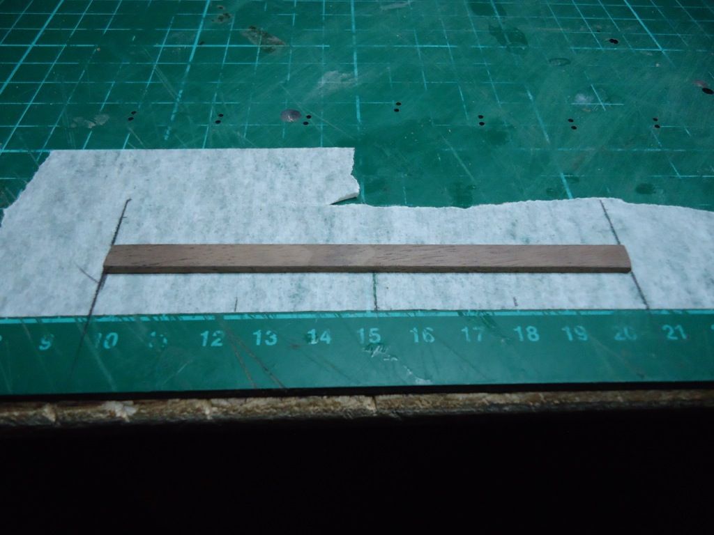

Decided to do the columns to the lower deck, as I have not finished down there yet, I bought 28 mm columns from Cornwall Model Boats, I needed them to be 30 mm but that was all I was able to get, Where needed I added a bit on the top to gain the extra height required.
My first job was to cut the 5 No cross beams, I cut the beams to length, and added a couple of cleats, One to each end to give the beams some support, this also helped with the extra height I was looking for.

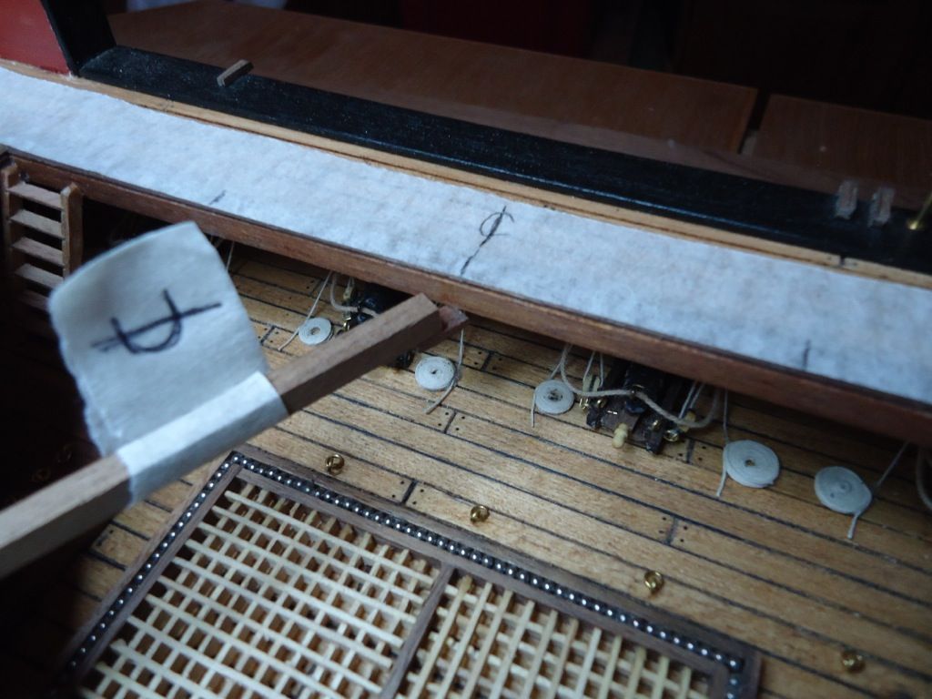

I used masking tape along the length of the opening, to mark the position of the cross beams, I then glued the beams and put in place, a good tight fit ensured they stayed where I wanted them to stay.
As I said the columns were 28 mm
I still had to add an extra bit of timber to the top of some of the columns, to get a tight fit,
I am going to see if I can get some barrels, or the like to make the deck more cluttered, I would love a small cat to put down there, anyone got any idea's on that one.
Mo

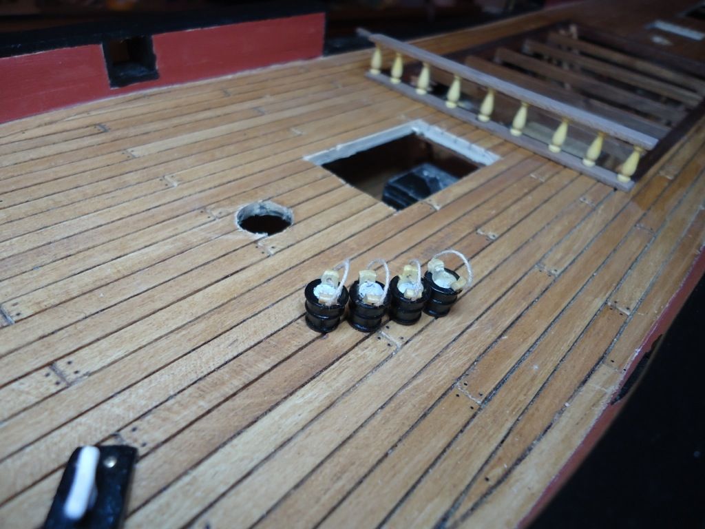

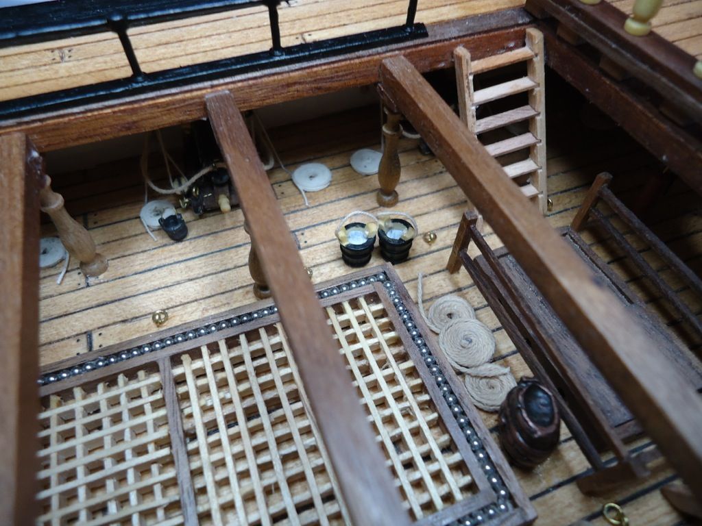

Thanks for your comments, I have now given all the timbers a coat of Danish Oil, it's all looking good now, I have stuck a few barrels and a few coils of rope down on the lower deck, looks ok, but the closer you look the more you seem to be able to do to add detail.
Will post some more pic's tomorrow.
Mo. 🔨. 📌🚢

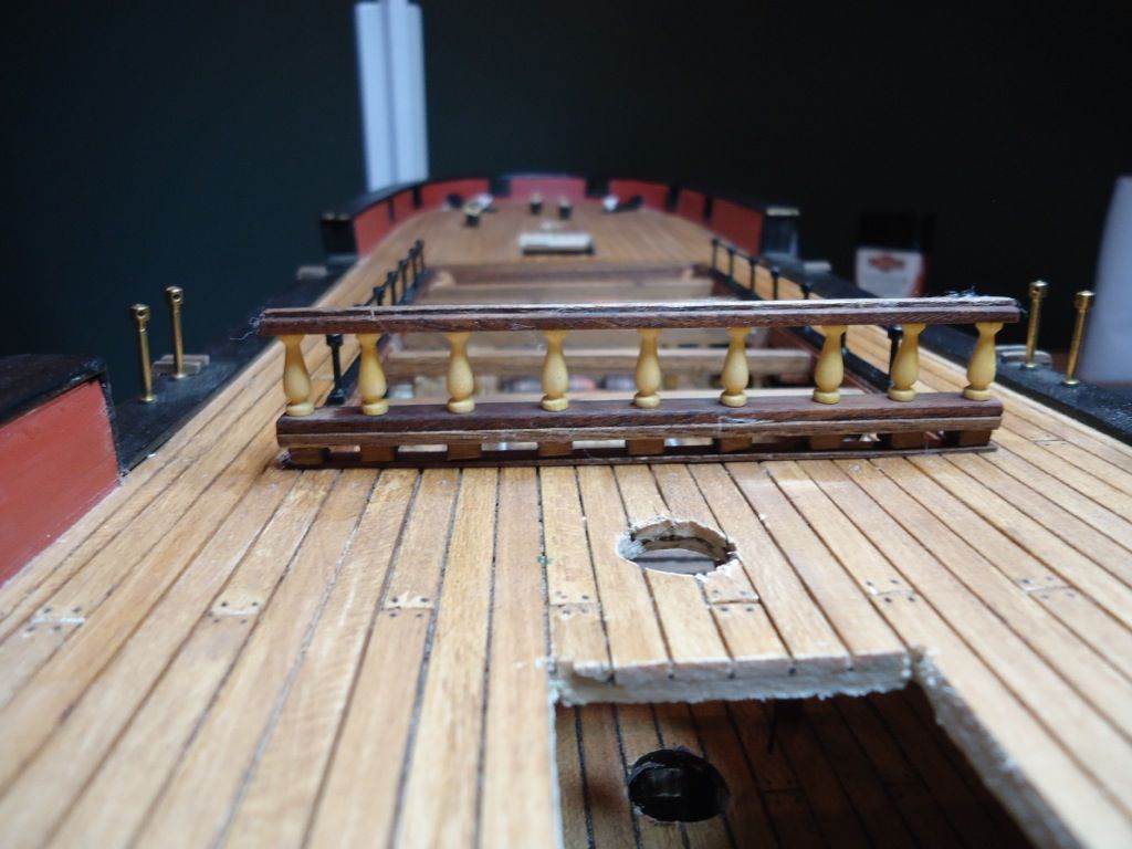

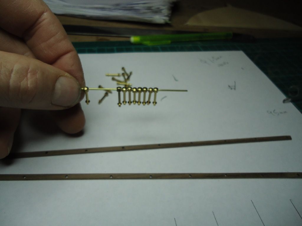

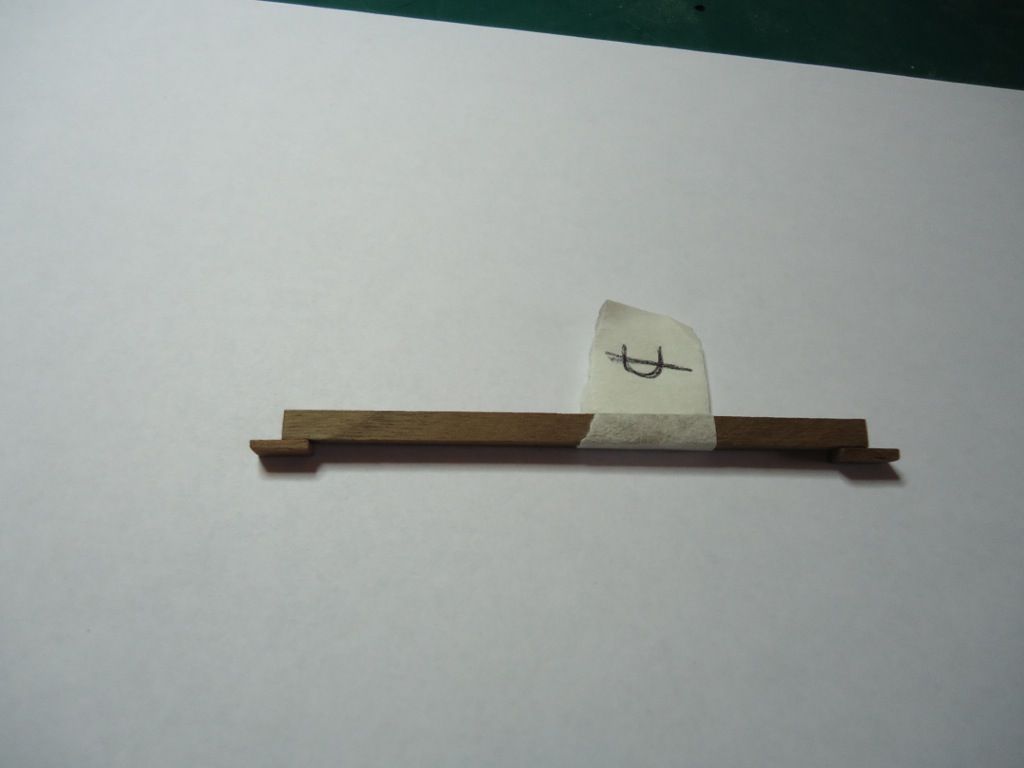

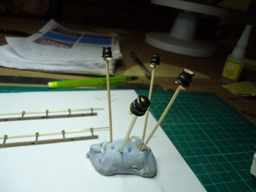

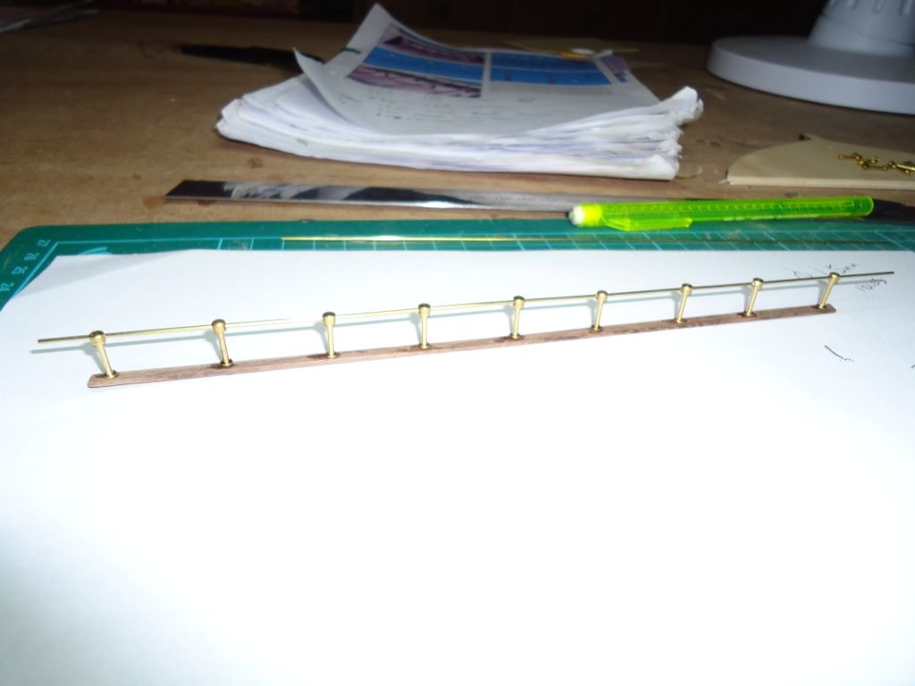

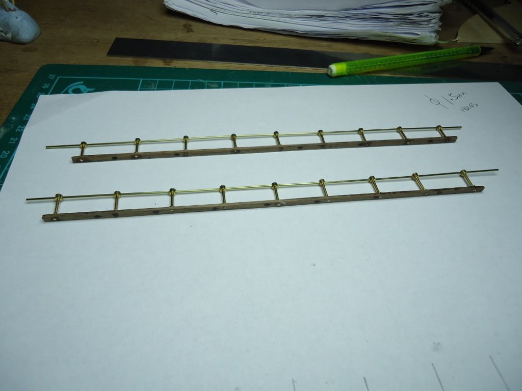

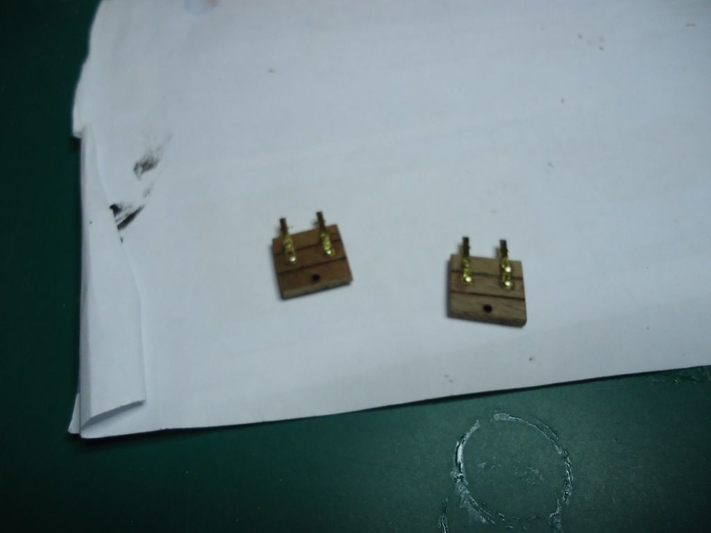

I have had a bit of time on my hands lately, so getting a good bit done on the Ship. I have been making the handrails to the cutout in the deck. I decided to paint the brass and wood black, I gave them 2 coats and seemed to cover well.
I cut the sole piece's to length, marked out the positions of the holes, and drilled them, The brass uprights were to long on the bottom, When I put them in to the holes they protruded out the bottom, so I filed a bit of the length.
I cut my brass rod, not wire as they tell you in the instructions, the brass rod will keep everything straight, and ridged. I then put all the uprights on to the brass rod, and glued all the holes, then located all the uprights in to the holes one by one, a lot easier this way, than trying to stick the uprights in and hoping all the holes are in line to take the brass rod. [size]

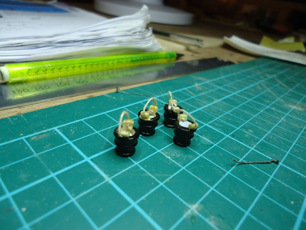

I have also got 4 buckets to put in the lower deck, I have painted them black, and put some blu tac in the bottom to make it like they are full of water.

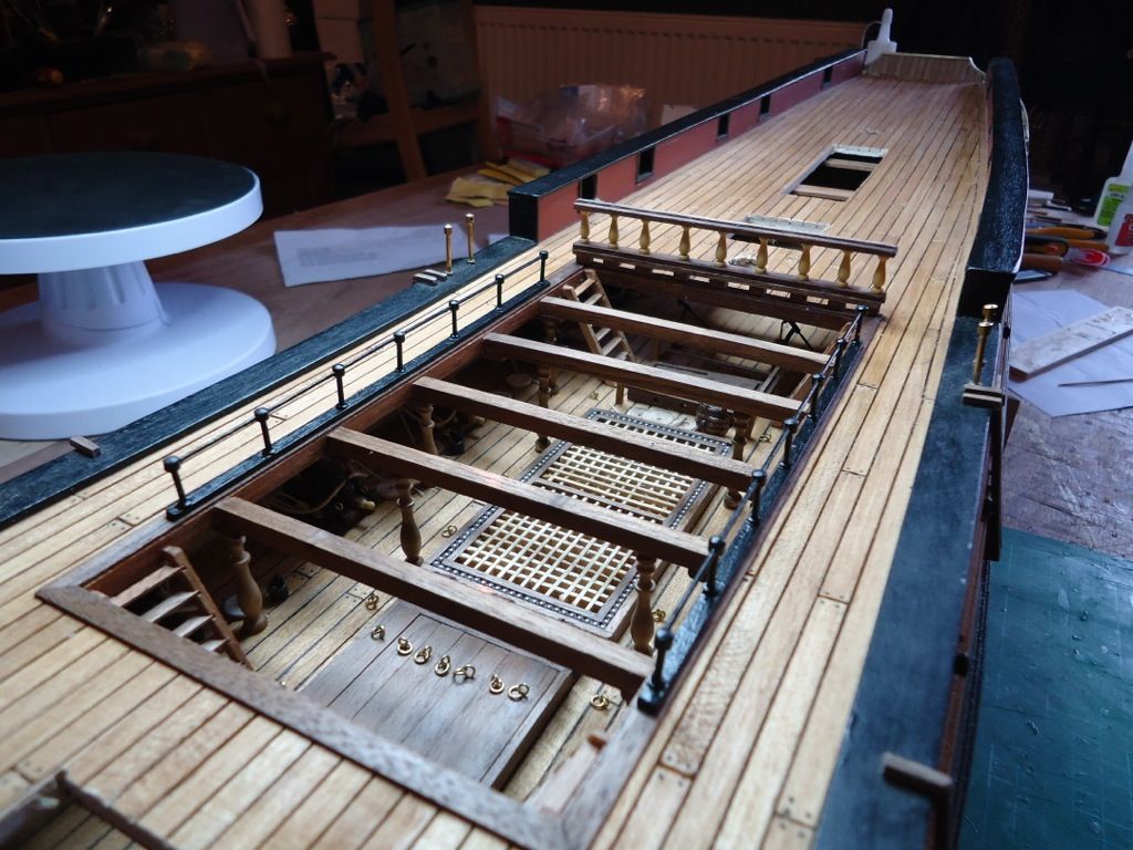

on the subject of the handrail to the opening, I cut the sole plate the length of the opening, and made the handrail at that length, but I forgot all about the stairs leading down to the lower deck, so I had to make a few adjustments.
It was then on to the balustrade detail at the stern end of the opening, Much the same as the metal one,

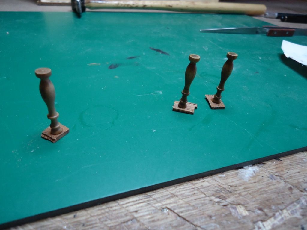

Now the 5 mm x 5mm x 5 mm blocks to the base of the balustrade, I kept the end grain of the wood horizontal, and not vertical, this ensured all the blocks were the same size, the thickness of the timber and not the size of the blocks I cut, Hope that makes sense.
[size=7]I have also tied my first rope shank, drilled a hole in one of the columns and hung the rope from there, a bit more practice required on this item.

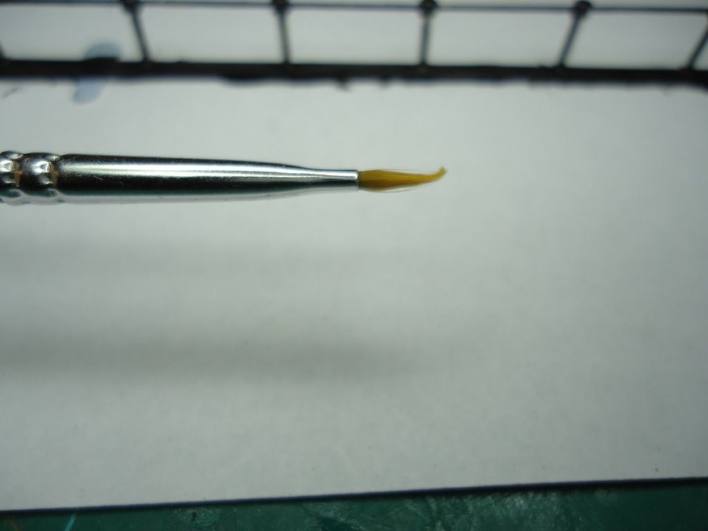

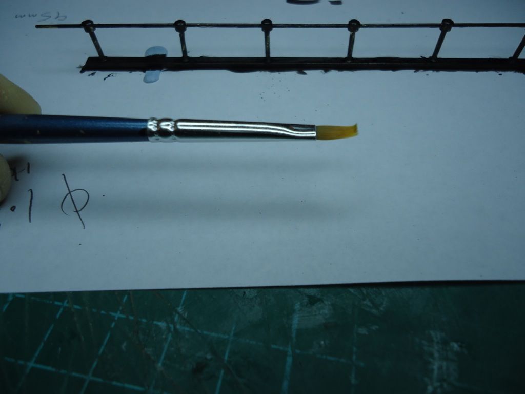

I have a problem with one of my paint brushes,
can anyone tell me whats happening here, every time I use the brush I clean it well, and always use the proper rinse wash I bought from Cornwall Model Boats, and I use my fingers to shape the brush before putting away.
Mo
Mo
#356 Posted : 14 February 2013 18:59:14
hi mo,do you stand them up on their bristles???? naughty naughty,store them upside down and all will be well.BigGrin love the build.
#357 Posted : 14 February 2013 19:05:35
Have to agree with Karl, it looks like its been stored bristles down!BigGrin
Mo
#358 Posted : 14 February 2013 19:47:16
Joined: 09/02/2012
Posts: 569
Points: 1,675
Sorry guy's but never bristles down, always blunt end down,
Mo
Mo
#359 Posted : 14 February 2013 19:53:47
hi mo,can you take a pic of your brushes stored please?
SennaMentalMe
#360 Posted : 14 February 2013 20:54:16
Hi Mo,
They look like they are synthetic bristles in your brush and one of the major problems with synthetic bristles is that they can end up with a 'Set' or bend in the bristle which is usually due to one of several things:
1. The cleaning solvents used haven't been fully cleaned out, even though you might think they have, which can then have an adverse effect on the synthetic fibre and cause it to curl one way, because of the aggressive nature in the solvent which can really play havoc with the make up of the fibres and their ability to return to their normal shape after bending whilst applying the paint.
2. Are you guilty of 'pushing' the paintbrush? Pushing, as in when you are trying to get the paint into crevices, etc, can be very destructive to finer brush fibres and is a sure way of damaging them. Always try to 'pull' the brush if possible, that way you will keep the fibres aligned as you paint and they won't 'set' into a curl. If you have to 'push' into tight areas, try keeping a cheaper brush with thicker, stiffer fibres, like an artist 'Hog' brush alongside your better brushes and use them for when you have to push the paint.
3. Clean your brushes regularly, even mid job if needs be, as paint can easily wick up the fibres to the ferrule if the brush is used for an extended period and will then be the devil to clean out properly, which if it isn't, will also cause curling and splaying of the fibres as it dries. You should only ever load the brush with paint up to about one third of the length of bristle and that way you will keep the paint from getting to the danger zone nearer the ferrule. Also, NEVER leave your brush tip down in the cleaning medium, be it water or solvent, even if it is temporarily for a second or two, whilst you stop painting, as that will almost certainly create a set in the fibres, since it will put the fine fibres under pressue which it may never recover from!! When painting try to only use the tip as you paint and WITHOUT applying too much pressure which again can cause a 'set' to the fibres and try to rotate the brush as you paint so that you aren't using only one side of the brush.
I am an artist when I'm not a modeller and I can tell you that some of the more expensive brushes like sable really need looking after if they are to be financially viable and a good tip that I can give you is to use a normal hair conditioner on the brush fibres AFTER you have fully cleaned it. Just clean it thoroughly, apply the conditioner in its' undiluted form, to the bristles then shape the tip to however it should be and store it tip up until next time you want to use it, when you just wash it thoroughly in warm clean water to remove all the conditioner and dry before using. Or you can just shape the fibres after cleaning and then wrap them in a little roll of wet tissue, which when it dries will keep the fibres aligned until next time or you can use the little clear tubes that some of the better brushes come with to protect the fibres and maintain their shape, as that is what they are for.
Hope that helps?
