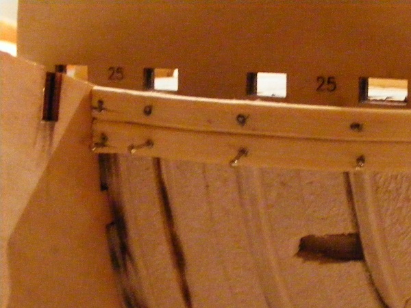

Finished fairing the hull and now started the infamous planking stage... Following Mr T's official build have made a start on the stern section... hopefully will finish this part off during the next session. Have to admit, found bamboo easy to manipulate but, will also add it is difficult to cut cross grain with a modellers knife. Cut to length using a razor saw.... much easier..... Should make cutting out of gun ports interesting.....Laugh

Looks great.
You're right about the gun ports though. I think that will prove incredibly difficult. Unless the more experienced have any killer tips.

My method of cutting small square holes, is to drill a small pilot hole in each corner, and then cut out the hole very carefully with a cutting disc in a Dremel.
Thanks for the tip Denissimo, I have a dremel and small cutting discs so I think a practice session may be called for..... Thanks for looking in....

Thanks for the comments Admiral, appreciate it.... I found this blade in my Draper modellers knife set. It's like a razor saw, works well on bamboo but only on the forward or backward stroke depending on which way you insert it into the handle.... Gives a clean cut and just may help with the cutting out of gun ports.....

Have finally made a start on planking.... Taking it nice and easy and so far I like how it's coming along. Did find though I needed to pre-drill the pin holes with a .5mm drill in order to stop the planks from splitting. Think I am going to enjoy this part of the build, may not be saying that a few weeks in but we will see.......Blink Blink
