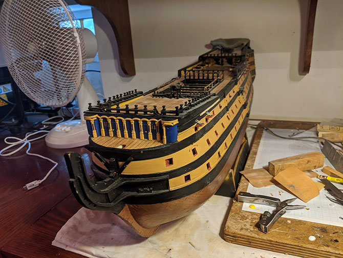

So this will be my last post for the year as I return to the UK soon until next February. Certainly many have suffered but TBH, being in a lockdown is not really a hardship for a modeller I guess! Completed stages 85-88 now, and it’s been slow, mainly because of the great summer we have had here and a few other projects.
TIP #1
Be careful when drilling out the holes for the heads. The instructions say we need to use a 3 mm bit, but it is easy to destroy the thin wood used for these. I used 1 mm and then a 2 mm bit for the pilot holes first and then simply turned the 3 mm drill bit by hand to cut the final hole. All safe and sound that way
TIP #2
I have mentioned before about using drill sizes smaller than recommended when using nails as pins or placing eye bolts. For the knight heads and kevels, the instructions suggests using a 0.7 mm drill, but I found using a 0.6 mm gives a tighter and better fit.
Not much else to comment on so here are the pics.
You can see the poor manufacturing of the casting here, to say nothing of the wrong parts being included. As if I don’t have enough problems to solve.
As you can see, I have plenty of implements I can use for bending the wood.
As I was looking at the gallery, something didn’t seem right, The balustrades we're not sitting correctly. Checked the port side, and they were OK, so had to rip them out and reseat them.
TIP #3
Fitting the stem decorations. This is really for anyone who has not yet reached Stage 44. The stem decorations should go between the stem trims but, mine were placed too close together. Had I known this back at stage 44, I could have placed them slightly further apart. Anyway, I don’t think they look too bad where they ended up, which is as high as they go.
I decided to have a go at paining the blue stripes in the bow frames rather than leave them yellow. I had 1 mm and 2 mm masking tape but neither looked right. 1½mm would have been best. Still some touching up to do, but it looks OK.
[img$http://www.bpgrp.org/images/victory/Oct20(26).jpg[/img]
And finally she comes together, although still a lot to do.
