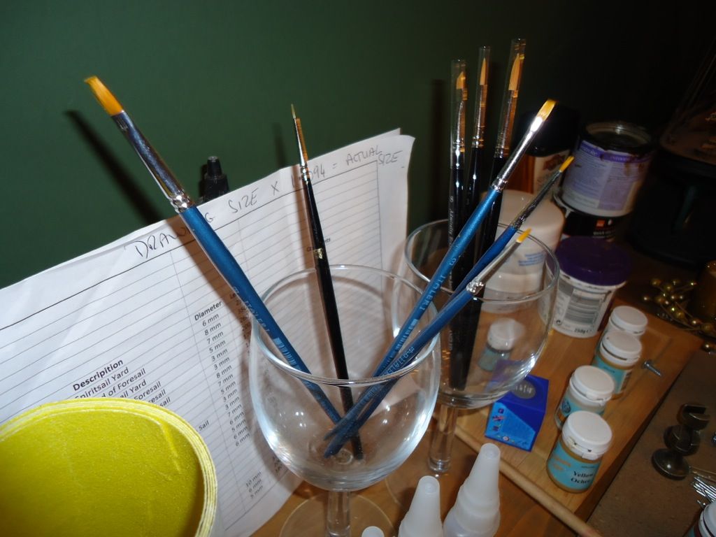

On the subject of paint brushes, I see there are brushes from size 000, 00, 0, 1, 2 and so on which is bigger, a 000 or a 4
Mo. 🎨.
Mo
SennaMentalMe
#365 Posted : 15 February 2013 00:17:39
Hi Mo,
The '4' is bigger than the '000'.
Below is a list of the Artists' Brush sizes commercially available as quoted from the Wikipedia page on brushes (sub heading - Artists Brushes). Although I call them artists brushes, the term will include the types of brushes used for craft and modelling work as well. Brushes used by Painters and Decorators have a different sizing system, which is usually given in both the old Imperial inches and the Metric millimetres sizes based on the physical dimensions with regard to the width of the brush at the bristle end of the ferrules, as in 1"(25mm), 2"(50mm), and so on.
From Wikipedia:
Artists' brushes are usually given numbered sizes, although there is no exact standard for their physical dimensions.
From smallest to largest, the sizes are:
20/0, 12/0, 10/0, 7/0, 6/0, 5/0, 4/0 (also written 0000), 000, 00, 0, 1, 2, 3, 4, 5, 6, 7, 8, 9, 10, 11, 12, 13, 14, 16, 18, 20, 22, 24, 25, 26, 28, 30. Brushes as fine as 30/0 are manufactured by major companies, but are not a common size.
Sizes 000 to 20 are most common.
From the list above size 20/0 is tiny through to size 30 which is huge.
I have a 5/0 brush in my arsenal which is very small so you can imagine how tiny a 20/0 really is, though I've never seen one!! You can see from the list that 4/0 is sometimes written as '0000' which is how they get the title 4/0 (4 x zero), so using that system if you ever see a brush labelled as a 3/0, a 2/0 or a 1/0 (unlikely nowadays), then they will be the same as a '000', '00' and '0'.
Hope that helps and is clear enough?

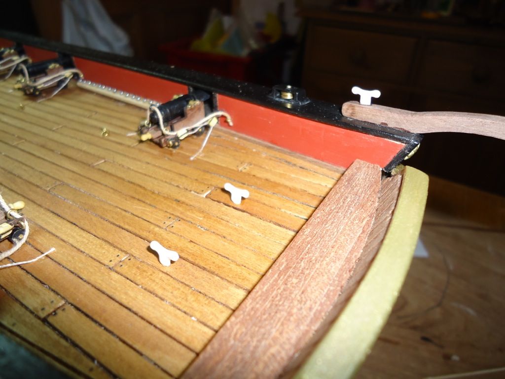

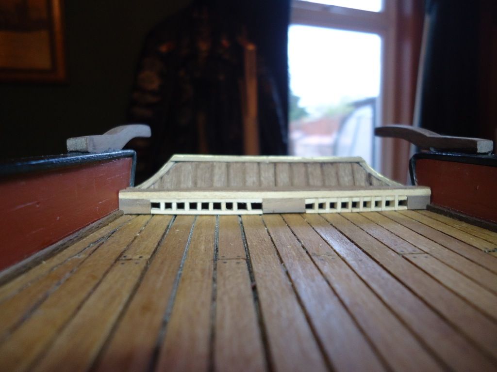

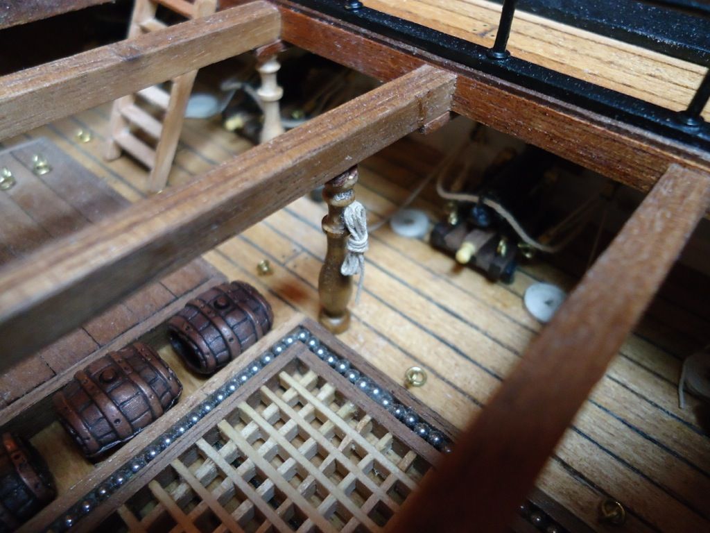

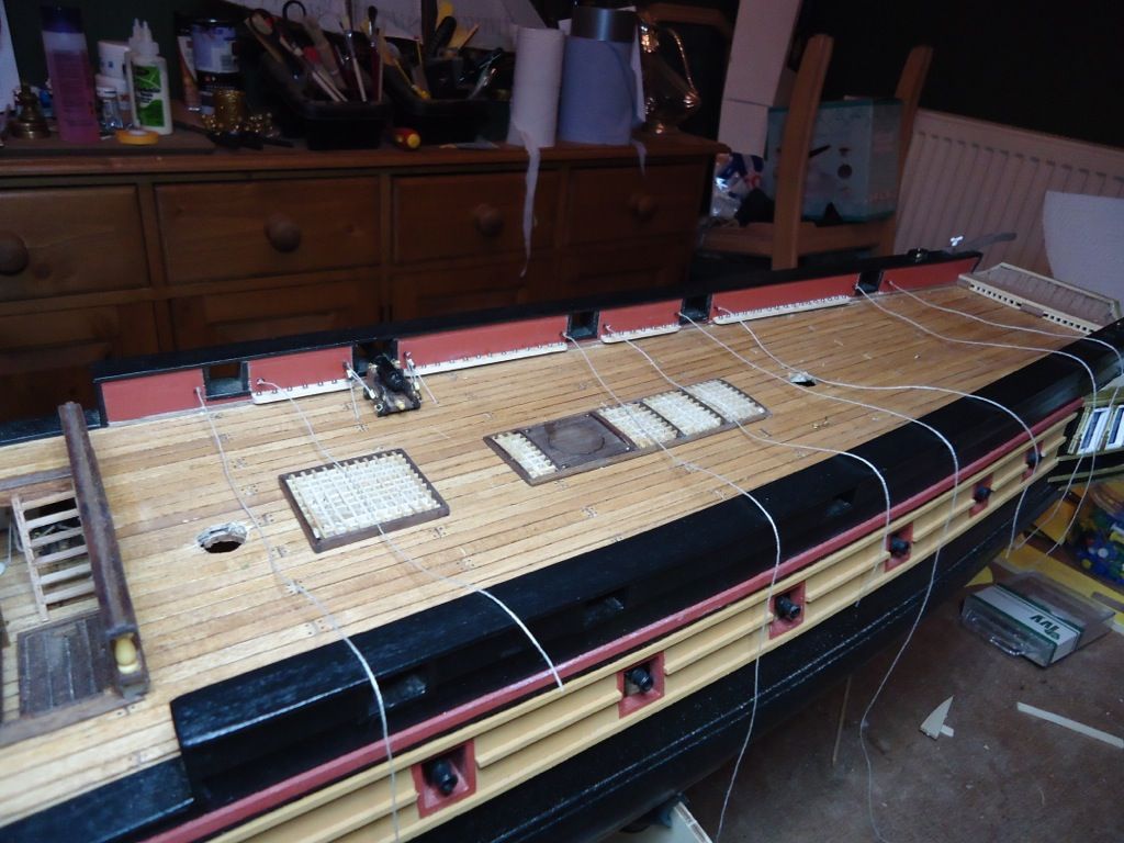

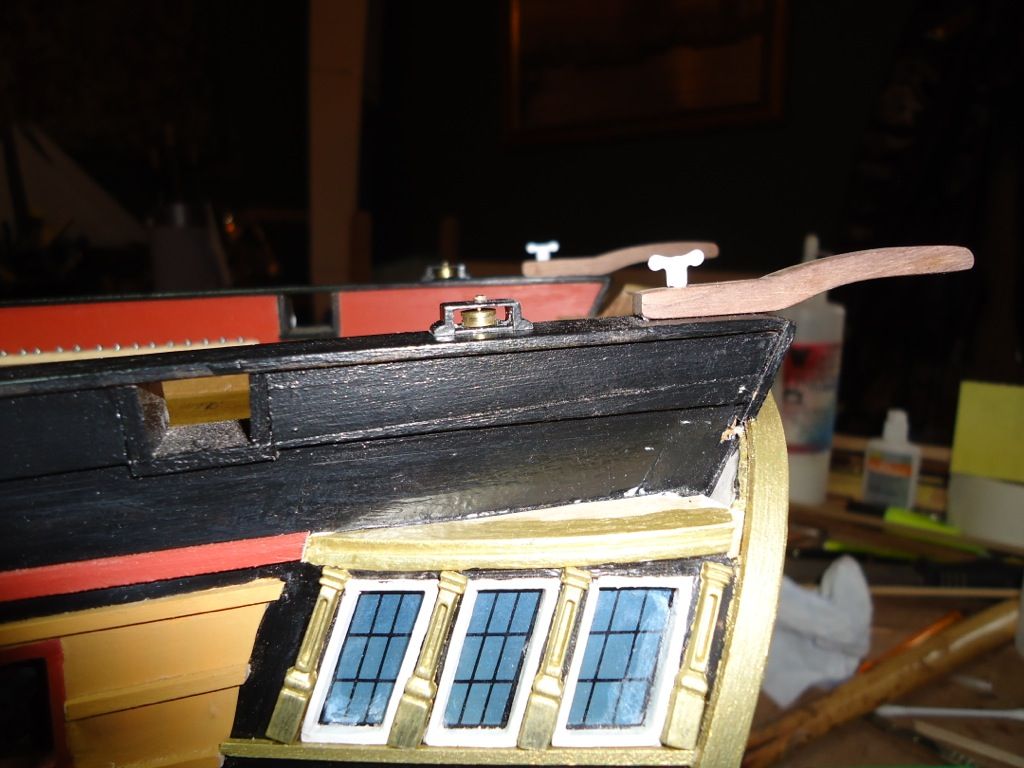

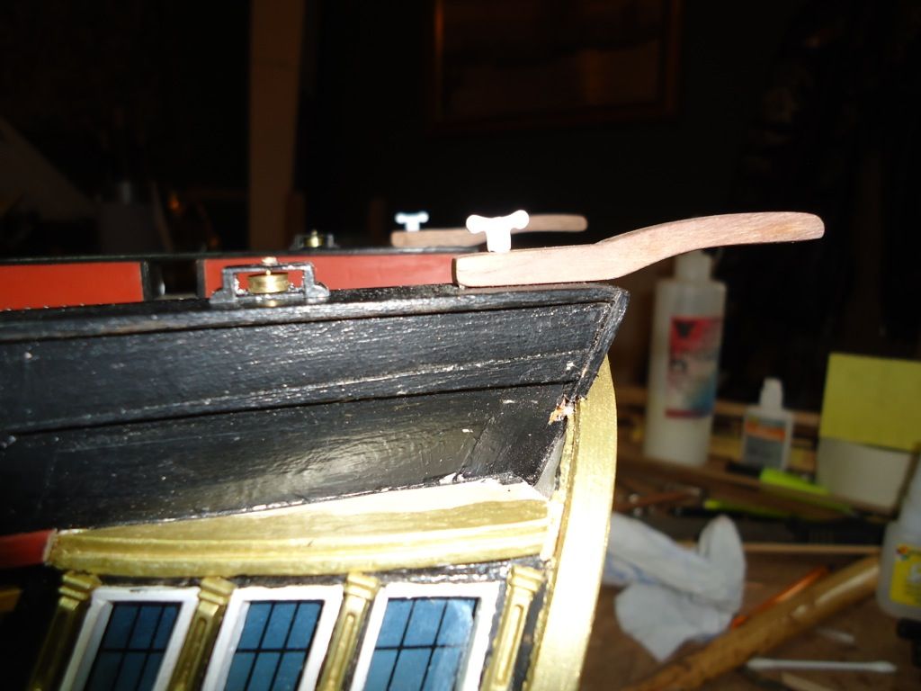

Making progress now, I have been making what I think is the flag box at the stern. Quite a fiddly bit to do again, but really happy with the results.
I put some really thin sapelle on the top of the box, and will give a coat of the old faithful, Danish Oil later.
My favourite, a little rope hanging from a column.
I don't know what these things are called, and I don't know what they are for, But they are done.
The instructions next told me to make pin rails, So I did. 2 set's
I have also made and fixed the rails holding the cannonball's, will look for the picture's and post.

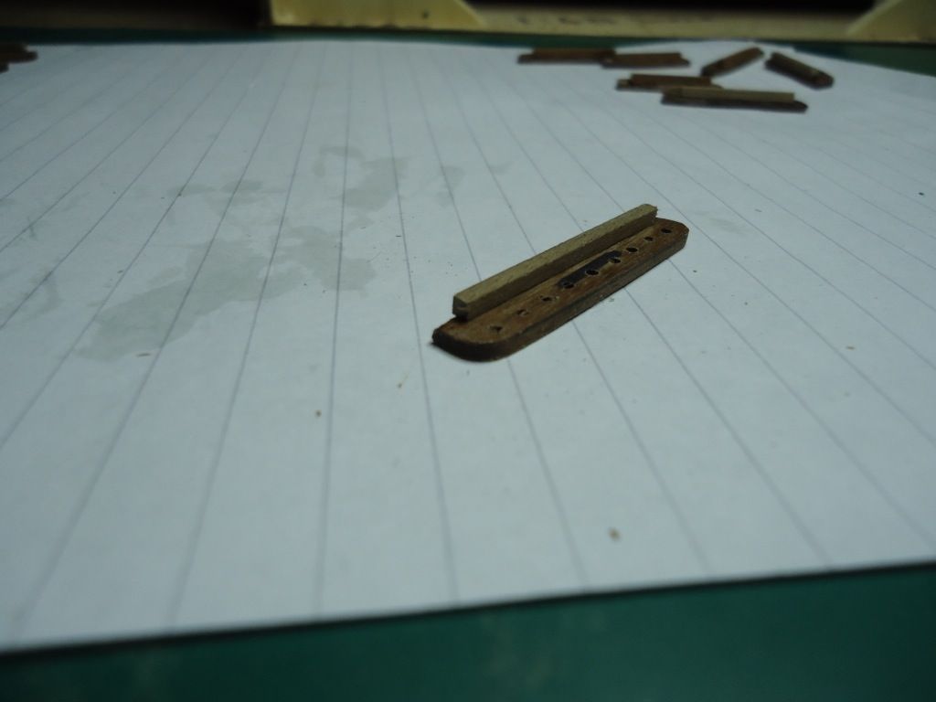

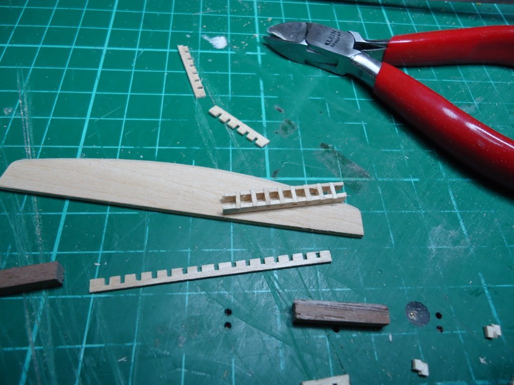

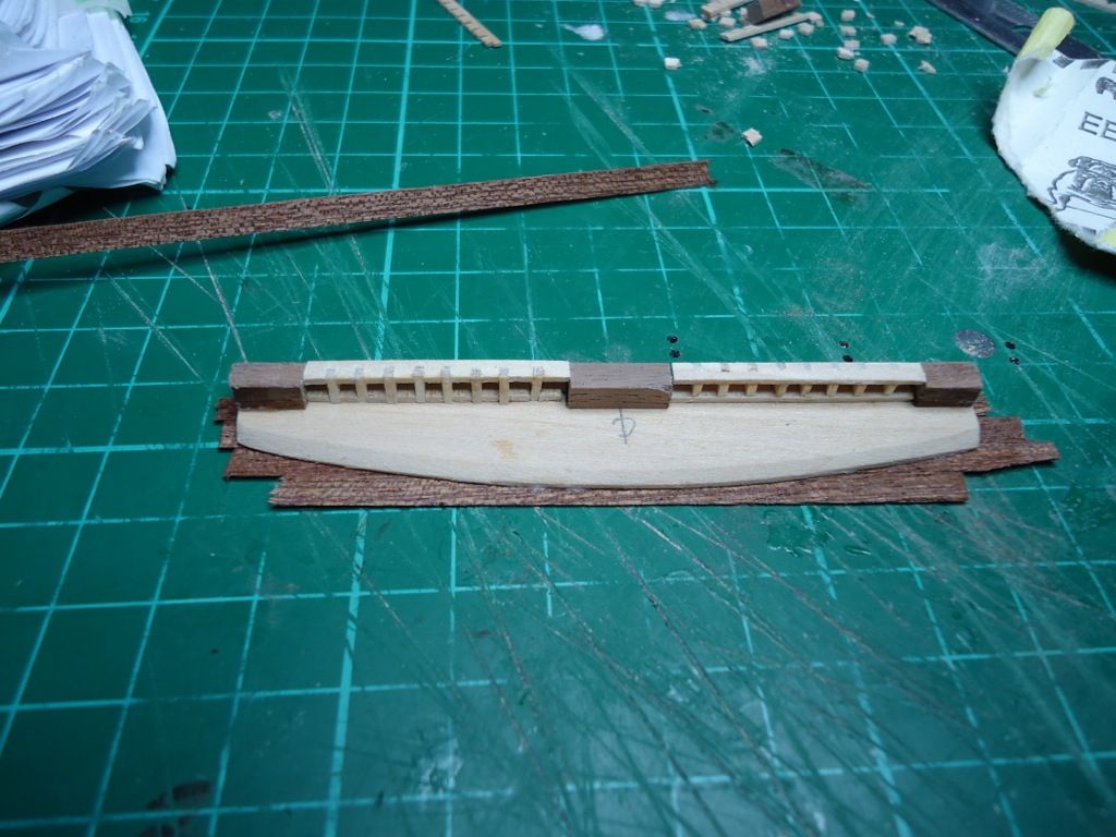

The racks for holding the cannonball's, easy one this. Just cut, a little drilling and glue in place. I put the 1.5 x 1.5 mm walnut round the joint of the bulwarks and the deck, the racks sit on this.
Speak soon, Mo

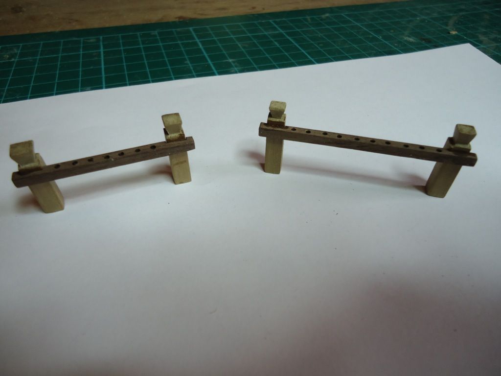

Iain, you said in a earlier post, to keep my belaying pin racks, wide enough to clear the capping's and not to low, would you suggest doing this before fitting the cannons, when you say wide enough, is that for the overhang of the capping to the bulwarks. Do the rigging lines actually go through the holes in racks, and then the belaying pins put in to jam the line tight, or are the rigging lines tied off around the pins without going through the hole's.

Hi there Mo, the pins will go through the holes you will make in the racks. The ropes will then pass underneath the pins and loop over the top and round the back in a figure 8 style just like the real thing. If you have done an overhang on your cappings and not done it flush to the walls it will be a struggle at best to wind the ropes round the pins therefor I suggest through expierience that you make the wood shelf for the pins about a 1mm or so larger than the plan suggests. this will then give you the clearence depending on your capping overhang for the ropes to pass round. I also suggest you fit these before or at the same time as the cannon because some are situated in the same place as the eyebolts for the securing of the cannon to the walls. You could end up with the opposite and not being able to pass the ropes under and around the pins. Hope this helps. I would also suggest an ideal hieght for fitting would be so that you can see about a 1.5 or 2mm of the pin above the capping. All will become clear when you start belaying or fixing your ropes to theseBigGrin .

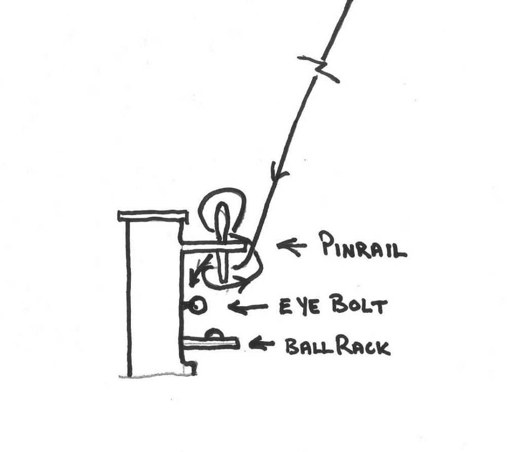

#374 Posted : 17 February 2013 11:42:24
Joined: 13/01/2012
Posts: 605
Points: 1,630
Location: Bucks
Just done this little drawing Mo, hope this makes it a little clearer. Good idea about jamming the thread into the hole before fitting the pin but you will find you are going to use different guage thread and you might not be able to get the pin in and in doing so you will rip the shelf off the wall. I reinforce mine with a bit of brass wire going into the shelf and into the wall. Have funBigGrin Cool

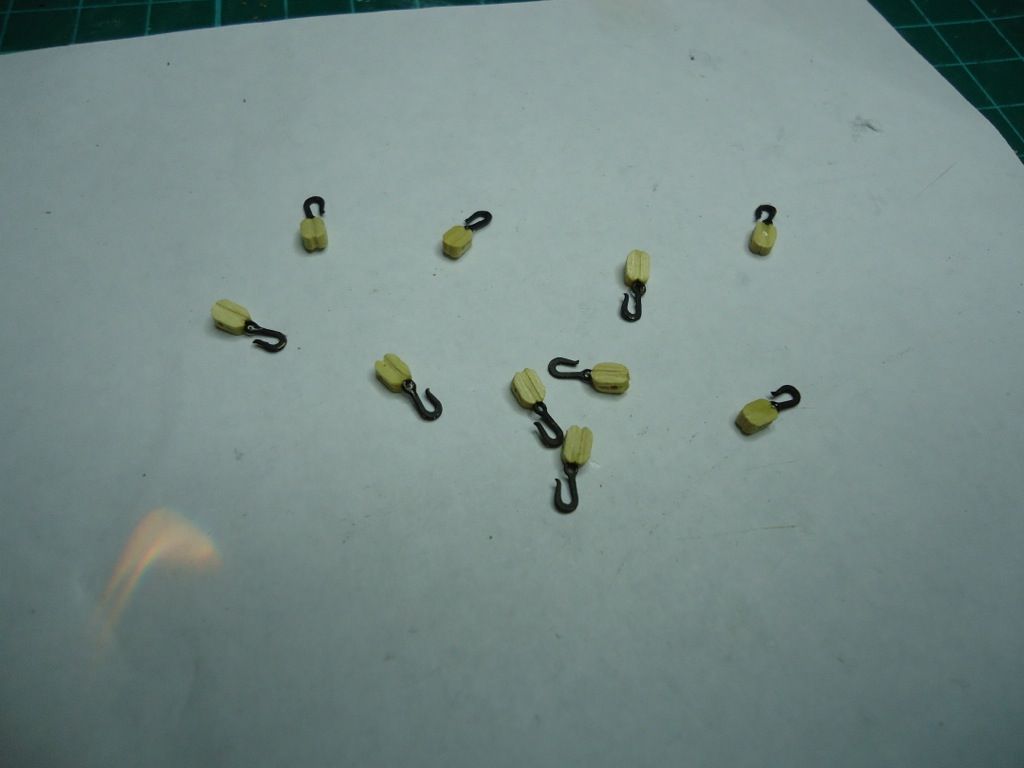

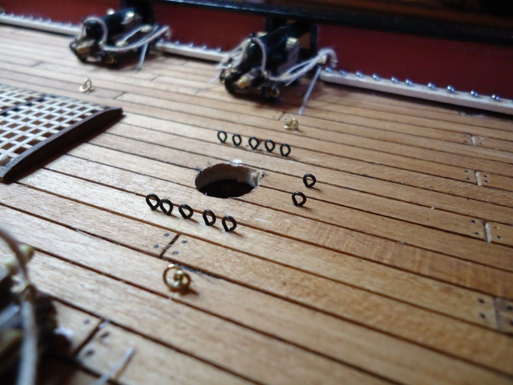

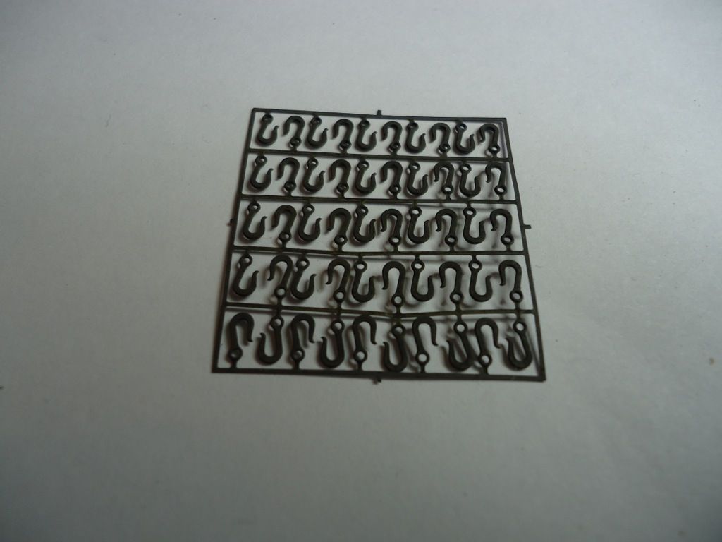

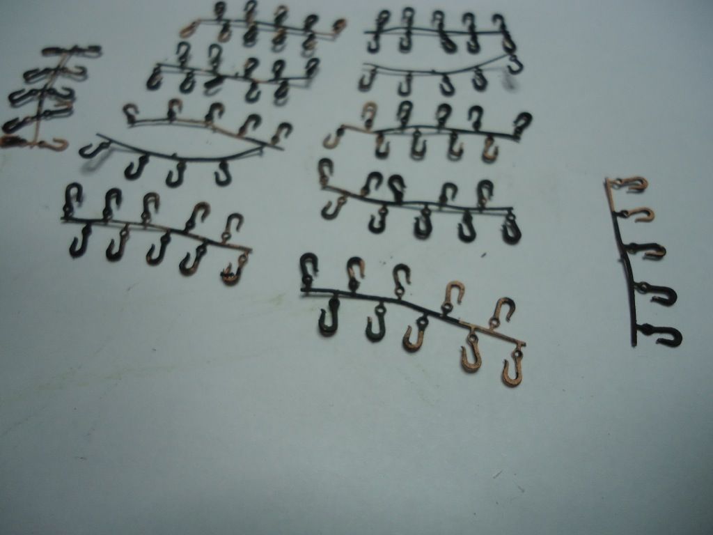

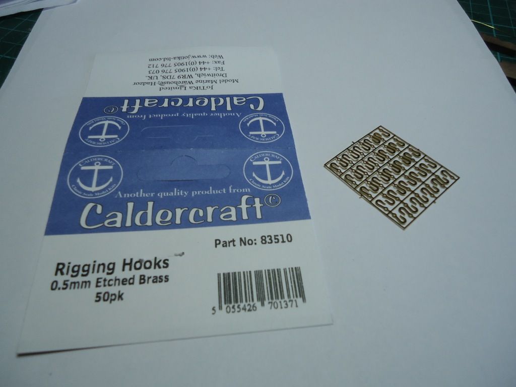

Been busy on the ship the last few days.My first task was to blacken the hooks for the blocks to the cannons. I used blacken-it, I think I left the hooks in the solution to long and they went kind of copper like, so I chucked them away and did another batch.
The second batch were ok.
I bored a hole in the end of the blocks, and left a little tab on the end of the hook, the hook was then glued in to the block, Once set I rebored the hole through the block for the rope, to ensure there were no obstructions.

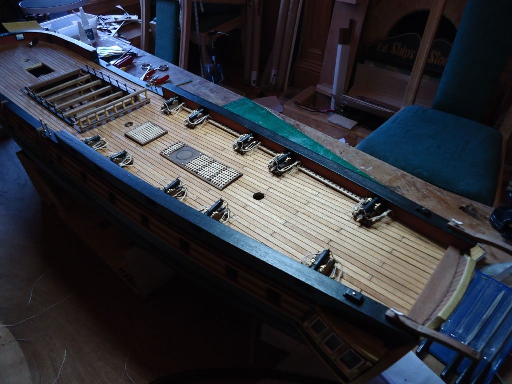

I then fully rigged the cannons to the upper deck, at the rear, I seen to be short of a few cannons to do the front ones.
I then put in all the hooks, cleats and eyelets to the deck, /size]

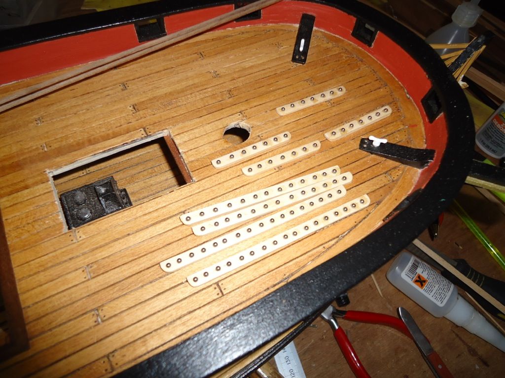

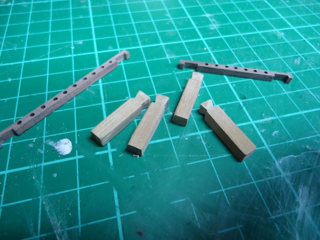

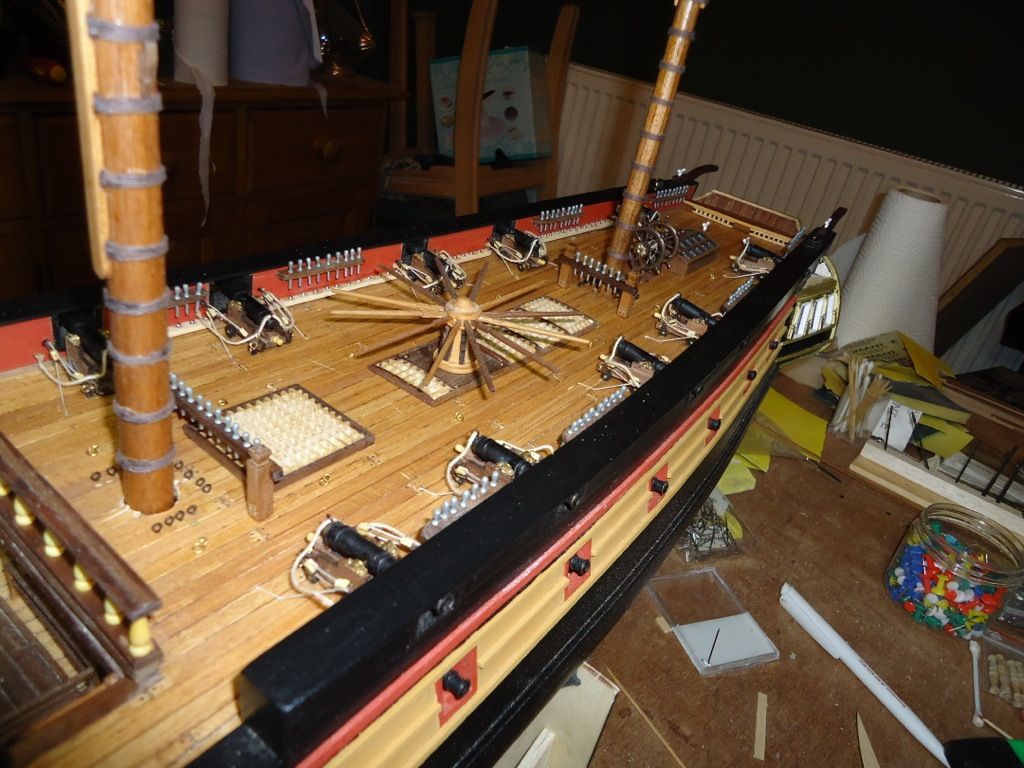

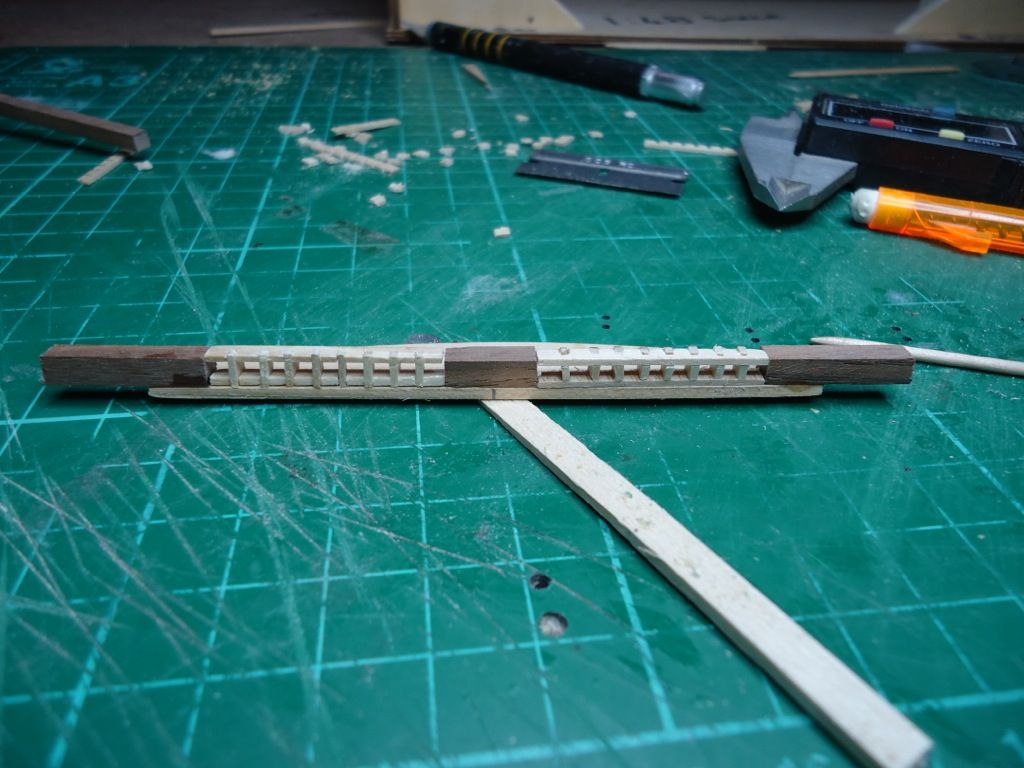

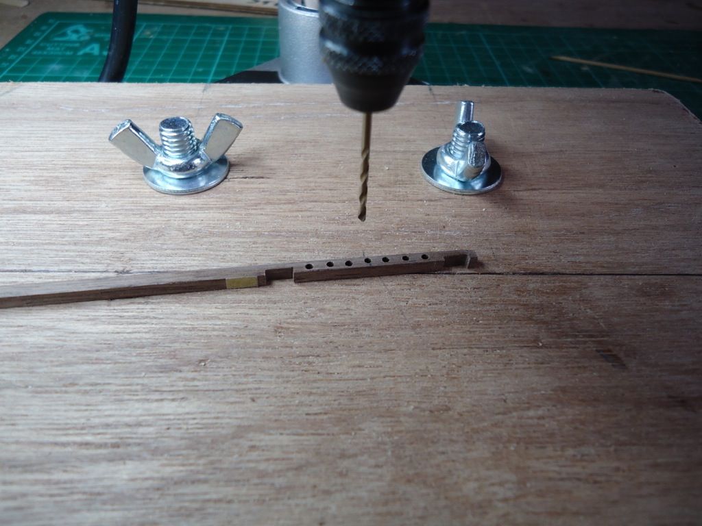

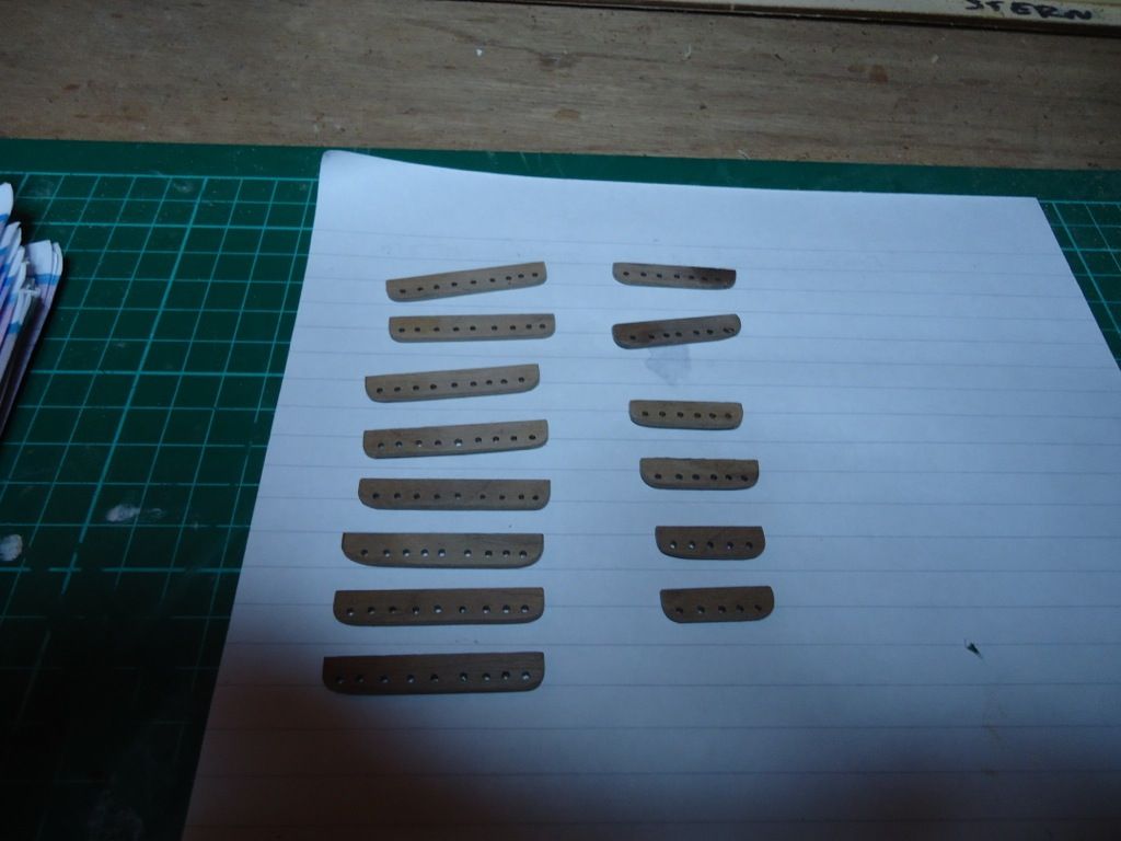

It was then on to the racks for the belaying pins,
[size=7]I have coated the racks for the belaying pins with Danish Oil, and will put the pins in tomorrow, Is it a good idea to glue the pins into the rack or leave loose ?
Mo
Mo

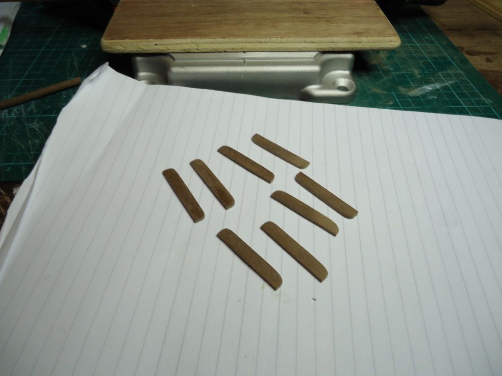

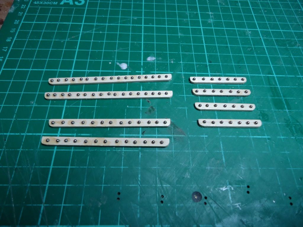

The rack's for the belaying pin's, I glued a small piece of timber on to the rack, so as to give it an extra bit of surface area for the glue, to get a better fixing to the bulwarks.
I am not sure if I should glue the pins into the racks or leave them loose, any advice ?

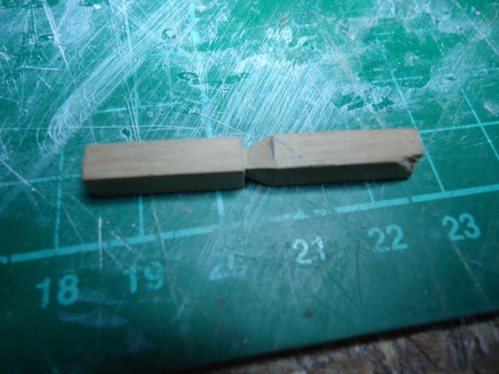

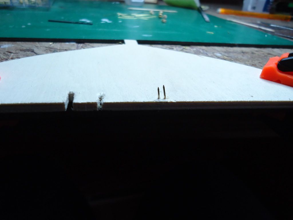

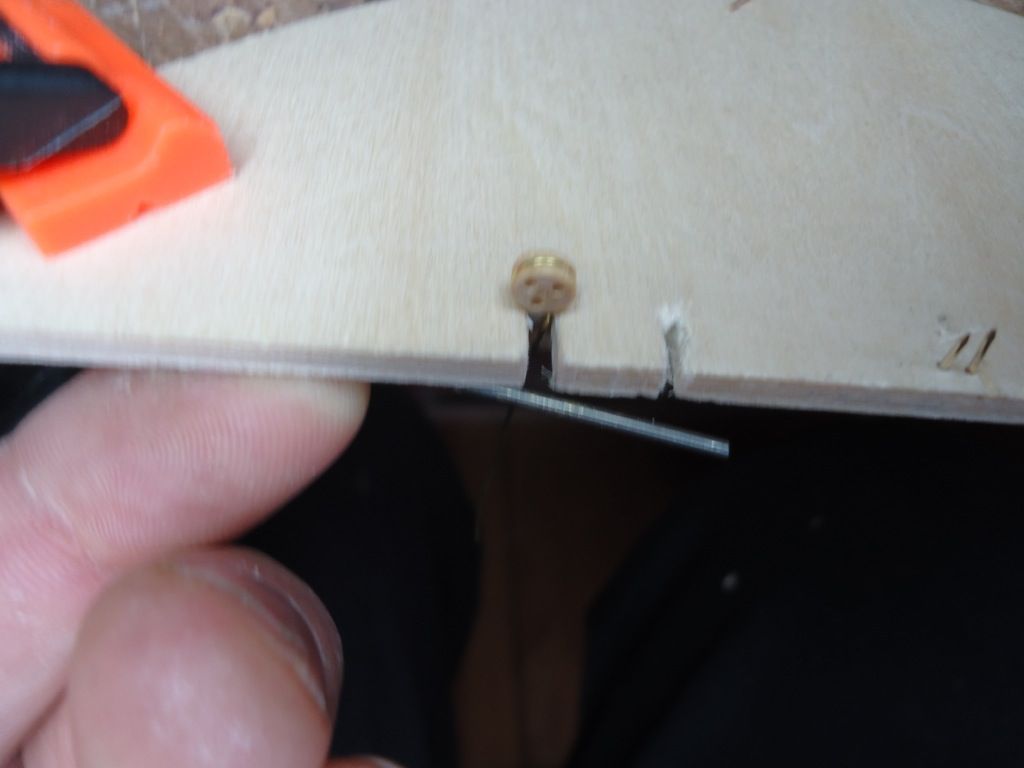

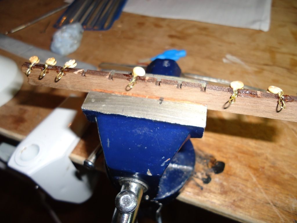

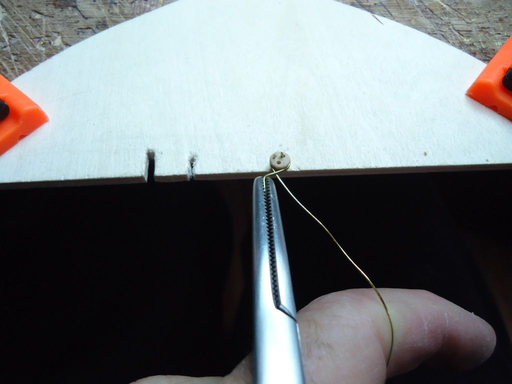

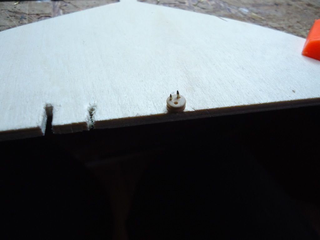

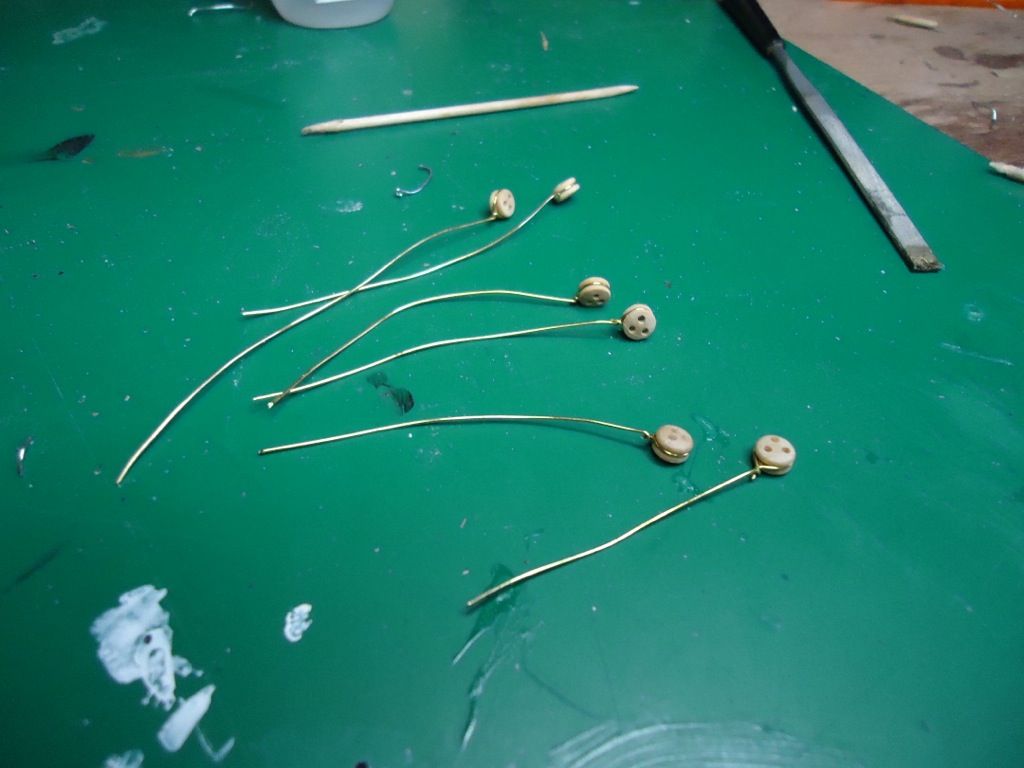

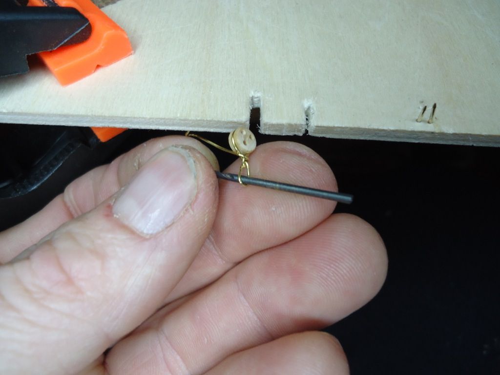

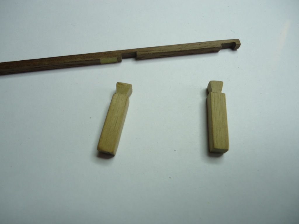

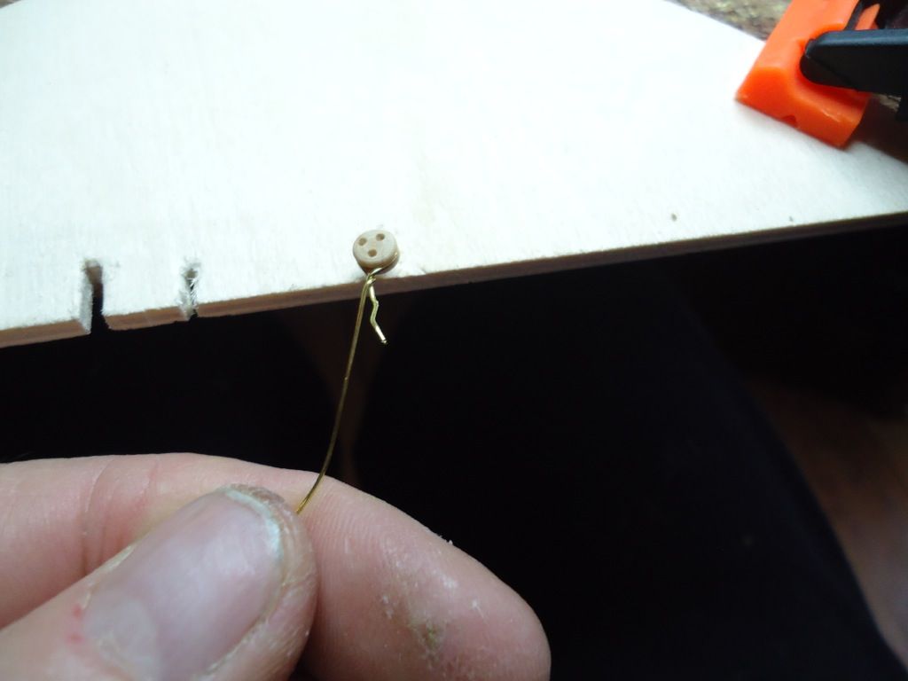

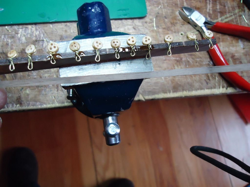

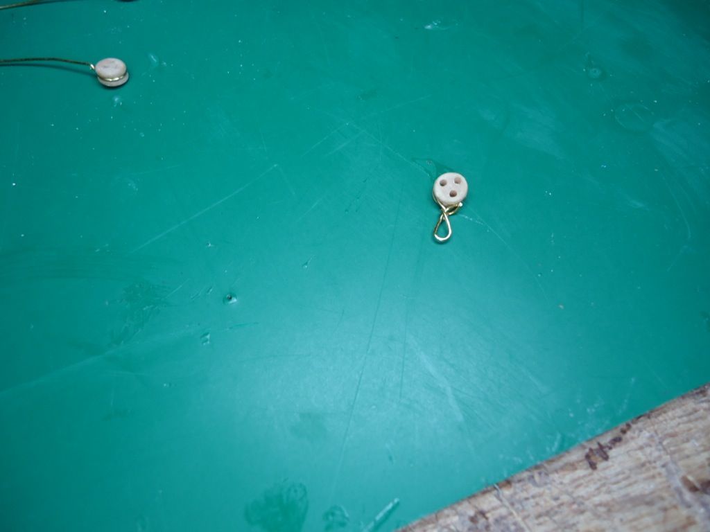

It was then on to the chainwales, this is a very fiddly job, seemed to be at it for ages untill I got a way to do them. I put 2 pins in to a piece of wood, the same thickness as the bit they are going to be attached to, this is to hold the clump block in place
I then wound the brass wire around the block, twisted it a turn and a half, this secured the wire to the block.
I then nipped of the unwanted piece of wire, I now have a block tied to the wire.
I then cut a saw draft in the same piece of wood, and inserted the wire with the block resting on the top of the wood, I held a 1.5 mm drill on the underside of the wood, and brought the wire up on it's self, giving the wire a twist to form a loop.
I then squashed them into the chainwale timbers, and gave them some glue to hold them in place, I then fitted the 3 x 1 mm cover plate, I will give them a coat of The old Danish Oil later. I can only say making these was a bit challenge, but getting there.
I will post a picture of the side of the ship with the chainwales fitted later.
