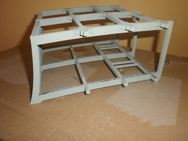

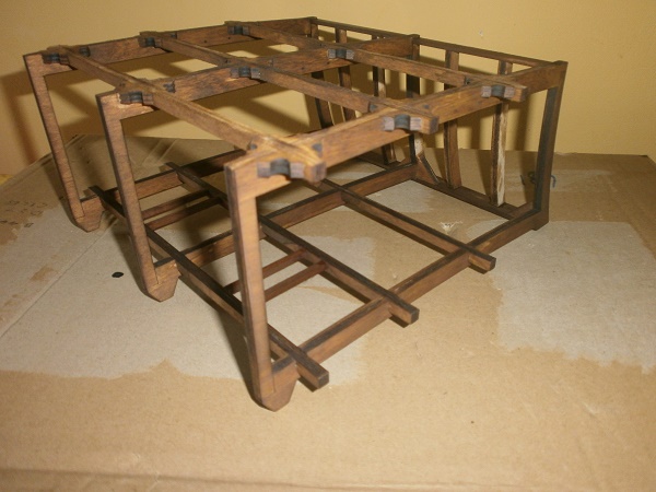

I was going to go for a natural finish using a stain ,medium oak to be precise [ see pic ] but im not happy with it, its too dark and the insides of ships would be painted.

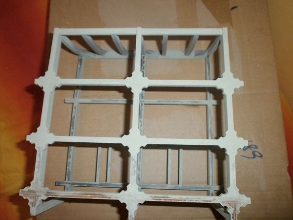

So after a little research I have decided paint will be the option im taking for the insides and a varnish on the outsides.
Early 18th century ships of the Royal Navy were mostly painted green on the sides and roof of the main decks and a light blue was used in the officers quarters. The decks would be bleached white from the daily Holy stoning done by the crew to keep all spick and span. Bleached decks wont be an easy option to reproduce so I will leave the decks in there natural light colour but the rest will be painted in a light green apart from the pillars which will be of oak stain. The gun carriages will be matt black and not the red as depicted in the kit pictures.
Of course the above mentioned colours could be changed to the preferences of the captain aboard each ship and the availability of paint colours in the stores but it is a good indication of the majority of ships internal colours.

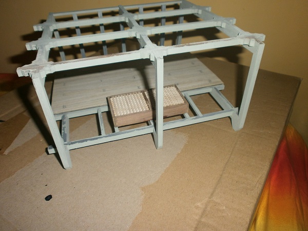

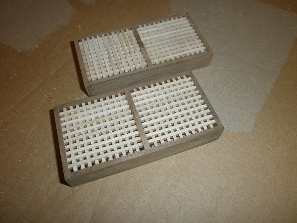

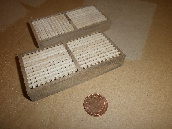

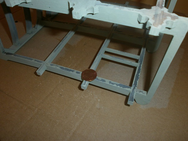

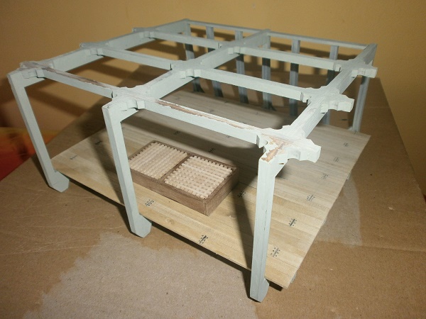

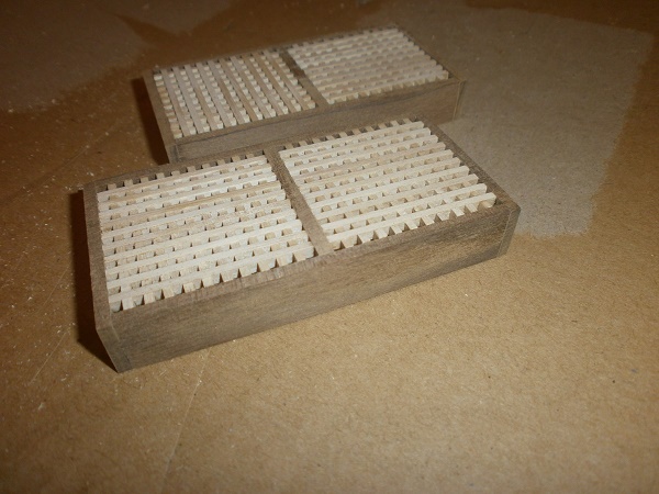

After deciding paint was the way to go I have spent the day undercoating and laying down some coats of paint but in between I managed to make up the two grating boxes for each deck. Personally I think it looks better painted but will look better once some planks go down but each to his own. Oh and just for Steve I have added some penny pics to give an idea of size

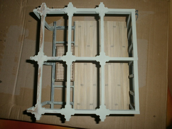

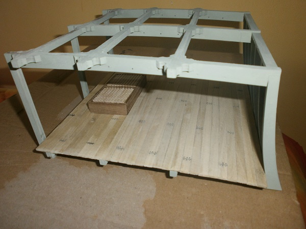

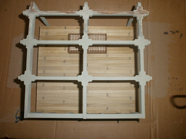

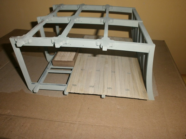

Managed to do some of the lower deck today and used the panart way to trenail which came out looking ok I think with I little pencil lead to highlight them. The lower grating has been added and there is till some planking to add around it.

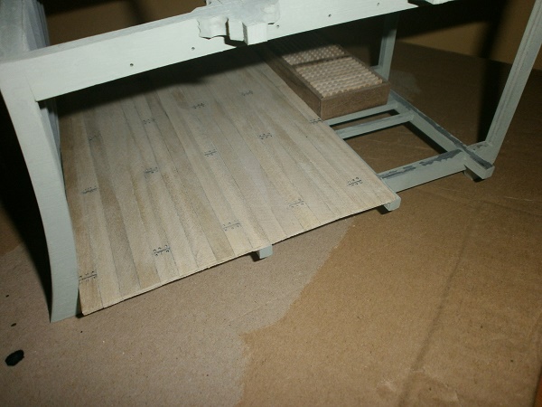

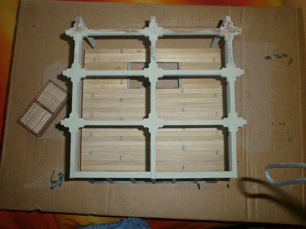

The lower planking is now done but needs a good sanding as yet, the grating section has not been glued in position to aid the sanding and will be glued down after.
