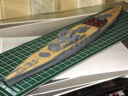

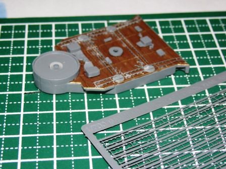

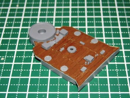

Hi All!
I post next progress.
After linoleum color paint dried, surface of the brass rods were scratched.
Removed plastic parts and photo etch parts of the turntables ware attached on the flight deck.
Parts of the rails will be attached in the next stage.
Best Regards,
Yutaro

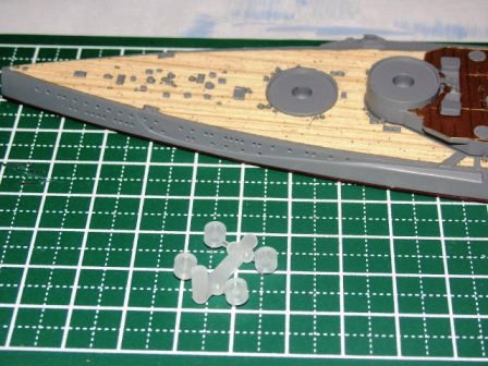

Hi All!

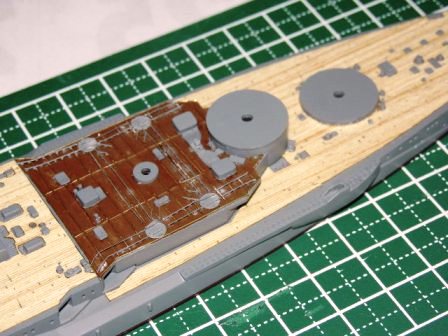

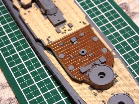

I post a diary of the next progress.
Since I caught a cold last weekend, the progress is poor.Blushing
The floor was glued to the hull.
I attached etching of rails on the flight deck.
'Polycap's were mounted in the gun turrets. Main guns can be rotated after finishing.
Best Regards,
Yutaro

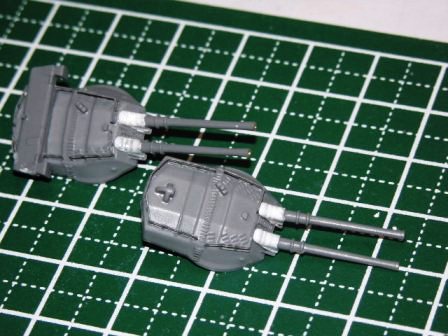

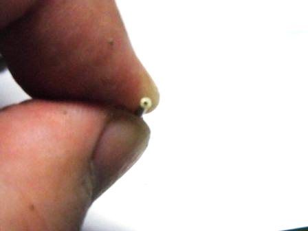

Location: Tokyo, Japan

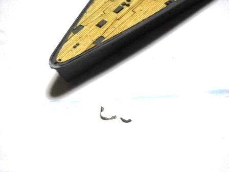

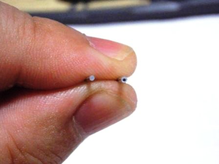

Hi All!
This time, I post a diary of main guns.
The NAGATO had 8 barrels of main guns. I used plastic parts that have openings.
I painted areas around the openings in gold. Japanese toothpicks were inserted into the openings.
(Japanese toothpicks have round section. It is like a cocktail pick of Europe)
After painting the barrels, the area and the insides of the opening were remained gold (brass) color.
I attached handrails and ladders on the main guns.
Besr Regards,
Yutaro
