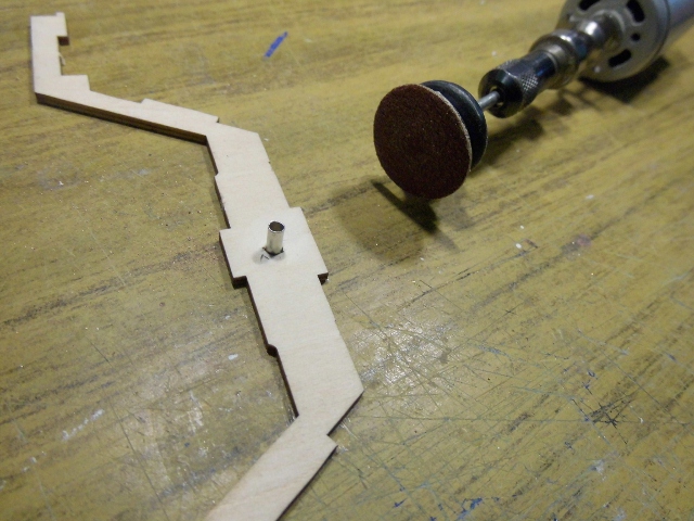

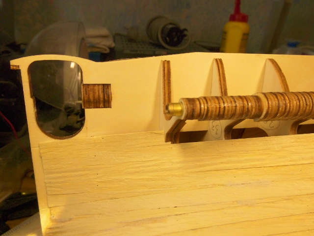

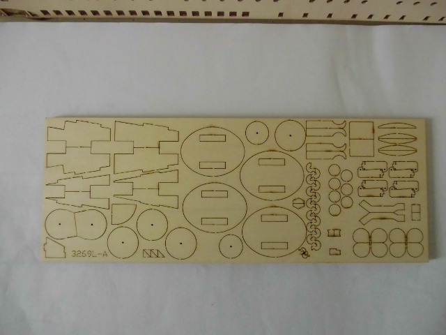

Missing parts kit received. Concerns the missing wood parts 3269L . Nothing else included. (no messing tubes, but in my build this does not really matter)
Wieltje attached the following image(s):

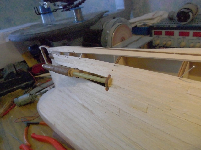

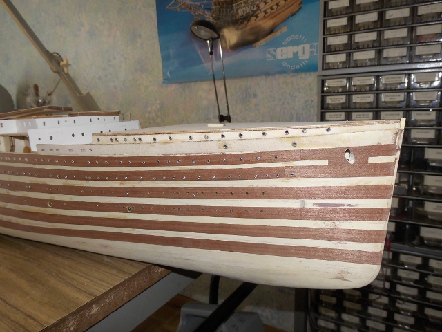

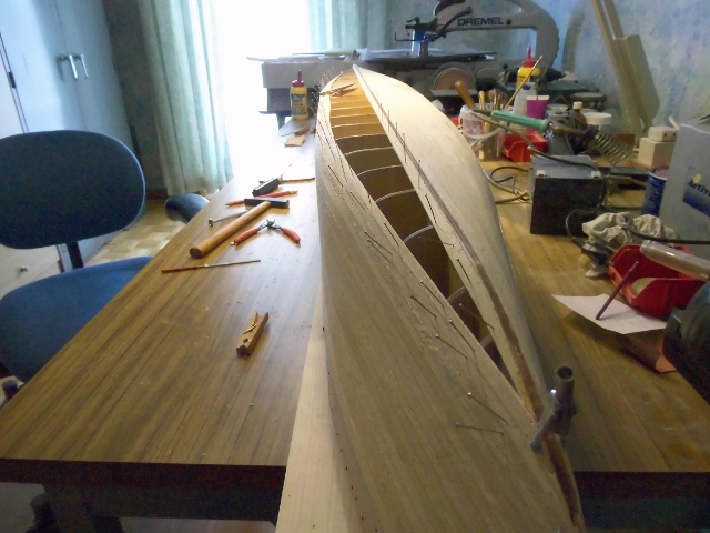

Completing the hull planking. First layer, but remember there is no real second layer. Only a few thin planks adding -undrilled- portholes. The supplied planks are 2 mm thick which is a bit unusual for hull planking. They are rather easy to install and real strong. I do suspect sanding is going to be difficult though because they are rather rough. To get them smooth will take deep sanding (up to removing almost half a millimeter or more at places).

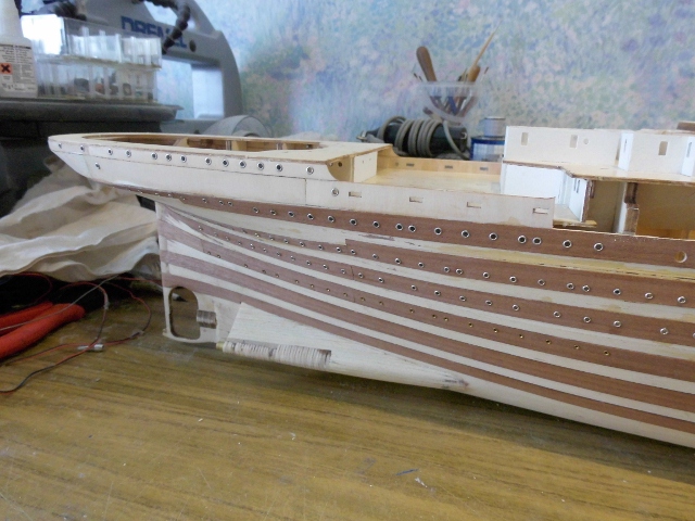

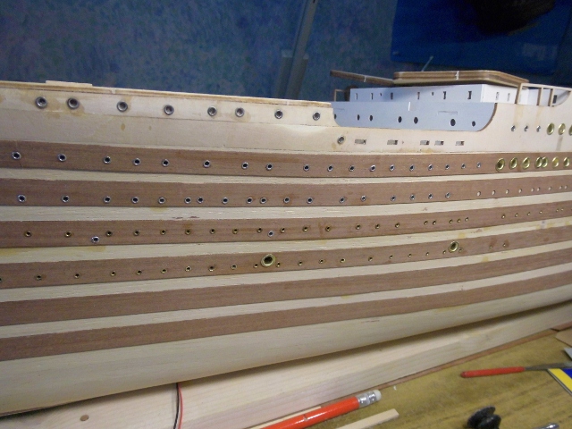

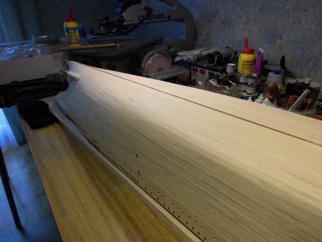

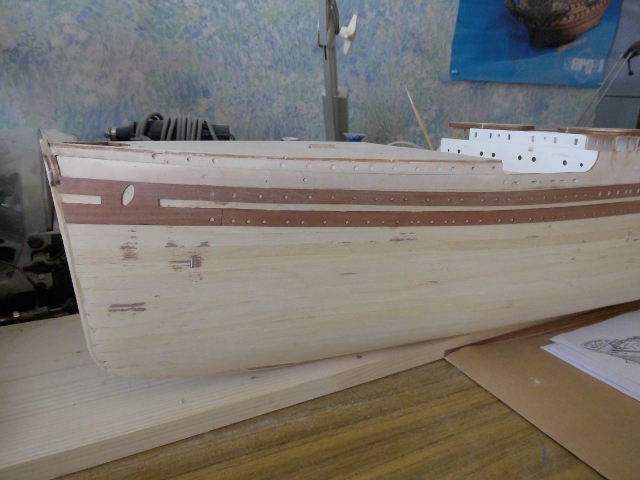

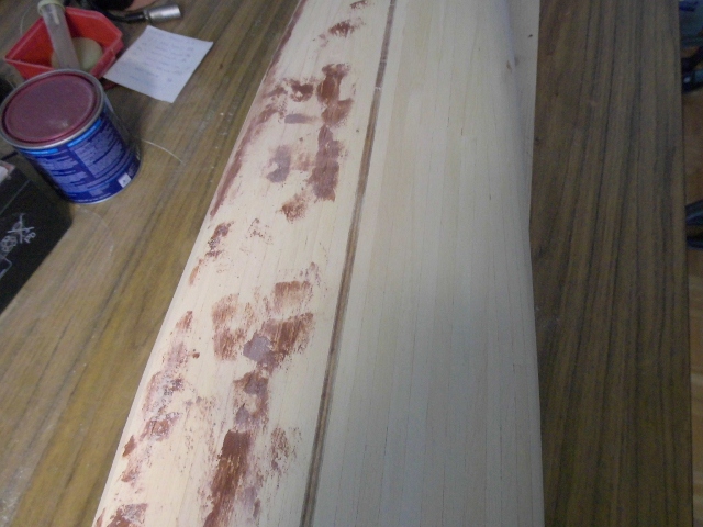

Sanding, sanding, sanding... As you will see in the pictures, even after a first deep sanding she is still far from smooth. Decided to use a filler (because this ship will be painted that's not really a problem) and opted for a very dark one. May seem unlogic but this permits me to see exactly how far I have to sand it down afterwards. Pictures will make clear what I mean. BigGrin
#28 Posted : 07 May 2014 21:37:20
WTG, Drool
Looks great.
One question:
If you have to turn this monster over, how many people does it take?

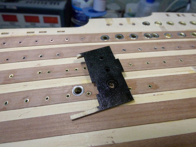

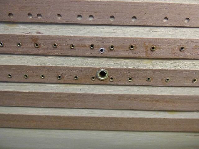

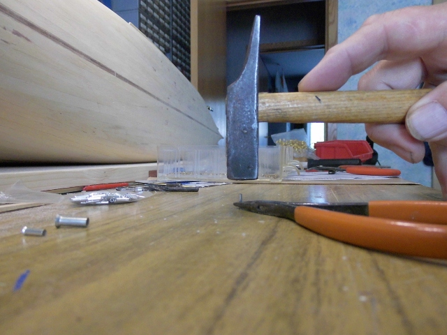

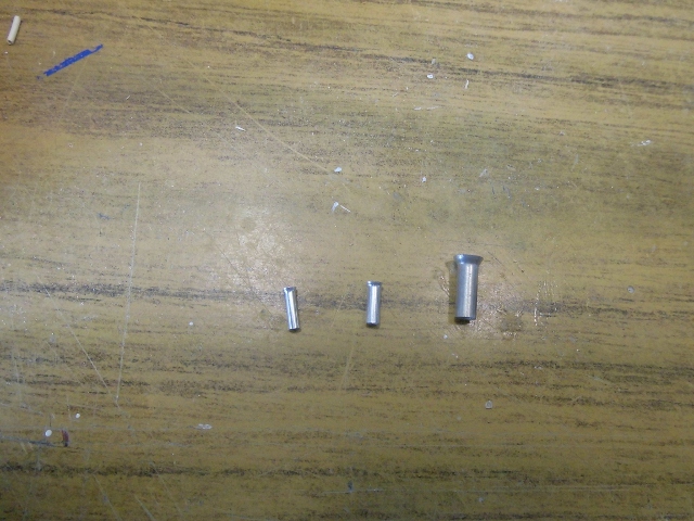

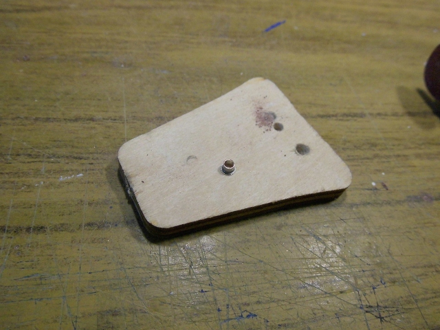

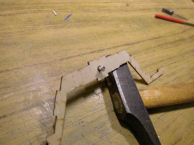

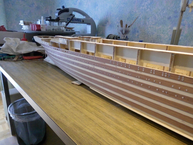

Time for the 'second planking layer' . Indeed, not complete, but looking at original pictures of Titanic you may have noticed that the real ship also has this somewhat strange hull structure. And then... there's the problem I noticed from the moment I opened the building box. Most portholes are not even intended to be drilled. Don't even think about mounting lights inside or so. And NO frames ! For a static model I needed and found a solution. You will see in the pictures that I purchased some ferrules (for electric wires) and adapted them to become frames. I hope the pictures show how exactly I managed that. The result is pretty pleasing. Think this will do very nicely indeed once the ship is painted .

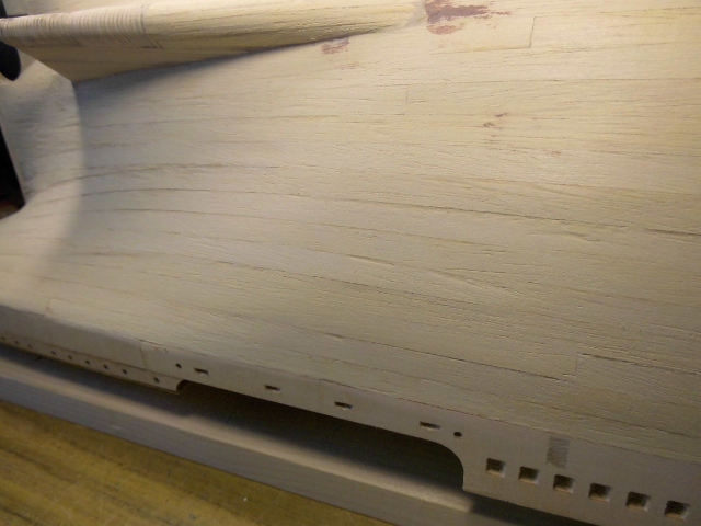

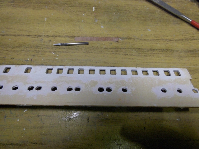

Since I would like this model to be a Titanic-model and not a "Wieltjes-model" I will indeed remove the biggest frames in the portholes. They are too obvious. The smaller ones will be sanded down to make them barely visible but they still provide a good finish to the smaller portholes. Unfortunately the bigger windows and portholes were mounted with acetatefilms on the inside. Painting them is IMPOSSIBLE this way.

For readers that did NOT yet mount the prefabricated hullparts ( especially 123/124) take notice that you can't paint the windows/portholes if you first mount the acetate. Painting the inside frame without touching the film would demand incredible precision. I have decided to remove these parts from the ship. Then I remove the acetate. Now painting of the inside edge in windows/portholes becomes possible. Only after finishing that paintjob I'll put acetate or other films back in place.

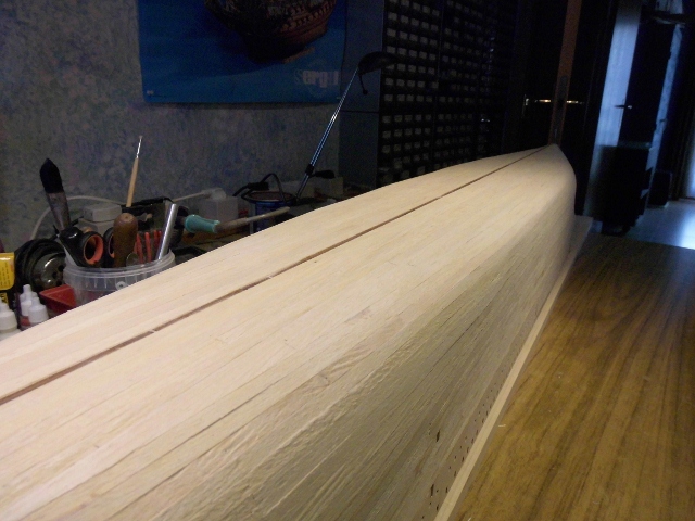

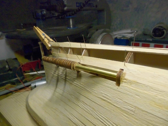

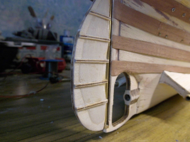

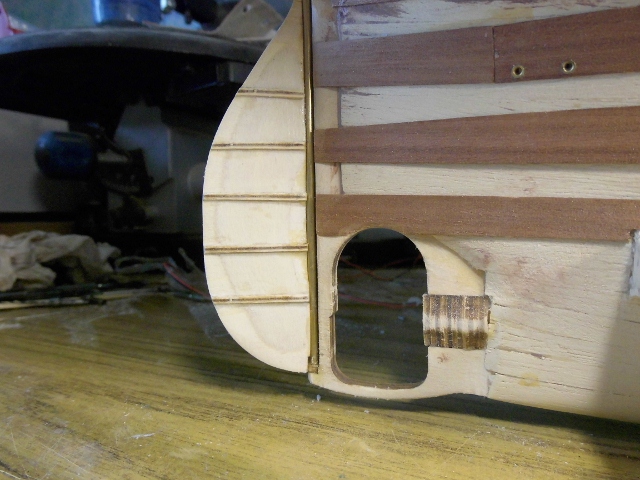

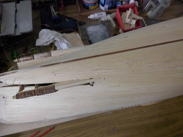

Time for an update on this build.
First a few pictures off the (partial) second planking layer and the construction of the rudder.
