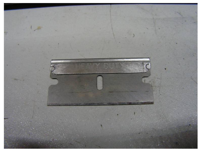

I've never heard of using a hot knife to cut the fibre before, I've always used a safety razor blade in the past without too much bother, you might need a firm surface to cut against though, a cutting mat might be too soft, cracking the fibre but I haven't tried it on one of them myself. As far as the heat goes though, if you bring the cut end of the fibre up close to a candle flame (but not in it!!)BigGrin The heat will cause the tip of the fibre to seal itself into a type of lens which will actually increase the light output. With care, that method will also allow you to feed the fibre through the deck for example, heat the tip and then pull it back down level with the deck where it will form the lens in the deck itself. (Practise with scrap fibre and plasticard is highly recommended!Blink )
Best of Luck!
#29 Posted : 26 May 2014 22:07:36
Brilliant Robin, that's what I wanted to hearBigGrin I guess they say to use a hot blade for the same reason as you suggested, I prefer your way though. BTW, what is a safety razor blade - I thought safety razors were the ones that you cant get at the blades?
#30 Posted : 26 May 2014 22:44:32
Lol razor blades are safety razors, they got their name as marketing to get people to by razor blades rather than using a cut throwt Modern razors are just a small strip sharpens with wire brushes
#31 Posted : 26 May 2014 23:07:17
Posts: 2,090
Points: 6,265
Ha! nice one Jase!BigGrin
Here you go Stevie, modern razors are called safety razors because as you said, you can't get at the blades but the blades they hold (apart from the modern disposables) are very thin double sided and razor sharp (naturally!BigGrin )
A 'Safety Razor BLADE' on the other hand is much thicker and only single edged with a blunt strip to use as a handle on the other edge, hence the 'Safety' aspect.
I use these either as they are or else contained in a metal retractable housing which gives greater control, either as a cutter or as a scraper.
(This is what I use to trim off the flash and perform 'surgery' on the polythene figures in the dioramas, cuts through polythene plastic like the proverbial knife through butter!)Cool
You should be able to get them through a chemist although I bought a box of 100 from a travelling supplier, years ago and I'm still not half way through them!
Brilliant little tools!Cool

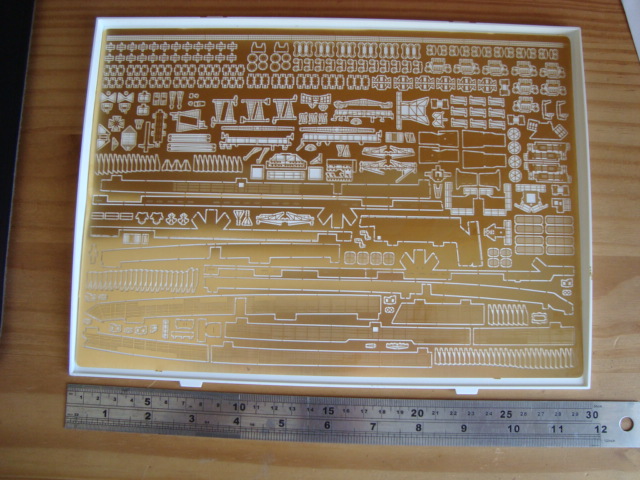

Good news is my etch arrived todayBigGrin I'm very happy with it too, never seen an A4 sized sheet before, 3 sheets in total so I can begin my build after a lot more reading of course, there is a very detailed 12 page book with it.
I have dabbled in etch before, 1/35 scale mainly but this is going to be a whole new experience for me.
Any tips welcome on here please, mainly would I be better off cleaning and priming the sheets as they are now in one piece or cutting them down to smaller sections as needed?

Thanks Jase, I have ordered the AK salt and deck wash too. Looking at your etch advice I think I will wash and prime the whole sheet first then, really thought it would just crack off when the etch was bent though?
#40 Posted : 07 June 2014 13:35:46
Short answer is yes it could. Personally i would not clean and prime until you need too, its amazing how much oils from fingers and work surfaces etch can pick up and you will be coming back to the same etch fret many times over the build.
I find it easier to clean prime and sometimes paint items like railings, ladders on the fret if there is no or little manipulation of the part needed. But for anything that needs more complex curves or folds better to form it first in my view. If the etch is part of a bigger assembly that is all one colour then i tend to prime and paint as part of the assembly.
I am guessing that much of your etch on this project can be painted with the main assembly as its largely all one colour.
Only other tip from me is spend plenty of time comparing your kit and etch instructions. mark up where you are using etch on the build instructions and you decide where you are pre painting and mark up on the etch instruction.
