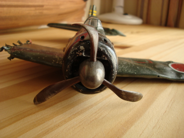

Great stuff Stevie, looking very realistic and I can't wait to see the finished diorama, it's going to be so cool!! Love the way you've done the bent propeller blades - did you just gently heat them in a warm oven before bending them?? CoolThumpUp

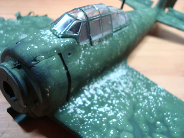

Thanks for looking in and all the nice comments guysBigGrin
Well I have now decided Id like to do a little more weathering on this to add some fun to the build so I am now going for the aircraft to look like it's been in the water for a little while. I am going to look into algae and salt streaking at a later stage but that will be on the complete aircraft assembly.

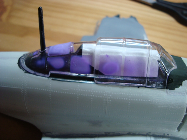

For this update I have used maskol by humbrol for the canopy masking. It goes on well, a blob in the center of the panel then push to the frames with a cocktail stick, came off ok too which is the main thingBigGrin There are more weathering layers to spray over but the canopy will be included in these later washes and filters.
As you can see I sprayed a base of aluminium first to aid in the chipping which in this instance is the salt method. Dont normally like this method but the effect it causes is perfect for my dio. The decals will be manually chipped later by simply scraping back to the Aluminiun layer. The ring marks are a result of over-spraying with an alcohol thinned paint reacting with the salt, they will disappear after a clear cote.
Lots more to comeLaugh

Lovely work Stevie! That salt technique works a treat, I'll have to look that one up!
This is going to look great in the water effects, well done indeed!

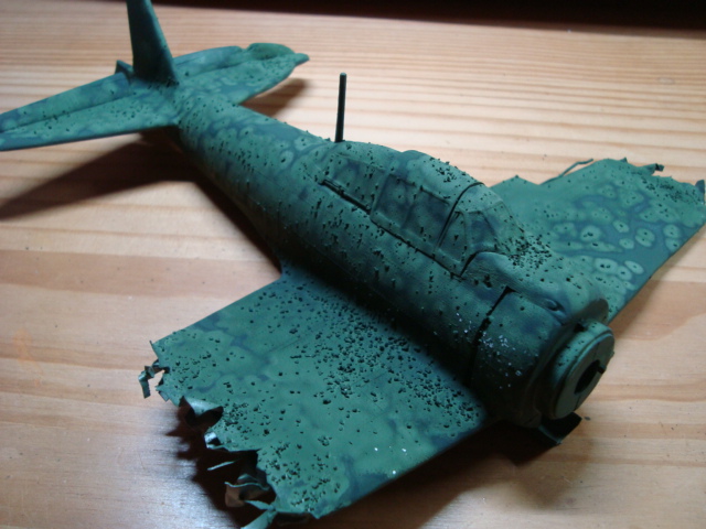

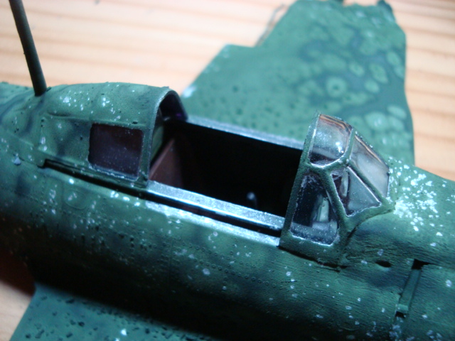

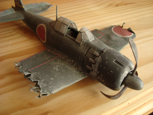

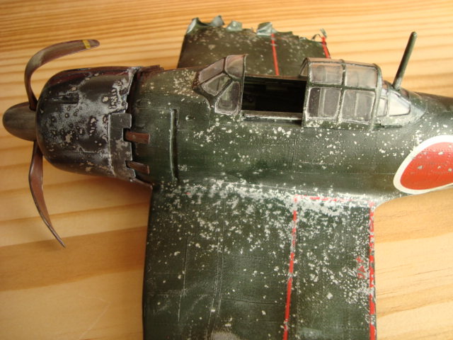

#30 Posted : 29 December 2014 14:25:12
Thanks for looking guys, left this alone over xmas but just a quick update of whats been done.
Decals applied onto a gloss surface, couple of washes to tone down the effects of the salt chipping, re-chipped the decals.
Next up will be to do some sun faded or filter washes and some detailing, especially the ripped wing edges which need some metal drybrushing on the torn bits and inside.
Then it's time to try to source a large 300x250 clear acrylic tray. I was hoping to recieve the worlds biggest box of ferrero rocher for xmas but never got itCrying

What a brilliant job you are doing with this one.
That can metal looks the part for the damaged wings very good idea indeed.

Now that really does look like a wreck.....LOL LOL LOL .. Fabulous results and a great show of real imagination....Drool Drool Drool .. Very well done Stevie....Cool Cool
#34 Posted : 30 December 2014 00:05:10
Brilliant work Steve, the ripped apart wings look really authentic

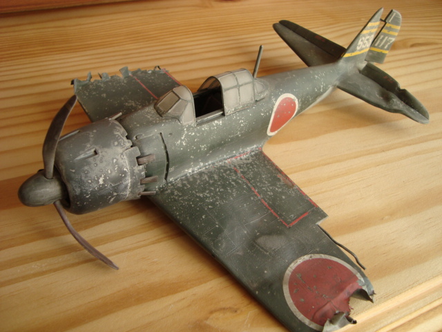

#35 Posted : 02 January 2015 14:58:12
Thanks guysBigGrin

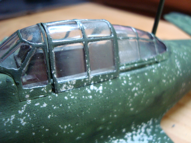

A couple more pics here after a few very thinned down airbrush layers of brown, sand and buff. There will be some more weathering and detailing when I'm at the point of placing it on the dio - some salt streaks will be needed too.

#36 Posted : 02 January 2015 16:40:15
Fantastic work so far, weathering is spot on! As for the difference in scale between 1:35 and 1:32, it is so minimal you wont notice, especially if the figures are away from the plane. Looking forward to your next update!!!Drool BigGrin

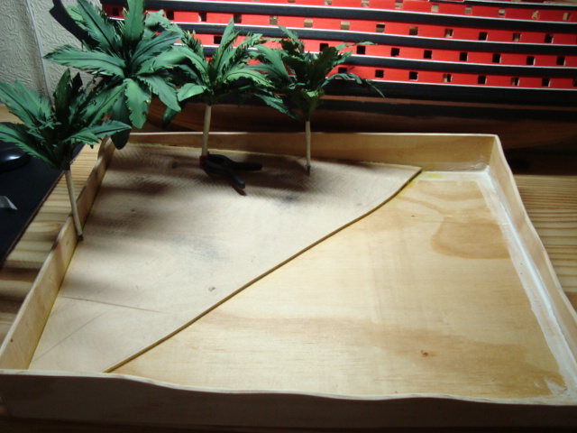

#40 Posted : 05 January 2015 00:09:23

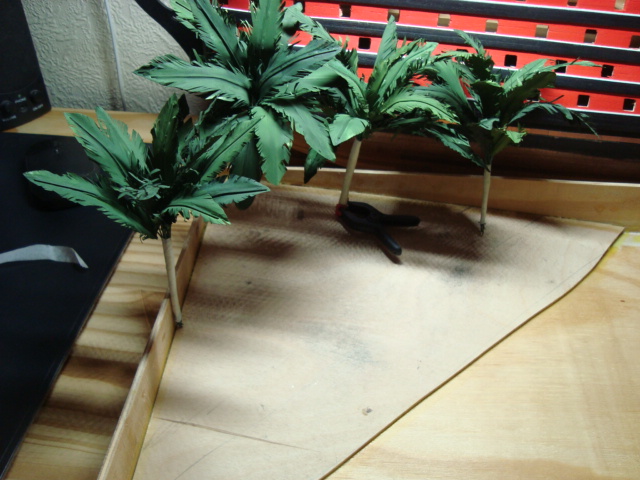

I have knocked together the basic diorama base, I angled a piece of plywood to get the slope of the beach and also to reduce the ammount of plaster and sand required.

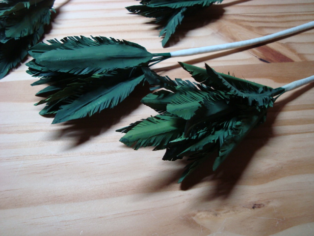

Also managed to get the palms done, I have 3 palm plants and a tree. These were done by cutting out the leaf shape from printer paper (x60Crying ), glueing it to a wire and the cutting the edges with scissors to get the frayed leaf effect. I put the 60 separate leaves into 3 piles and airbrushed a different shade of green for each pile. Once placed together about 15 per tree there is a subtle shade difference in all the leaves.
The trees are obviously not in place yet so not sure of the exact layout at this moment.
Still have to put some air dry clay over the tape for the trunks and add some leaf highlights and poss a satin finish...
