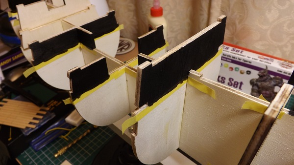

1. The first picture shows these false decks being test fitted into place.
2. Having test fitted them into place I decided that I would paint black some of the wood that may still be viewable just in case it should be visible through the grating to be added at a later date.
3. I used Tamiya masking tape to line out the areas I wanted to paint black.
4. This is what it now looks like with the black paint added.

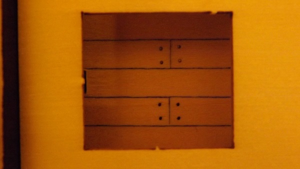

Having looked again at these false decks I thought it might be fun to have a play around with a planking effect even tough in theory very little of this will be seen through the final grating of the upper decks. The instructions would just have these pices glued in place with no details of planking them.
The intention was to have a little play to try and produce a suitable caulking effect between the planks and to produce an effect of the treenails.

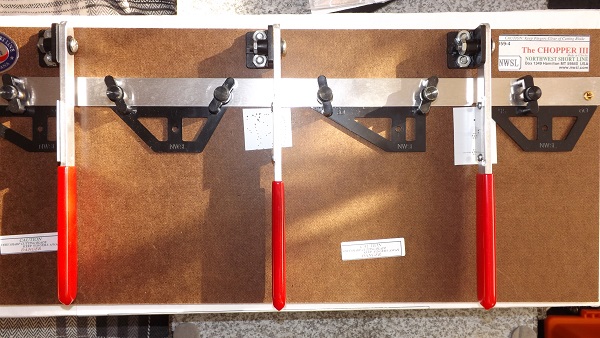

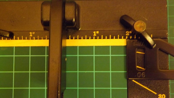

1. In order to cut the 1000mm lengths of maple down to a a suitable plank length I set up my "Chopper" with an stop to ensure all the planks could be cut to the same length.
2. Having cut our planks we end up with a nice little pile of wood strips to work with.

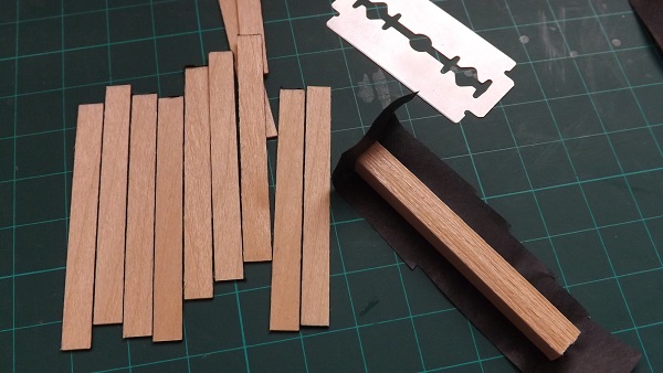

Having produced a pile of wood strips I will now describe my chosen method of producing he caulking and treenail effects. There are many methods of producing the caulking effect from eding the plank with a soft pencil, using black cotton and a whole host of other valid and interesting methods.
This is the method I find works best for me.
1. I use a cheap thin PVA glue, some black tissue paper (important to get a colour fast version to stop problems with the glue or later varnish coats)and a couple of peg clamps.
2. The first stage is to line up a set of wood strips so the one long and one short edge are all even. These are then clamped up.
3. I apply a generous coat of glue to one long and one short edge onto which a piece of the black tissue paper is affixed.
4. When this little glued bundle is dry its time to separate out each plank.
5. I find that the finest blade to use for this is a good old razor blade. I have used double edged in the past but as I am rather attached to my fingers have recently sourced a batch of barbers single edge blades. I have found that the traditional safety blade is just a little to thick and rigid for my liking.
6. All I then do is to carefully (those blades are very sharp) cut through the tissue paper to produce a stack of planks that have a black edge along one long and one short side.

Ok, so having produced a set of deck planks that are "pre-caulked" its time to set them in place.
As I mentioned at the start of this update these lower decks are in effect next to impossible to see so my planking pattern is nothing special on this level.

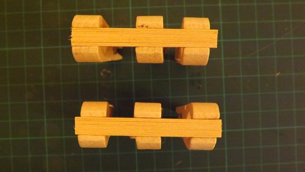

1. To produce the treenails I made myself a small jig to try and ensure
the 2 nail holes per planks have some sort of consistency. Its just 3
pieces of scrap wood with a 5mm space between. I have then end
drilled a further 5mm thick scrap in order to fix 2 plank nails.
This little tool allows me to end stamp each plank with 2 small holes
ready for drilling later.
2. I use my favourite Titebond II glue to carefully fix the planks to
the false decks. I like this glue as its thick, has fast grab and on
such thin planks does not cause any issues with the thin planking
wood curling.
3. When the planks are dry its a case of trimming around the false decks to remove excess deck strips.
#26 Posted : 25 January 2015 15:48:57
Having finished the planking its time for the treenails.

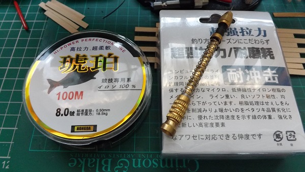

1. For this task I have decided to use a 0.5mm plastic fishing line cut
into small lengths and then glued into 0.5mm holes I have drilled
using those previously created guide marks made with the jig to try
and produce an even, neat finish (easier said than done).
2. When the "plastic pegs" have dried they are cut off flush using, this
time, a single edge safety razor blade. A quick rub over with a fine
sandpaper is then followed by a couple of satin varnish coats.

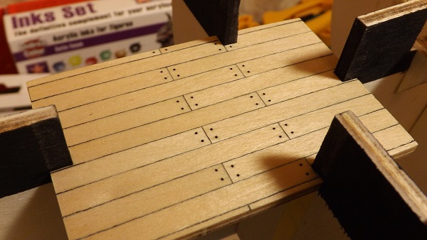

3. These false decks are then glued firmly onto the false keel. The
final picture on this posy shows the effect when the upper deck is
put in place although as mentioned the hole will be filled with a
grating so chances are not very much of this work will be finished on
the final model.

2. As I am going to be cutting a slightly longer plank then a longer
cutter is the order of the day so I have switched to my "Chopper III"
for this purpose.

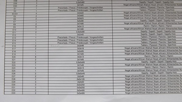

Its at this point a minor error was found in the parts listing. Parts E16 and E17 make up thMore Smilies...e first of the hatch linings but as (hopefully) you can see from the picture E17 is correctly listed as African Walnut but Parts E16 are shown as PLYWOOD- a minor issue but one to be aware of.
