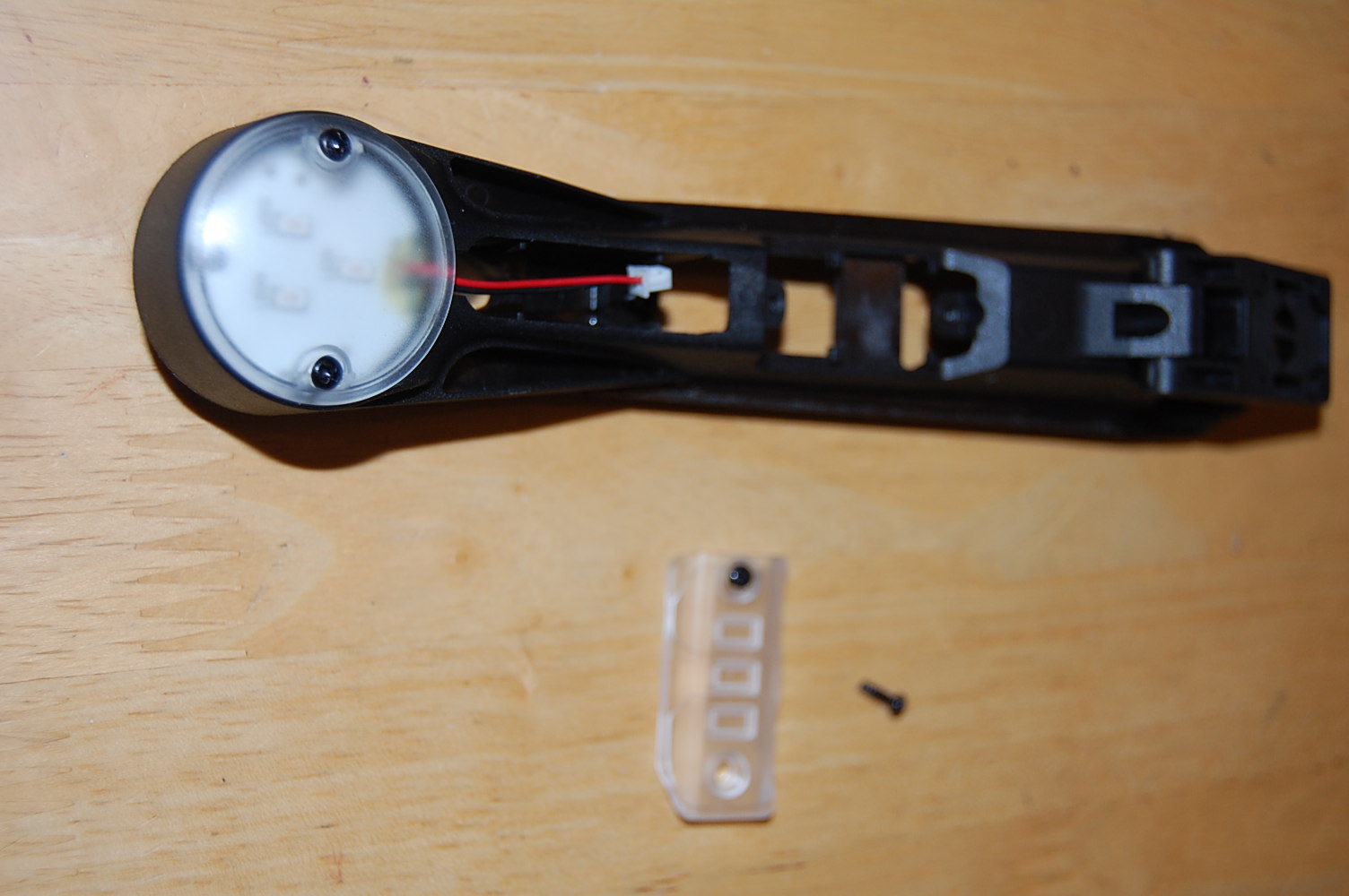

Stage 12.Fitting the Red LEDs and the transparent cover to the rear left Rotor arm. The arm and the transparent cover from stage 8 plus 2 M2x6 screws from the same stage.Feed the long wires through to the end, and the short wires through to the end with the circular light cluster, connect the two plugs together. The new light strip is placed in the center with the holes lined up with those in the arm, the clear cover is placed over the top and screwed down with the afore mentioned screws..
longblade attached the following image(s):
