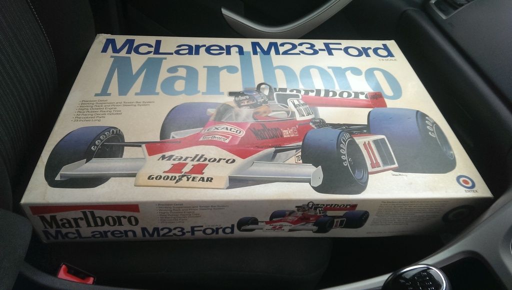

ITS HERE!!!!!
Pictures will follow tonight :)
mark8454
#22 Posted : 30 March 2015 17:23:59
Joined: 24/09/2013
Posts: 180
Points: 550
Location: East Sussex
Mint condition, one or two bits came of the sprue over time but complete! Perfect

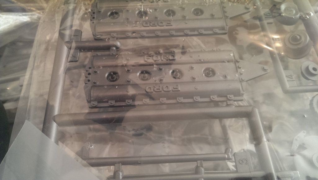

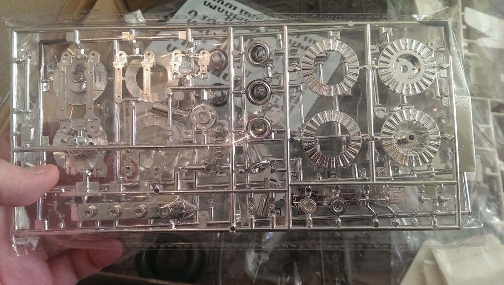

Sorry for no updates, here a just a few box contents, I won't be starting this until the mp4 23 is done.

BigGrin She looks the bizz and will look forward to your diary when you start itCool

It's a stunning kit Mark and one that will keep you busy. Take your time on her as its one that will need some attention for certain parts. I removed the chrome from my parts with a good soaking in household bleach but only do that if your going to re chrome the parts with Alclads

The kit certainly looks in remarkably good condition for its' age Mark and the decal sheets look mint, though you'll not need those red ones if you're going to spray it in MP/4 red? You're very lucky to find one in such good condition.

Also Spence I'm insure what I will be doing with the chrome, I will definitely be doing something with it, I may even just dirty it up slightly :)

I agree with Malc, do the paint yourself Mark otherwise it could maybe niggle you in later years that you didn't build it all by yourself and that it could never be "all your own work" so to speak? All you need to do is practice on some plastic sheet or old models until you feel proficient enough to apply the same techniques to your very expensive McLaren? If you don't feel confident enough to respray the kit chrome parts with 'Alclad' as Spencer has suggested then you could always try 'Bare Metal Foil' which is self adhesive and is essentially real metal, so should look far better than the original kit chrome, which to my mind always looks rather too bright and 'plastic' like to be truly realistic no matter how much you try to weather or dull it down?

Also thanks for tips Kev, I think I will try both foil and alclad in parts :)
