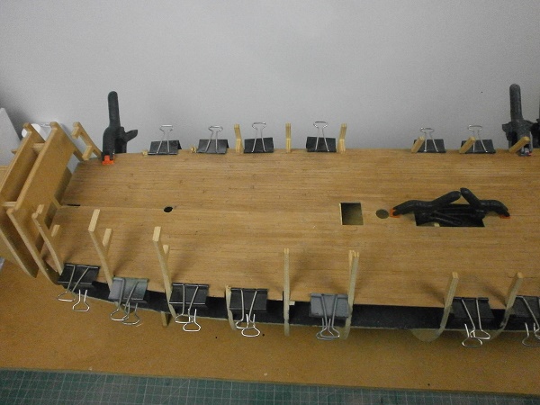

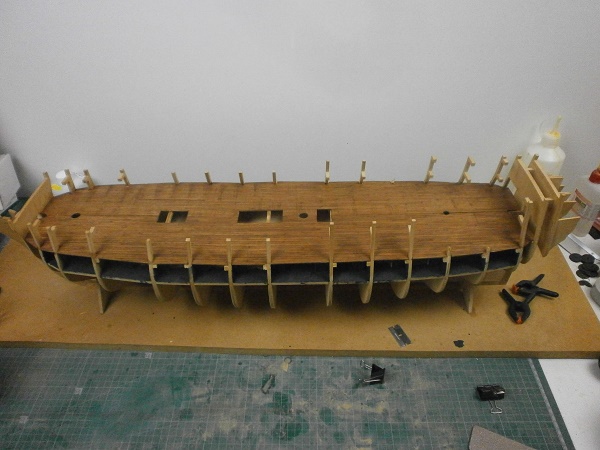

The main hull has been painted in the area of the false gun mounts with matt black [ best done now before any planks go on] then the other half deck was planked. Marked out the trenails then drilled and added the cocktail sticks on both half decks. Trimmed and sanded the decks then after a small amount of adjustment glued them in position as you can see. Next its a couple of coats of danish oil. More soon

BigGrin Hi Steve Thanks for looking in and your comments, the planks are 4mm wide so a better width and more to scale than 5mm planks, the trenails should start to show better once the Danish Oil goes on.

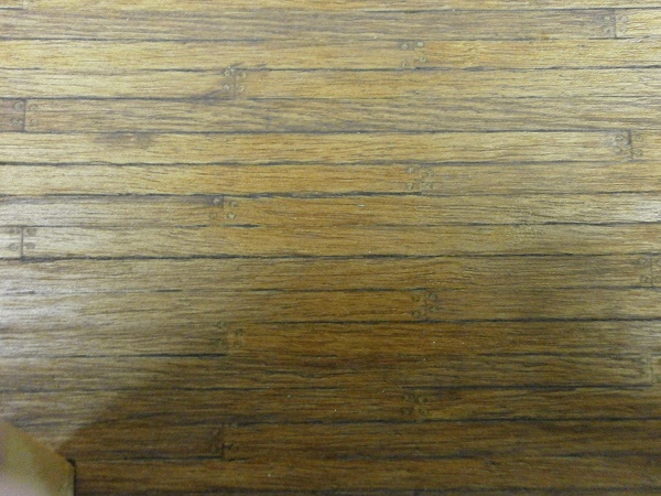

A big thank you for all your comments, the build will go fast at first as its an old build and I want to get the 1st planking done to settle everything down, once the hull has been planked things will slow down considerably.
The deck has now had 3 coats of Danish Oil and the little experiment with the wash to simulate the caulking has I think turned out quite well, what do you think all comments good or bad welcome. I do know that in real life the decks would be holy stoned practically white and would not look as I have done them. More soon.

Hi Andy like the look of that deck very much. Never have thought of using cocktail sticks for trenails, learn something new every day.thanks for sharing.look forward to next update cheers mick. BigGrin BigGrin

@ Mick try to buy the wood cocktail sticks if your going to use them as the really cheap ones can be made from bamboo which are a beggar to trim and the bonus is that after trimming you just sharpen them and use them againLaugh LOL Cool

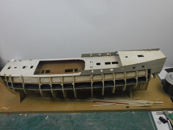

More progress, The next job after fitting the deck was to add the inner gun whale with lime wood,the first strip on each side next to the deck were pre-painted with red ochre to prevent the inevitable slips. After the planking the strips were painted and the next set of deck cross beams added ready to dry fit and pin the next deck and poop deck plys in place, then the masts were added to make sure they fitted correctly into there slots, I had to enlarge the main and poop deck holes on mine. After the decks had been added the whole hull was sanded back to get everything in line ready for the pre-cut bulwarks to be glued and pinned in place. This looks harder than it is to do as when the plan is looked at the first gun port forward edge is over the hull former so gives a reference point and the marking the position of the rear deck at the stern end makes it easy to line up and pin. The frame is now ready for the first set of planking starting from the bottom of the bulwarks just fitted. More soon.
