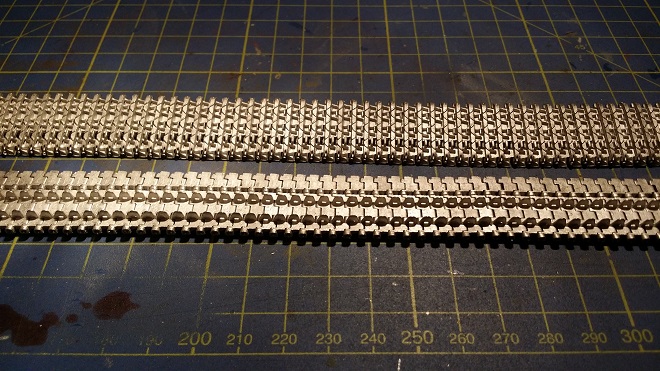

#33 Posted : 24 April 2016 15:01:15
Well I suppose I should put these together before I carry on with the weathering as it would look a bit daft with brand new tracks and a beaten up tank!!LOL BigGrin

#36 Posted : 15 June 2016 18:33:16
Well I managed to get one side done at last!!! (yawn! lol)

#38 Posted : 13 July 2016 15:16:30
Metal tracks look very nice, how long did it take to out them together, a bit of patience needed I should imagine
#39 Posted : 13 July 2016 17:26:35
Thanks for looking in peeps. The tracks take about an hour a side to pin and the same to clean out the link holes, got them down to a fine art now!!
#40 Posted : 24 September 2016 19:25:58
At last I have finished both sides! LOL I can get some paint on them now and get them fitted, may actually get this finished!!LOL
