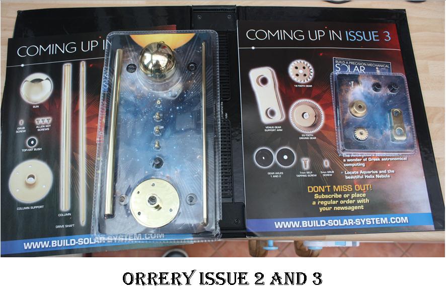

Issue 2 and 3 arrived today
It seems I have to be patient and collect all of the Stage 1 part of the build before I can start
More to follow

Next parts have arrived and these include build instructions so more pictures will follow shortly
Current Build:-

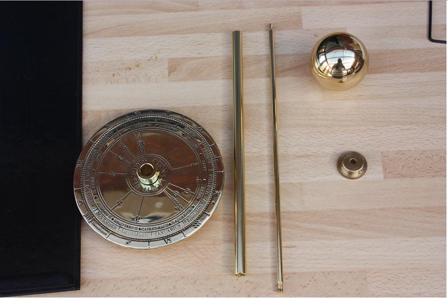

Stage one of the build starts with the construction of the column support/drive shaft
As this build progresses more gears and planets will be added to this column
1) The sun is screwed onto the threaded end of the drive shaft
2) Then slide the 55 tooth driving gear so that it fits snugly against the sun
3) The planet arm that holds Mercury slots into this gear (It is important that the arm is inserted correctly. This is helped by the fact that the arm has a small hold into which the planet is inserted, the other end is solid) the gears for this build are of varying sizes identified by the number of teeth on the drive. It would have been useful if the gears had some sort of marking as to how many teeth are on the drive
4) The next step is to construct the small gear set that drives the planet Venus around the solar system. The instructions are clear enough just be careful that the parts are orientated as shown. There are two gears for this part of the construct 65 and 19 so easy to identify. Do not over tighten the self-tappers used in this part of the construct, make sure the gears still rotate freely
5) The gear arm is attached to the central column. Insert the top hat bush into the top of the unit and push the unit up the column until it reaches the driving gear already installed. The 65 tooth gear should be on top and this meshes with the gear already installed.
So far So good
Current Build:-
