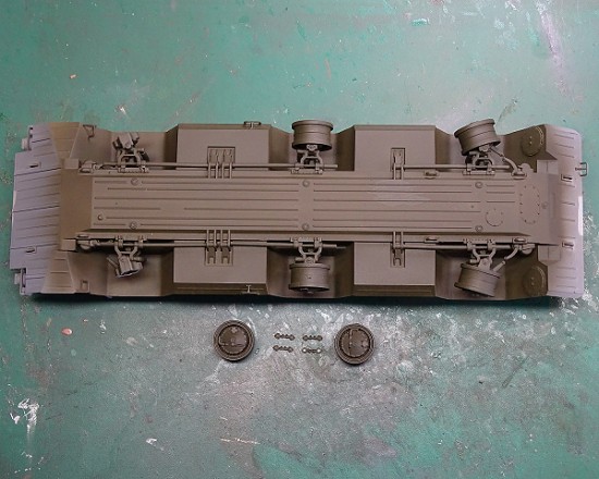

Thanks for the comments so far. This build will take a little time since my work involves night shifts and I don't get to spend as much time at the workbench as I would like. Moving on........When attaching the suspension units to the hull I first attached the central axle stubs with masking liquid (Humbrols Maskol) These pieces will need a little movement when placing the suspension units over them. Secondly you will probably have to open up (I had to) the lower square recesses on the hull slightly to allow the suspension unit square lugs to fit in.
The suspension is almost complete. Undercoated and painted with A.Mig-931 Russian Dark Base which I use for most of my Russian builds. Apart from the 2 centre wheels, which are rigid, I have left the remaining 4 off along with the steering arms which I will cement in place once I have decided on the angle of steering that I want to create.
The photo shows the amount of steerage available, the hull/suspension steering linkage arms and the linkages themselves.
Photos of 'Gecko' with wheels turned are hard to come by but I did find some accurate CAD drawings showing them off very well.

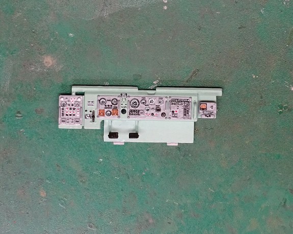

Next on the to do list is the Drivers/Commanders cab. The instrument panel has been hand painted with the dials cut from the larger kit panel decals.
A mixture of Humbrol enamels were mixed to make up the bulkhead colour although I think it should be a more sickly green colour. The remainder was painted in acrylics.

Stunning work with the dials ThumpUp

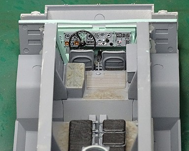

I'm presuming that I did not post this next pic since it doesn't show up in previous posts.
It's the view of the drivers/commanders csbin with the instrument panel and steering wheel in position.

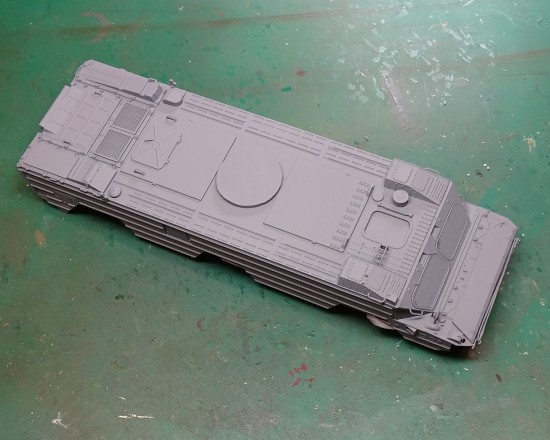

Having completed the painting of the lower and upper hull interiors it was time to move on to the upper hull exterior.
This part of the construction is very straight forward with a few pieces of PE to add two of which are handles that require a bit of bending.
I haven't added all the external parts since some of them will need a base coat on both sides, get in the way of future painting or be easier to paint as individual items. The photo below shows those parts.

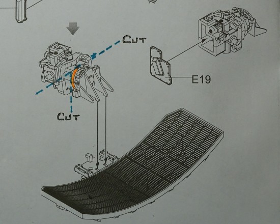

During this week I have been toying around with the upper radar array. The kit does not allow the radar dish to rotate and therefore if assembled as the instructions show the radar dish will be permanently fixed facing the rear. I wanted to be able to position the radar in whatever position I felt showed it off to it's best.
On viewing videos on U-Tube and googling the 'Gecko' I found that kit parts C86 & C87 are not fitted to working radar arrays. They are probably locking bars to hold the array whilst traveling inactive.
Internet browsing also showed the point of where the rotating head is attached to the fixed base. This area is on parts A11 & E9 once cemented together. Having found this point, using a thin razor saw, I carefully separated the pieces on the line as shown in the photo. i Added a thin shim of plastic card to replace the cut away portion of the rotating base. Now it was just a matter of drilling a hole from the top of the mounting, through the shim and on through the top of the fixed base and adding an appropriate length of plastic rod.
Here's hoping the pictures will show the process.
