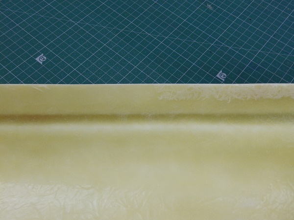

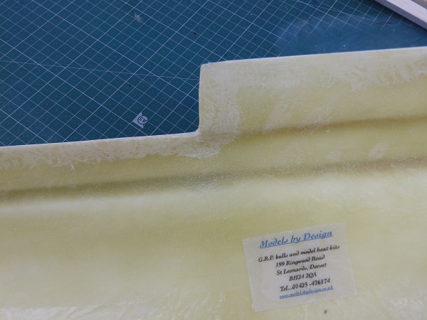

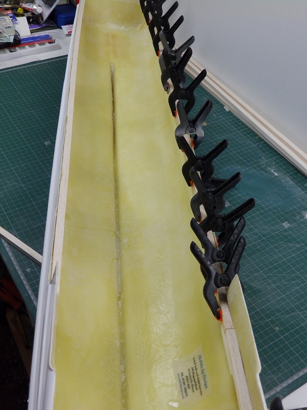

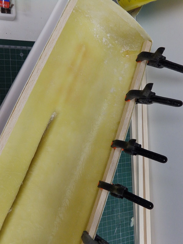

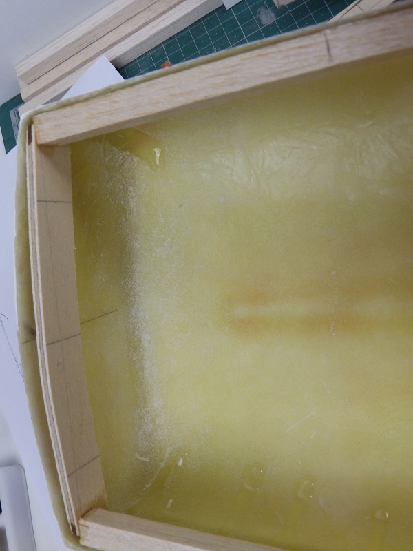

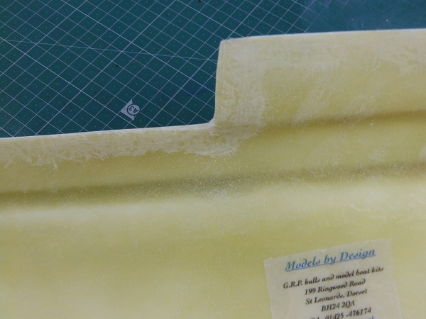

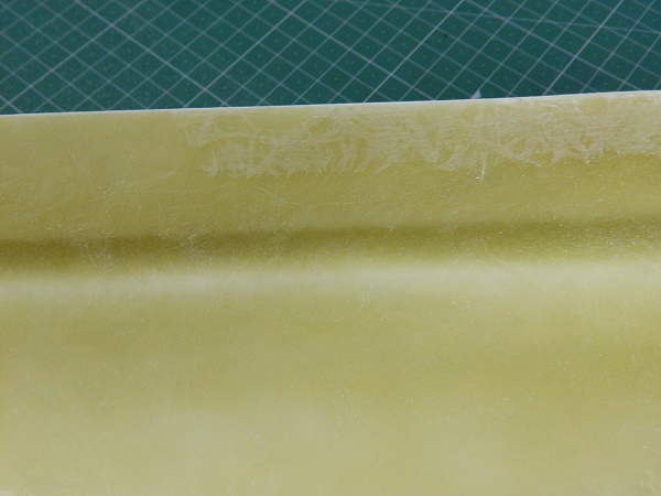

Made a start on the hull but firstly the hull itself needs some preparation as there are release agents and waxes used in its making that need removing otherwise that part glued to it if not removed can pop off with the slightest knock. The outer hull after filling any imperfections can be rubbed down with wet and dry to remove the shiny part of the gel coat this should then leave the hull ready for a coat of primer. when sanding the outside or inside of the hull its best to use a face mask as the dust is quite harmful to you.
The inside of the hull will need to be sanded back where ever you are going to stick something to it and you can see in the pictures where I have used a rotary tool to take off the surface ready for the epoxy.

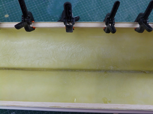

The first thing to add to the inner hull are the side stringers these are glued to the hull leaving a gap above them the thickness of the deck panel ready for when it is attached. Another thing to look out for is the hull can either spread outwards or inwards to rectify this beams will be added at around every four inches along the hull.

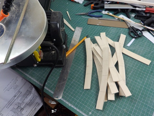

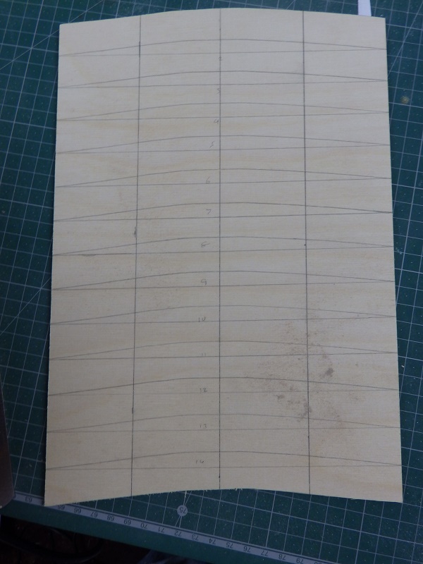

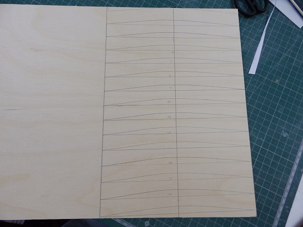

For now the fitting of the stern deck area is what we are concentrating on although some of the beams will be left off to aid the fitting of the rudders and prop shafts. The pictures show the beams marked out on plywood ready for cutting out using my scroll saw.

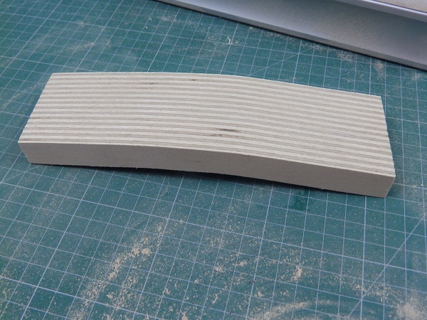

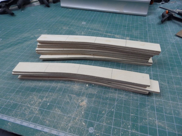

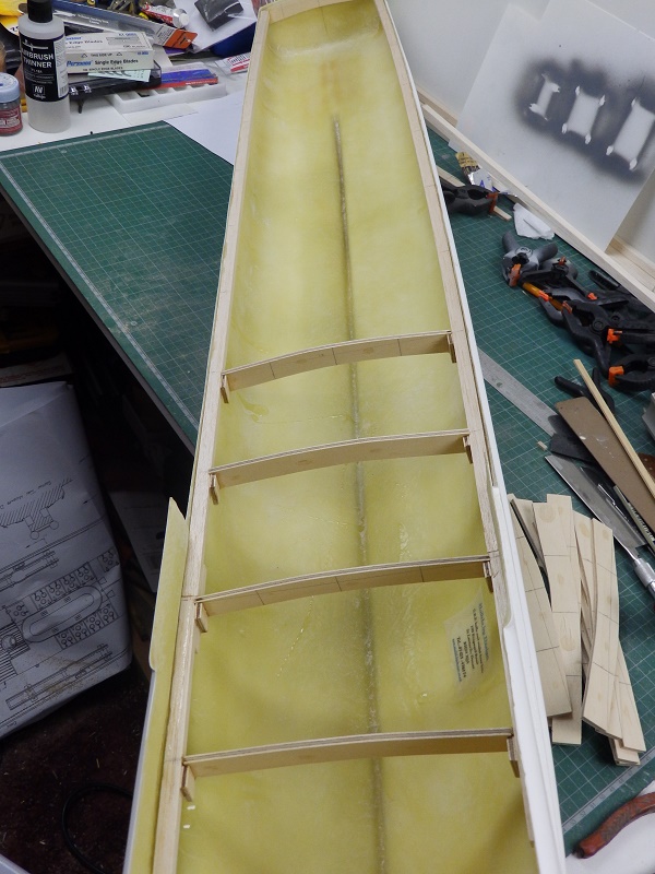

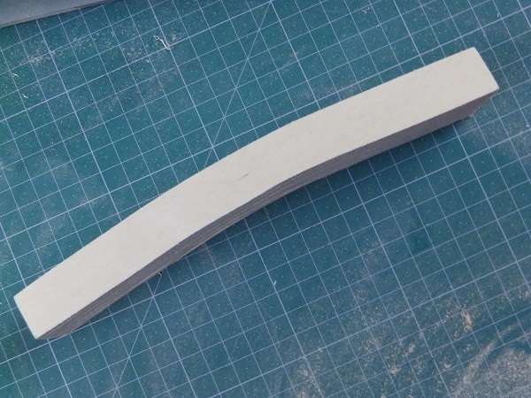

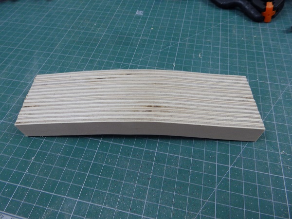

Today I cut the beams I marked out yesterday then it was a case of spot glueing them all together and then sanding the top curve so all the beams are the same shape so the deck will fit across them properly.After the beams were all the same shape they were separated ready for fitting.
You may have noticed the beams are all the same length the reason for this is they are all 202 mm long which is the widest part of the deck the other beams will be trimmed to fit as the hull tapers to the bow and stern.

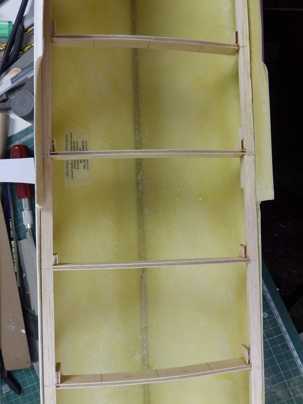

Next the side stringers were marked off at 4 inch intervals to give a guide for the beams placing. the four most forward beams have been added along with some fillets from off cuts to give a bigger glue to wood area and lastly the stern beam was added. the rest of the beams will be added after the hull is fitted out with the running gear. The build is stalled right now as I am awaiting the arrival of the A frames for the outer prop shafts before fitting them.

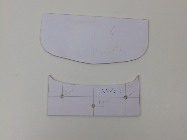

BigGrin More bits arriving that I forgot to orderBlushing Blink Blushing like propshaft A frames and the third larger central rudder. I have also had to order brass tube with an internal 6mm diameter. The hull has been marked out ready for the shafts and jigs made upCool
