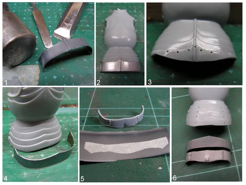

OK then, in Photo 1 we have the basic set of tools I used to create the first piece of the Fauld plates – the front section. Kev was almost right in suggesting the ball pein hammer, this is a very similar hammer as seen here but not used in the way Kev was thinking! As these Fauld plates are essentially flat sheets bent into a simple curve, and the tuna tin metal is very soft and malleable, I was actually able to bend the metal into the required curve by pressing it against the wooden handle of the hammer and firmly smoothing along the sheet with my thumb to form the curves. The ‘business end’ of the same hammer was used in the traditional sense to form the raised line in the centre, which matches up with the moulded plates above. After marking the centre line in felt tip on the reverse, the wood chisel was given a solid ‘thump’ to impress the soft metal, creating a raised line on the front face (apologies to all competent wood-workers here – I know this is a sacrilegious use for a chisel!)Blushing Once that was done, the flat spatula type tool seen beside it was used as a punch with the hammer to tidy up the outer edges of the raised line by tapping it down from the exterior side. The finished plate can be seen in the foreground and also resting on top of the kit torso in Photo 2.
Photo 3 is a close up of the same torso piece with the new plate removed. You can clearly make out the top outline of the reduced bottom plate, compare the bottom edge with the previous photo and you can see how much of the kit part was actually behind the two moulded on Tassets! The line of little drill holes marks the top of the new plate location. You see, because the torso has part of the bottom plate moulded on I can’t just glue the metal replacement straight on top – to maintain the overall thickness of the overlapping plates, the moulded one now has to be sanded down smooth, level with the next one up! Once that plastic has been removed, the drilled holes will mark the upper edge for the new metal plate to be super glued up to. Photo 4 illustrates the rear half of the torso together with it's replacement bottom plate. Again, that moulded bottom Fauld will have to be sanded away to fit the metal one in place and the single hole seen here marks the position of the strap for the ‘hinged’ lowest plate.
Which brings us to that very same plate! After constructing the front and back Faulds in the tuna tin metal, I was very pleased with the overall effect. The problem came when I offered up the kit part shown in Photo 5. The plastic part now seemed far too thick compared to the scale thickness metal parts – there was only one thing to do and that was to make an entirely new hinged-section too!Blink Masking tape was stuck over the plastic original and trimmed back to fit the size and shape. Once satisfied with it, the tape was removed and pressed down onto the tuna tin as shown in this photo. After carefully scoring around the tape, it was removed and I cut out the shape from the tin (the hardest parts of the cutting out are the curved sections, of which there are many! I find it much easier cutting a curve from right to left so sometimes it was easier to cut outside of the scored line, remove the entire piece from the larger metal section and then make right to left cuts from whichever side was easiest, right way up or upside down!). Finally in Photo 6 we have both the lower Fauld and the hinged plate below the plastic rear torso. The ‘bum’ depression was created with the hammer and another one of the stainless steel tools shaped like a flat spear head (I believe the actual set is for wax sculpting but they’re great for Milliput sculpting too!) This photo was taken right after the first ‘bashing’ session, the dents and depressions have since been slightly cleaned up although the two side dents will be completely covered by the suspension straps anyway.

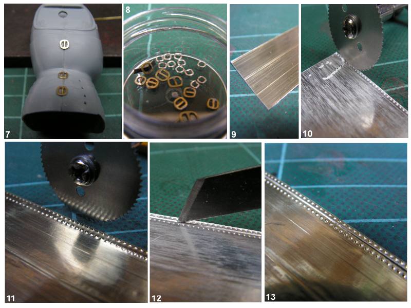

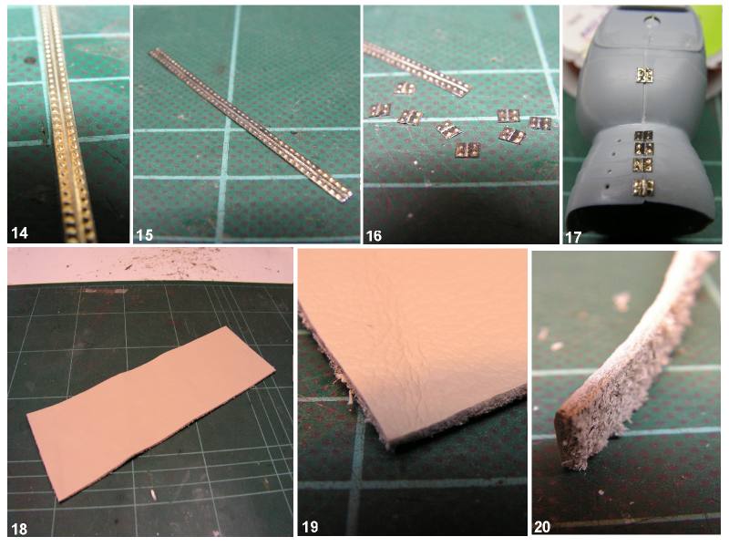

Buckles and Hinges Pt 1: The Buckles
The biggest problem I encountered at first was trying to form the brass wire into rectangles small enough for this scale. I tried using every mini pair of pliers I had but even the smallest and finest still wouldn’t allow me to bend accurate and even shaped rectangles. The answer came, as many others have done, whilst searching for ready made buckles on the internet. I came across an explanation by another modeller who was making up seat belt buckles for 1/35 scale vehicles – he was using fuse wire instead of the 0.5mm brass wire used here but his method of obtaining the initial squares was so obvious I still feel pretty stupid for not seeing it before! Instead of trying to form the shapes with pliers, all you have to do is bend the wire around a suitably shaped former – like I said – so obvious, but as is often the case in modelling, tunnel vision sometimes takes over – once I’d decided on using pliers I became fixated on that method alone!
Photo 1 illustrates the simple method itself. The other chap had used a square plasticard core but to form brass wire I needed something as strong as the brass – ie, more brass!Blink I used three different sized brass square rods for the buckles, the two larger ones had a hole drilled through to start the coil off with, the thinnest one was too small for that so I simply gripped the start of the wire against the rod with pliers. The brass wire was wrapped around the rod, keeping it as tight as possible before cutting off the start end and sliding the resulting coil off the rod as shown in Photo 2.
This first batch was then snipped up through the middle with my finest wire cutters to create the set of buckle shapes as shown in Photo 3. As you might notice, a couple of them are not exactly ‘square’, I later refined the process, squeezing the coil against the rod to even up the sides and then cutting the coil off by slicing down the middle with a thin cutting disk instead of using the wire cutters. The subsequent sets were better shaped! The next step was to create the central bar over which the eventual strap will pass. This was probably the most exasperating task so far on this build (with the possible exception of the chain mail experiments to date). The bar had to be cut to such an exact size that many ended up going just a hair’s width under size, which made them useless! It was a case of cutting just oversized and then grinding down each end of a 2mm? Piece of brass until it could ‘snap’ into position, holding itself in the middle until I could fix it with a tiny drop of solder as shown in Photo 4. More than once I got it just perfect only for the ruddy thing to ping out of the tweezers and vanish into oblivion! The perfect fits were snapped into place using the bottom of the large cylindrical aluminium knife handle and then the whole thing was gripped in the very tip of the spring tweezers for soldering (and another great opportunity for the ‘pinging fairy’ to strike!)Cursing Three finished buckles can be seen in Photo 5 alongside the 0.5mm wire used to form them, whilst in Photo 6 you can see the growing collection of buckles – there are three sizes here, the smallest ones are for the side straps of the breastplate, faulds and tassets, the middle sized pair are for the straps securing the helm to the bevor and the largest one is the main buckle for Frederick’s sword belt. There is another set of buckles to come yet – the ones for the tightening straps on the arm and leg armours – these will be even smaller!Blink
In the next part of this section – Forming the Hinges.

I've split the second part of 'Buckles and Hinges into two parts - mostly because the leather turned up and I've gone back to the buckles again! Anyhow here's the first bit!
A test fit of sorts is shown in Photo 7 running on from last week with three of the side strap buckles placed on the torso, whilst the final shot for the buckle collection is seen in Photo 8. You can see those smaller silver buckles at the back of the group. These were made from a smaller 0.4mm silver plated wire which I found in the local Hobbycraft store – a 20m roll for just £2 – not bad at all considering the ebay prices were very similar! I did come across a slight problem here though, I assumed the wire was silver plated brass but when I sanded down the solder joints I discovered that it seems to be silver plated copper instead. I don’t think I’m going to be able to get the central bar to fit inside these which leaves me with a decision for later – do I solder them, sand them off and then paint them back to silver or simply squeeze them into shape and leave the silver plating intact? Time will tell on that one. Note also at the top left an initial trial using a tiny bit of black leather inserted through one of the brass buckles. This is a more supple leather than the off cuts I’m still looking for and was consequently more difficult to slice down to scale thickness. It’s not bad though, but I will still try and get some tan coloured leather to try out before I decide how to make the straps for real.
And now on to the brass hinges!
I did a lot of thinking on these hinges – I considered trying to fabricate them out of actual thin brass sheet or strip, the problem is, they are so ruddy small that it’s almost impossible to hold them with anything in order to file or sand the ends smooth! In the end I realised that I already had a good facsimile of this brass right in front of me – Mum’s old eye ointment tubes again! The same material which I had used for corrugated panels, was already plated with a gold/brass finish on the other side! (As is shown in Photo 9). The first task was to introduce a line of ‘rivets’ into the opposite silver side using the good old circular saw blade from the rotary tool set as illustrated in Photo 10. What I haven’t shown here for clarity is the six inch steel ruler, which I first placed in position to roll the saw blade along. With the first line in place, a second was then embossed a couple of mm inside the first. This is shown in Photo 11 with the tube metal now brass side up showing the rivets in relief. With the sheet upside down again, the steel rule was used once more to scribe a line or channel between the two rows of rivets as shown in Photo 12. When that was done, we then have a strip of ‘hinges’ with the central bar or pivot running down the middle as in Photo 13. Photos 14 and 15 look pretty similar – this is because the thin coat of Humbrol Black Enamel Wash doesn’t appear as dark in the photos as it does to the human eye! When the hinges are finally glued onto the silver gilded armour, I’ll probably give them another wash to emphasize the shadows further. All that remained then was to slice the hinges off the strip, each one having two sets of rivets as shown in Photo 16. The cutting process does flatten the ends of the central bar in some cases but this can be remedied by carefully re-embossing the channel with the large sewing needle – and finally for the hinges, Photo 17 illustrates the set of five, temporarily placed on the left side of the armour where they will be glued after the silvering and ‘steel’ washing is complete.
In the meantime, my leather off cut has arrived from ebay! It is shown in it’s entirety in Photo 18 and is a 8 x 2.5” piece of “Warm Beige” which worked out at about £1.30 or so. Unfortunately it is also of the ‘soft’ and pliable type which, from my point of view, is a little more difficult to work with as I mentioned compared to the stiff type (like briefcases are made from for example). As I still can’t find my old pieces of leather, I’ll have to go with what I can find! I do like the colour however, I think it’ll go really well up against the steel plates later on. As you can see from the close ups in Photos 19 and 20, the leather is way over thickness for this scale and in the next part of this section I’ll show how the initial trial straps were formed. In working on them and after some further web research, I discovered that there was indeed an easier way to accomplish what I’ve done so far (I thought there would be!)Blink So I’m now waiting for another delivery from China – more on that in the next instalment!
Until then –Happy Modelling to you All!
Robin.

Carrying on from the last instalment and the introduction of the oversized natural leather....
The basic technique for turning the standard leather piece into scale sized straps is shown in Diagram 21. From top to bottom we start with the full thickness leather as shown earlier. The first task is to shave away the fibrous underside of the leather to leave as thin a layer of just the top surface as possible, as illustrated in Photo 22. In this case (more of a trial than anything else) I used a brand new safety razor blade as shown in that photo. What’s really surprising is the amount of material that has to be removed as you can see here!Blink After I had completed this trial, a little further searching on the web revealed that this process is called “Skiving” (Sky-ving), I have to wonder if the term ‘skiving’, ie, to remove thin layers of something gave rise to the slang term ‘skiving off’!Blink Anyway, I since learned there are actual tools available to perform this task called Skiving Knives (as well as very expensive Skiving Machines as well). There are two basic types, one shaped like a paint scraper for larger areas and another a bit like a vegetable peeler. The peeler type is available on Ebay (from China) for less than £2 (free p&p) so I’m putting off any more strap production for the time being until that particular item arrives and I can try it out – you can also get them from UK suppliers, but why pay around £7-10 when I can wait a few weeks!BigGrin
After the leather has been suitably thinned down the next task is to slice it into thin strips the actual width of the strap required, (third piece down on the diagram). Once that is done it’s time to thread the strip through the brass buckle constructed earlier. Passing the strip through the first section was easy enough (sort of) but I found that passing it down through the other half was much more difficult and required the inserting end to be cut down, both to a ‘V’ shape as shown on the diagram and also by slicing off the underside even further as shown in the ‘bubble’.
With the leather strap now threaded through the buckle, the longest part was cut off as illustrated in the fourth section down. Once removed, the ‘buckled’ part was given two pierced holes using a large sewing needle, either side of the buckle, into which will later go the locating brass pins. The remaining cut off section was then given a series of similar holes to form the protruding part of the strap, which sticks out beyond the buckle as shown in Photo 23. This section was then super glued up against the brass buckle after first slicing off the underside to give the illusion of the strap coming up from ‘under’ the buckle itself (the angled end shown in the diagram). The completed strap is shown against the traditional penny in Photo 24.
Using that needle to pierce the holes was easy enough but quite hard on the fingertip doing the pushing! The obvious answer (discovered millennia ago by the female of our species) was to use a thimble!Cool Haven’t got one of them however, so I improvised a more controllable handle for the needle by cutting off a couple of inches from one of my ‘The Works’ paintbrushes, drilling it out and pushing the needle down the hole as shown in the before and after shots of Photo 25 – it’s much easier to grip the needle now (and more accurate as well)!
Finally for this instalment, Photo 26 shows the three straps pushed into place using the brass pins on the right hand side of the torso. They need a little trimming down to get them to a similar length and the top one will need to be re-done as the tiny little cross bar broke away from the buckle during the insertion process but it gives a good idea of what the finished effect will be with the ‘excess’ parts of the strap sticking out quite a bit as in real life, unlike the moulded originals which were flat to the surface (and much smaller too). Those brass pin heads also have to be ground down into a smaller diameter too.
As I said earlier, I’m now waiting for the Skiving Knife to arrive before I carry on with the rest of the straps, of which there are many, on both the arms and legs for example.Crying
In the next instalment, Frederick’s left arm will be getting the surgeon’s attention (and the blacksmith’s too!)
Robin.

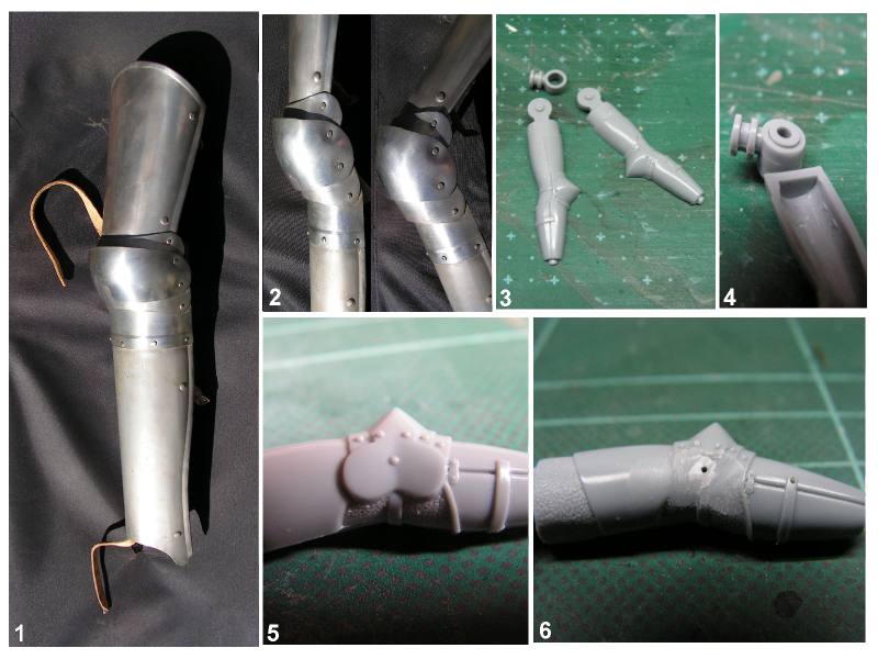

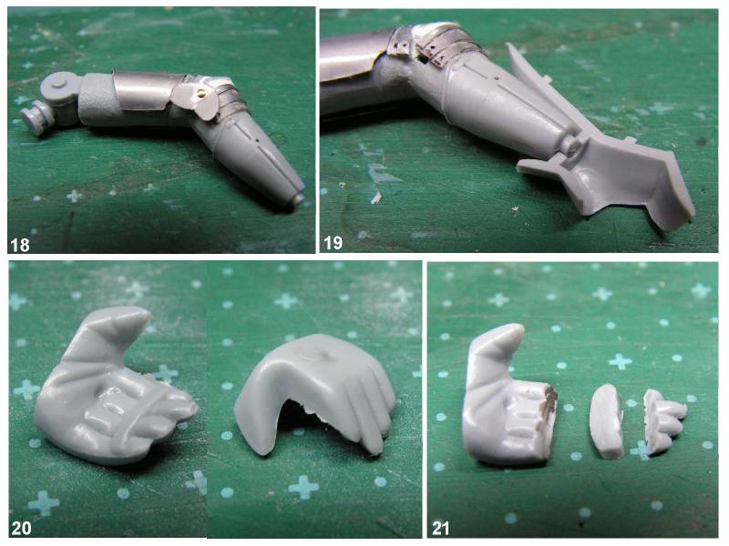

Before I begin hacking up Frederick’s left arm, here’s a quick example of how this type of jointed armour actually works. Unfortunately I don’t possess a piece of arm protection in this style (mine is a two piece shoulder and forearm with no elbow protection) but I do have leg armour with the same riveted ‘lobster-plate’ joint as shown in Photo 1 which will serve the same purpose. Apologies for the dull finish, I should have polished this up months ago!Blushing Photo 2 illustrates the moving joint system with the straight limb shown on the left and the flexed or bent limb on the right. Most of the movement is taken up with the knee (or elbow) piece, and the riveted plate below it. The knee ‘bowl’ is called the Poleyn but the corresponding elbow piece would be called the Couter. If you compare the Couter and adjoining plate in the two photos you can see that there is more of the plate showing in the bent photo illustrating how the Couter has rotated up and back from it. Both of those plates are capable of hinging and in the highest grades of armour the movement in both would probably be about the same.
Photo 3 shows the three parts of the main left arm (there are another three parts later to make up the gauntlet). As you can see everything is moulded ‘in-situ’, and despite the moulding being of excellent quality, a lot of it is going to have to be replaced in order to bend the arm. Photo 4 shows the movable shoulder joint in place on the inner peg. If following the kit instructions to the letter, those two rims on the plug would have been used to trap the joint between the two halves of the torso giving the arm some movement at the shoulder.
In Photo 5 we have a close up view of the elbow joint itself. There were two ways of going about altering the joint, I could either attempt to carefully pare away under the protective ‘butterfly’ plates seen here and then, equally carefully try and cut into the edge of the Couter to salvage as much of the fine detail as possible or I could simply hack off the parts mentioned above and start from scratch. Looking at Photo 6 you’d probably think I went for option 2 but in actual fact I did make an attempt to use the butterfly part! Despite my best attempts, once I began to cut or slice under those ‘wings’ the plastic simply started to curl upwards and eventually cracked away from the rest of the arm. With one side lost, there was no point trying to save the other so after filing down the rivet and replacing it with a drill hole to mark the spot the rest of the butterfly was rapidly removed with blade, grinder and file as shown here. Photo 7 is actually out of sequence! Before attempting the salvage option I took the precaution of marking out the shape of the butterfly using masking tape and a permanent marker pen as shown here (just in case!) As the attempt was a dismal failure this was just as well and the masking tape template was then used to cut out a replacement part in the tuna tin metal. This was then drilled through to take an Amati ‘very fine’ brass pin as shown in Photo 8.

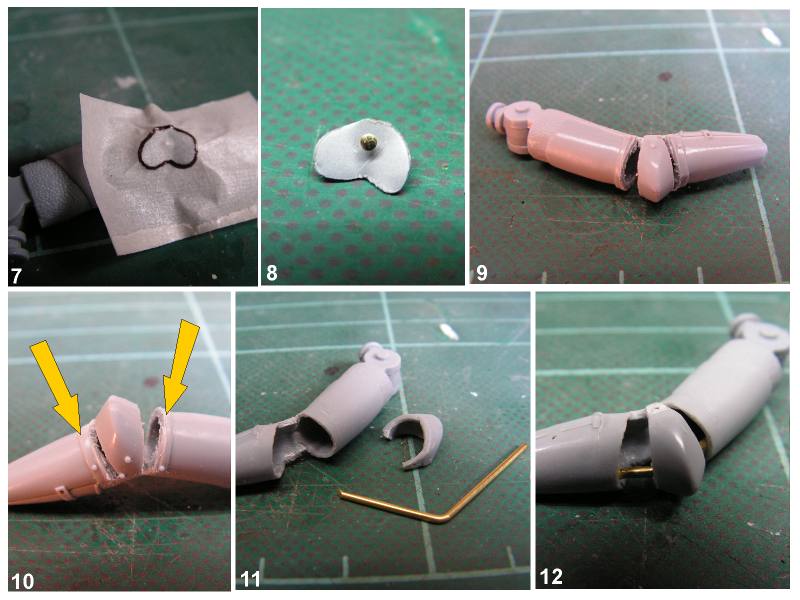

The real butchery begins in Photo 9! The Couter has been sawn through on the inner line beside the ‘dome’. In retrospect, this was a mistake as I later realised that the first riveted plate beside the dome isn’t in fact a separate piece but is actually part of the dome. This meant I’d have to do some ‘repair’ work later on, this error hopefully won’t be repeated on the right arm!Blushing The same stage is shown from the other side in Photo 10, the two arrows indicate the remains of the outer riveted plates – these will have to be sanded away smooth to the surface to provide the under-surface which the outer plates (to be made from the metal can) would be sitting on. Also due for removal is the moulded on strap at the bottom left to be replaced with a real leather one later on. The moulded rivet was again filed down and replaced with a marking hole for a brass pin. I gently flexed the arm into a more bent position hoping that the Couter might stay where it was but in the event it did part company on one side so I removed it completely as shown here for easier cleaning up, in Photo 11. Also shown here is a section of brass rod, bent into the angle at which the arm will be ‘set’. What is probably obvious in the pic but wasn’t to me until I tried to fit the rod in, is that it was far too long to go into both halves of the arm at the same time! It was consequently reduced down in length until I could just get it in, at which point the arm was super glued to the rod (by dribbling the glue down inside) and finally, the Couter was also super glued to the ‘elbow’ of the rod and also liquid poly-glued back to the edges of the plastic armour as seen here in Photo 12.
In the second part of this section the metal armour plates are formed to fill in the gaps in Frederick’s arm, the repair to reform the Couter is achieved and the armoured gauntlet receives it’s own alterations.Blink
Robin.

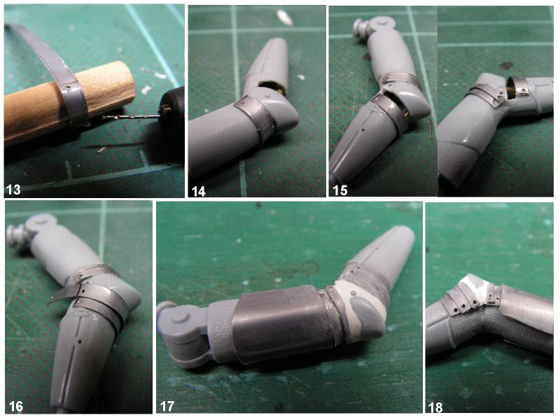

Many thanks for those kind words Ian! Blushing In this installment the new armour sections finally begin to like actual armour!BigGrin
Photo 13 shows the first of the metal replacement plates under construction. A strip of about 2.5mm has been cut off the tuna tin metal and was then simply pressed around a suitable wooden dowel to form it into a curve. After drilling the rivet hole in the starting end, the now curved strip was offered up to the plastic arm and the other end marked in with a thin permanent marker as just visible in this photo. The position of the other rivet was then marked in and using a hard nail, a small punch mark was hammered into the strip to aid drilling out the second hole with the pin vice and drill bit as shown here. (Keeping the darned thing still to be hammered was not easy!)Blink
Once the second hole was drilled out, the strip was cut off along the mark and the completed strip placed onto the plastic arm as shown in Photo 14. As with the full size armour, the effect of forming the strip around the dowel creates a sort of ‘sprung steel’ and the new metal plate will hold itself in position whilst a small amount of thin super glue is applied around the edges with a cocktail stick, ‘wicking’ itself under the plate to fix it in position permanently. The composite Photo 15 shows the first three plates in position following the same procedure as outlined above – the first plate now has its overlapping companion on the wrist end of the arm and the first plate has been fitted on the shoulder end as well. As I said before, it’s a real pity that this lovely ‘steel’ effect has to be silvered over to tie all the metal and plastic sections together later on! Photo 16 is almost a repeat of 13 with the last of the articulated plates sprung into place to be marked for cutting off. At this point, this was as far as I’d originally intended to go with the arm, leaving the rest of the armour as it came on the kit. The more I looked at it however I kept thinking why not try the upper arm section too? The thinking was ‘ it’s only a simple cylinder with no compound curves – how difficult can it be?’ In the end I had a go and, lo and behold, it was easy enough to do - I stuck a piece of masking tape over the plastic part, marked around the edge and then cut it out of the tuna tin before curving it into shape around a slightly smaller wooden former (a paintbrush handle in this case) so that the finished piece would be ‘clipped’ in place for gluing. The result is shown in Photos 17 and 18, the new piece stands out a lot more from the underlying layer than the moulded on original, something that will be far more convincing when the ring mail is added on much later. Also seen in these two photos is the thin layer of Milliput epoxy putty used to ‘fair in’ the new plates adjoining the Couter. This extra depth can be seen even clearer in yet another Photo 18 (I’ve only just realised the numbering mistake – too late now!)Blushing shown with the protective butterfly wings also temporarily back in place. The dimpled bottom layer will eventually be composed of individual metal rings – but not until some more Milliput application!Blink
Photo 19 (without the butterfly again) illustrates one half of the armoured gauntlet placed on the end of the arm to show how it fits on the end of the peg at the wrist. The two ‘tabs’ sticking up on the edge are just the sprue attachments which I hadn’t yet removed at this point. The lower arm is composed of these two halves together with a single piece hand insert which is shown in Photo 20 (front and back views) In the finished model, this hand will be gripping the handle strap of Frederick’s shield so a little more articulation is required from the fingers. The first step for this is shown in Photo 21 – the hand has been cleaned up from the slight amount of plastic ‘flash’ evident in the previous pic and then the fingers have been sliced off at the first and second knuckles which corresponds to the moulded strap. This strap is nothing to do with the shield however, this is the gauntlet’s own strap which secures the hand to the moveable articulated plates protecting the hand inside.

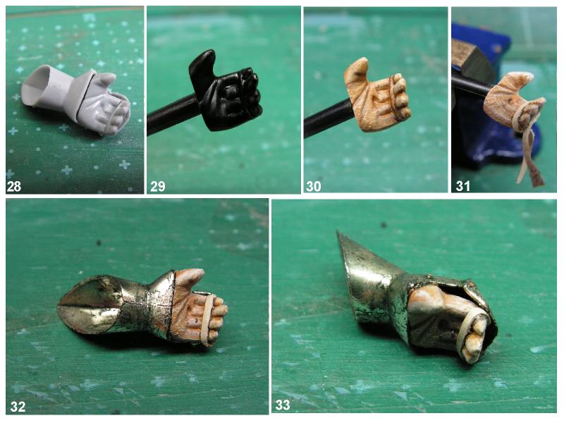

Carrying on from the last post:

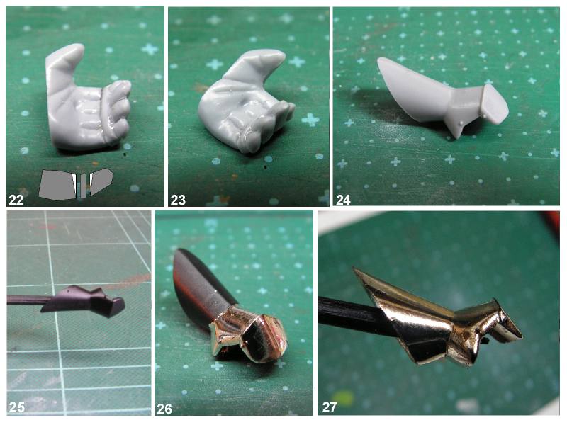

The previously sliced up hand is shown glued back together in Photos 22 and 23. Before gluing, the edges of the palm and finger sections were sanded back, angling down from the top surface as shown by the white sections in the diagram, (these were the parts removed in the sanding). Once fixed back together, this created a slightly more ‘cupped’ hand, seen best in Photo 23. Moving on to the armoured gauntlet itself, this is shown glued together and sanded smooth in Photo 24. It is worth noting that the left and right gauntlets are NOT identical! As in common with this period in armour design, the left hand armour is of a simpler design than the right. This gauntlet was designed to be used only to grip simple leather straps, – either the horse reins or the wooden shield hand-strap. As you can see here, the armoured section has only two parts; forearm and back of the hand guard in one formed piece with an articulated finger guard plate. Since Frederick will indeed be holding his shield in this hand there was no need to fabricate a new finger guard. His right hand however will be gripping his battle sword and that gauntlet has more moving parts for greater flexibility – not looking forward to THAT one!Blink
In Photo 25, the set gauntlet has had a wooden skewer pushed up into the wrist hole for a convenient handle to spray the piece with Poundshop Matt Black primer. Given overnight to dry completely, the next evening the inside and outside of the hand section was given a coat of thinned down acrylic size, left for 35 minutes and then the silver leaf applied to the surfaces as shown in Photo 26. This was then followed by the same procedure for the cuff section to complete the leafing as shown in Photo 27.
Stepping backwards for a moment, here’s one I forgot to put in earlier!Blushing Photo 28 illustrates the re-formed hand test-fitted back into the armour. It fitted fairly well here but it turns out that if you follow the instruction to the letter, some parts are designed to be fitted in when the two halves of whatever they go inside are glued together! This means that some parts of the conversion are going to be a little more difficult than I had originally planned!Crying The next part to come under this category will be the left shoulder armour or Pauldron – I’m still working on how to sort that one out!
After checking the fit, a length of plastic kit sprue was glued to the wrist of the hand to provide a convenient handle for painting and then the hand was sprayed matt black as illustrated in Photo 29. This was followed by the actual painting, which took a couple of days, allowing the base coats to dry completely in the process. The actual technique was as follows:
Over the matt black primer I applied two thick coats of Revell acrylic Wood Brown (382) with 24 hours between the coats. The following day I drybrushed over the glove with Admiralty Yellow Ochre acrylic and once that was dry I picked out the shadows along the strap, in the creases and between the fingers with Citadel Skaven Brown Ink. Finally, another drybrush of the Yellow Ochre mixed with Revell White acrylic to pick out the highlights. The final ‘worn leather’ effect is seen in Photo 30. The next step was to ‘replace’ the moulded leather strap with a real one as shown underway in Photo 31. A new strap was cut from the thinned down real leather and with the sprue handle gripped in the mini vice, a series of tiny drops of super glue gel were applied along the moulded strap before the replacement one was stretched around over the old one as shown here. Once the super glue was set (a matter of seconds) the excess strap was sliced off with the razor blade and the finished hand was re-fitted back into the armour as shown in Photo 32. (That 'temporary handle wasn't quite as temporary as I thought!)BigGrin
With the extra thickness of the leather in place, as thin as that was, this is where getting it to fit back became – ahem, ‘a little harder!’ Eventually it did fit back and I was able to permanently fix the hand in place by applying Revell Contacta polystyrene glue down through the small wrist hole (where the skewer had gone before) and allowing it to flow around the joint from below. The finished armour as shown in this photo and the last one Photo 33 actually looks a lot ‘grottier’ than it actually is – some of the shine was dulled down during the battle to re-fit the glove but it does really look like battle hardened steel away from the macro setting on the camera! In actual fact, much of this part of the armour is hidden away under his shield anyway, still its all good practice!
In the next instalment, I’ll be getting to grips with the shoulder armour to finish off this arm – more tin bending to come!Blink

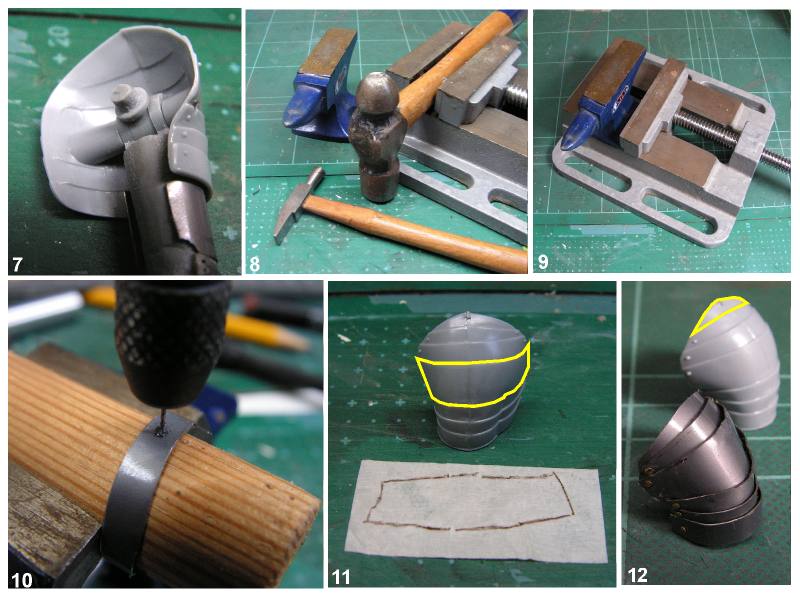

Left Pauldron Part 2:
As promised previously, in Photo 7 we have the inside of the kit Pauldron showing the jointing system used to join the arm to the torso. The two moulded sockets seen horizontally in this shot would have enclosed the two lugs on the end of the arm allowing the arm to swing up and down. At the same time the ‘drum’ at the end of the arm which fits between those sockets and which is not glued would have allowed the arm to swivel to the front or back. As I mentioned, I’ve sanded off those lugs so the arm joint is simply resting in that socket at the moment. Once the arm is cemented into the torso that entire joint system will be encased in Milliput to mould the ‘proper’ armpit area and the Pauldron will be resting in place over the top with it’s new leather straps.
Photos 8 and 9 illustrate my ‘Medieval Smithy’! The ‘heavy’ work was carried out on the ball pein hammer shown here securely held in the bench pillar drill work vice. The hammering was performed with the little jeweller’s hammer although, for the right hand Pauldron I may well try a different technique and try to ‘roll’ the curvature into the tuna tin metal using cylindrical metal knife handles to see if the result is smoother than bashing the hell out of the metal! The finer work was accomplished on the little jeweller’s anvil also shown in the photo. I found it very difficult to hit the metal hard enough without the anvil moving under the impact so in the end I simply fastened the anvil into the work vice in place of the hammer as shown in Photo 9. Also employed, as shown in Photo 10 was a little mini vice with a section of large dowel gripped in it. This was used both in the initial bending of the plates and also as a convenient stand into which to drill the rivet holes at the ends of each separate plate as seen here. Now we come to the most complicated of all the plates – the biggest one shown here outlined in yellow in Photo 11. This one is a nightmare, with a gentle curvature plus a slight kink at the bottom on the back side, and a compound ‘expanding’ bulge on the front side! As well as all that it also has a slight curve inwards at the top edge! The masking tape template is shown below although in the case of this one, there was a lot of extra trimming carried out during the fitting in place, especially along the top edge where about 2 – 3mm was eventually removed.
Surprisingly, despite all the measuring, altering and scissoring, it went together pretty well and is shown almost complete up against the plastic original in Photo 12. Only the final top curved plate is still to go on (again shown with the yellow outline on the original). That final piece; the smallest of the lot was probably almost as difficult to put in as the big hammered one in the middle – by the time I got to that last one I was running out of space for the rivet holes and it got so tight that pressing the brass pins through actually split the metal on the next to last plate requiring the final one to be super glued in place. This is the only one that doesn’t therefore realistically articulate!
The actual process of gluing that final piece is shown from the underside in Photo 13. After securing the piece in place with a pair of spring tweezers just visible on the bottom right, super glue was ‘dribbled’ into the inner overlap with a cocktail stick where capillary action then drew it into the joint. In actual fact I had to do this twice as the initial join gave way during some over-enthusiastic final shaping! The second attempt seems to be holding so far!
The last bit that needed to be added was a small rim around the edge of the lowest plate. This is apparent in photos of the real thing and is just noticeable on the plastic kit parts too. I did have a go at soldering the copper wire onto a scrap piece of the tuna tin bent into a representation of the lowest plate but although the copper was fine to cover in solder, the metal just wouldn’t accept it at all. I think this is due to the lovely ‘steel’ effect being an electroplated covering as I discovered soon after that the metal is actually a bright silver underneath the steel (there must be a fair amount of iron in it too as it’s very magnetic when it comes near the stainless steel fine tweezers)! I finally managed to fix the ‘proper’ rim in place by shaping it around the bottom of the armour with an extended overhang at each side, which was held down to the work surface with masking tape. Holding the armour flat to the surface I could then dribble super glue between the copper wire and the metal plate, eventually fixing it in place. Photo 14 shows the Pauldron in the position it was held in to glue the rim whilst Photo 15 shows it in the fully extended position. The only drawback to the super glue was that the glue left a slightly ‘lumpy’ appearance in the gap between the copper and the metal. This was reduced right down, by going over the copper and the glue joint with the rotary tool and a circular wire brush. It was during this ‘burnishing’ task that I discovered the true finish of the tuna tin metal.
Finally, in Photo 16 we have the finished Pauldron tacked in place on the kit torso. The brass pins acting as rivets will be replaced later with new ones with their heads ground down smaller to scale and the top part of the armour will be fixed down by a leather strap which comes from under the top to disappear under the neck armour or Bevor. There was one last hole to be drilled after this photo was taken, right down near the rim in that ‘kink’ shown in Photo 14. The securing arm strap will go from that kink around to the bottom most rivet on the front face. After I have made the twin set for the right shoulder the two sets will be dismantled and the individual plates silver gilded before reassembling with the smaller brass pins. The ‘bluing’ wash will be applied once the whole thing is fixed back together again, I'm hoping that the wash will act as a sealer, fixing the plates into their final position once the arms are in place. Making the right Pauldron will be exactly the same as the left so the next instalment will probably be getting to grips with Frederick’s scratch build battle shield (then I can sort out his final left arm positioning).
