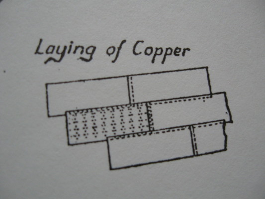

Just a small authenticity detail, if you want authentic then the plates should be overlapped rather than butted, where in reality the tile perimieter nails run in a single line along the overlap, rather than having a double nailed line which is created if you butt the tiles.

Also if you look at Tomick's sketch the lengthwise overlap between rows is less than 50%.
I am currently building the Caldercraft Victory and my only raised eyebrow so far, is that they show the copper plating arranged with a 50% overlap like a brick pattern. However, I have a long way to go before I get to that stage.
I have also discussed with Yotika what effect overlapping the edges has on the number of plates required. I have been told that about an additional 50% may be needed i.e. 3000 instead of 2000! in the case of Victory. However all that is to come in the future, I'm still first planking.

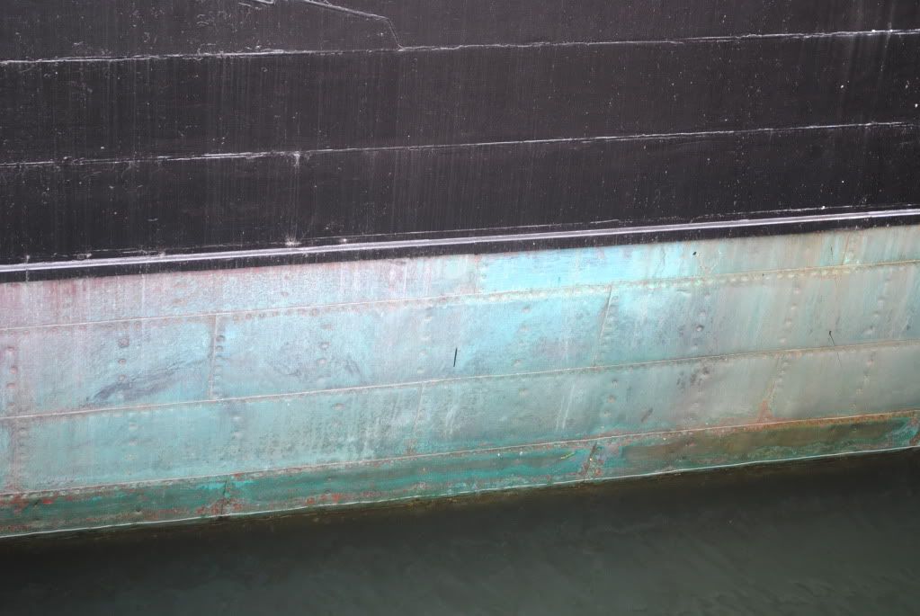

A quick one about the overlapping copper plates, on tommick's sketch the bottom plates overlap the ones above, I would have thought top should overlap those below (like 'clinker build') but looking at photo's I took of the 'Trincmalee' at Hartlepool you can see Tomick is right although the overlap is barely discernable, so it would possibly be a bit OTT to bother with the overlap on a model of this scale??
Here's the photo's of the plates on the 'Trincomalee'.

The drawing is actually from Longridge who has studied Victory inside out.
Plating on a model is a very time consuming task in its own right let alone attending to overlap detail, very much a case of how much time you want to throw at it, where in the main the majority of model builder's/kits go the butt route, including for practical purposes the Caldercraft Victory.

Longridge also points out that overlapping the bottom plates over the top is a characteristic of ships of war. Commercial vessels were coppered with the top plates overlapping the lower ones!
I take Tomick's point about butting versus overlap, I just hope when I get to that stage I will have the incentive and patience to do the longer job. It's up to individual choice in the end!

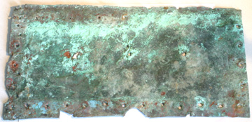

And if you want to go for the 'weathered' look the below photo is of an actual Victory sheathing plate
