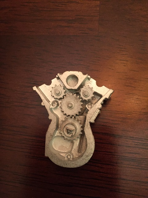

OK more work on the GTO engine.The next step is to assemble the timing gear and the front of the engine.The gear is designed to work to transmit motion from the crankshaft to the camshafts.I took a pic and made a short video showing the gears moving.The gear on the far left is keyed to fit into the end of the crankshaft.
https://youtu.be/oOdu-Xm9dmU

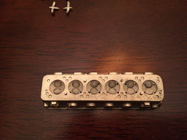

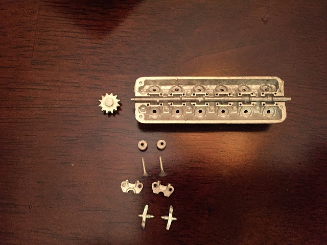

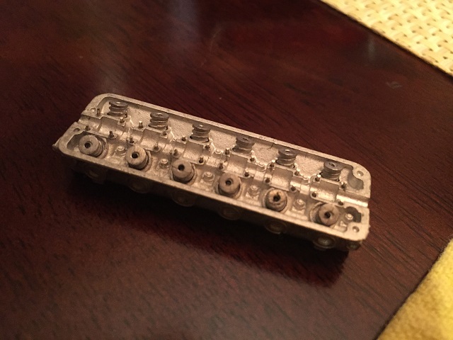

The next step in the engine build is the cylinder head, valve and rocker arm assemblies
The first job was to drill 24 holes in the cylinder head block .These will be for attaching the rocker arm bearings.next you drill 12 holes though the cylinder head for the valves.
Drilling the holes was a trip.They are very tiny (0.5 mm) and you have to be precise.One of the cylinder head blocks in made of clear resin.It was very tough to drill holes in this part because it was really tough to see the pilot hole.
So that is a total of 60 more holes drilled.
108 holes drilled so far.
Here is a pic showing the valve assemblies. There are 2 valves, 2 "springs" ,2 rocker arms and 2 bearings to hold the rocker arms in place over the camshaft.
#35 Posted : 22 May 2016 18:50:50

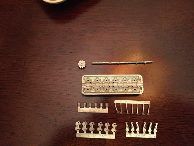

The first step is to insert the valves into the holed predrilled into the cylinder head.
#36 Posted : 22 May 2016 18:57:37
Now I applied the "springs".These are cast pieces that sit over the valve stem.
The final step on the cylinder head to to place 0.5mm nickel wire into the holes that will act as the anchoring point for the bearings holding the rocker arms in place.
This also means you have to drill mounting holes in the rocker arm bearings. 2 per bearing and 12 bearing per engine half.Thats 48 more holes in total to drill.
So holes drilled now 156
The next step is to mount the rocker arms onto the cylinder hear.This promises to be VERY fiddly

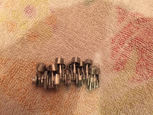

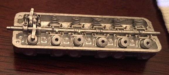

#37 Posted : 22 May 2016 19:08:47
Sounds like your having fun with this one Carl, looking great and more pic's soon please.
#38 Posted : 23 May 2016 15:09:35

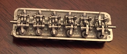

The rocker arm assembly.2 hours of frustration cursing and VERY delicate model making to attach these.They do move up and down a bit as the cam shaft rotates.I will do a video once I have attached it to the engine.
Now I have to do exactly the same thing again with the clear resin cylinder head.Oh joy.

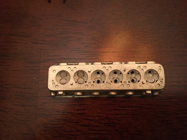

#39 Posted : 25 May 2016 22:44:47
Now started working of the right side of the rocker arm and cylinder head assembly.This is clear resin and it is really hard to see the tiny holes I drilled in it so it toom me a whiel just to get the valves and springs installed.nest step is the rocker arm assembly and then the 2 cylinder head assemblies will be added to the engine block.This kit even has a photoetched cylinder head gasket.Amazing
#40 Posted : 26 May 2016 14:51:41

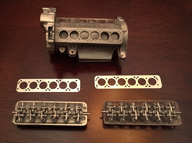

OK after 2 more hours of really bad cursing and swearing the right side cylinder head and rocker arm assembly is complete.The next step is to mount the cylinder head on the engine block.The cylinder head gasket sandwiches between the 2 parts.There are guide hole to drill in the engine block to accept the alignment pins on the underside of the cylinder head.
After that it will be time to paint the cylinder head cover and some other parts and mount them to the engine.Of course each cylinder head cover needs 12 holes drilled in it to accept the nuts that secure it to the block.
