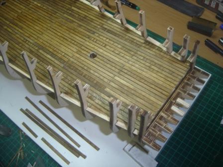

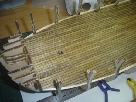

Thank you for the encouragement gentlemen, managed to get the lower deck planking completed today but I was getting a bit anxious towards the end as I only had 4 spare planks left over...no room for errors here.
There are a couple of areas on the deck plate edges at the edges between former's 14 and 18 which require a little trimming on both sides, not a big problem will tackle that tomorrow..

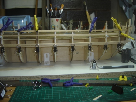

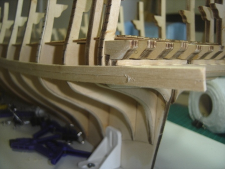

Phew, eventually got all the former's to line up (I think) Got the glue ready, I'm going to use thick viscosity cyano (super glue) to fix the planks to the former's about 4 at a time, this gives me time (about 10-15 sec) to ensure the plank is is the correct place before it sets and then white wood glue between the planks. I used this method on a couple of RC aircraft I scratch built and it worked a treat.
The first couple of planks fitted as per Deag instructions and help from the forum 25mm below the lower deck plate for the entire length of the model.

#34 Posted : 31 May 2016 19:52:17
That looks like a sweet start to your planking.
Always well worth spending some time at this stage as it sets the course for the rest of the planks.
Well Done.
