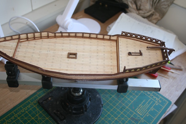

I would like to ask for some advice please.
As I have now finished planking the hull, I was going to varnish it. How many layers of varnish do people apply?
Should I also varnish the deck as I am worried that if I varnish the deck now the deck furniture may not stick very well to it.
Thanks for any help
Xander
#23 Posted : 07 October 2016 05:24:34
BigGrin Hi Xander it all depends on what finish you are after if you want the decks nice and shiny then two or three coats but if you want a dull look just one to seal the deck . I have never had problems with things sticking to the deck if you use water based varnish Cool hope this helps rgd Martyn
#24 Posted : 07 October 2016 21:17:46
BigGrin just had a look on google and the decks are a Matt finish and bleached from the sun Cool hope this helps rgd Martyn
xander
#25 Posted : 07 October 2016 23:07:12
Rank: Amateur Level 1
Joined: 20/11/2015
Posts: 36
Points: 108
Thanks Martyn
I have decided to put one coat of varnish on the deck but 2 or 3 on the hull.
Will post a picture when completed --- hopefully sometime soon.
Xander

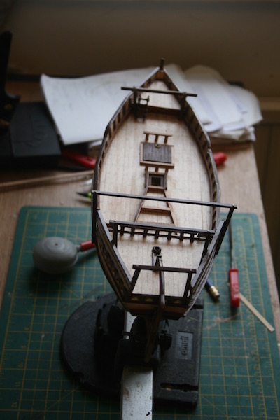

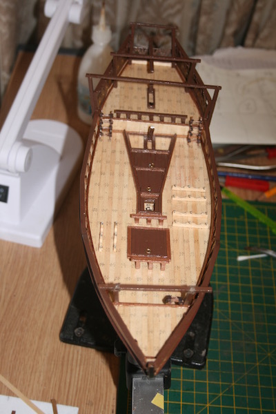

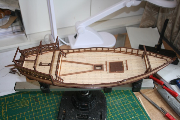

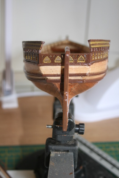

What i meant to say was that I have done some more work on my Dhow.
i have made the mizzen brackets next followed by the stern embellishments. i made these in one piece and then glued them into position.
This was followed by the hatchways, canopy pillars and barrel supports.
The hull and deck were varnished with a clear satin varnish but the hatches were varnished using a gloss varnish.
A personal preference but I like the contrast between the two types of varnish.
Like others before me I have found this to be a very enjoyable and fun build.
enclosing some pictures of my progress so far.
Xander

#30 Posted : 26 October 2016 17:54:54
Very nice update on your build.
I have seen a few of these being built and they look really good with the decoration on the model
Hope it contiunes well for you.

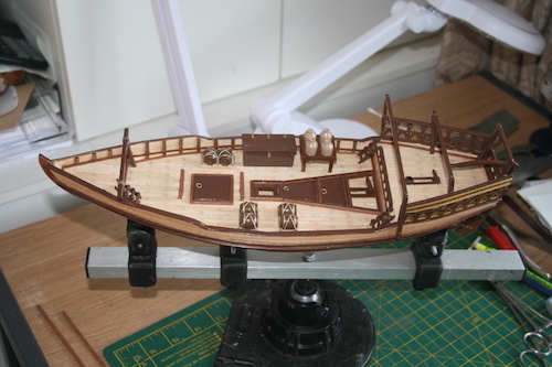

Just an update on my progress on the Dhow.
The barrels were staiined with Tamiya Linoleum Deck Brown and then given a coat of gloss varnish.
I rubbed some wood glue on the end of the thread to stiffen it and this allowed the thread to go through the eyelets more easily.
I found that lightly glueing the barrels to their brackets meant they remained in situ whilst the thread was placed in position.
Then the chest was made. It was stained and varnished before putting the hinges and handles on. finally it was glued on to the deck.
The amphora were painted with Tamiya Wooden Deck Tan, varnished with a gloss varnish and placed in position.
Will now start on the crate.
xander attached the following image(s):

#36 Posted : 02 November 2016 17:39:13
BigGrin Looking good and the barrels look brilliant Cool
#37 Posted : 02 November 2016 18:31:44
Very nice update. You certainly know what you are doing and the results are wonderful.
#38 Posted : 02 November 2016 19:12:01
Great work on the deck furniture.
Cool Cool Cool
#39 Posted : 02 November 2016 23:59:10
Do love the finish you're achieving with this, looking great....Cool Cool
#40 Posted : 04 November 2016 14:55:51
Looking a very nice build. leep up the good work.
IanCool BigGrin
