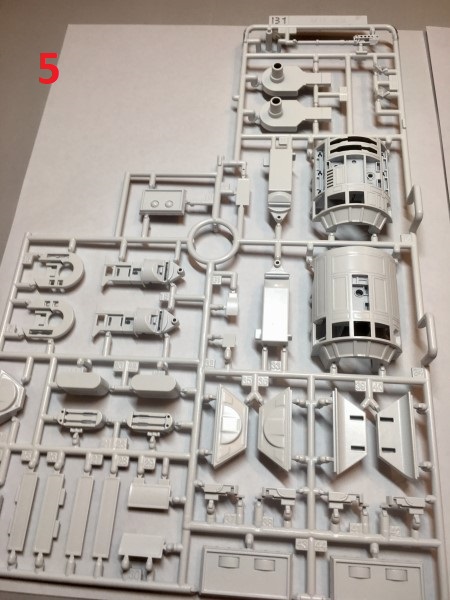

Pictures 5 & 6. I then painted the main body parts with white paint and gave them a couple of coats. The white paint is the same as I am using with the R2 customise build, as is the silver paint.

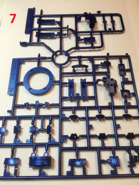

Pictures 7 & 8. The blue parts have been painted, again the same as the custom build. Starting with silver, translucent purple, blue, and the purple again. The only difference I will be doing is not applying the full gloss varnish to the blue parts, as they won’t need it. The picture doesn’t really do it any justice, but you get that metallic blue/ purple look. Once allowed to dry for several days, I will be very lightly chipping the parts with a small sharp knife, allowing the silver to come through when weathering.

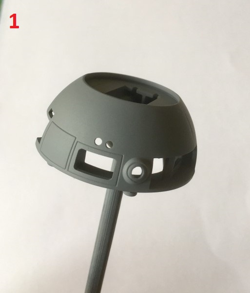

I have been away for the Easter weekend. I took some modelling equipment with me, just in case it rained, and hid it in the boot of the car. So not to be disappointed it rained all Sunday afternoon and evening. Whilst the missus was reading her book, she said it’s a shame I didn’t bring any modelling to do, I smirked.
Pictures 1 & 2. Anyway, on to the build. I started with the dome on R2 by priming the part before painting it with polished metalcote Aluminium.
Pictures 3,4,5 & 6. As you can see in the next picture, you can see the seam. Unfortunately, with this model you have to fit the inner blue panels inside before attaching the two halves together. So, I used some masking tape and some plastic filler, then filed down using a sanding stick being careful not to hit the blue panels.
Picture 7. Here you can see the seam taken out
Picture 8. I then drilled out a hole for the blue and red light to go.

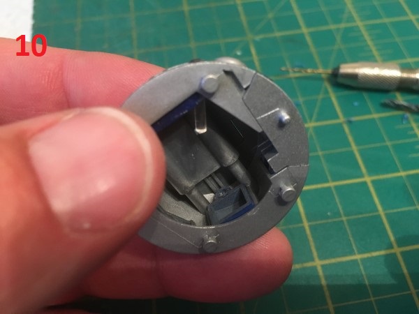

Pictures 9 & 10. I then used a 2mm fiber optic tube and mushroomed the end, before placing it into the hole. The second picture shows the underside. I glued the cable with UV glue.
Picture 11. Here is how it looks when inserted.
