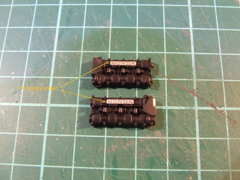

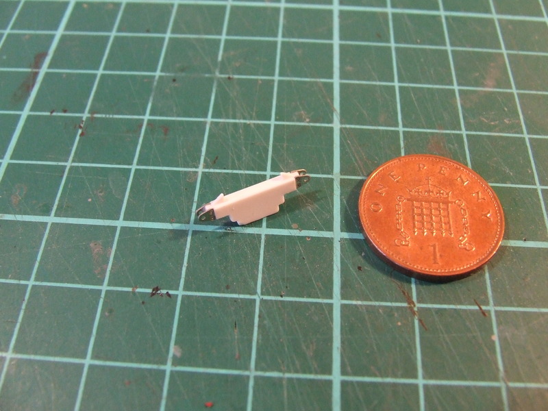

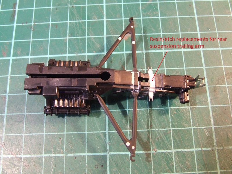

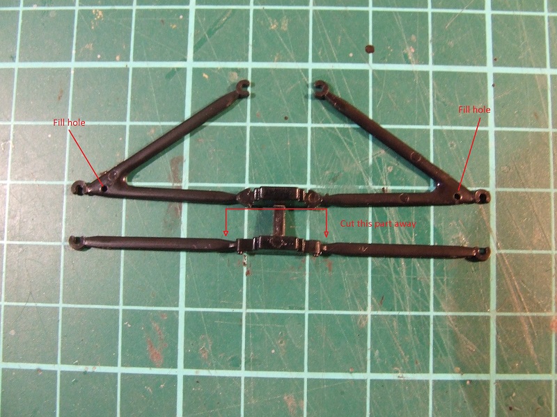

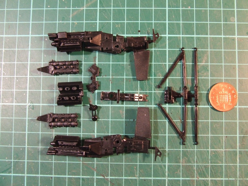

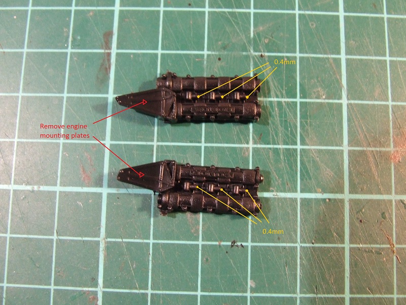

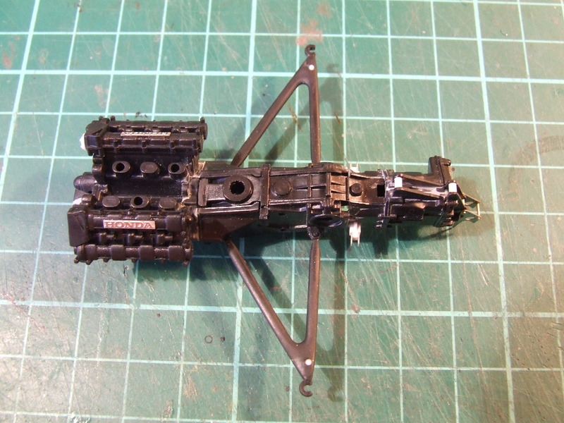

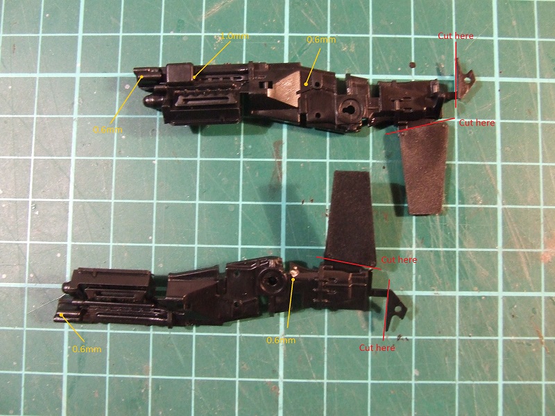

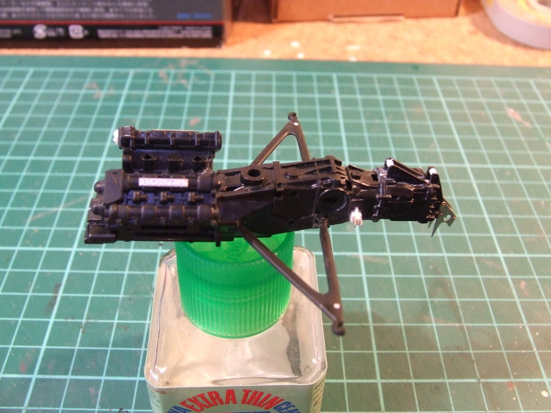

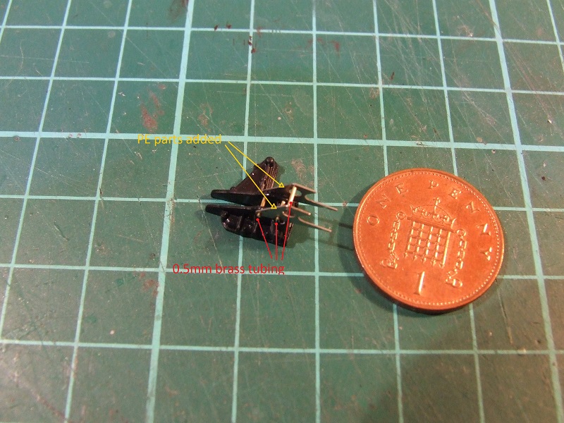

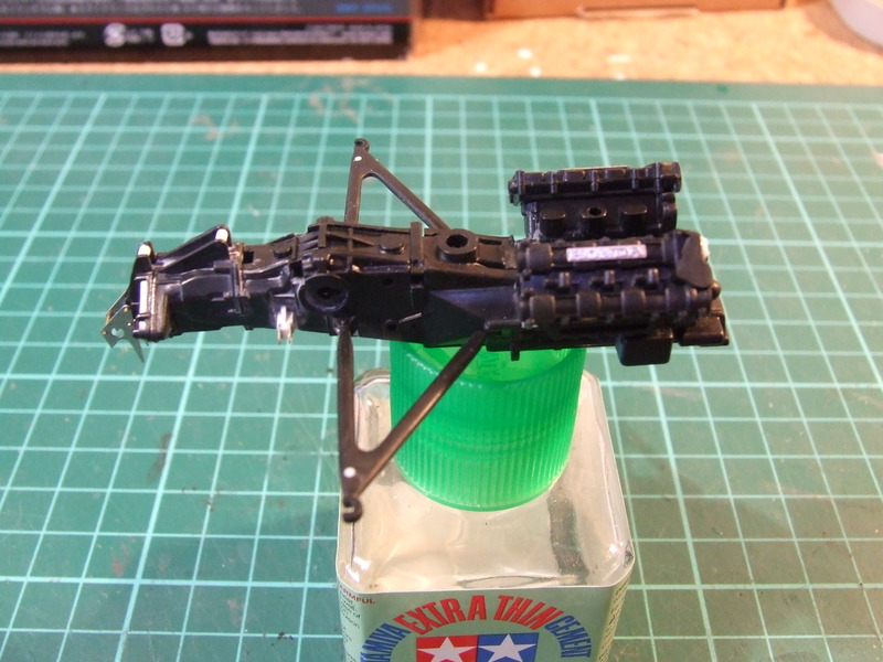

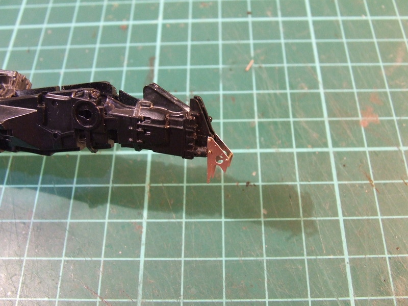

Hello all,
Right then, here we go with my first update on the actual building work!!
I have decided I am going to do this diary slightly different to my previous ones, by having less text between the photos. Where necessary I will add text between them but most of the photos will have text and markers inserted to indicate what has been done at each stage. Where no text is added to a photo they will just be to show a general view of any work completed. Any holes drilled will be indicated in yellow in the photos. The penny shots show just how small this thing is ... and I have an awful lot of tiny parts to add to this engine!!
Photos 1-10 below show the basic parts needed at this point for the construction of the engine, transmission and rear suspension and the modifications I need to make to them. Photos 11-19 show the various resin and etch replacement parts for the rear suspension trailing arm pick-up points along with various scratchbuilt detail parts.
The topmost section of the gearbox/transmission hasn't been glued in place yet as I'll need to remove it to add the top wishbones and fittings at a later date. It will be primed and painted at the same time as the rest of it, then the joints just filled and touched up. It's just easier that way!! Some of the joints look a little messy at the moment but that is just where they have had Mr Surfacer 500 added then been cleaned up. It'll all disappear under a coat of primer. Some of the joints on this kit are really bad, not at all like modern Tamiya kits, but this is a re-release of quite an old kit from the '80s and it is starting to show it's age a bit now!!
Thanks for looking, all comments and constructive criticisms welcomed. Cool ThumpUp
