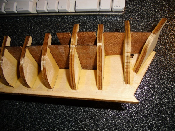

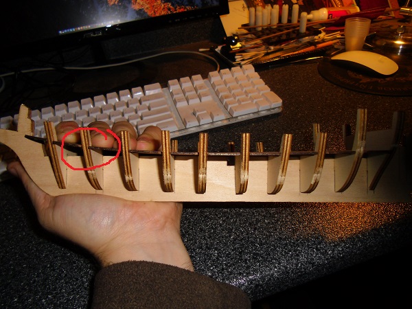

ok, so I've managed to cut all the notches in the deck. What I've learned from this exercise is that it's easy to get the notches out of alignment if you just start at one end and work your way down. The best way to do it is to put in the first and last bulkhead (in this case, it's bulkheads 1 and 10) and then place the intervening bulkheads one at a time (no more than 3 at a time - one on each end, and only one at a time in the middle). Once I figured that out, it went a lot smoother.
Picture one shows a top view of the deck resting in place with the first 10 bulkheads in place.
Picture 2 show a side/underneath view of the same thing.

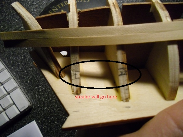

In picture 3, I've tried to show the gap between the deck and the top of bulkhead 2, which exists because the deck seems to be meant to slope down, but needs to be forced into position.
Picture 4 shows me forcing the deck into position with my hand, thereby closing the gap.
The next thing I plan to do is to cut the notches in the aft deck, which fits with bulkheads 9-12. Then I can actually glue some of this stuff into place permanently.
Thanks for people's interest and advice. It means a lot to me.

#22 Posted : 04 February 2017 17:57:35
BigGrin Looking good Richie very nicely done Cool Most decks slope down towards the centre of the ship so it can get rid of the water out of the scuppers Cool

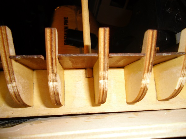

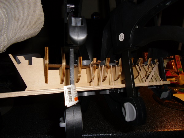

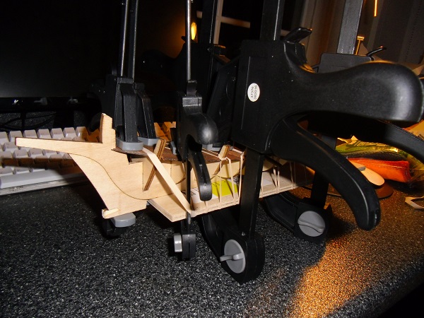

Daffy, you read my mind! I actually made a special trip to harbor freight to buy a couple of extra clamps just in case. I decided to glue the bulkheads and the deck all in one shot, but I didn't trust myself to apply glue and then assemble all the clamps and rubber bands before the glue dried. So I clamped everything up tight as I could, and put rubber bands around all of the bulkheads, and then diluted some titebond wood glue and painted it onto all of the joints, hoping that capillary action would draw the thinned glue into the spaces between the keel, bulkheads, and deck.
These pictures are before I applied the glue. The first picture is meant to impress you with how many clamps and rubber bands I managed to get in there.
The second picture is to show what I thought was a clever idea: I had trouble clamping the bow area as the keel sloped up to about a 45 degree angle with the deck, and the clamp kept slipping off. I cut off the piece of plywood that was adjacent to the front of the keel in the original plywood sheet, and it fit perfectly against the curve, and gave me a nice flat surface to clamp to.
The last picture is just to demonstrate that I think I did manage to eliminate pretty much all of the space between the bottom of the deck and the top of the bulkheads.
Tonight, assuming it all hold, I plan to reapply some full strength glue over all the joints just to be safe.
So far, so good, I think...

#25 Posted : 07 February 2017 18:55:15
Looks good Ritchie, WTG.
Cool Cool
#26 Posted : 07 February 2017 20:54:29
Nicely done Ritchie, looks like you're making good progress....Cool Cool
daffy09
#27 Posted : 08 February 2017 01:34:29
Joined: 08/07/2010
Posts: 1,036
Points: 3,086
Well impressed Richie, a fine job you've made of clamping her all up. Good idea to use a wedge at the bow to level things up.
Happy building
David

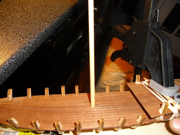

The deck and first 10 bulkheads seem nice and stable, so I notched and glued on the upper aft deck in the same way with the last 2 bulkheads (first 2 pictures).
I'm not really sure of the order of the steps here, but it seemed to me that this would be a good time to drill the 3 holes in the decks for the 3 masts (because I could see where they go easily, without any hull planks in the way.) The two front masts are 6mm in diameter according to the figures, and the backmost one is 5mm. I drilled the holes by starting with a 1mm drill bit, and incrementally increased the bit size until the dowels fit snug. (After the first bit, which fit into a pin vise, I just held the drill bits and turned them by hand. It works ok, as long as the bit is just marginally bigger than the hole. The next 4 pictures show the front mast hole from the top, and side with the dowel in place, and the middle mast with dowel in place from the top and side. As the front mast is canted forward, I think I will bevel the bottom so that it fits flat against the false keel.

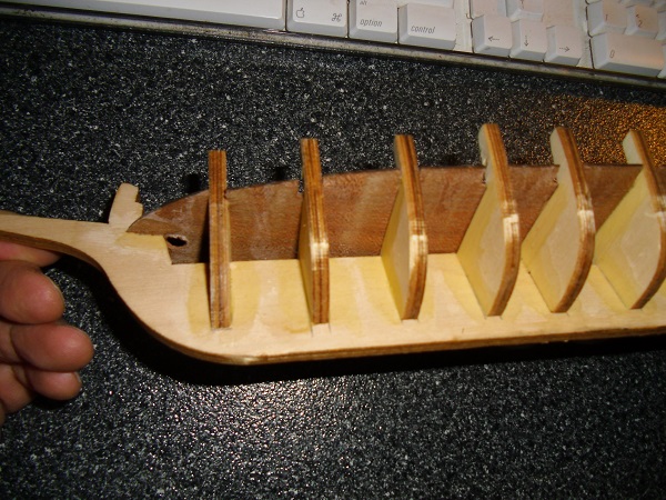

Pics 4 and 5 show the unfaired stern and the faired stern. I would ask some advice with respect to the last bulkhead in the stern. I couldn't really get the file or sanding block down into the bottom, so, you can see that there is still some of the original laser char there. Can I leave it like that? or should I get some little files and try to really get the whole edge nice and angles like the upper part?

#34 Posted : 16 February 2017 00:12:38
Coming along nicely Richie, looking good...Cool Cool .. My initial impression is you need to use a small file and fair the stern some more. Very difficult to tell for certain as I can only see the stern from the side, it would be good to see a couple of pics of the stern looking down the side of the hull.....Cool Cool

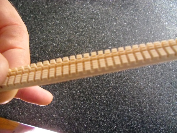

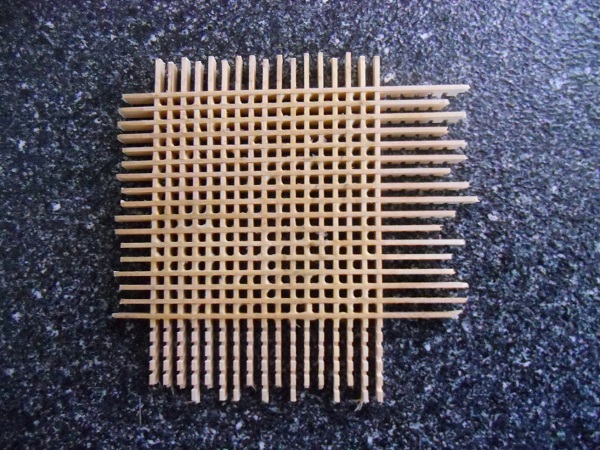

I'm still working on fairing the hull to prepare it to accept the hull planks, but it's slow going, and my attention span is too short to work on just one thing singlemindedly. So, in the meantime, I've prepared a piece of the rearmost deck. It came as a bunch of pieces of wood that had multiple little notches cut into them at regular intervals, and it seemed that when I separated all the pieces out, they fit together in a grid-like pattern. I glued them all together with titebond, which was kind of tough because there were hundreds of little intersections that I tried to get the glue into without leaving big clumps of extra glue clogging the holes, but it seemed to work ok with a metal pin as an applicator. Then I traced the 1:1 template from the plans onto paper, and transferred the pattern to the wooden grid and cut it with an 11 blade. They then suggested lining the whole thing with a 1x4 mm plank. (I think my final product is a bit oversized, but I guess if it doesn't fit, I can either sand down the external plank, or cut the whole thing a little smaller and replace the planks.
RichieG attached the following image(s):
#36 Posted : 21 February 2017 18:38:23
BigGrin Very nicely done on the gratings Richie Cool a little tip for gluing them together is to get a piece of plastic so the pieces of the gratings don't stick to the table then assemble the gratings once together apply diluted PVA with a brush over the joints and leave to dry Cool Hope this helps rgd Martyn

sure that helps! I did think to put a plastic bag under the grating while I was gluing it (so it wouldn't stick to the table), but I didn't think to dilute the glue, so I just kept dipping a metal pin into glue, and running it into every corner of every one of the little squares. Thanks for the suggestion. I'll use that in the future.
