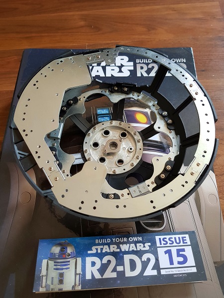

this is where it starts to get a bit tricky at issue 15. here is the frame test fitted in position. note that the ring connectors are facing towards the 1st ring, which is the opposite way to the 1st frame.

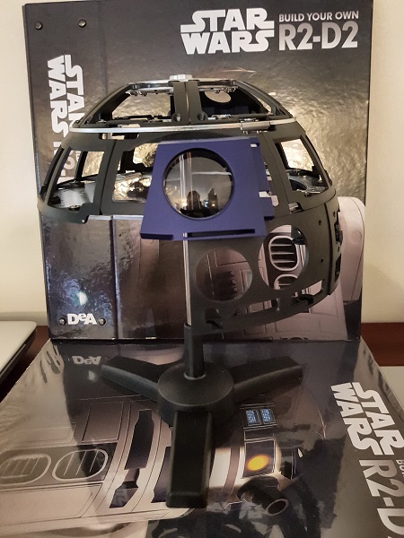

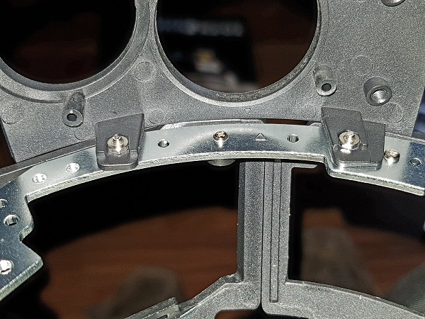

Upon fitting the frame its tricky to figure out where it is positioned from the images in the mag. If you look to the right of the large square frame where the camera lens attaches there is a little tab at the bottom corner, roughly line this up with the arrow marked on the ring frame and it will fit nicely, ensure the pins on all the frames are located in the ring.
semaj attached the following image(s):

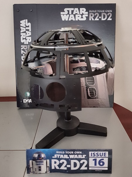

issue 16 starts the 3rd layer of framework and is quite straight forward once you have worked out the correct position of the frame, as once again the mag is not very clear.
To ensure you get the correct location of the frame part look just below the larger of the 2 holes in the new part to be fitted you will see a very small arrow/triangle, align this up with the largearrow on the main ring frame.

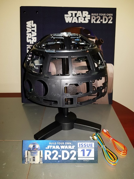

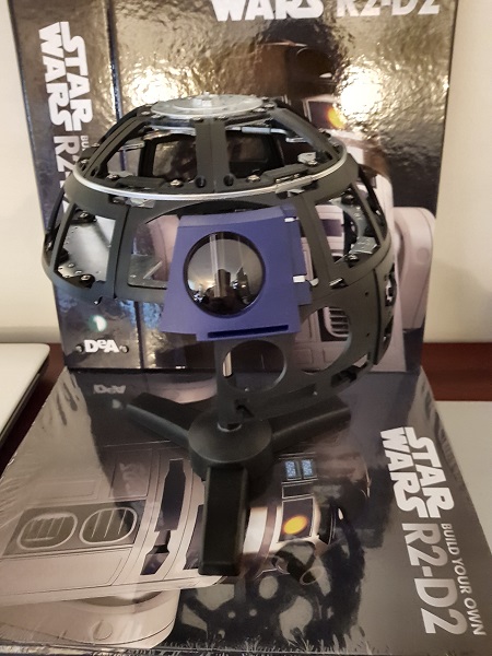

and finally issue 17 is simply adding a further frame piece to the 3rd layer, and some random cables for use much later on. one is a motor cable, and the other is for an infrared sensor.
